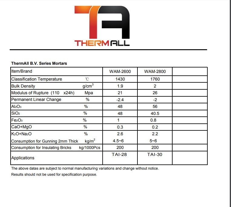

    Thanks, just downloaded the sheet, looks you are correct, I see both SiO2 and Na2O in the datasheet
    Does this imply I should change whatever I am doing now?
    Can you combine this with the Portland based homebrew, that I wish to use for the filling in of holes, or do I have to use calcium aluminate cement.
    Thanks for the info guys, this really helps.

    Your build is looking good. Your mortar sounds like it’s a sodium silicate based mortar. Check the specs as they usually recommend a max mortar joint of 4mm.

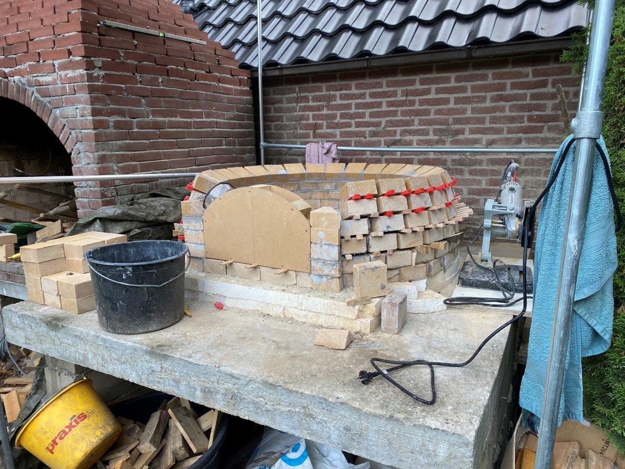

    It is going good, but slower than expected

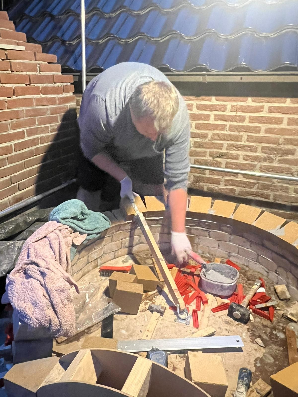

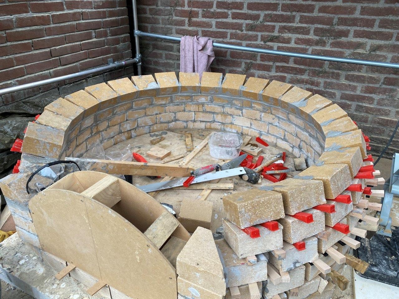

    Just now on row 5 of the build, it is looking quite good, at least for me.
Name:	2022-06-19 23.18.21.jpg
ID:	447182 Click image for larger version
Name:	2022-06-20 07.03.36.jpg
ID:	447183 Click image for larger version
Name:	2022-06-20 07.03.30.jpg
    So, I am using this high heat mortar, pre-mixed and delivered wet. Once it solidifies, it is really strong, but for it to solidify, it takes such long time. Sometime up to 2 days.
    If I even cover the WFO, it takes much longer. So, I stopped covering it, and extended the roof, to protect from rain. Luckily we had some good weather, for this time of the year.
    I am afraid to touch and wipe of the excess mortar. I tried it once, and the brick moved, I had to re-join an entire row. By the time it is hard enough, the mortar also sets in quite hard.
    The idea is to do maybe 2 rows more, than focus on the entry arch and the flue/landing part. That will harden the rest of the dome, so that I can start cleaning it.
    Did anyone try to clean the interior of the oven with a wire-brush affixed to a drill (or dremel tool), seems like the best option now.
    So, if all is well, I should be finished with 2/3 more rows and the entry arch this week.
    From the last row, I started also tapering the bricks. Otherwise the triangle type joints between two adjacent bricks in the same row is too large.
    Happy building guys, thanks
    Marko

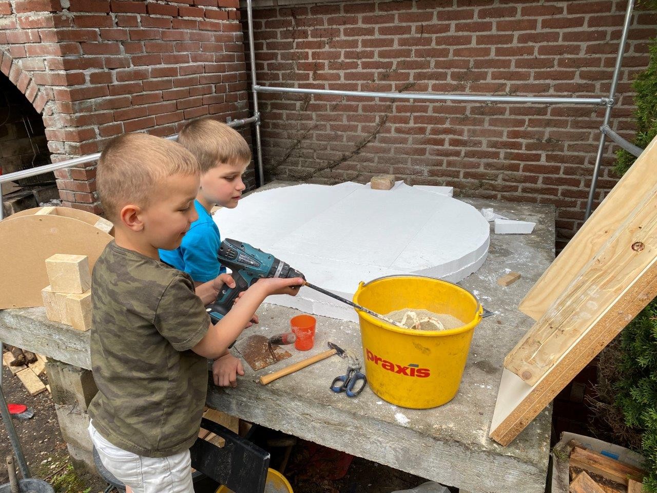

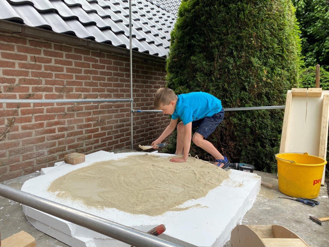

    Expert assistance on mixing fireclay and sand (1:1) for a layer below the WFO floor
Name:	2022-05-29 14.58.52.jpg
Name:	2022-05-29 15.04.34.jpg

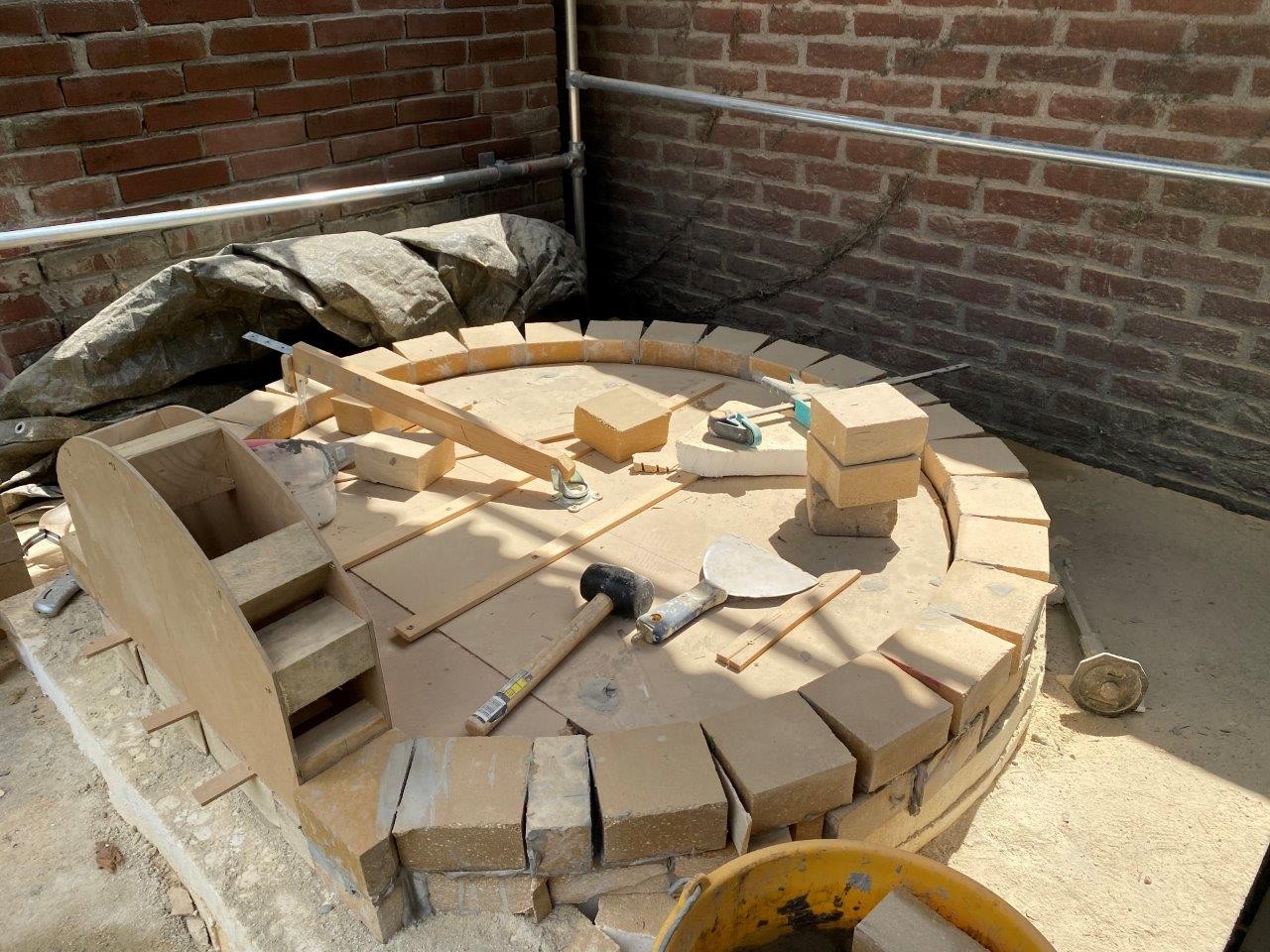

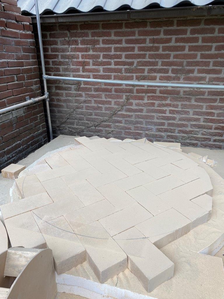

    Floor will not be connected to the walls around, to facilitate possible replacements of the WFO floor.
    After that, I made the opening template/support, and the floor was done in herringbone pattern.
Name:	2022-05-29 19.19.04.jpg
Name:	2022-06-12 12.24.23.jpg

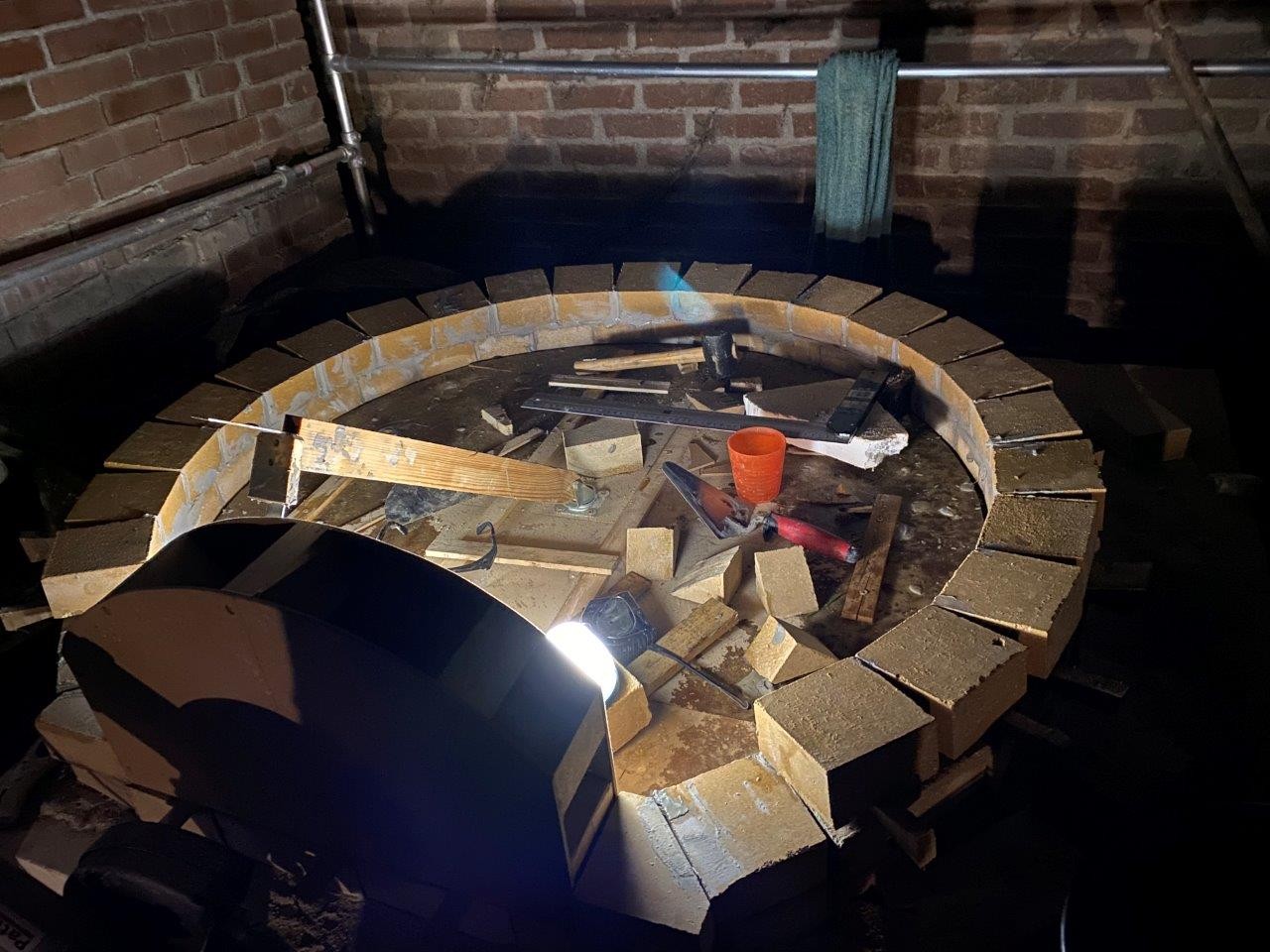

    I am currently at third row, it is going OK. This is a perfect project for procrastinators, as you can do only one row a day (at least that is how I do it, hehehe)

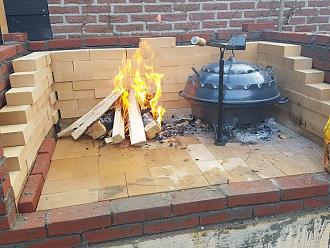

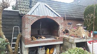

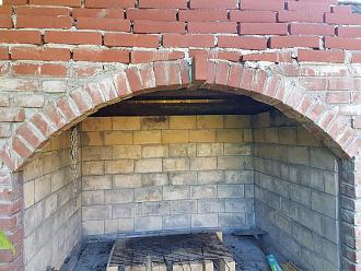

    The fireplace for BBQ was done, and we are using it, come sun or snow eversince
ID:	447121 Click image for larger version
ID:	447122 Click image for larger version
ID:	447124 Click image for larger version
ID:	447125 Click image for larger version

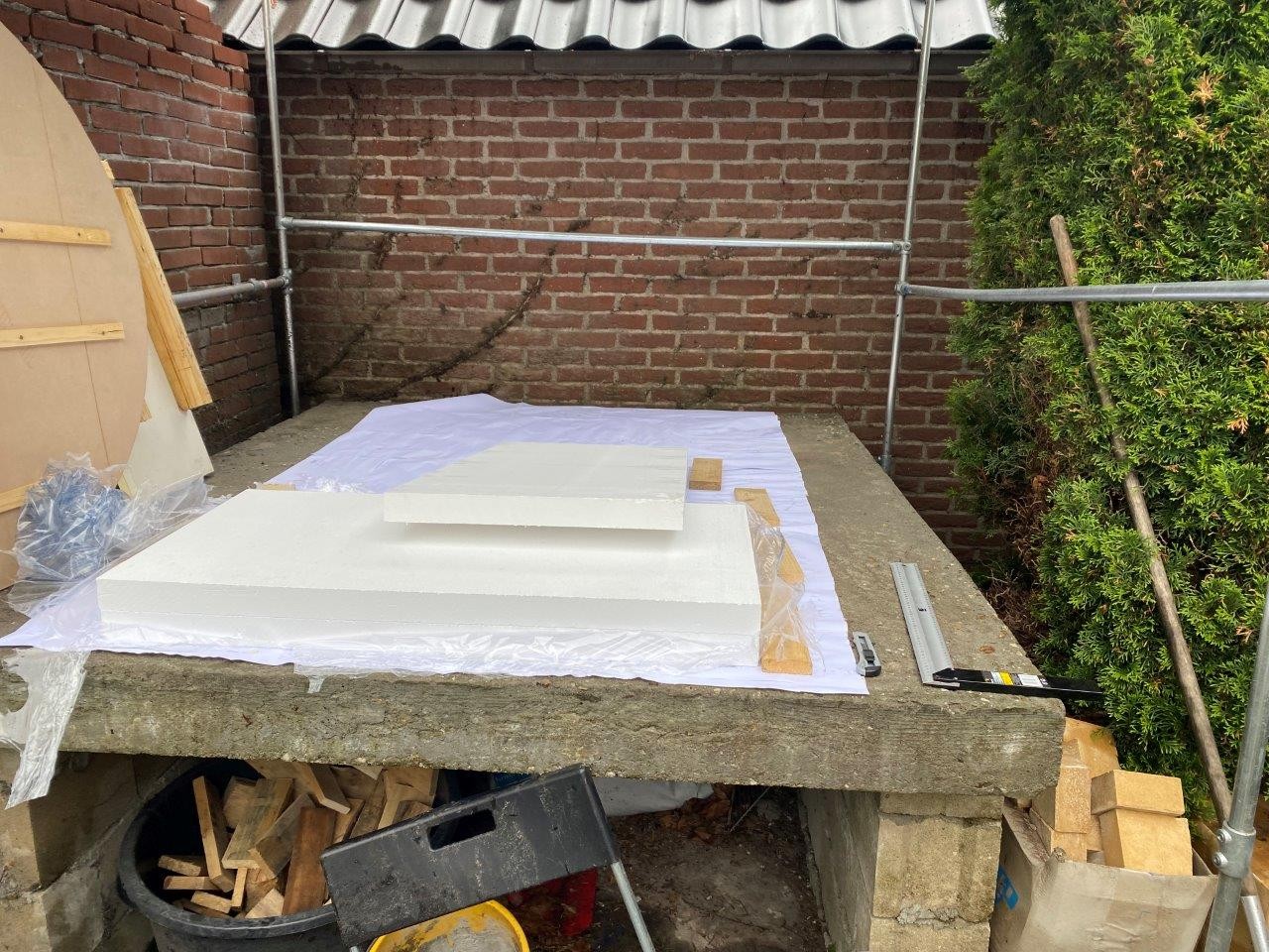

Name:
Name:
ID:	447117 Click image for larger version
Name:
