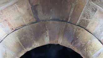

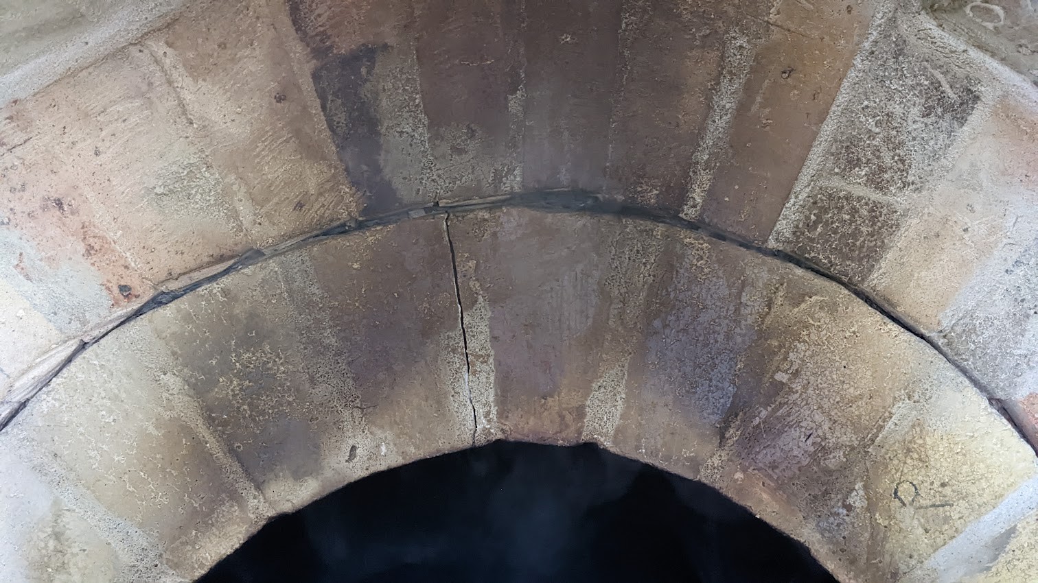

    So, as a relatively new builder, I had the same rookie hopes that my 36" brick dome would not crack. Well, during Drying Fire #2 or 3, things got a little hotter, and OOPS!!! It took me a while to realize (and accept) that it's part of the process, and that it would have happened sooner or later. There's no way to avoid cracks. In reality, your only choices so far are: 1) Turn a blind eye (includes not seeing any cracks, but they are there, trust me) 2) Accept wherever they happen (sort of disappointing, especially at first) and 3) Make a decision to control where your cracks happen (Since they ARE going to happen whether you want them or not).

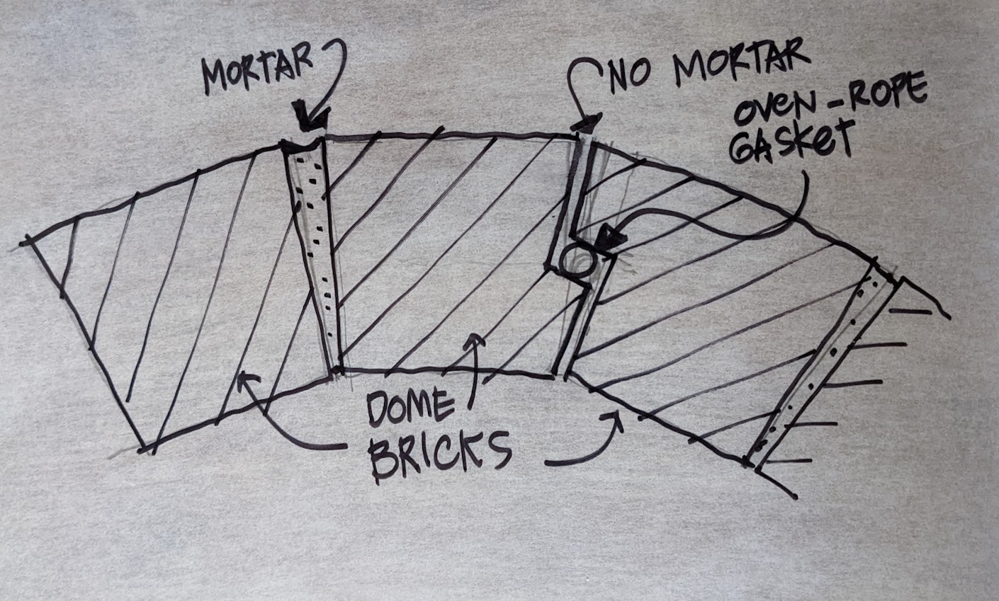

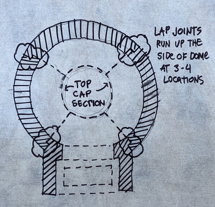

    As a former Architect, I am familiar with various strategies to deal with expansion, contraction, settling and heaving. They all involve planning ahead, and making conscious decisions on how you want to deal with the inevitable challenges that nature and the environment throw at us.
    One only has to look at the various PROFESSIONAL pre-cast ovens to realize that they have learned this lesson too, and many of them cast in sections to allow for the expansion of various sections of the dome at different rates. I am particularly impressed by segmented domes with offset (lapping) joints that also have a separate section for the very top. The idea behind the lap, is that the two sections can slide a millimiter or so past each other, but still are performing as one. This construction technique allows for expansion of the segments with the expected range of a normal pizza oven, while maintaining structural integrity, and enhancing aesthetic the aesthetics of the oven for the owner.
    What I now realize is that there is NO REASON why we can't adapt and improve these same building techniques to the DIY Pompeii oven construction made from Firebrick. The illustration below shows how I would do it now if I were starting over... The arch is an inherently weak section, so I would frame it with joints on both sides. I'd also avoid a joint straight at the back, for aesthetic reasons, so I have two more joints at the 10:00 and 2:00 hour positions. I think it's important to have a solid top, so I would recommend at least an 18" diameter top section, which in my dome would have been the top 3 courses.
    This approach goes against the general advice to not align the masonry joints from one course to another. While that is true in most brick construction walls are built with running-bond, control-joints are recommended where expansion might happen. Ovens just happen to have relatively small areas where differential heat and expansion might cause cracking, and thus defy conventional masonry construction techniques. I would also find a way to insert either a rope gasket or some other flexible insulator at the controlled lap joints to minimize smoke leaking out, or moisture leaking in- at those places. See blowup sketch of lapped joint below.
    I would love to hear feedback on this UNTESTED strategy... it does require more time and craftsmanship during the construction period, but hopefully it results in a better oven in the end.
    Click image for larger version  Name:	image_98077.jpg Views:	3 Size:	277.4 KB ID:	449795 Click image for larger version  Name:	image_98078.jpg Views:	4 Size:	342.9 KB ID:	449796

    I would think the integrity of the whole dome would suffer and the individual sections would start to break up.
    The basic principle of a brick dome is that each brick hold the next in place, I think if you set a gap the other bricks in between will move?
    However I like your thinking but feel if you keep going you will go a complete circle and end up with a cast multi part oven!
      This is certainly the approach taken by cast manufacturers, so perhaps it might work for a brick oven.

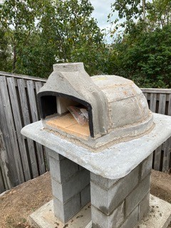

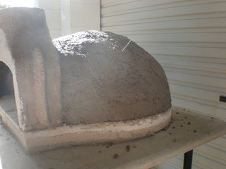

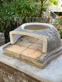

      My own approach was to use three sections, a front and back with partially half lapped joints and a large top section using a conical joint that can expand if it wants to. The top section I feel, needs to be fairly large as it is the one that will receive the bulk of the heat first and therefore suffer more from thermal expansion.This approach was also confirmed by my home oven that was built as a single one piece dome that has a hairline crack running around the dome in exactly the same place as my ,now, second cast domes. These sections once fitted together with refractory mortar are then cladded with another mix which not only helps hold all the sections together, but adds thermal mass.

        I don't disagree. This is more of a theoretical inquiry so far... if someone ever tries it, we'd find out for sure. I think the brick movement could be mitigated with some removable shim segments placed between the non-mortared faces perhaps 1mm thick? Similar to how tile is set with spacers?
        I also think with 3 or 4 control joints, with lapping joints (both vertical and horizontal) the integrity of the dome would be weakened, but not so much as to cause structural failure. Especially when we know that a crack or two don't really change the structural stability of the dome. But again, it remains to be seen that the dome segments perform as a unit like a cast segment, and don't break down with further cracks or movement within them.
          Ah, Interesting! - so you did the base of the dome as a kind of cylinder, the top of the dome as a circle, and the flue gallery as a separate unit. I like it.
          Did you use any reinforcement? Just wondering if the center of the arch, being the thinnest section of the dome base, and also getting a lot of heat from escaping gasese might be prone to cracking, much like where I got a crack on my brick arch... (which I can't see anymore, by the way, since the top of the dome arch is now all covered with black soot! )
          Click image for larger version  Name:	Arch crack.jpg Views:	0 Size:	377.0 KB ID:	449812

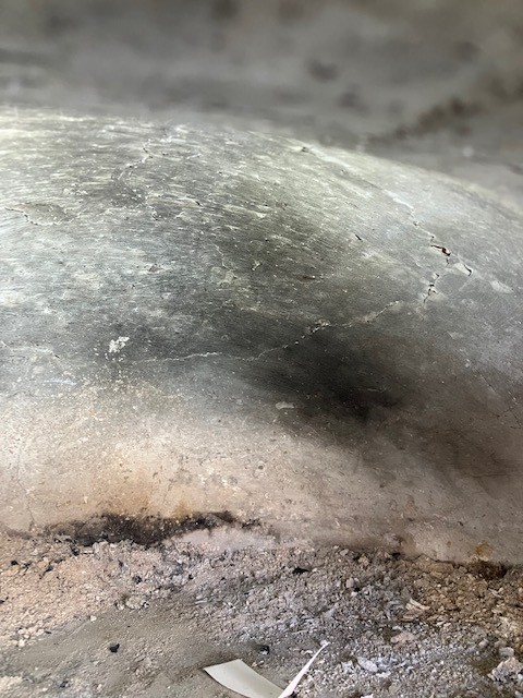

              Sixto, we make extensive use of stainless, pp, AR glass and now nanotube fibres in our castings and about to trial basalt fibres as well.
              Kvanbael ,"if you can also let the oven decide on its own few micro-cracks." This is exactly what furnace and kiln builders do. They see where cracks develop then place expansion joints in those areas in subsequent builds. It's also exactly what I did. See attached pic of the hairline crack running around my one piece cast dome. It is 15 years old and still fires as good as ever, the hairline crack never getting bigger.
              Click image for larger version  Name:	IMG_0156.jpg Views:	0 Size:	109.8 KB ID:	449817

                Re: comment #1 - Before I heated up the dome, I expected I would get cracks. When I got one smack on top of the arch, I started wondering what could be done if one wanted to avoid an unsightly crack... (some people are more accepting of happy accidents than others?) I happen to be totally comfortable with what I have, but wanted to explore alternatives for future builders that want more control.

                  Mortar for general brick construction, not only ovens, is always meant to be weaker than the brick units. This is to prevent any cracks going through the bricks themselves, thus relying on staggered brick courses for structural strength.
                  The main reason cracks occur, particularly at the top of the inner arch is that builders don't heed the warning to avoid direct flame impingement especially in the first few drying fires.
