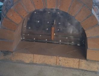

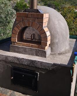

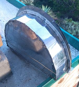

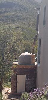

          • #50
            Hi guys,
            Above are some photos of my progress with the oven, including the inner door, the vermiculite layer, the final render, and the store room on which the oven is built.
            This storeroom gets hot when the sun shines on it, would a layer of vermiculite / cement and render work in solving this problem?
            Has anyone done this,? If so how should I go about it, without it collapsing after a while?
            Thanks again for all the input and support you guys have given me to reach this point.

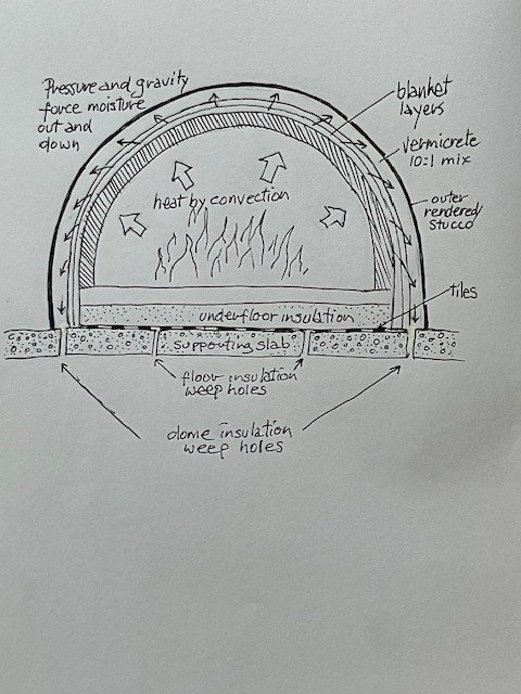

              I was thinking about the pizza dome and moisture,
              If a bit of moisture happend to, get in the inner layers somehow without me noticing it and I made a fire, it would cause steam to build up, especially as I have waterproofed the render, this steam would obviously be able to cause damage to the dome
              Would it be feasible for me to drill a small hole on top of the dome, say 5 or 6mm diam. down to the ceramic layer to allow the steam to escape. Then keep it plugged with say a wooden dowl.
              Or am I way off course?
              • #52
                Think how long it would take for a saucepan to boil dry with one tiny hole in the lid. It should relieve steam pressure build up but drying wet insulation takes a long time. As the heat rises by convection in the chamber the top of the dome will get hot and dry much faster than the bottom. I believe moisture vents are far better placed in the supporting slab and lining up with the dome insulation layers which will dry the oven more efficiently and be out of sight. My diagram explains how it works.
                • #53
                  Thanks David,
                  OK your reasoning sounds good. But that looks like I should have provided those weep holes at the beginning of the build. Also the whole dome sits on a solid concrete slab.
                  What do you think?
                  • #54
                    You could drill some holes up through the bottom of your concrete slab starting with an 8mm masonry bit. But you won’t know where the steel reo is, so fingers crossed you don’t hit any. The holes can then be widened to around 12mm About 4 to locate the dome insulation layer and a few near the centre to allow the underfloor insulation to breathe. I’ve performed this operation with excellent results on a few ovens with wet bottoms.
                    • #55
                      Thanks David
                      I have done that, and I must say that I feel a lot happier now with that sorted.
                      I managed to only hit one reo
                      Have a great weekend

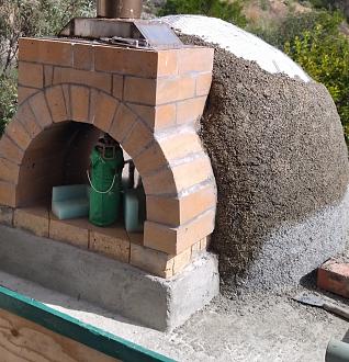

                        Hi guys,
                        Trusting that you all are doing great, and those in the Northern Hemisphere are putting your ovens to good use.
                        I have made a mistake, I sealed my outside built oven but did not seal the chimney. We subsequently had a long period of lots of rain with the result that the bricks on the chimney have produced a lot of efflorescence.
                        I don't want to rush ahead and do something that will be harmful to the quality and appearance of the bricks.
                        Does anyone have sound advice on how to best clean them, as well as what to seal them with.
                        Would it be best to use a sealer with Silane/Siloxane in it, or a water based sealer.
                        Also it appears that the water has permeated into the surrounding dome bricks, would this mean that I must do another round of cool to hot fires to get the moisture out.
                        I would be glad to receive professional advise on this issue.
                        Have a great day and weekend.
                        • #57
                          It sounds like you still have moisture in your oven. You can wire brush off the efflorescence, but it would be best not to seal the brick work yet. Avoid pizza temperature for now and just use the oven for roasting and baking. If there is a persistent black ring of carbon around the bottom of the inside of the dome, which I suspect you have, don’t have a raging fire or you can risk damage at this stage. To test if the oven is still purging itself of water, you can also throw some sheet plastic over it to see if moisture condenses under it. You can hurry up the drying process, but it will risk damage. You can’t go too slow and it’s far safer.Leave the sealing until you are perfectly sure the oven is dry.
                          • #58
                            Thanks David
                            I was pretty sure that the oven was dry before the week or so of heavy rain. So I had tested it with a plastic sheet and it seemed fine, so I went ahead and sealed it with a Siloxane sealer, but not the chimney.
                            ​​ Since the rain there are dark "fingers" showing on the dome going back from the chimney. I will post a photo a bit later.
                            The efflorescence does not come off easily with a wire brush, someone suggested weak hydrochloric acid, then to neutralise it afterwards with baking soda???
                            I have not started using it yet as there is a delay in the granite slab I am wanting to lay in the front
