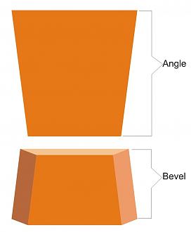

    So I downloaded it and printed it out. I’m trying to understand some of the measurements under jig setup. It says side tilt (Chipsters Jig); back tilt (Hendo’s jig) and side angle. How does this translate to taper, wedge and skew. Seems like these would be more universal terms.
    thanks
    Attached in one version brickies diagram of various terms. So angle can be also called taper and/or wedge and bevel a skew or compound cut. So tilts are used on jigs to make compound angle bevel cuts. Bevel cut do NOT need to be the entire length (front to back) only where the two ID bricks start to overlap. Look at JR Pizza's build and he shows where only the first internal part of the brick need to be compound beveled.Click image for larger version

        Thank you. I’m trying to figure out how taper, wedge and skew correspond to side tilt (chipster), back tilt (hendo) and side angle on the spreadsheet
        thanks
          Those figures are the settings to use in a brick cutting jig, rather than the final angles on the brick. MrChipster's jig is a contraption that tilts the brick sideways to achieve the desired bevel. Hendo's jig tilts the brick forward. I believe the spreadsheet has links to the forum posts on each jig. You only use one set of numbers or the other, depending on what kind of jig you're using. With either jig you need to rotate the brick horizontally to achieve the desired angle (as in Utah's diagram). The amount of the side angle is a function of the width of brick blank, and largely does not change with subsequent courses until you switch from 1/2 to 1/3 bricks.
