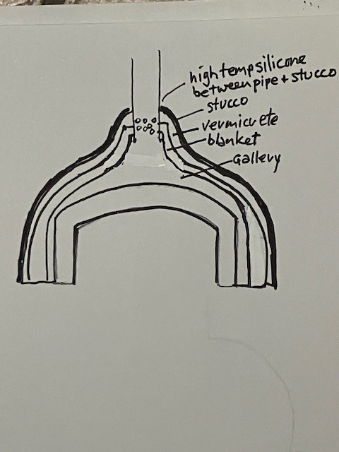

                    Because the top of the dome gets hot first, the moisture present there is also driven out first.,as moisture will always travel away from the heat source. For this reason, the direction of moisture travel is towards the base of the dome, so any venting is better placed at the bottom. This situation can also be assisted by steam pressure build up in the upper part of the insulation space. The accompanying drawing explains this process.
                    Alternatively if you are still keen to provide a vent in the upper section of the insulation space, some holes made in the base of the flue pipe that sits in the insulation space, can allow moisture to escape into the flue pipe and exit there (second drawing)
                    Either of these solutions remove an exposed breather at the top of the dome's exterior.
