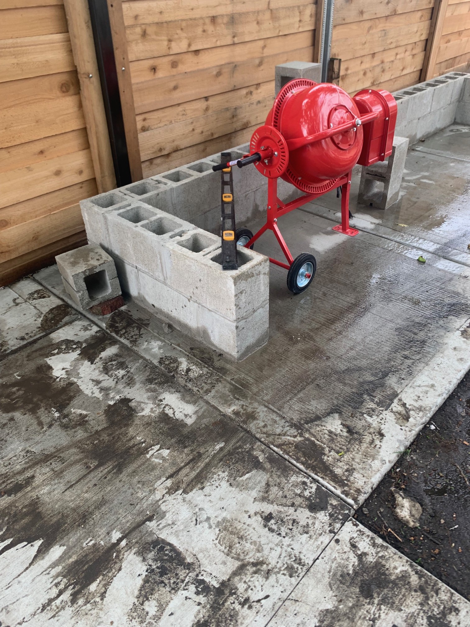

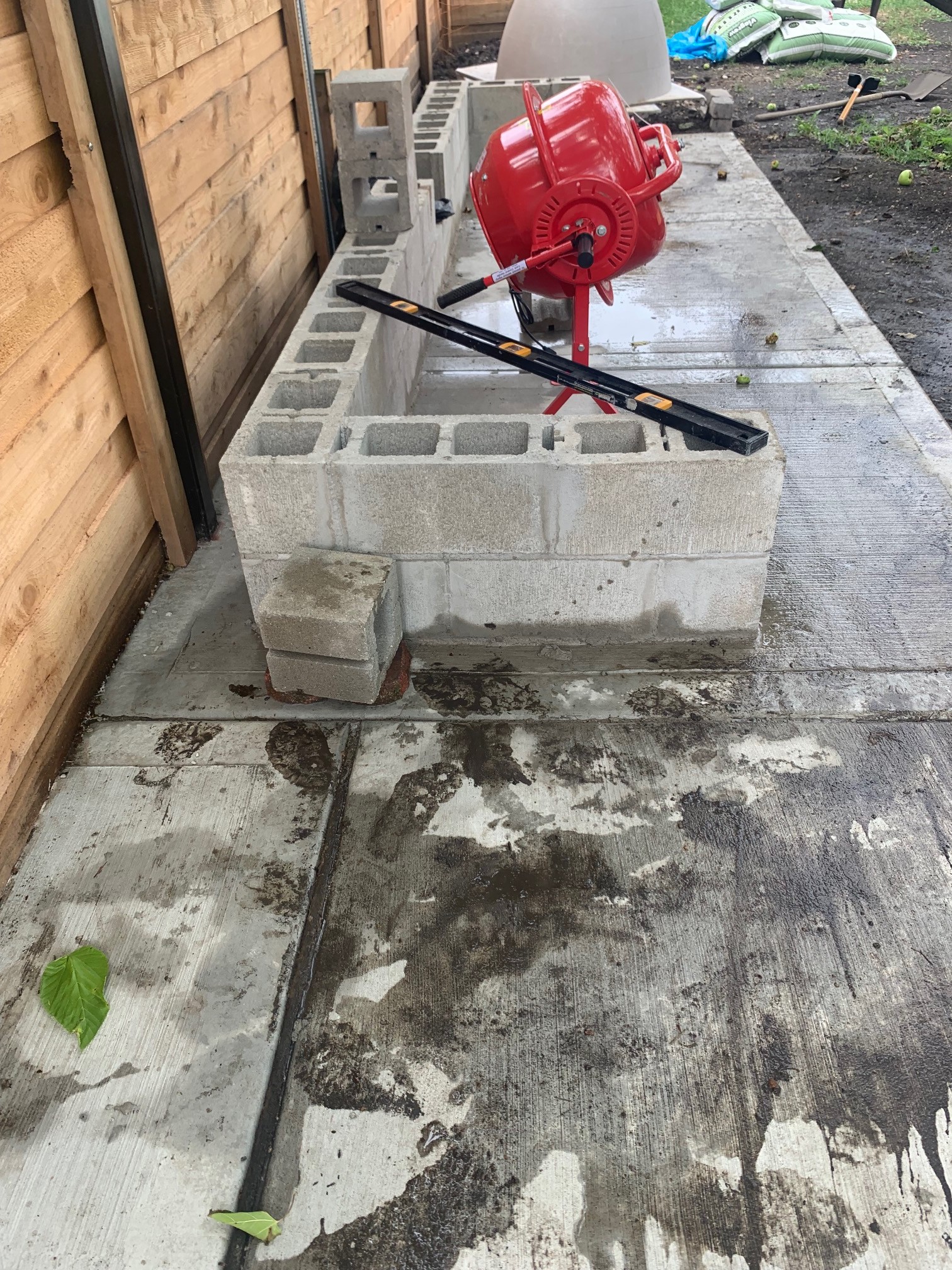

    Here are some pics of my cinder block perimeter so far.

      - Not sure how big of an oven you had planned, but just based on the number of blocks in your picture, your cinderblock structure doesn't seem deep enough unless you have quite a small oven planned (the successive layers of wall, insulation and stucco add up, plus you need more room in the front for chimney than you need on the sides.

        - The inside of the oven should be about 42" in diameter, and I plan to have the oven on a 45 degree angled with the opening towards the rest of the kitchen. But I think you are right and I may need to add an additional block or have the 4" thick cement base with a bigger lip.

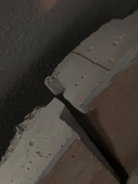

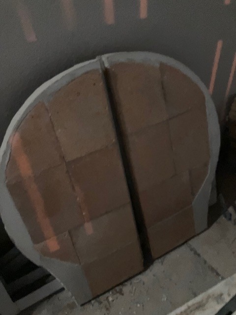

                        For my ovens I solved the uneven floor brick issue by creating a two piece cast, casting upside down which creates a perfectly flat surface, employing a single tongue and groove join. This then provides two manageable sections with the single join providing sufficient movement for expansion.
ID:	460090 Click image for larger version
