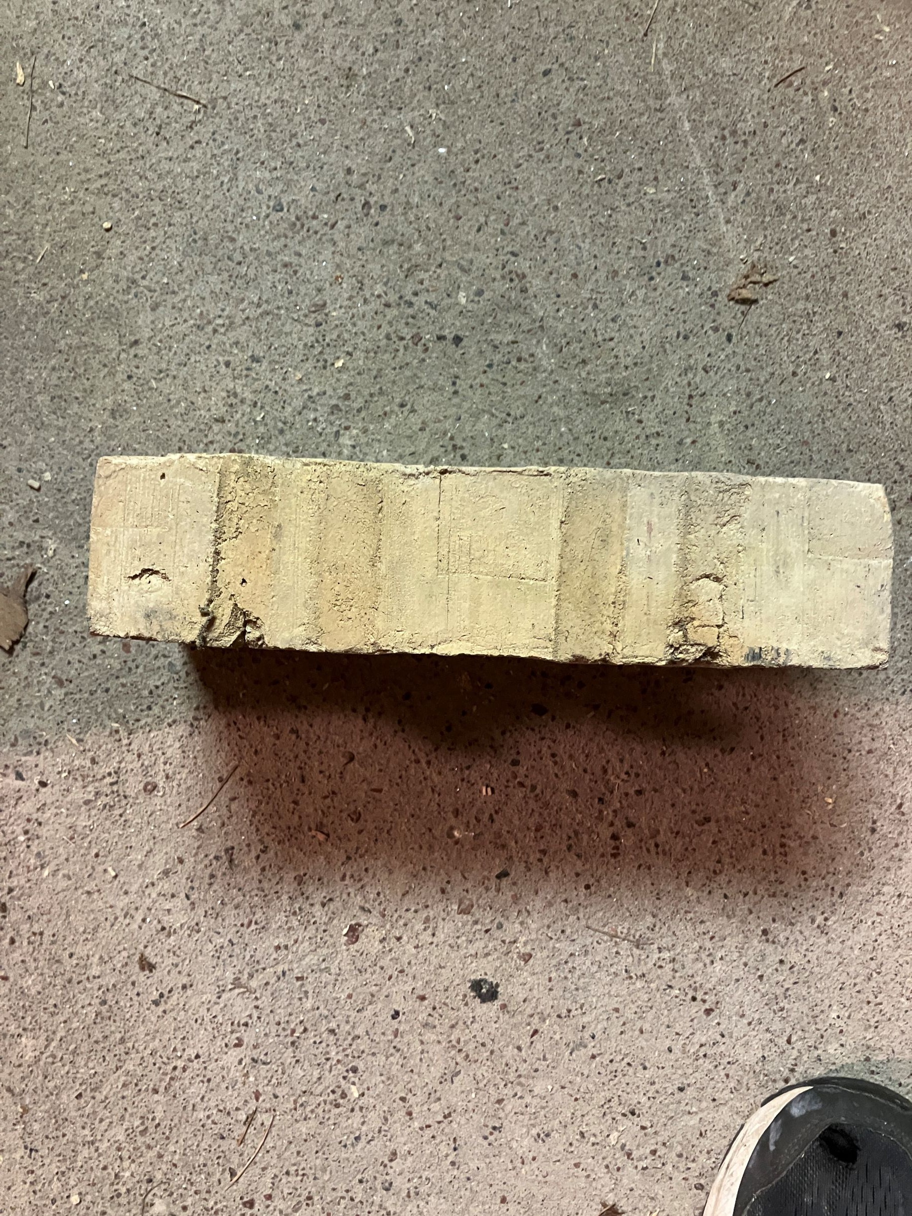

    I found 60 'valvsten' bricks for about $2.50 each. This means they were already precut for a certain diameter arch so they're dimensions were 230x114x59-69. This caused some small problems later.

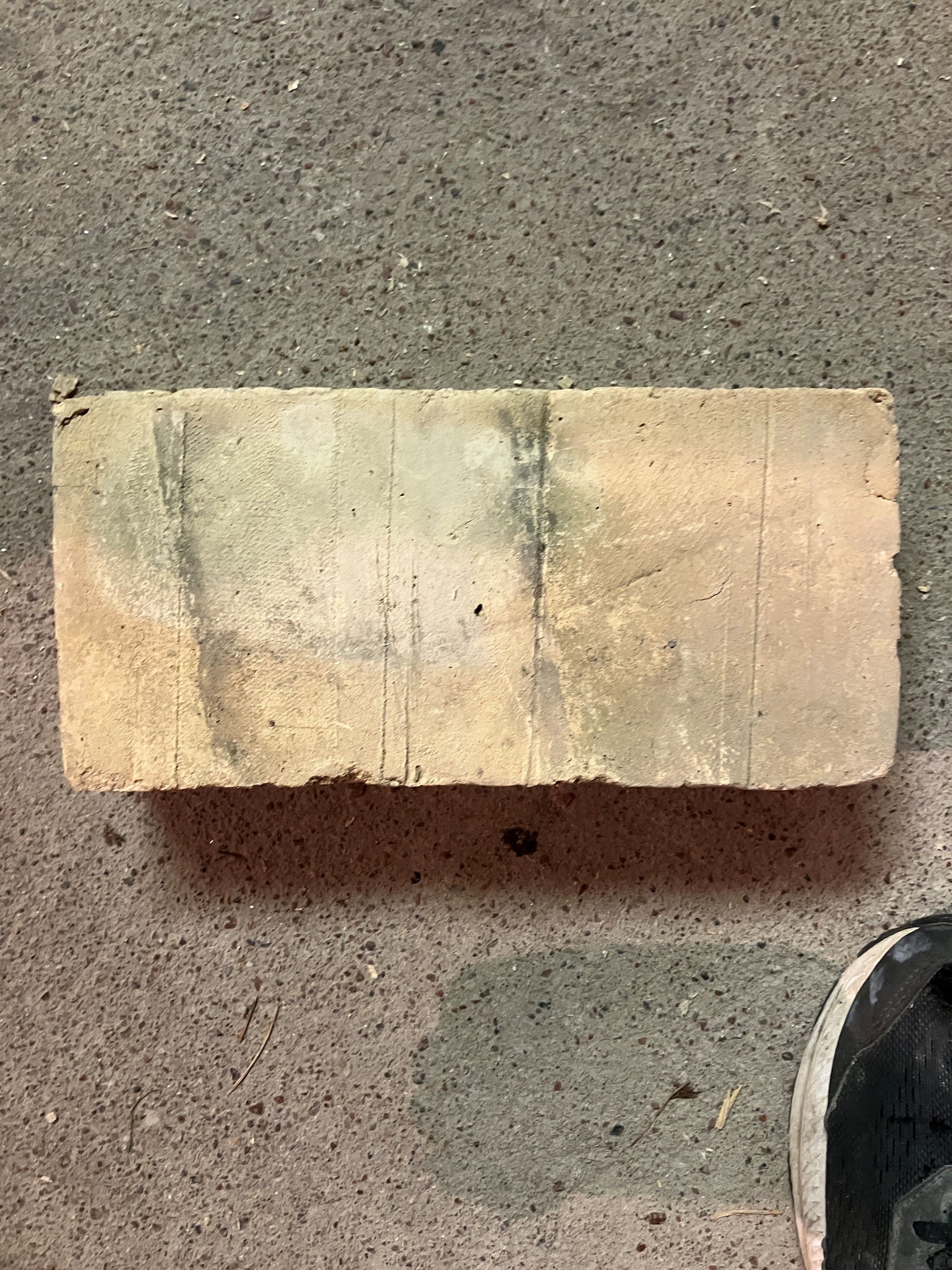

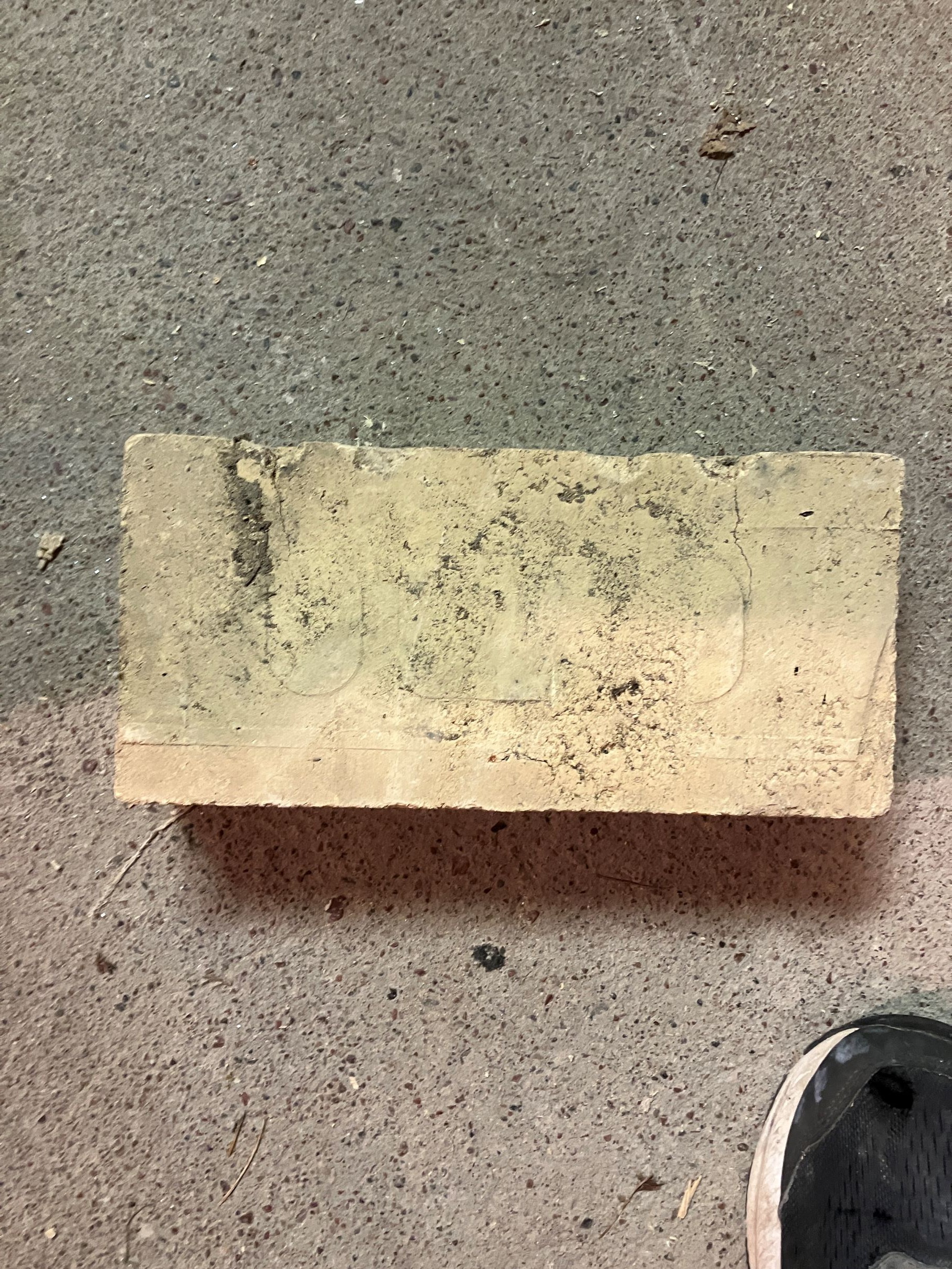

    Next I found 123 bricks also for $2.00 each. Now these were stacked outside on a pallet. Once I got there it turned out to be 6 different dimension bricks. 92@ 250x120x60, 18@ 200x95x55, 8@ 225x110x64, 2@ 245x120x75, 2@ 295x145x75, 1@225x110x40. I figured this was good enough so I went with it. The 92 bricks I used for the dome/arch and the rest I cut down to workable sizes for the floor. So my oven floor is a bit crazy. Pictures later. However, those 92 bricks caused me a lot of problems. I realize now that these were obviously hand cast in molds and hand cut with wire. This means that the all bricks are slightly uneven, cupped, warped, or slightly different thicknesses. As a someone who really strives for accuracy this was perturbing. To top this off all of them had been left outside stacked on top of eachother for so long that there was a large amount of mold on over half of them. I picked them up in winter so this was not readily apparent until spring when my garage then smelled strongly of mold. I ended up putting most them on a charcoal grill about 5 at a time to kill all the mold. Still didn't completely succeed.
    I realize this sounds a little whiny, sorry about that. I fully realize that I did this to myself
    After that the secondhand firebrick market dried up so I ended up needing to buy 19 new firebricks. After a mistake with my order I ended up getting an extra 19 delivered by accident which they then said I could keep, so that was a nice bonus. These extra bricks ended up being just enough to build my entry vault.

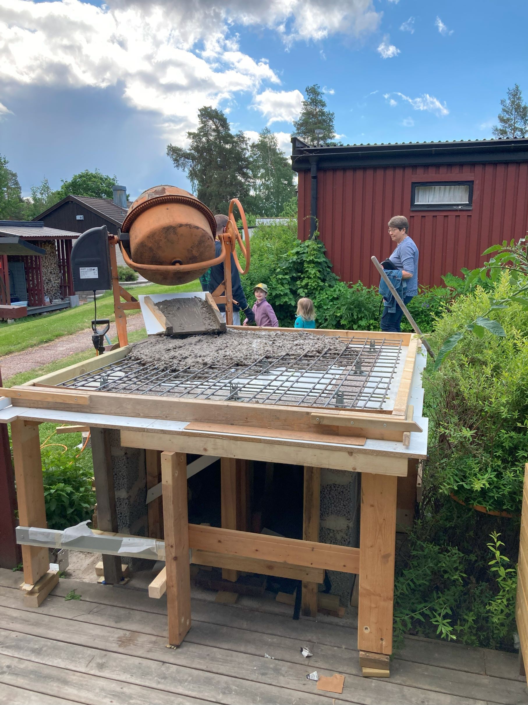

    I had originally thought to do concrete sacks to make the foundation and hearth slab easier. This turned out to be financially restrictive. I got rocks and sand from my local recycling center, bought cement/rebar, borrowed a drum mixer from a neighbor and poured the foundation and slab that way. I'm a structural engineer by trade so I was able to calculate the reinforcement I needed.

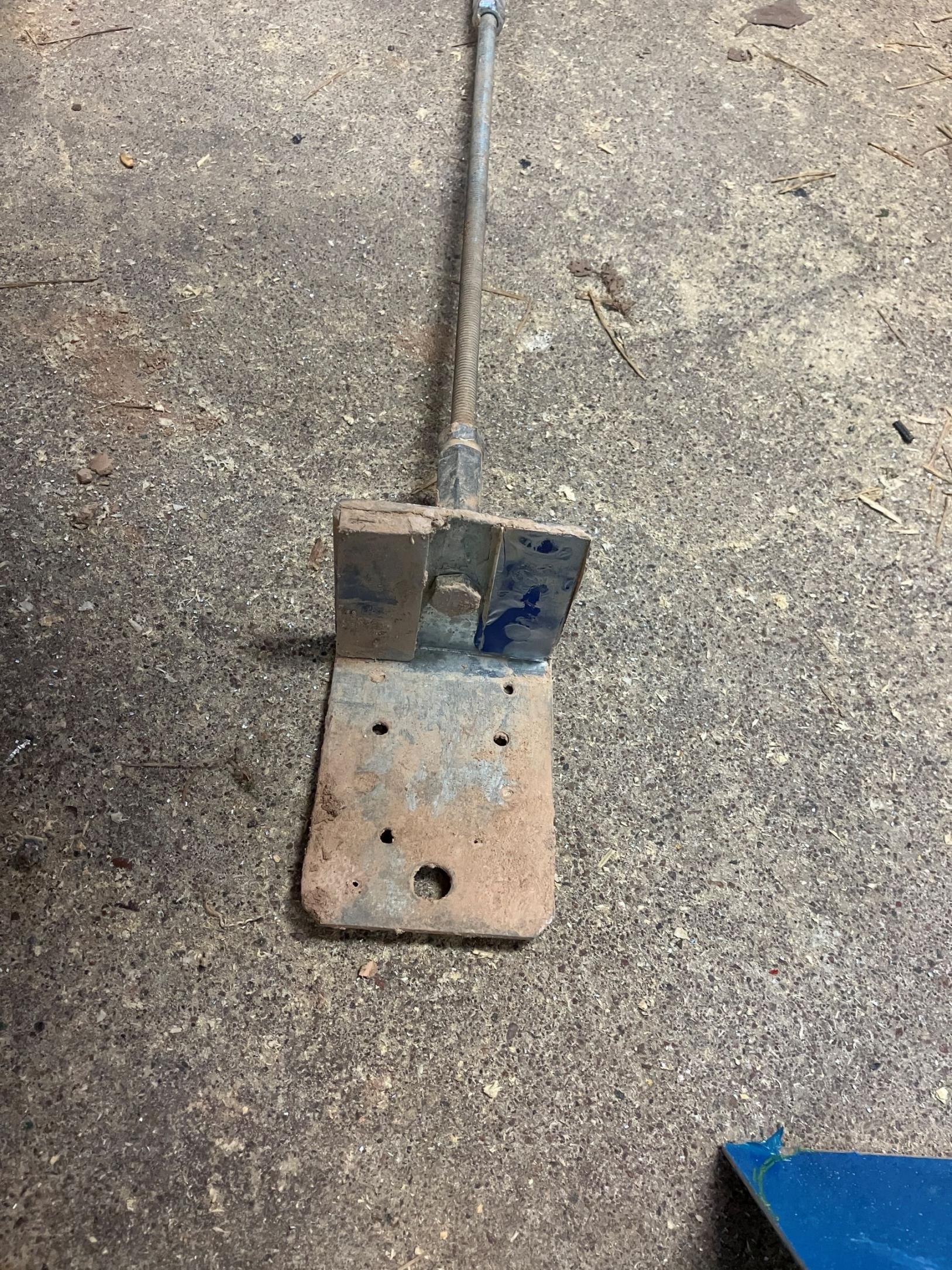

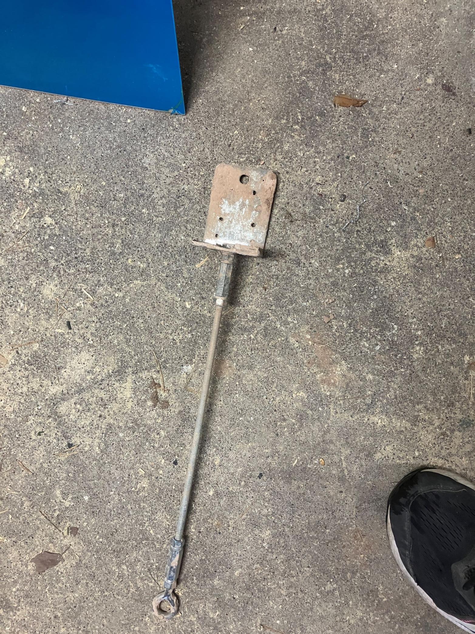

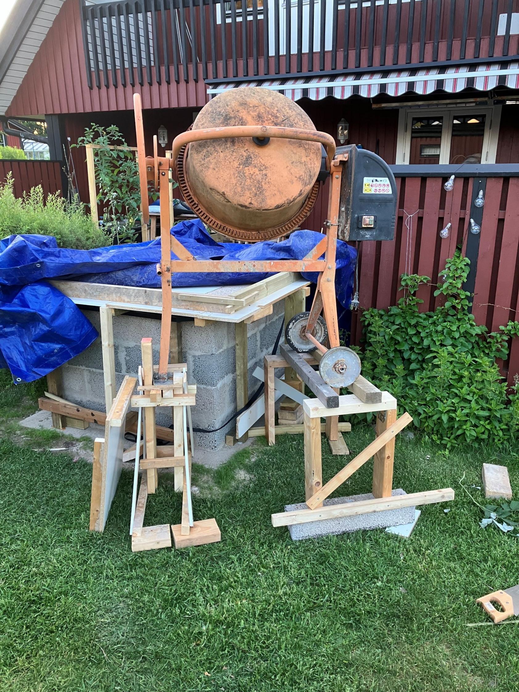

    I spent a long time trying to find the right indispensible tool design and didn't really find anything on the forum. Too many designs included welding. I ended up bolting an angle to a threaded rod with locknuts and coupling nuts. These I connected to the plywood floor form with another coupling nut, a caribiner, and a loop screwed to the plywood. In retrospect I did not like this design. Try to make a fixed length one without a break instead.
    Angle grinder was on par with price and was easy to find. If you're like me, never really used an angle grinder before, and think you can make accurate cuts with it. You are mistaken. I was bad at using this tool

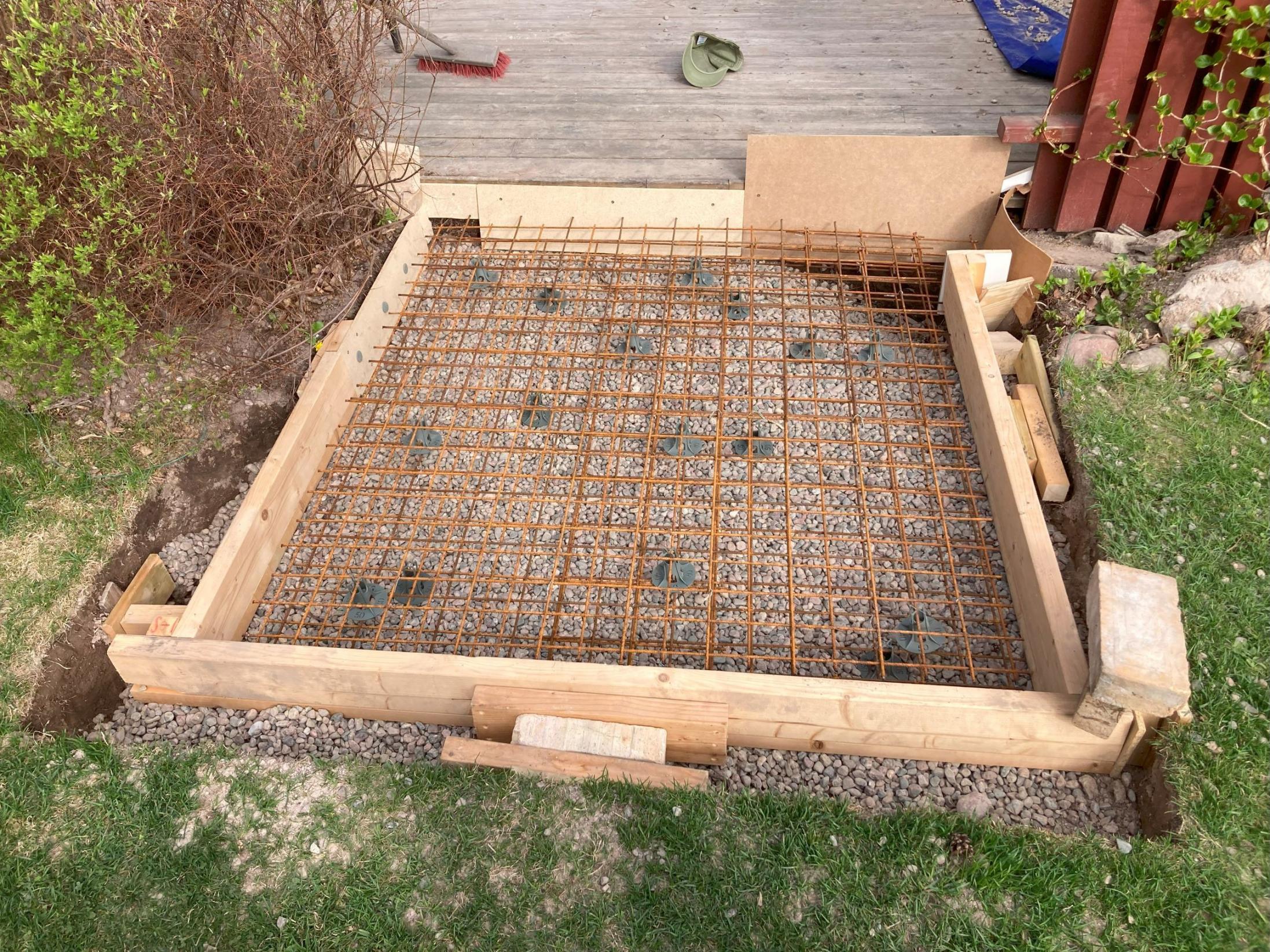

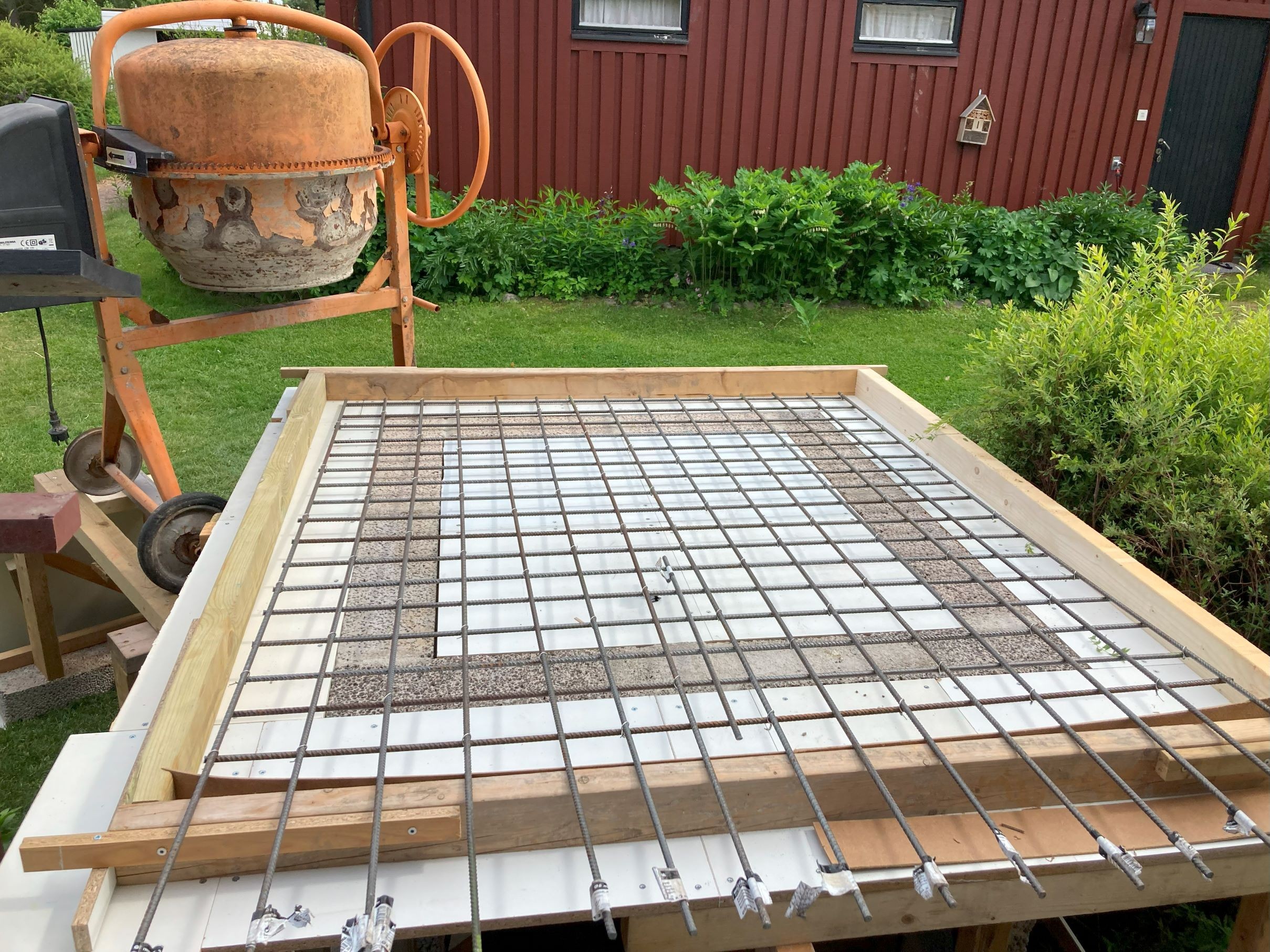

    Foundation

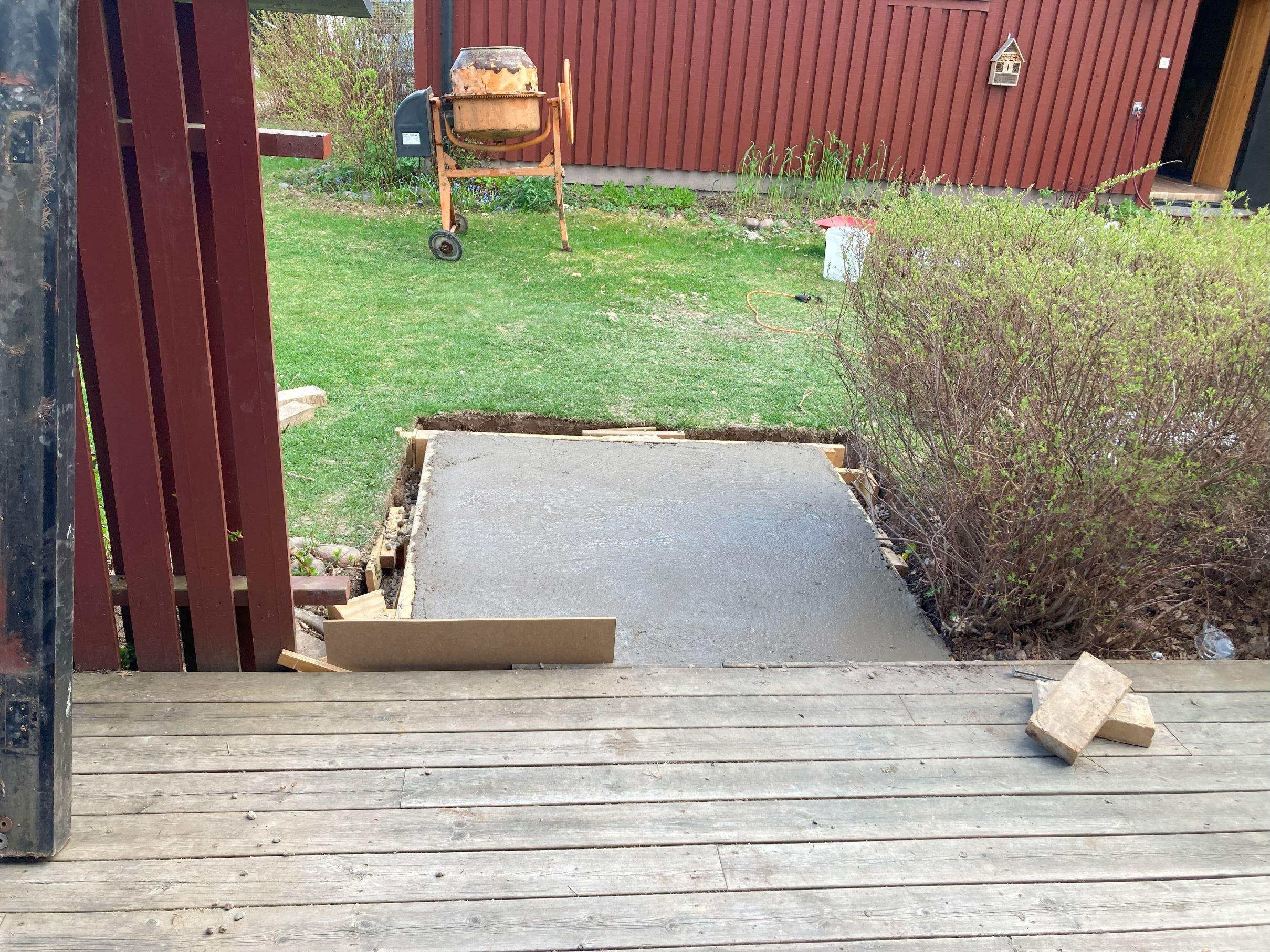

    As I've said before, I am a structural engineer. I know how concrete works, I know how to calculate it's strength, I know how to calculate the right amount of rebar. I am not a construction worker. Casting this was difficult. I did it alone with a drum mixer. It took 7 bags of cement, 500kg of rocks, 300kg of sand. I am a reasonably in shape person and measuring and pouring this much material destroyed me. I was very tired afterwards.

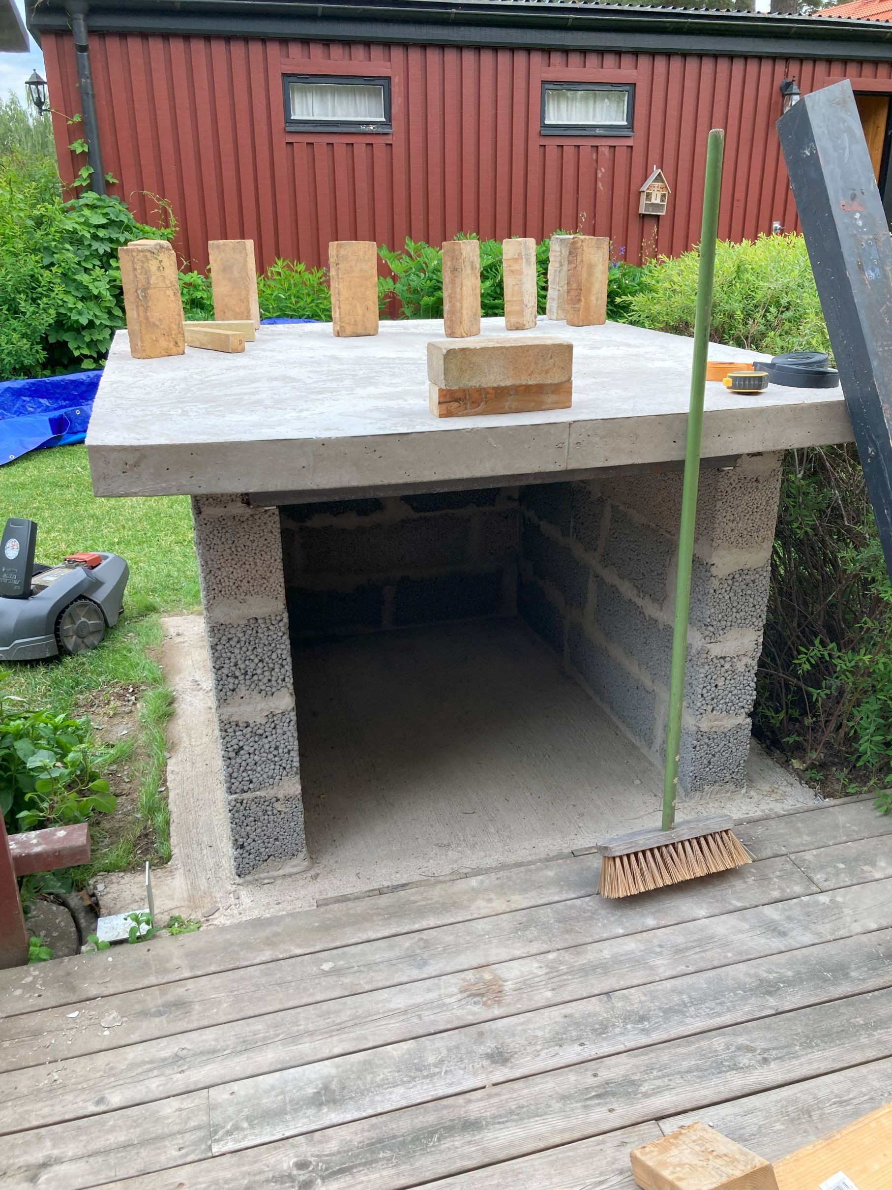

    Stand
    I built the stand out of Lecablock as it's known in Sweden. These are the standard for light masonry here as opposed to CMU. Apparently these are also named Leca block in America too although I don't ever remember seeing them in any hardware store. I spent awhile trying to figure out how to anchor the units to the foundation below as there are no holes, they're just solid rectangles. In the end everything I read said that it wasn't really necessary. So the block is just sitting on top of the foundation relying on weight and friction to hold it in place.
    Slab

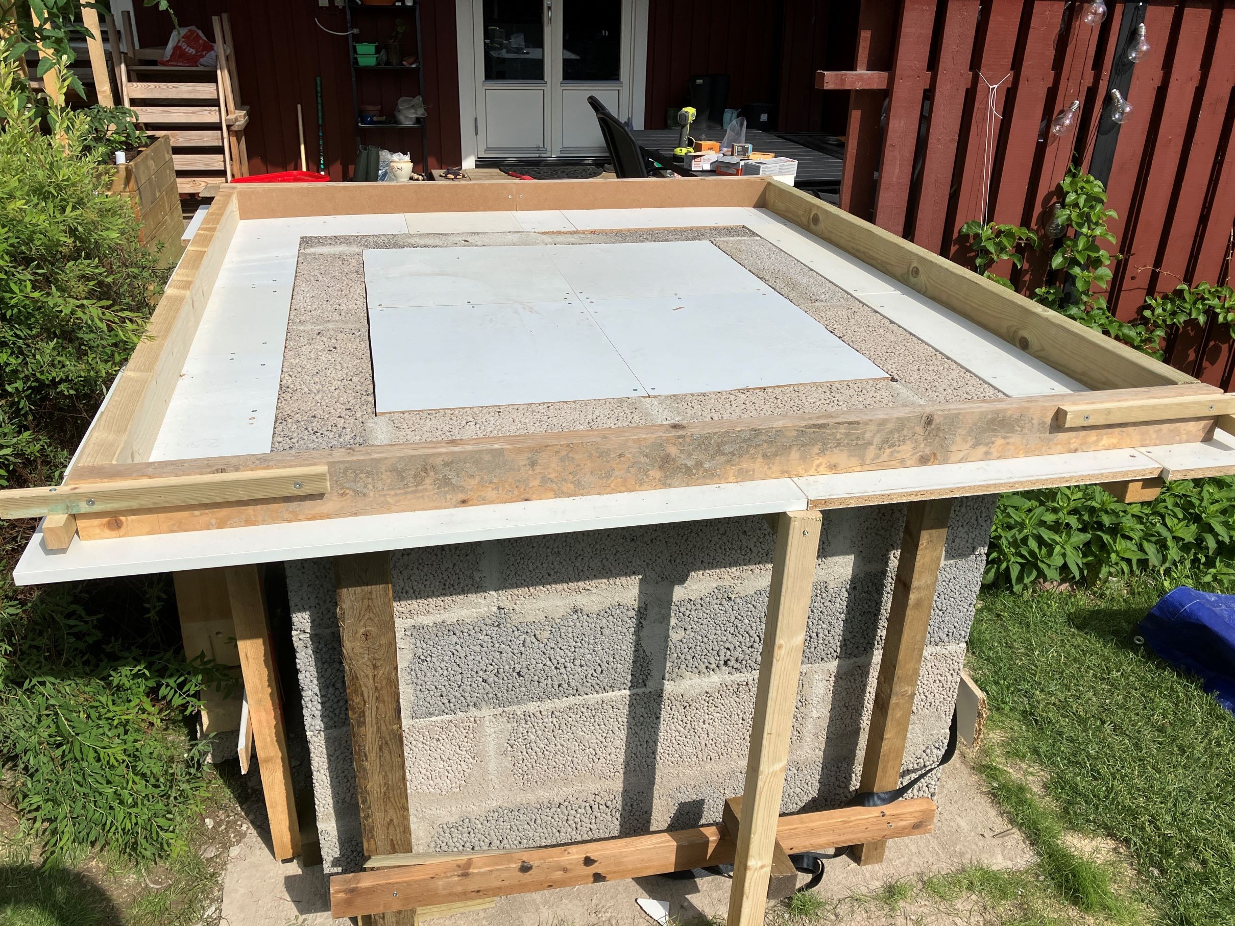

    We remodeled our kitchen about two years ago and I saved all the shelf boards and planks that I could. Thank god I did that because this saved me a lot in forms for the hearth slab. The form is just a bunch of square sections screwed together underneath with spare wood. Now to the sketchy unsafe part. I still had the drum mixer but I remembered how physically exhausting casting the foundation was. I couldn't figure out how to pour the elevated hearth slab. Ordering concrete with a truck was out of the question for only 0.25 cubic meters of concrete. I don't think I could have the energy to pour the concrete from the drum to a wheelbarrow and then shovel it up to the slab form. I thought about building a ramp to push the wheelbarrow up but that also sounded exhausting. So my solution was to build a stand out of scrap wood that the entire drum mixer could stand on in order to pour directly into the slab form. This looked sketchy as hell, but it worked and saved a lot of effort.

            I'm not very good at casting concrete. My hearth slab was not as neat and clean and flat as I had hoped it would be. I read a post about broken up tiles underneath the calcium silicate board to raise it off of the slab and I thought that sounded like a good idea so I went with it. Because my slab wasn't super flat and the silicate board I got was not great quality (I sent some complaining e-mails) it was difficult to get these level. I ended up using a good amount of sand around the tiles in order to even out the silicate boards. When I went to put the floor in these still weren't even enough so I needed to also do the sand/fireclay mix underneath the floor bricks. I am very tired of leveling things.
            I read one post, from Sweden actually, that made their own under oven insulation out of leca balls. The same thing as the leca block I used to support the hearth slab. I thought this sounded like a good idea to keep cost down however there wasn't any after oven checkup so I don't know how well they performed. I ordered silicate board for underneath the dome and used leca balls underneath the entry vault.

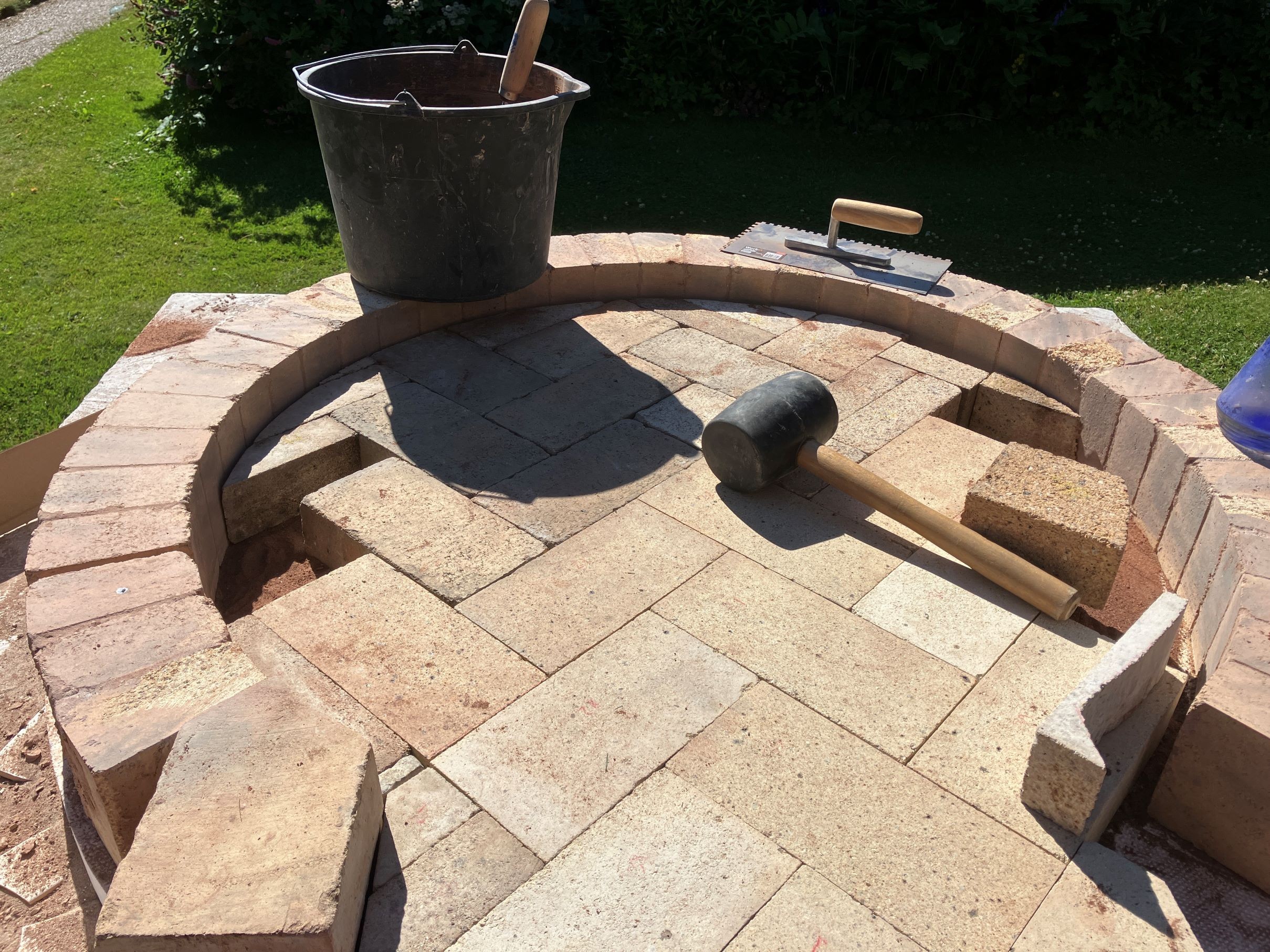

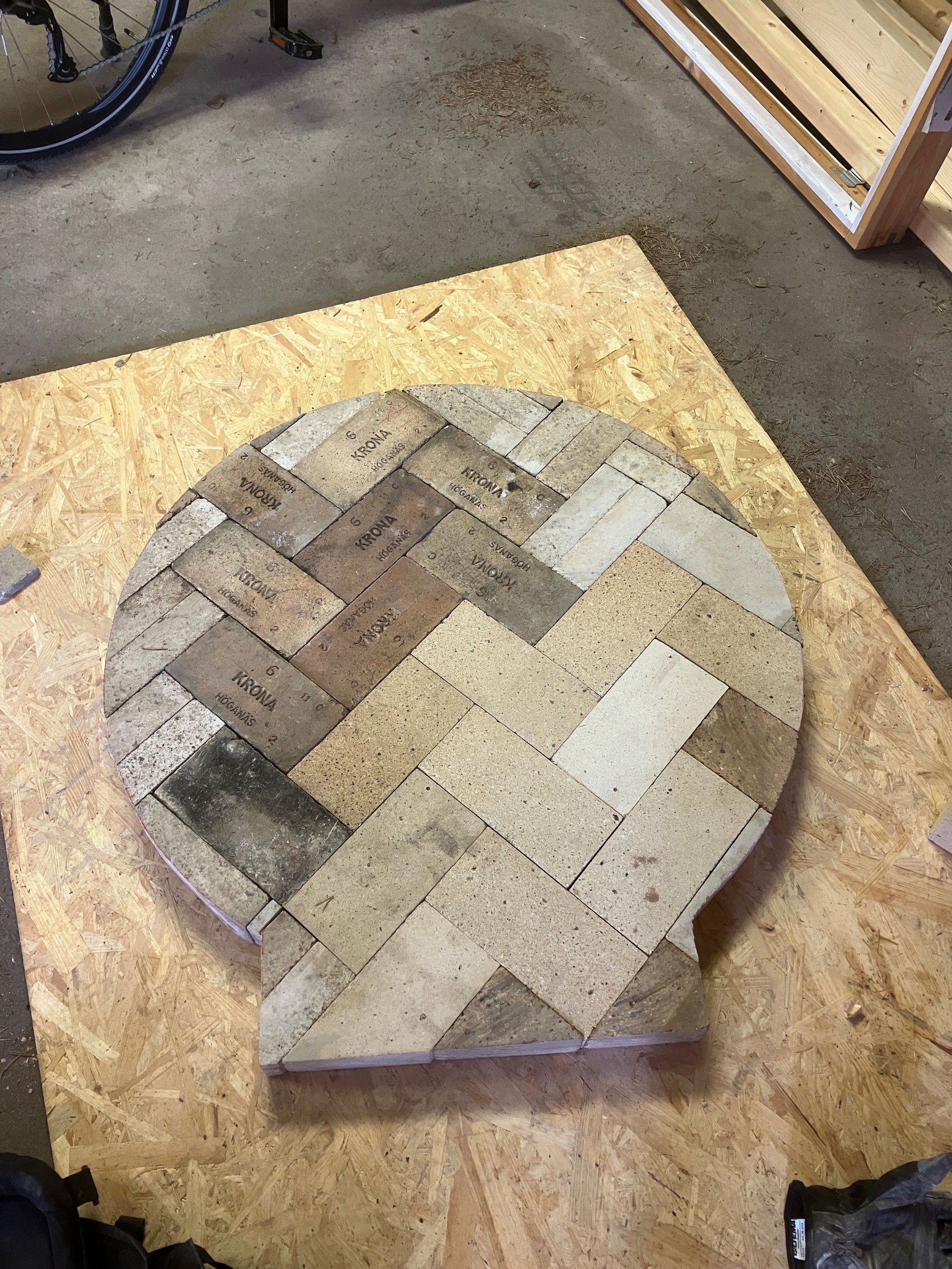

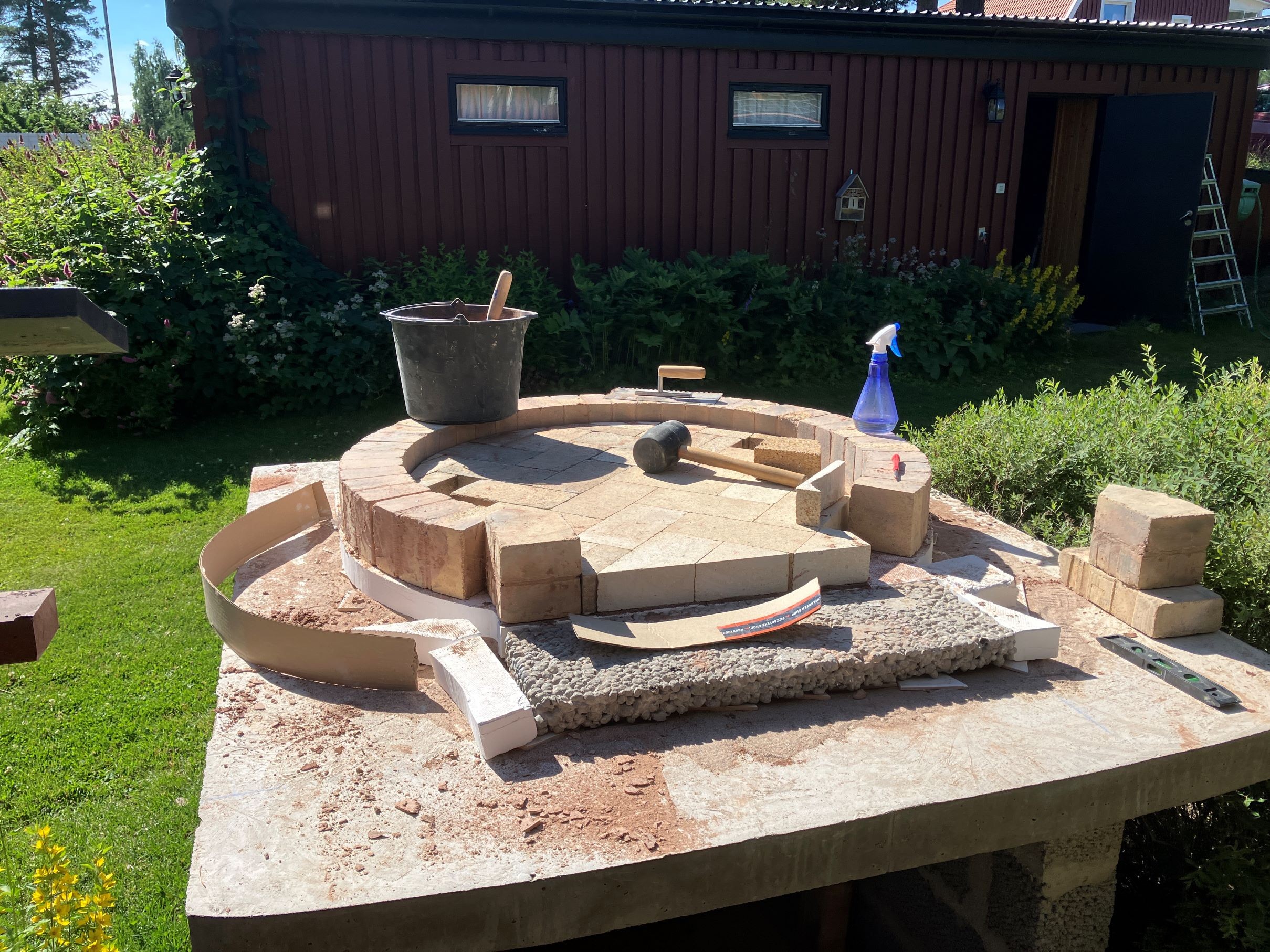

            I mortared the half soldier course first, cut the floor bricks using a template, then installed the floor after the half soldier course. If I were to do it again I would have reversed this. Installing the floor bricks after the half soldiers necessitated som extra shaving/cutting in order to get them to fit. You can see my frankenstein floor in the pictures that I did in order to use as many of the secondhand bricks as I could.

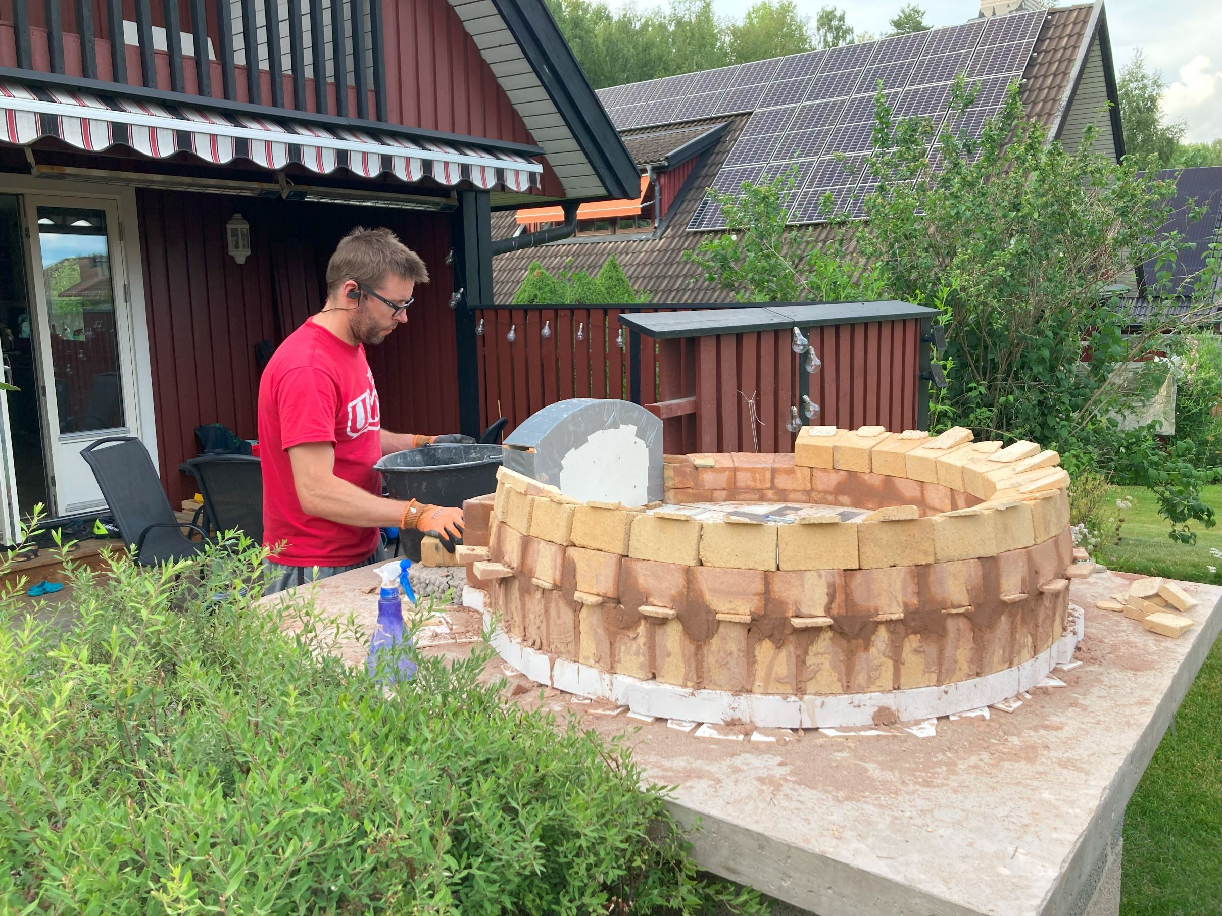

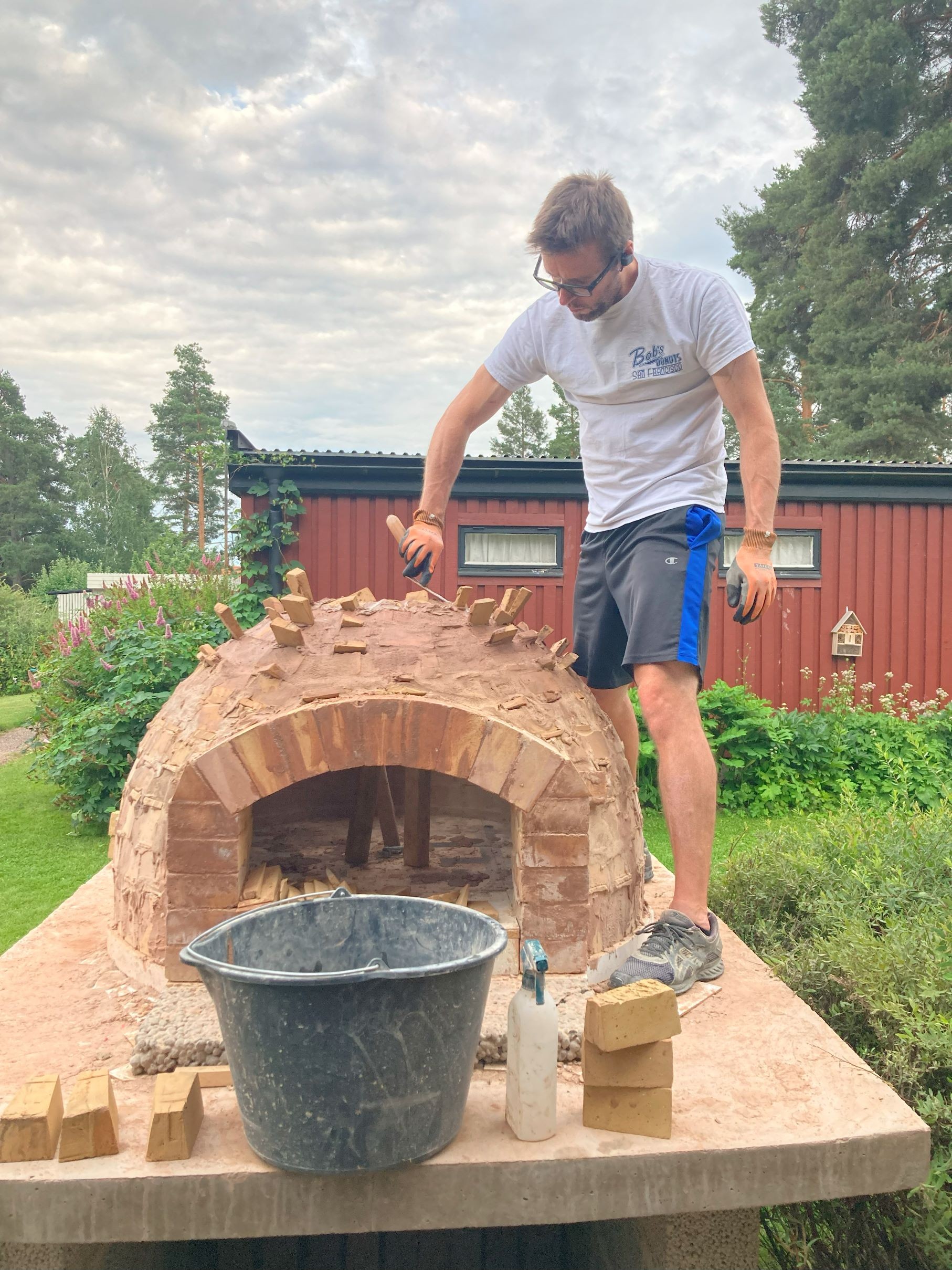

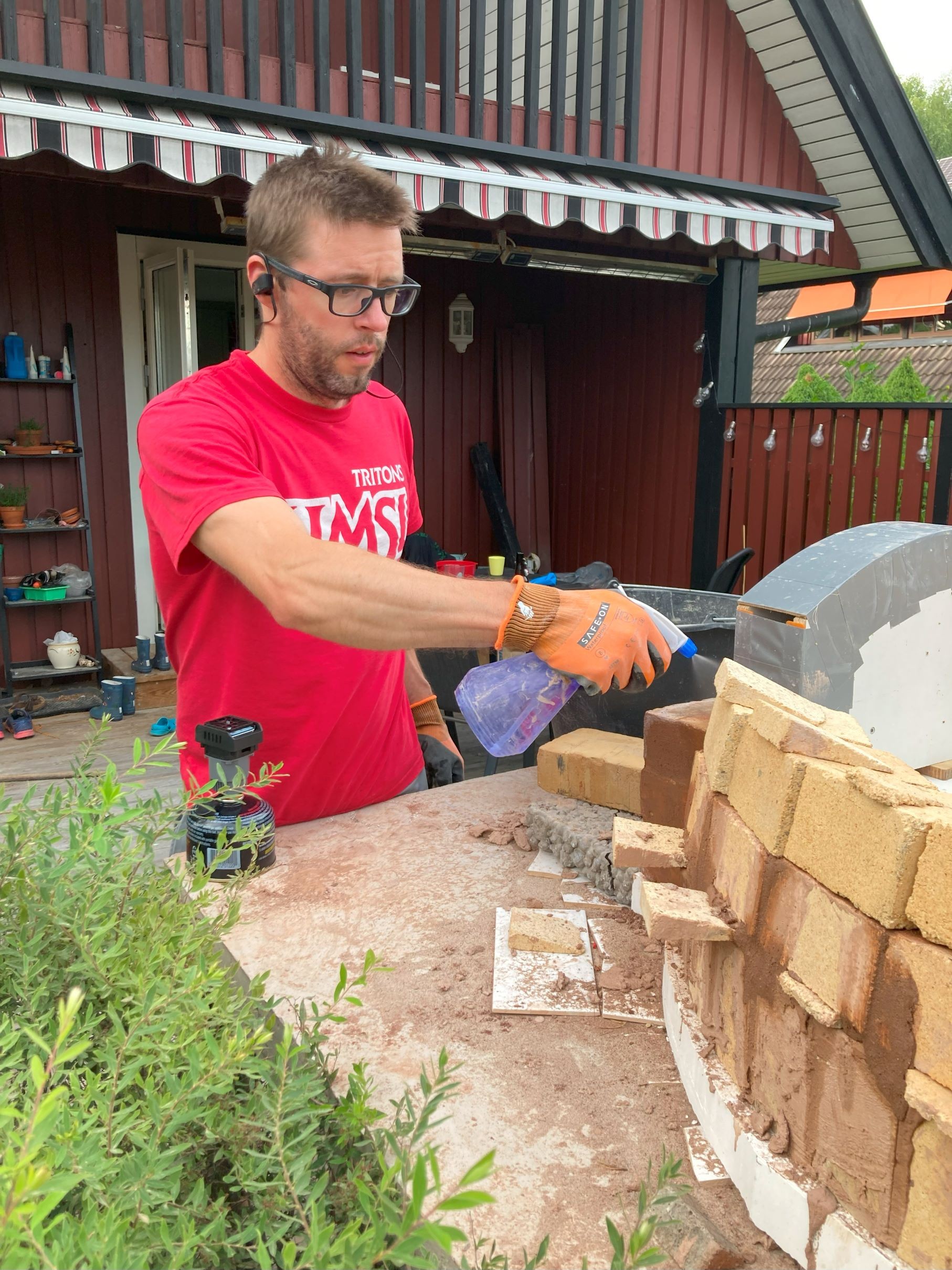

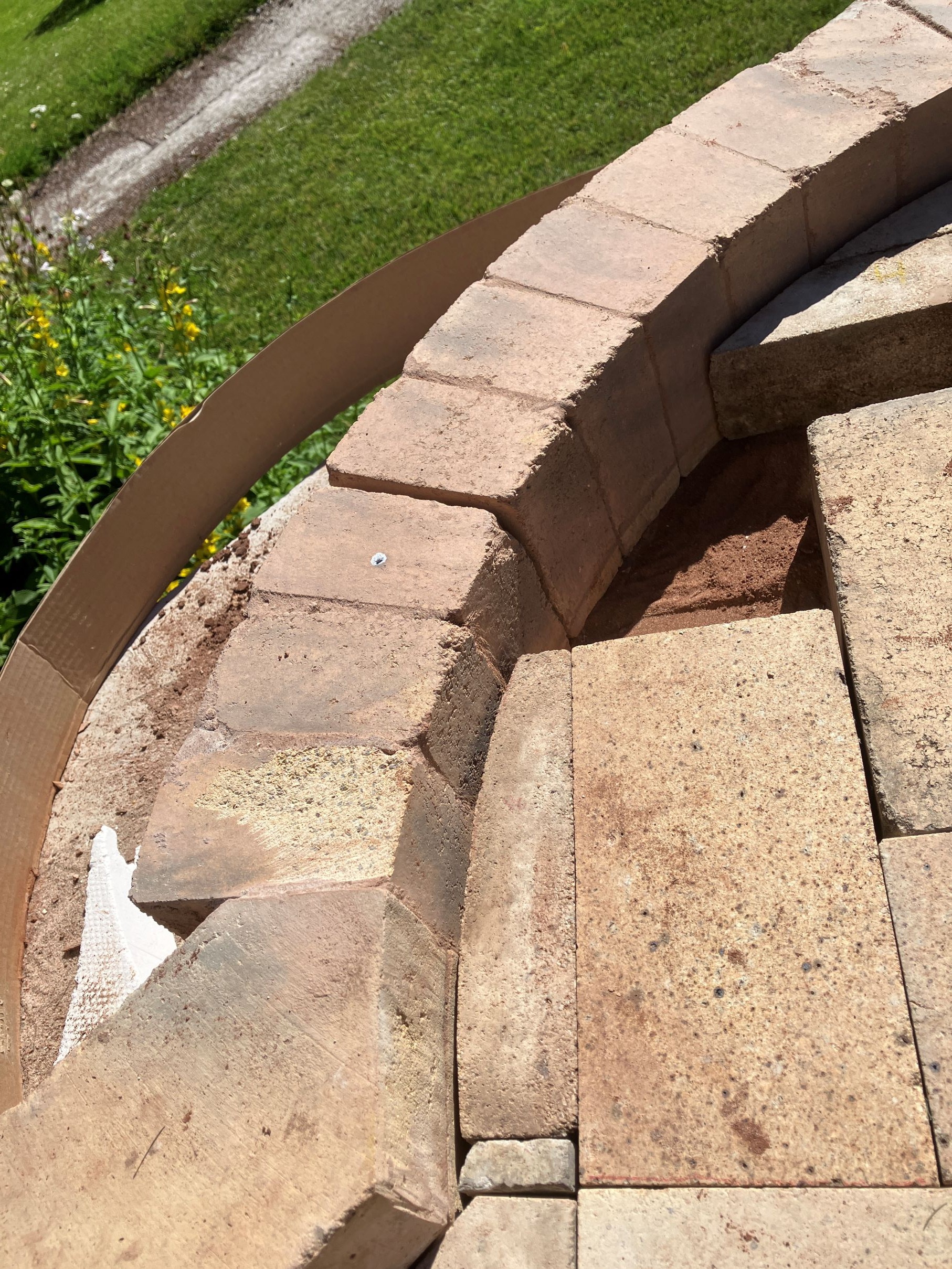

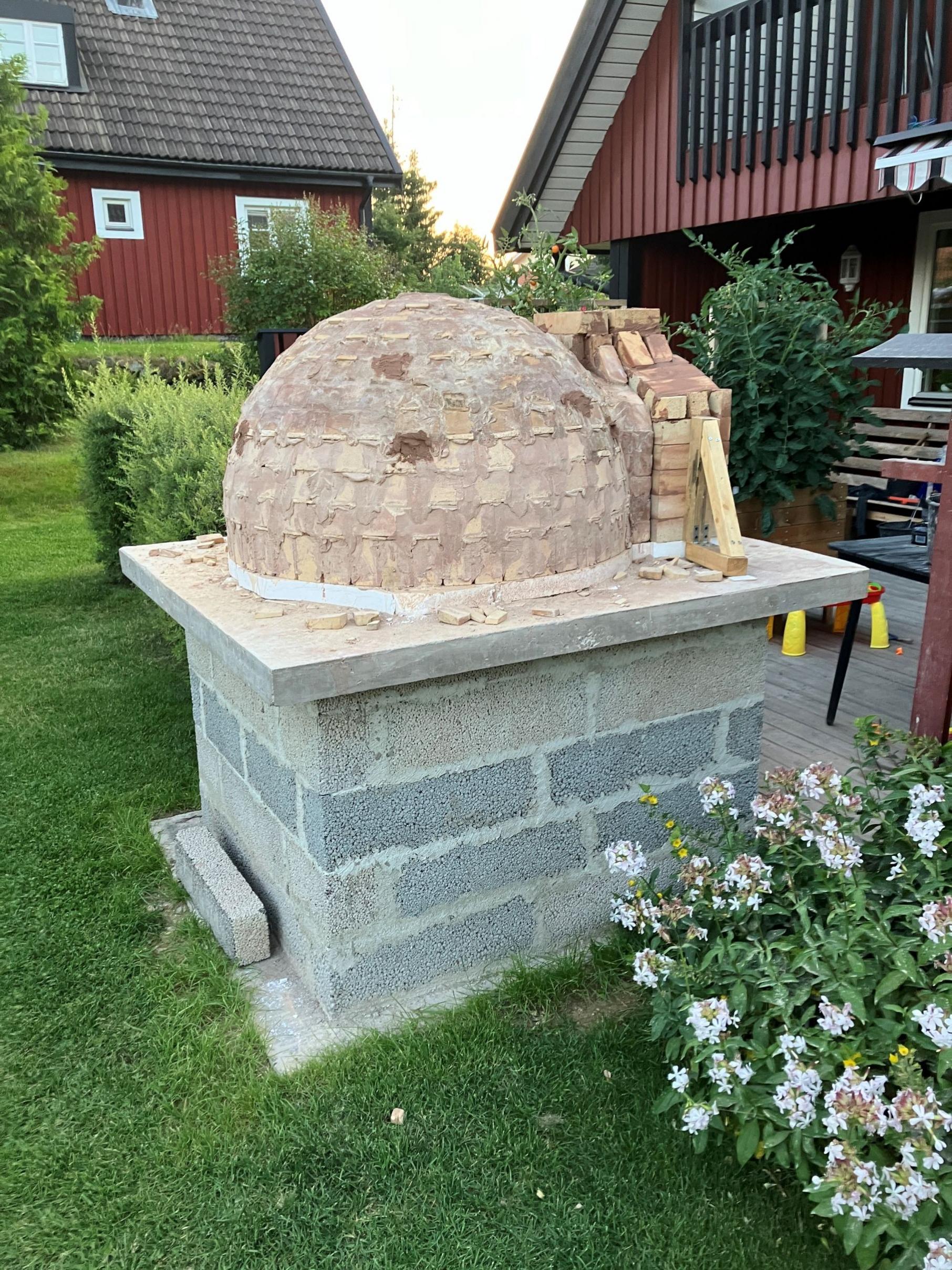

                  Alright. Next was casting the dome up on the half soldier course. As I said, I've never done masonry before and my half soldiers were kind of dirty. It was only after this course that I read more about it and realized I needed a damp sponge to wipe up afterwards. That made things much nicer.
                  I used the pompeii dome spreadsheet that you can find on this forum very easily. I looked through it and modified it based on my bricks. This is because I had multiple different sizes and types of bricks. Then, because I work as an engineer and have easy access to modelling programs like revit, I drew up many detailed to scale drawings of how the entire oven should look, how to cut each course of bricks, etc. I tried to be as accurate as possible.

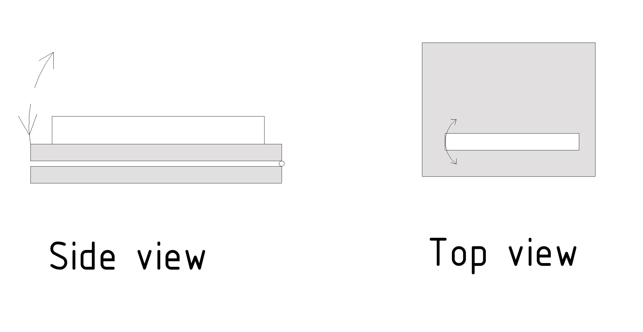

                  I used a cutting jig I've seen on posts here before. Two OSB boards screwed together with hinges. See my pictures below.
                  I said I made very detailed drawings. Well this doesn't really do much when:
                  1. You've never done masonry before
                  2. You've never cut bricks before
                  3. Your saw doesn't make cuts with the accuracy that you calculated
                  4. You have unpredictable sizes of mortart joints
                  5. Your bricks aren't completely square and even.
                  So even though I went through a lot of time and planning to make as detailed drawings as possible, that's simply not how it turned out. This bothered me a lot as I was building it, but now after it's done and I'm curing, I'm just glad it's done and that it works (so far).
                  So if you're like me and you want everything you build to be close to perfect, it's hard but you have to just let it go. I know. It's hard.
                  I used leftover pieces as shims in the back as almost everyone suggests. Even though my arch is completed and stable, I still don't know the best way to cut the bricks for a good transition between arch and dome. Mine required lots of mortar and awkwardly cut bricks. After cutting the soldier course I was skeptical I would have enough sand/dust from cutting to make enough mortar so I bought some fine sand to make up the difference. This ended up not being necessary. Once you're making three cuts per brick you get enough sand.

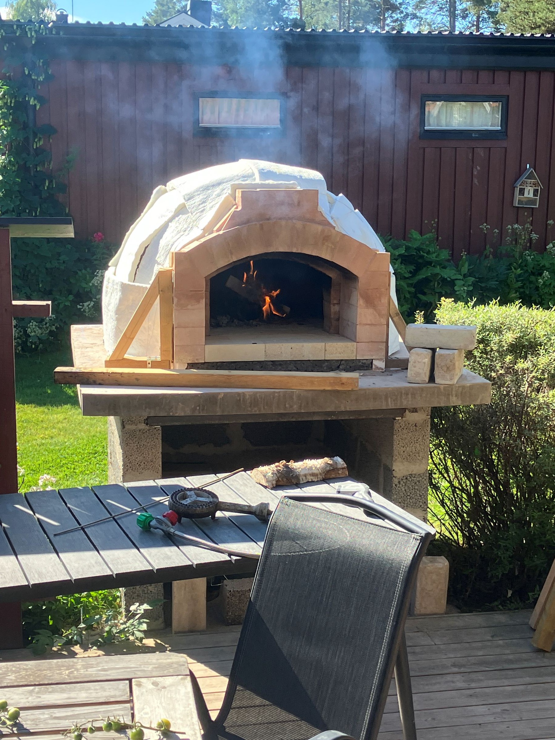

                    It took 3 weeks of working after the kids went to sleep every single night and I got the dome finished. Then just when you think you're done and tired of doing masonry and cutting bricks, then comes the entry vault and the chimney support.
                    I found a post on here of someone who built one in kentucky and he posted very nice detailed pictures of his entire process (unlike me). I thought his looked great so I followed the look of it very closely. It was this one: https://community.fornobravo.com/for...-kentucky-dome
                    Thank you very much Ken524. I wish I could have made my oven as seamlessly as your pictures make your process look.

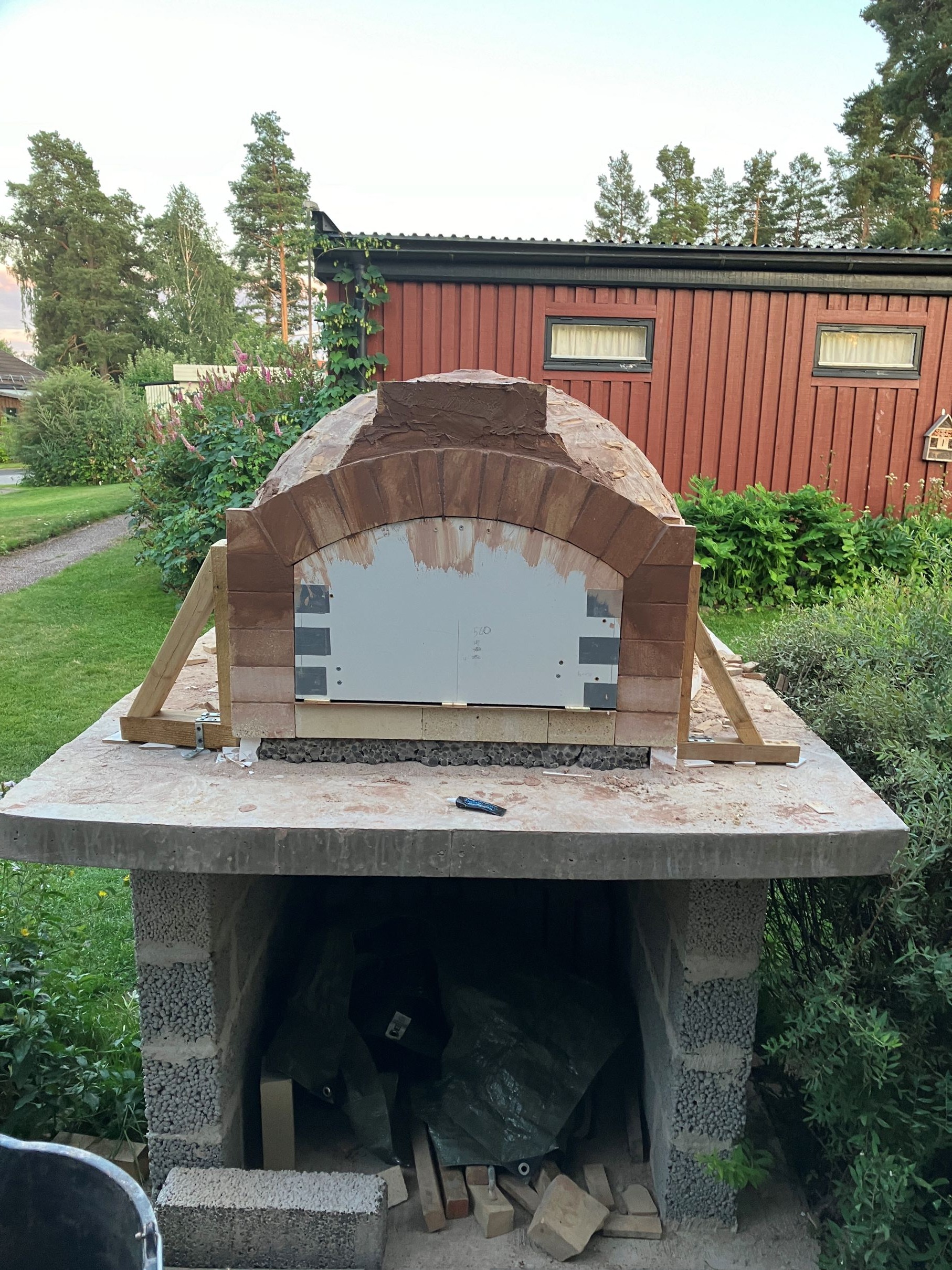

                    Now Ken had a vault that was wider in the front and narrower in the back, a flared vault approach that I felt made the oven look very open and accessibly. I did build mine this way, but figuring out the cutting, brick orientation, and general installation issues made me regret it. I think mine looks good (not as good as Ken's) but I wish I'd saved myself some trouble and just gone with a straight entry vault.
                    I built some simple wood buttresses to brace the entry vault walls as I have it completely separated from the dome, by about 10mm. I have som fire cord in the gap to close the air gap.

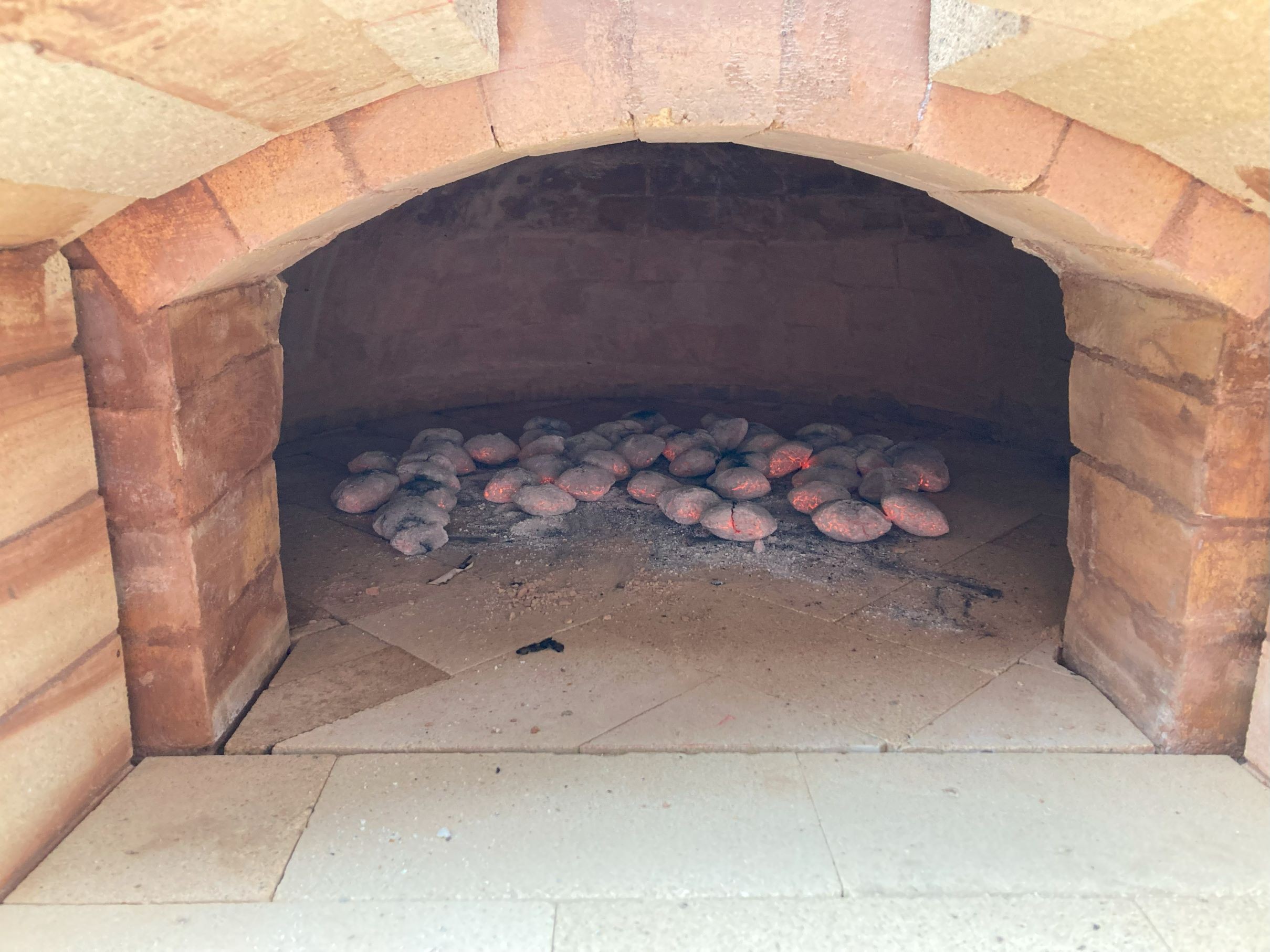

                    I've now put on about half the dome insulation. I'm doing the 300, 350, 500, 600, 700 curing process and am currently at the 500F stage. I'm working from home so I'll be able to hold the temps for a number of hours.
                    I'm going to build an enclosure around the dome as I feel it's a more water/weather tight solution.
                    Now my posting has caught up to where I actually am in the process. I will return later to show pictures of the final firing, the insulation, and the enclosure. I encourage anyone, especially Swedes, to contact me with questions if they wish. I did a lot of research on this project and I think I could help especially with material/sourcing questions. With the actual construction I'm skeptical you would want my advice.
