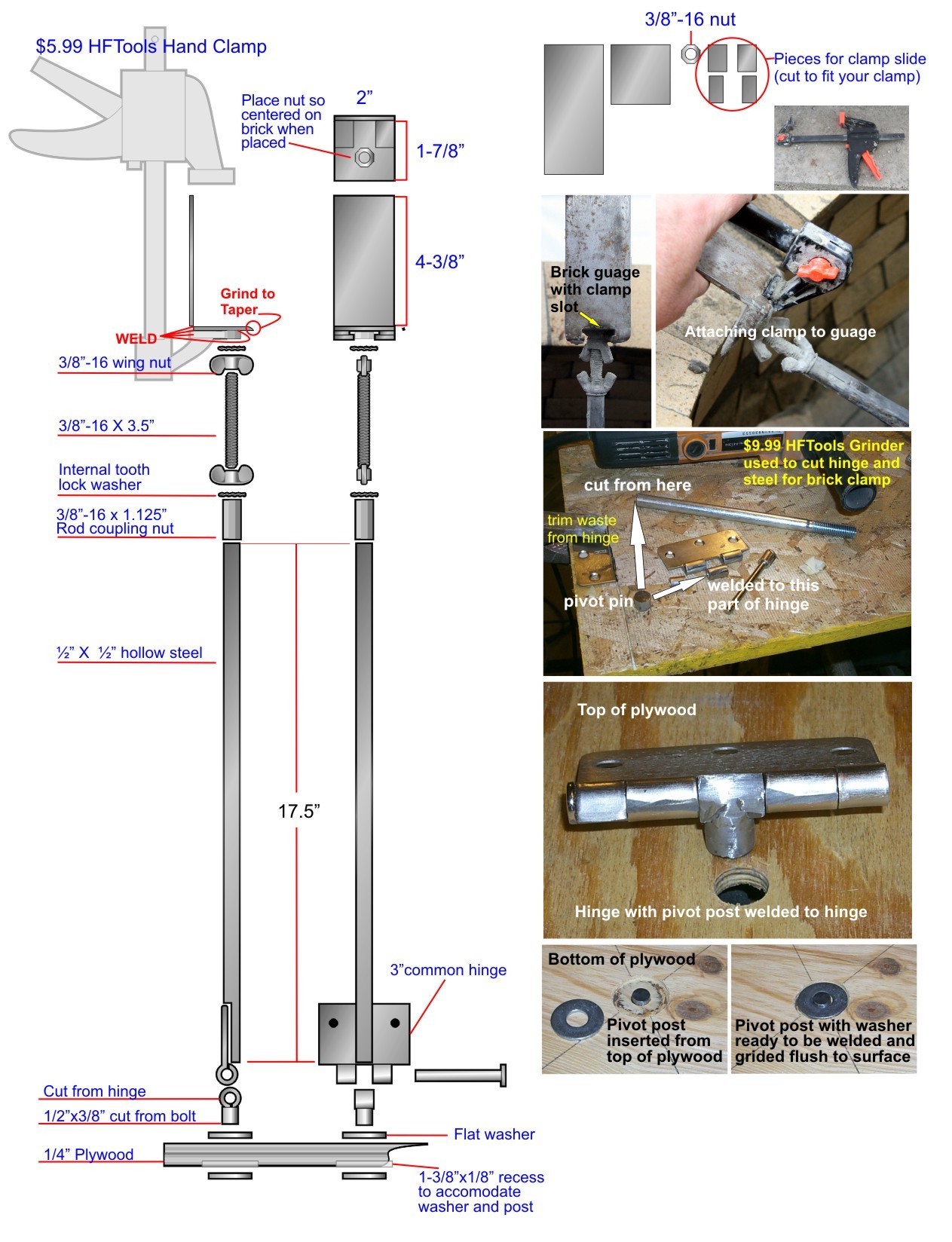

        There are a lot of variations in the build, brick size, mortar joint size, etc where having an adjustable IT is worth the extra effort. Attached in a set of plans from one our builders, there are also some not weld adjustable ITs out on the blog as well. Click image for larger version
