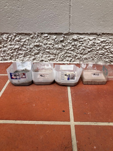

                I have made up the following mixes to test some stuff.
                (mixes by volume)
                1. 3:1:1:0.5 graded sand, hydrated lime, OPC, clay
                2. 3:1:1:0.5 graded sand, hydrated lime, grog, clay
                3. 3:1 graded sand, hydrated lime
                4. 3:1 grog, hydrated lime
                I will let the samples set and damp cure for a week before testing their strength.
                I can also fire some samples up to 500C in my kiln to see what that shows, although this does interrupt a firing schedule, opening the kiln, then refiring at a vulnerable temperature stage, so will see what the strength tests reveal first.
                There is also a time factor using the carbonation of lime to create the reaction, that a week of curing may not reveal, maybe it takes months. I think it's something like 3 months.
                https://www.buildinglimesforum.org.u...at%2090%20days.
                Thanks for sparking my interest in this topic. I think that the homebrew recipe, being around for so long, must have had the testing and tweaking of many variables over the decades (my own included) to arrive at its current formula, so don’t expect miracles.
                I think there's a better case for adding some burnout fibres to any type of oven or kiln mortar to reduce the problems of steam spalling. Because of the large variation in thickness of the mortar joints this problem becomes greater.
                Click image for larger version  Name:	IMG_1726.jpg Views:	0 Size:	115.7 KB ID:	465150

                        See mixes 2 and 4 as well as the additional one I made of 1:1 hydrated lime and powdered clay (mix5)
                        I just made a Mix 6 sample of 4:2:1 graded sand,hydrated lime and grog as per your reques to add to the others.
                        The lack of either clay or OPC in this mix made it almost unworkable, but we shall see how it sets. Workability for both castable mixes and mortars is a very important quality in regards to placement.
                        I'm most interested to test the results. What do others think?
