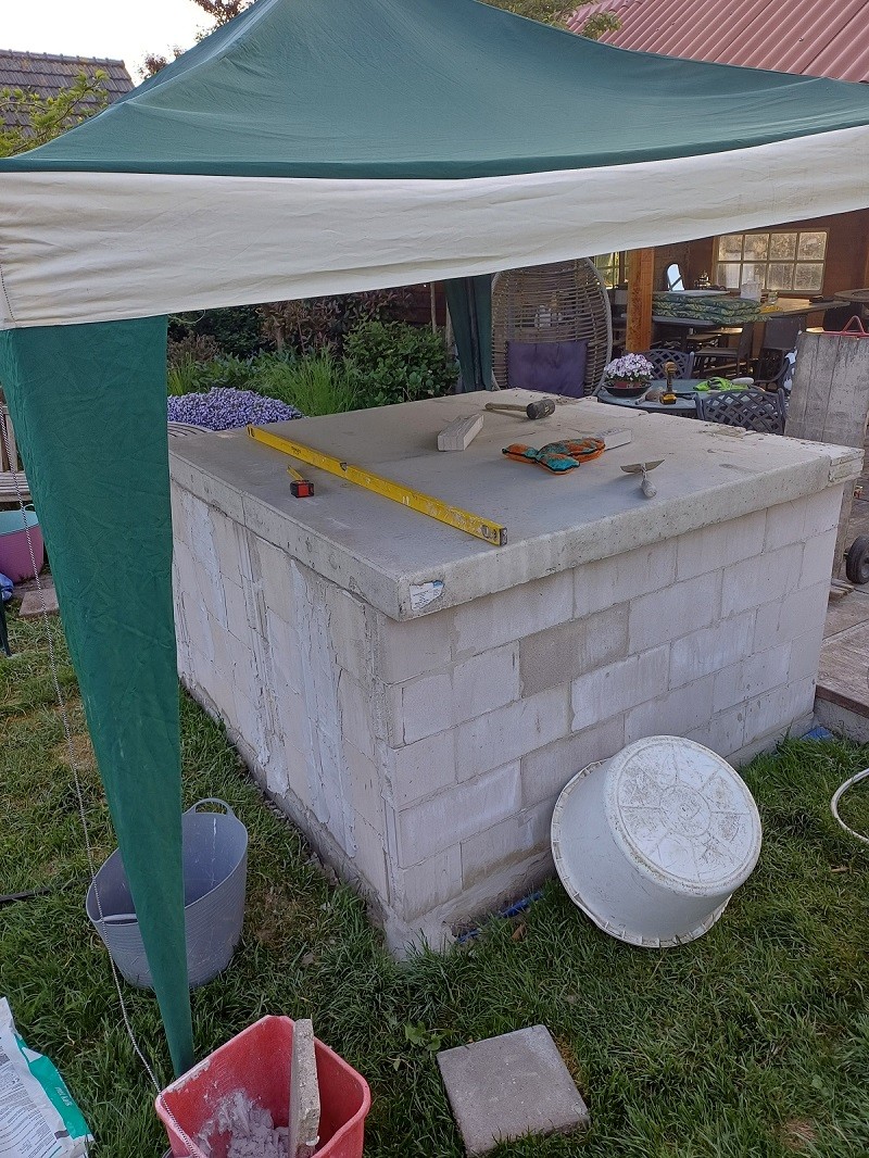

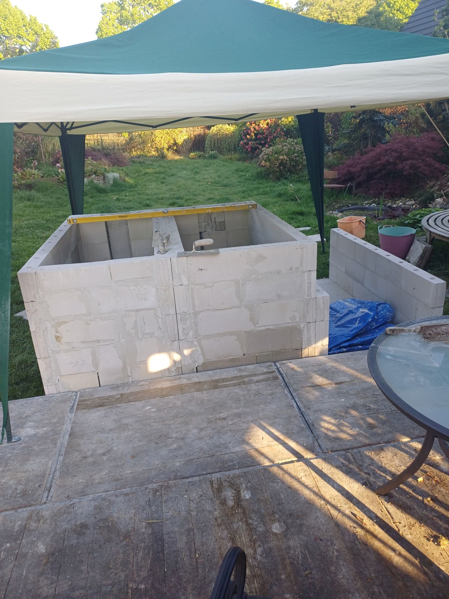

    Hello, I am building a neapolitan oven. It is my second one.
    I have poured the foundation and put sand-linestone walls on it.
    Tomorrow I will get 3 slate's front 2x1 meter and 12 cm thick.
    We have a mini shovel and use it to place the slat's.
    They brought the slate's they were only 40€ each. I have got them on the walls and can start with the oven build. Click image for larger version  Name:	platen erop.jpg Views:	0 Size:	329.0 KB ID:	465619

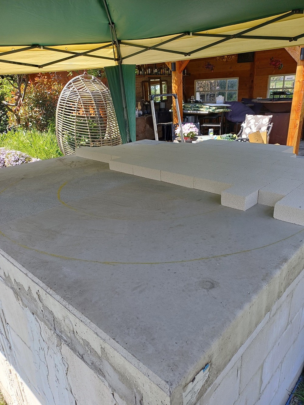

            Another one, I have for 12 years 100 isolation stones lying here and want to use them.
            What is better, first fireclay than isolation stones and than the pizzafloor or first isolation stones than fireclay and than pizzafloor. Click image for larger version
Name:	vuurvaste stenen.jpg
            • #7
              Clay is really only needed as a leveling medium in either case, isolation bricks or oven floor bricks. The hearth looks really flat and the isolation bricks look like they are laying very flat.
              • #8
                That is right, it is all very flat. They are laying loose on the floor, must I glue the outside one's or just go on laying the floor.
                • #9
                  You can lay the insulation directly on the hearth slab and the cooking floor directly on the insulation, no adhesive or mortar needed. The weight of the oven will hold it all down.

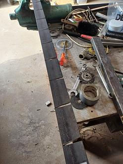

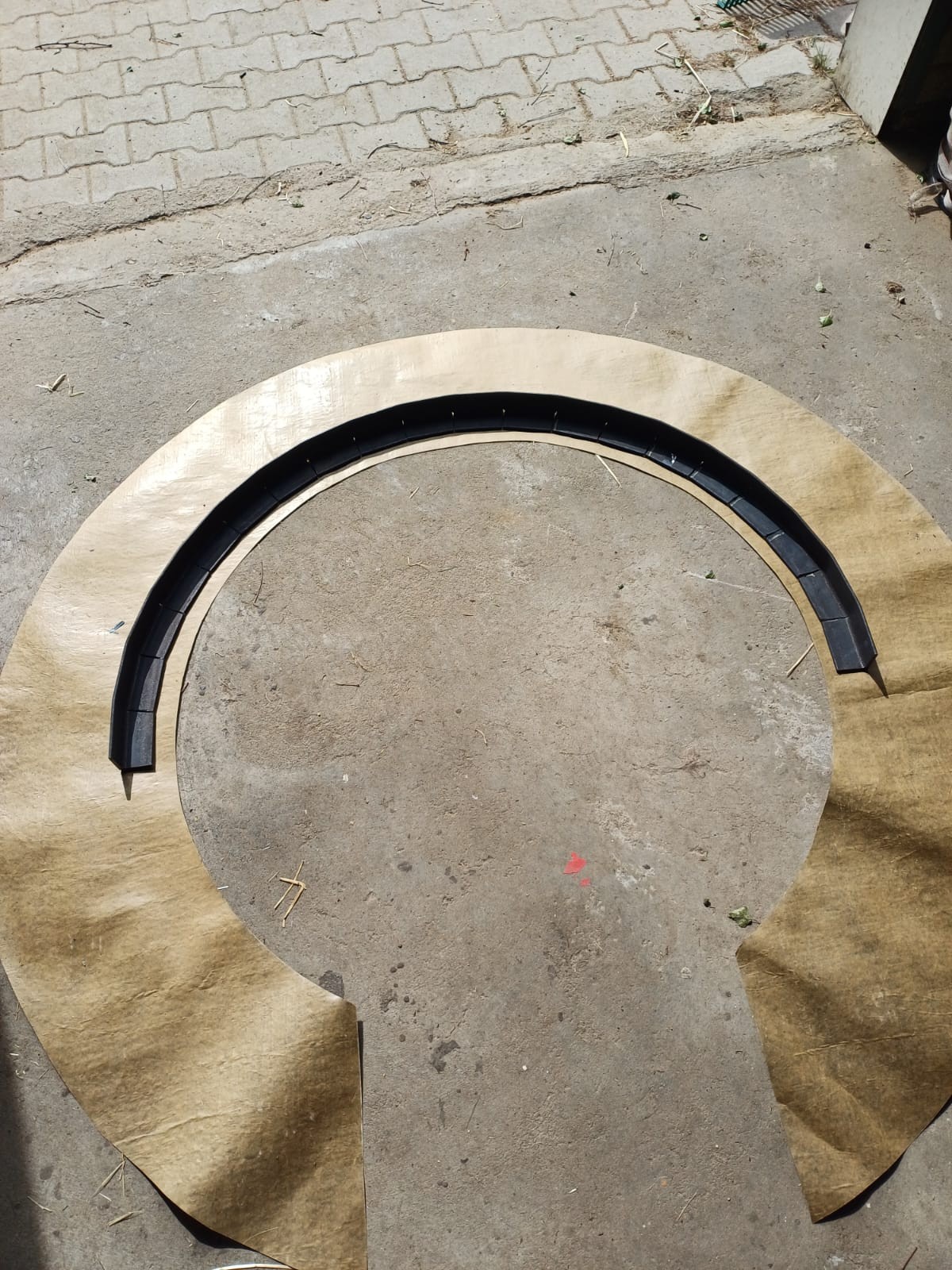

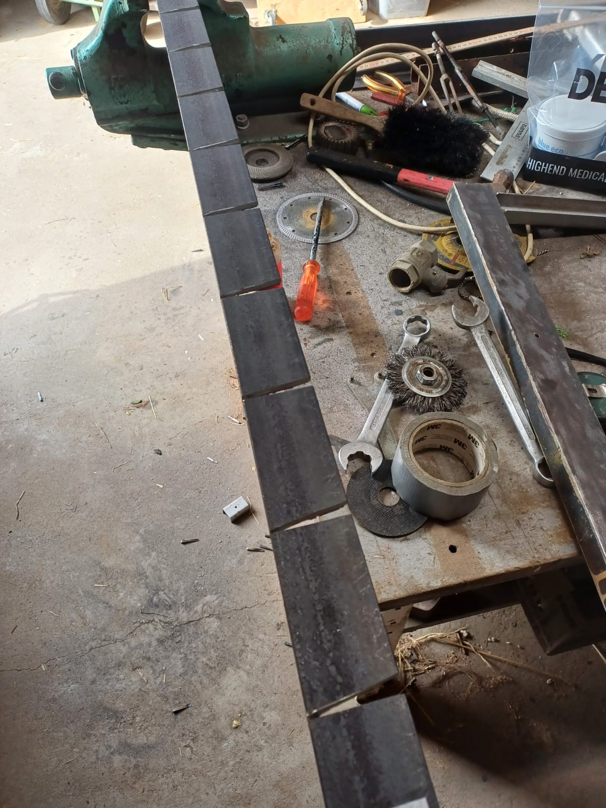

                            You are right, I will clean the iron from the sink coating. When you weld sink you get these white feathers floating in the air. I take the risk of a crack around the door, there must be a vertical hold for the metal band around the soldiers. I thought all or most neapolitan ovens have a metal band on the soldiers to take the forces from the low dome.
                            • #15

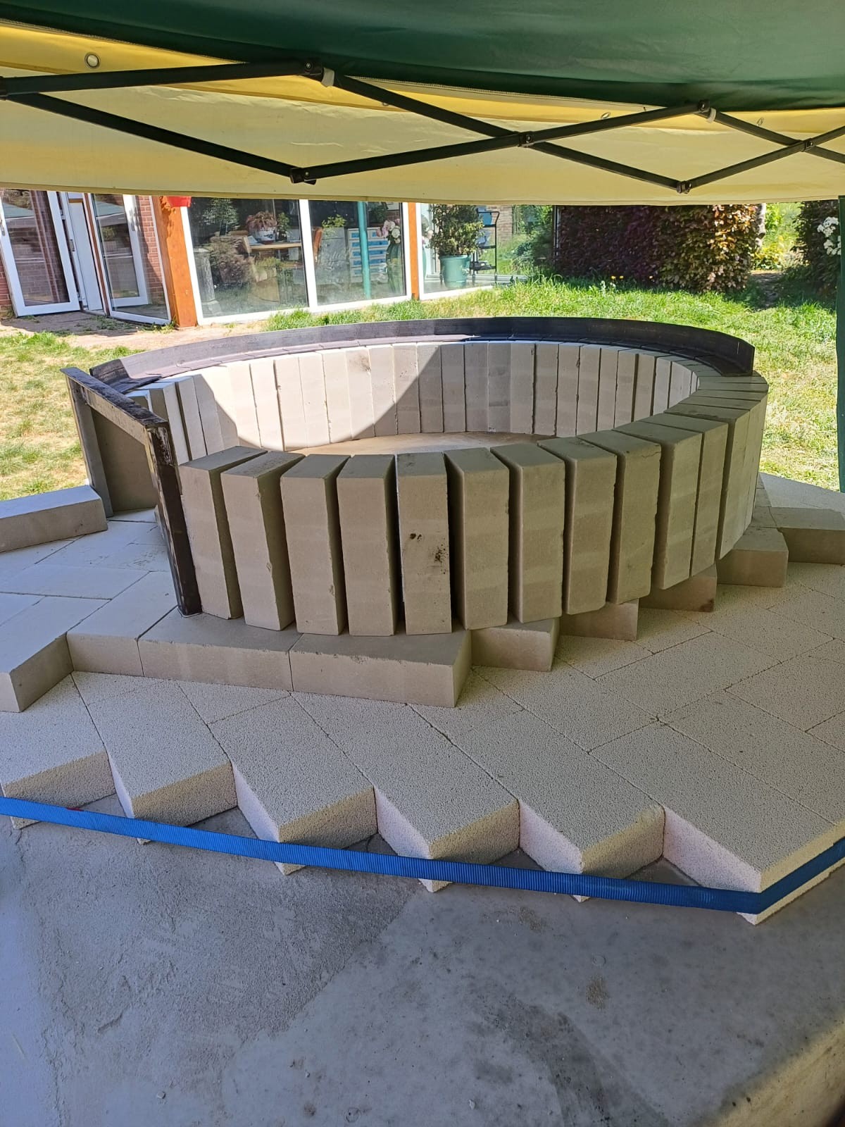

                              Yes, my bricks aso are in. Layed the floor and the soldiers so I can bend the support for the first ring. Went OK. Click image for larger version
ID:	465831 Click image for larger version
ID:	465832 Click image for larger version
                              Tomorrow I will try to place the soldiers and than let it harden for one day and then place the ring on it and weld it together.
