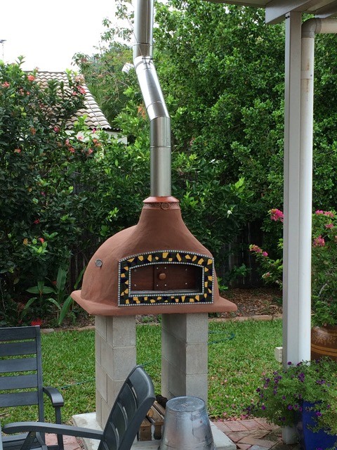

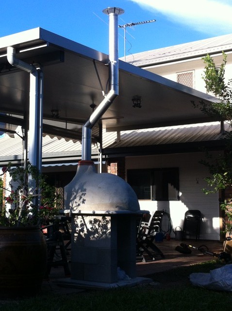

    It is recommended that any bends do not exceed 45 degrees, but I have seen plenty that go to 90.
    I've done a number of ovens tucked under the eaves like this which gives the operator complete cover, but the oven with its bum sticking out in the weather. Advantages: no roof penetration, single flue only required.
    Disadvantages: some folk think it looks odd
    I believe that function and performance always trumps appearance, some disagree.The extra height increases draw to easily compensate for the restriction of the bends, while the roof provides a good anchor point to support the tall flue. The flue exit should be 600m (2 ft) higher than the roof and the pipe at least 50mm (2" away from the gutter or facia.
    Click image for larger version  Name:	oven .jpeg1.jpg Views:	0 Size:	133.5 KB ID:	466013 Click image for larger version  Name:	oven.jpeg2.jpg Views:	0 Size:	79.1 KB ID:	466014
