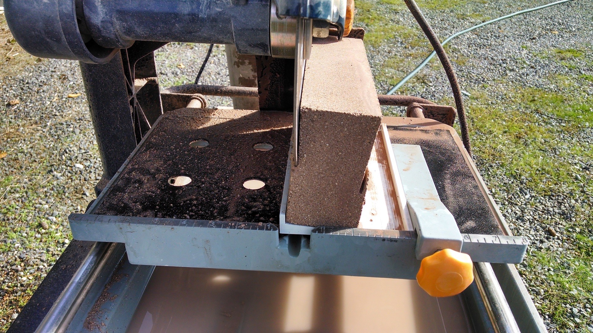

          Those tapered bricks look amazing. I don't think my wet saw is nearly big enough to cut in the 4-1/2 inch brick direction, so I'll have to go with wedges in my mortar joints. I do want to figure out how to make a nice oversized keystone for the top of the decorative arch, though
            You can cut part way through and then turn the brick over and cut from the other. It will probably leave a small section in the middle that is not cut entirely through, but a light tap will finish the job. I have done it free hand. However, clamping an angled guide to the tile saw will make things much easier.
            • JRPizza
              • Jan 2012
              • 1557
              I tried to walk through the process of cutting the arch bricks in my build thread - it was really not that hard and I think the look is worth the trouble. I had to flip the bricks over but was able to cut them all the way through in two passes. Just cut them all from one side, then adjusted the jig and did teh second pass. I also used the same angles for the inner and outer arches.

                JRPizza I read through most of your build thread this evening to figure out how you cut the arch bricks. You show in post Adding a smoker a 3D printed jig for cutting your vent arch bricks. Did you also use same approach on your dome/inner arch bricks? The photos in post #42 show them clearly tapered.

                  My tapered arch bricks first appear in post #24 and I mentioned my angled shim in the post before it, but I don't show the shim/jig until post Adding a smoker I had so many things going on that I forgot to show it early on.
                  When I got to the bigger vent arch I figured out that I could use the same angle jig as I used for the inner arch - are the angles perfect, no, but it was close enough so the same angles on all the arches worked for me. I think I just added a brick or two (you would have to count in the pictures) and it all worked out. The keys to my jig were having the right angle for the narrow side of the brick to sit on so I could cut the taper, and a lip/stop so I could index the edge of the brick against to get repeatable cuts. I apparently lost the file I used to make my 3D print in a computer crash or I would send you a copy. I do have the angles (I think) somewhere if you want me to dig them out. I also have an arch angle spread sheet somewhere.
                  I cut all my bricks in the full 9" length. I found it easier to work with longer bricks - more to hold on to and easier to control. I trimmed them to appropriate length after tapering.
                  One thing I mentioned and found critical - some of my bricks did not have narrow sides that were 90 degrees to the wide side, the cross section was a parallelogram, not a square. I had to sort bricks with a square so when I had the narrow side against the jig I got uniform cuts.
