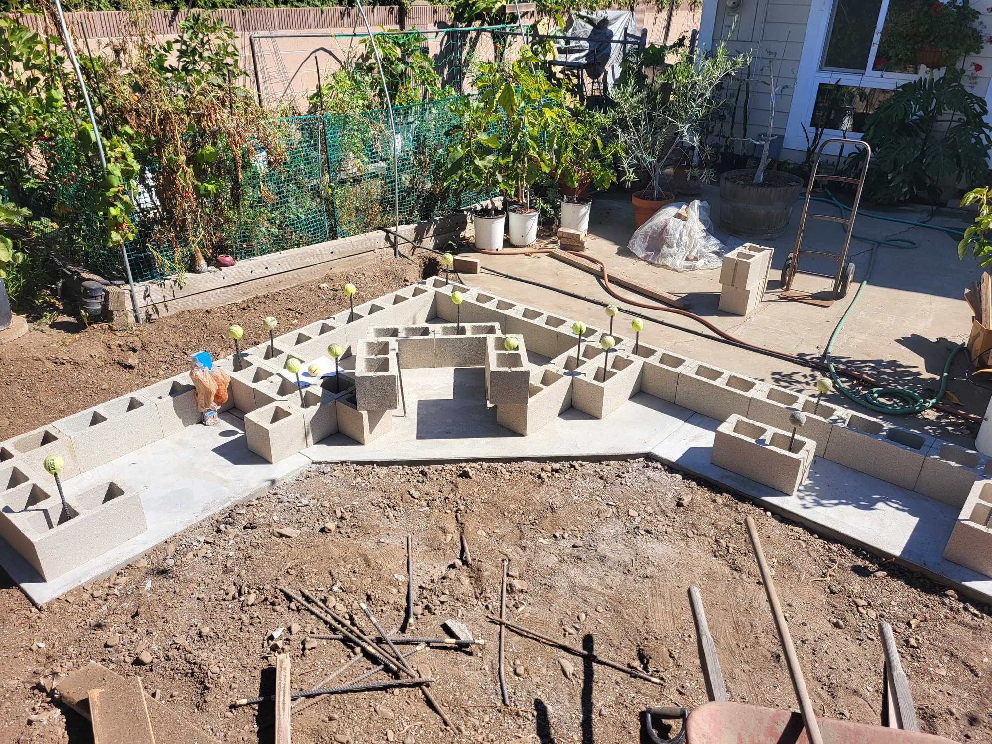

    It's been almost a year I've been working on this oven build, so I figured it's time to create a build thread to keep track of things and let you kind folks see what I'm doing. The goal is to build an L-shaped structure towards the far back corner of my 1/4 acre suburban lot with the oven in the corner of the L, with the opening towards the inside of the corner. To the oven's left is a prep counter and to the right is a bar-height counter for folks to sit on the far side and at the end. The dimensions of the two counters are to take advantage of leftover quartzite slab material I have from a kitchen remodel. I started with a 6" concrete slab over 2" of compacted road base, all dug out with a pick axe, as the ground here is ~20% river rock held together by silty loam, undisturbed since this was an orchard in the 1950's. Since we're in earthquake country and the thought of several tons of masonry falling on family or friends haunts me, I hooked several L-shaped pieces of rebar under the slab rebar to tie the vertical structure to the slab reinforcement. There are two pieces of conduit for electrical to power a refrigerator under the prep counter and an outlet (phone charging) next to the bar seating. I'm dry stacking 8x8x16 CMUs for the structure. The second photo shows the initial layout . We got in a rush at the end of the corner slab pour, so a few pieces of vertical rebar ended up in the wrong place. I don't think anyone will notice them cut off in the wood storage area.

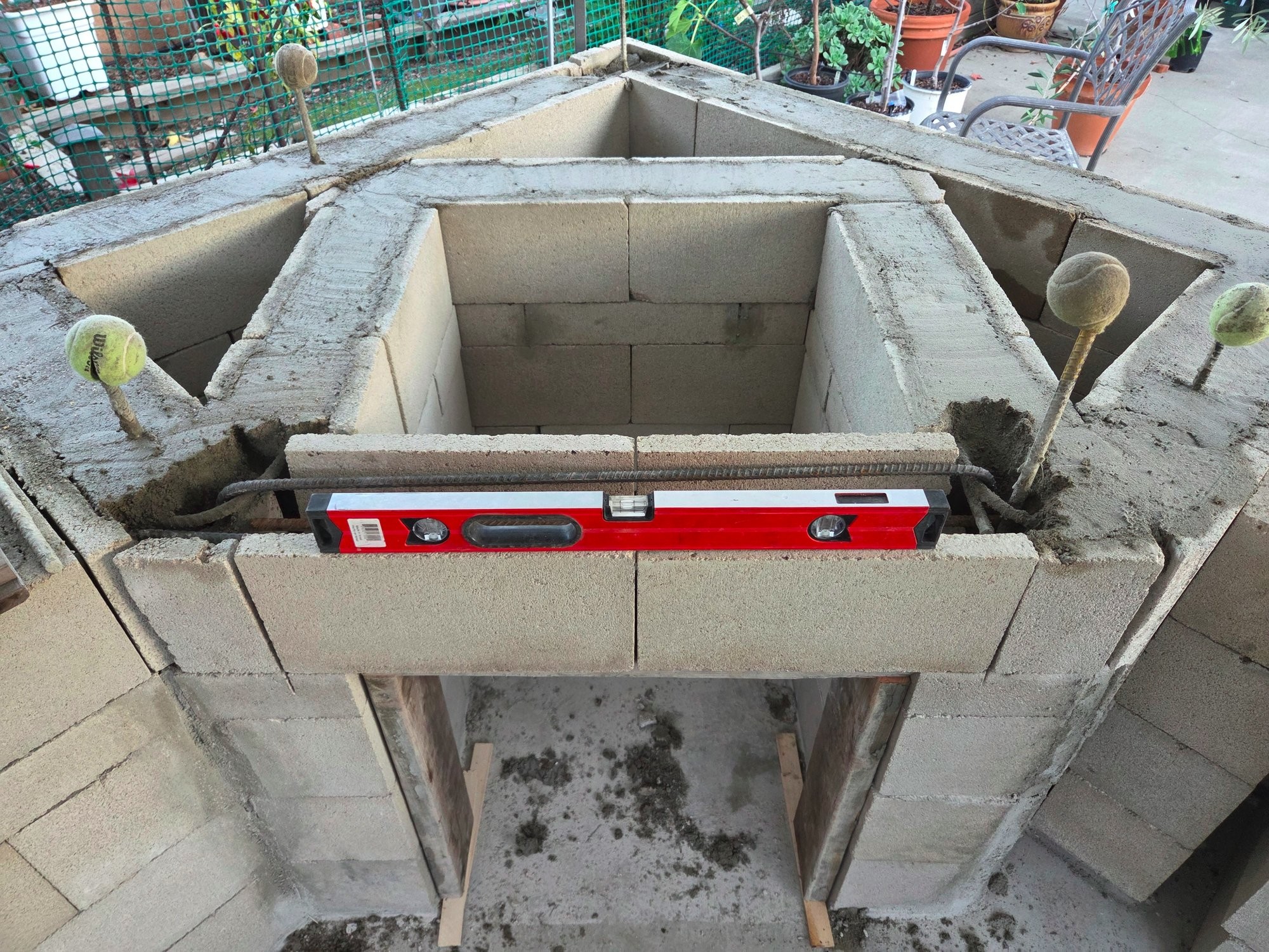

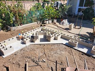

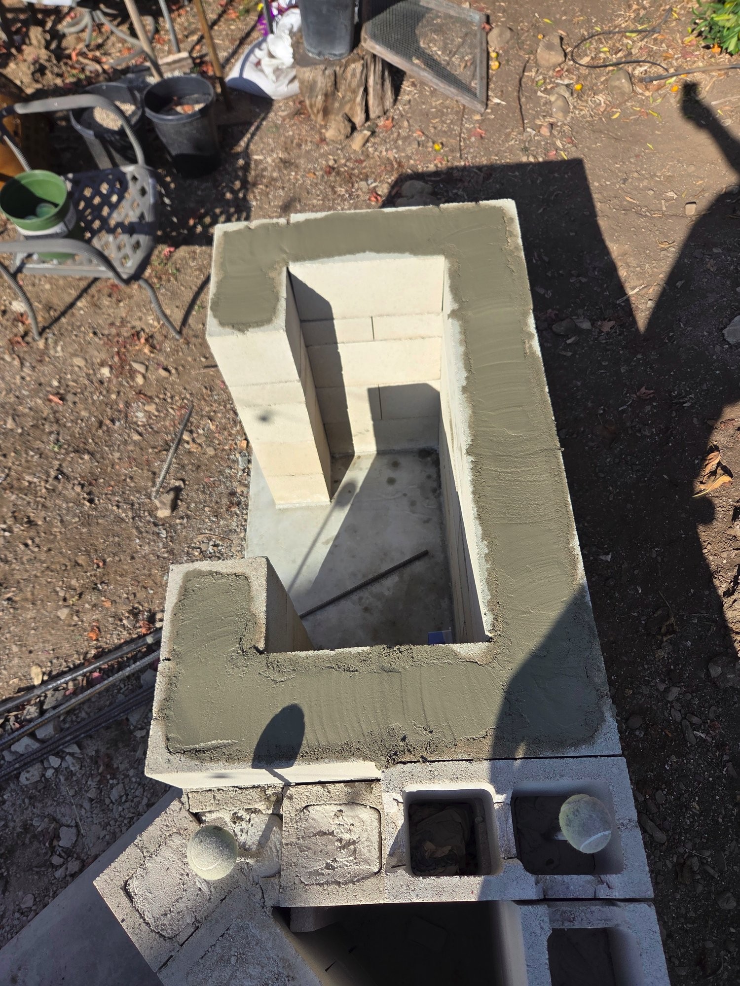

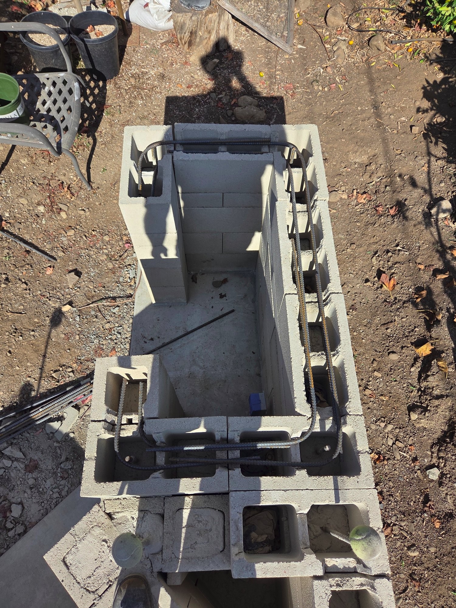

    The prep counter is farthest from view of the guests, so I started there to get my learning curve taken care of. Every other vertical cell got filled with grout, adding extra when needed for corners or vertical rebar. Half a 5-gal bucket is about all I like to carry/pour. A bond beam on the top course ties everything together for shear loading. I will eventually cover it with HardieBacker cement board bedded in mortar to support and level it, secured with TapCon screws into the grout, then polyurethane construction adhesive will hold the quartzite in place. This is one place on the property the termites won't get to! If you are thinking of getting a diamond blade for your grinder to cut your CMUs, the segmented one makes a world of difference for cutting speed and still gives perfectly acceptable finish since it will all be under stucco anyway. Wear your respirator, silicosis is no joke.

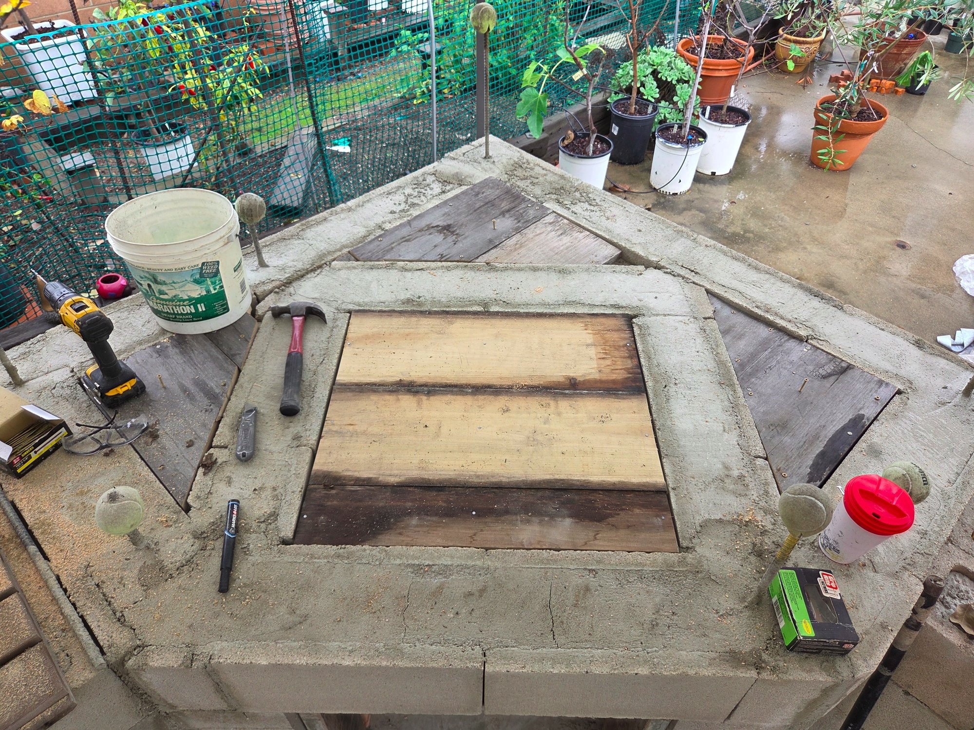

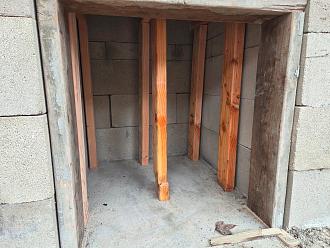

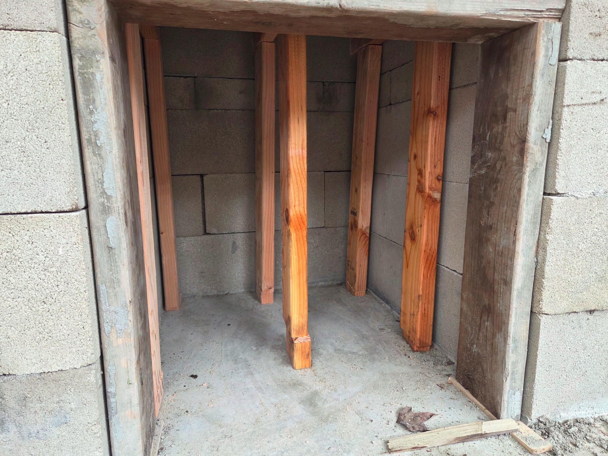

      While the prep counter will get an angle iron lintel to clear the refrigerator height, the oven and bar are higher and will get CMU lintels. I plan to put a decorative brick arch on the wood storage area to match the decorative arch on the oven. There were three triangular areas that got closed off under the oven. I thought about installing a time capsule but other priorities won out. The slab on top of the oven CMU structure is 3.5" of rebar-reinforced concrete topped with a 42" diameter ring of 4" thick vermiculite concrete for a brutalist-inspired total slab thickness of 7.5". Thanks to those who have gone before me for the reminder to shim the legs of the slab support so they can be removed easily. I foolishly added a curved area to the front of the slab which created issues with room for my arches and landing area. I also added a 3/4" chamfer to all edges just to make things more complicated.

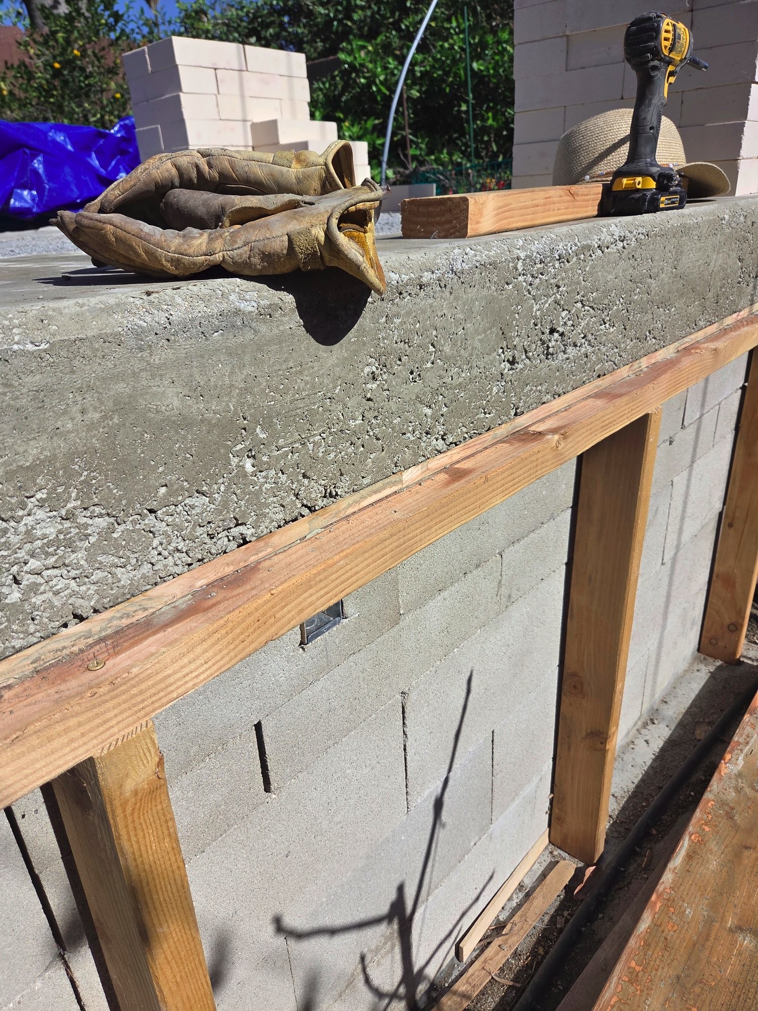

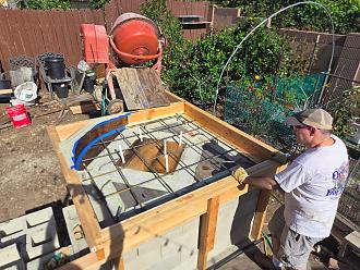

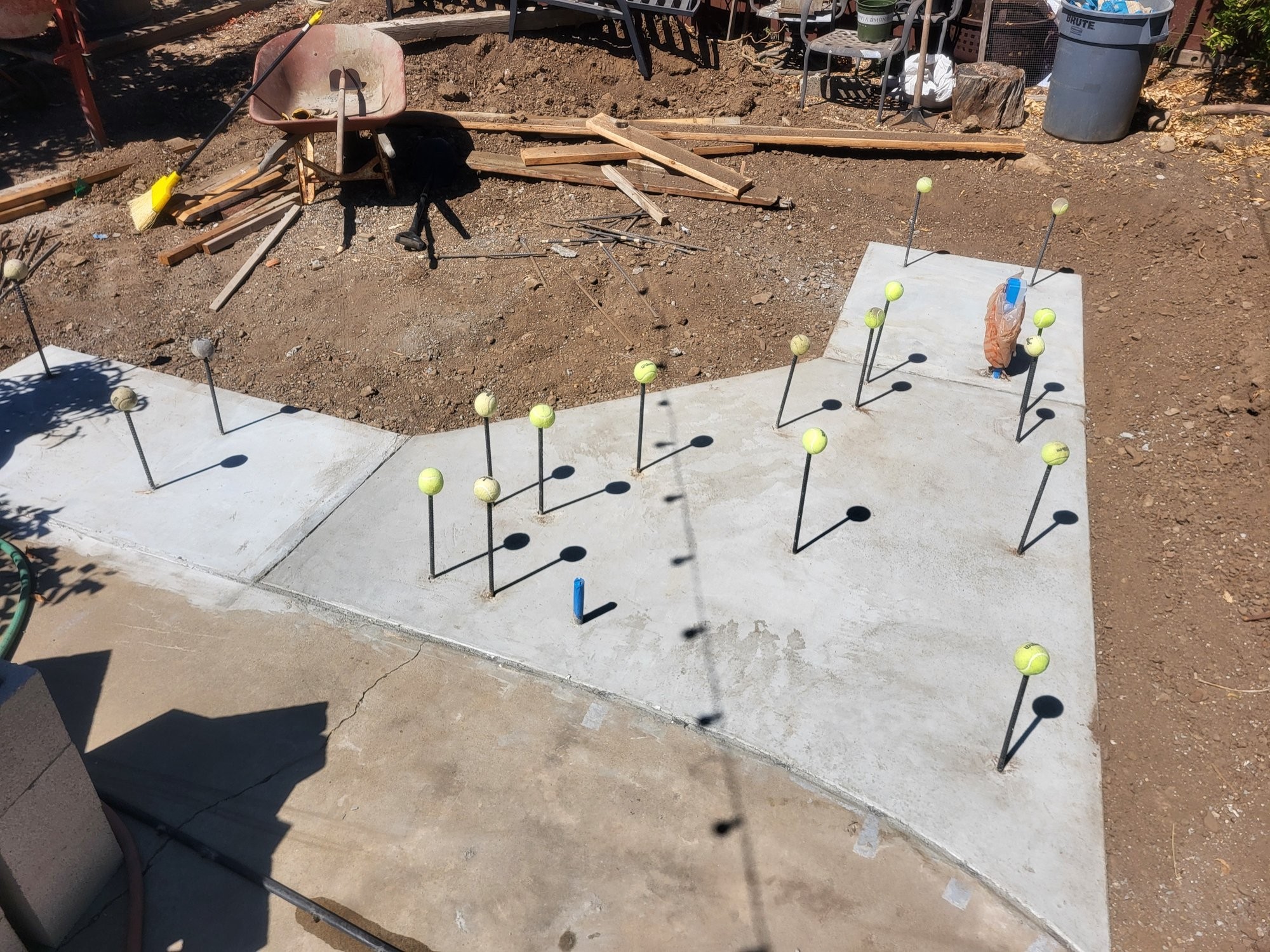

      The slab forms have a 2" reveal from the exterior wall of the CMUs to allow 1" for stucco and a 1" final reveal. This allowed me to screw the vertical 2x8s to the lower horizontal 2x4s to prevent the form from bowing. A 2x2 on the top exterior rim kept the upper area from bowing out. It was ~1/4 below the top of the 2x8 to not interfere with screeding the slab. Five 1/2" PVC drain molds were held by blind holes in the plug covering the wood storage area. No release agent was needed to remove them, just a pair of vice grips to twist out of the vermicucrete.
      Click image for larger version  Name:	20251228_163621a.jpg Views:	0 Size:	969.4 KB ID:	469645 Click image for larger version  Name:	20260102_111522a.jpg Views:	0 Size:	858.7 KB ID:	469647 Click image for larger version  Name:	20260102_111518.jpg Views:	0 Size:	1.10 MB ID:	469648 Click image for larger version  Name:	20260125_121917a.jpg Views:	0 Size:	960.6 KB ID:	469649

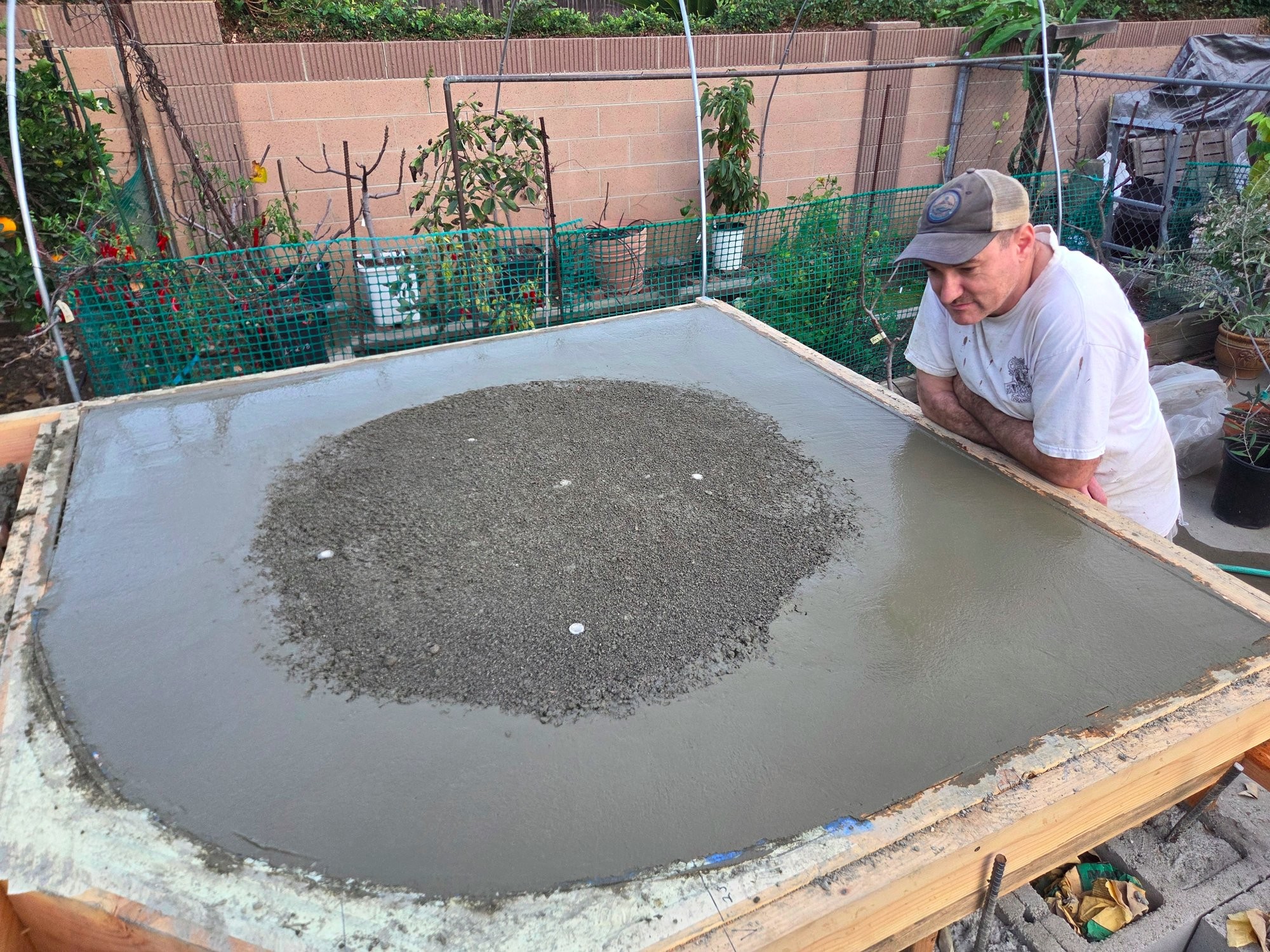

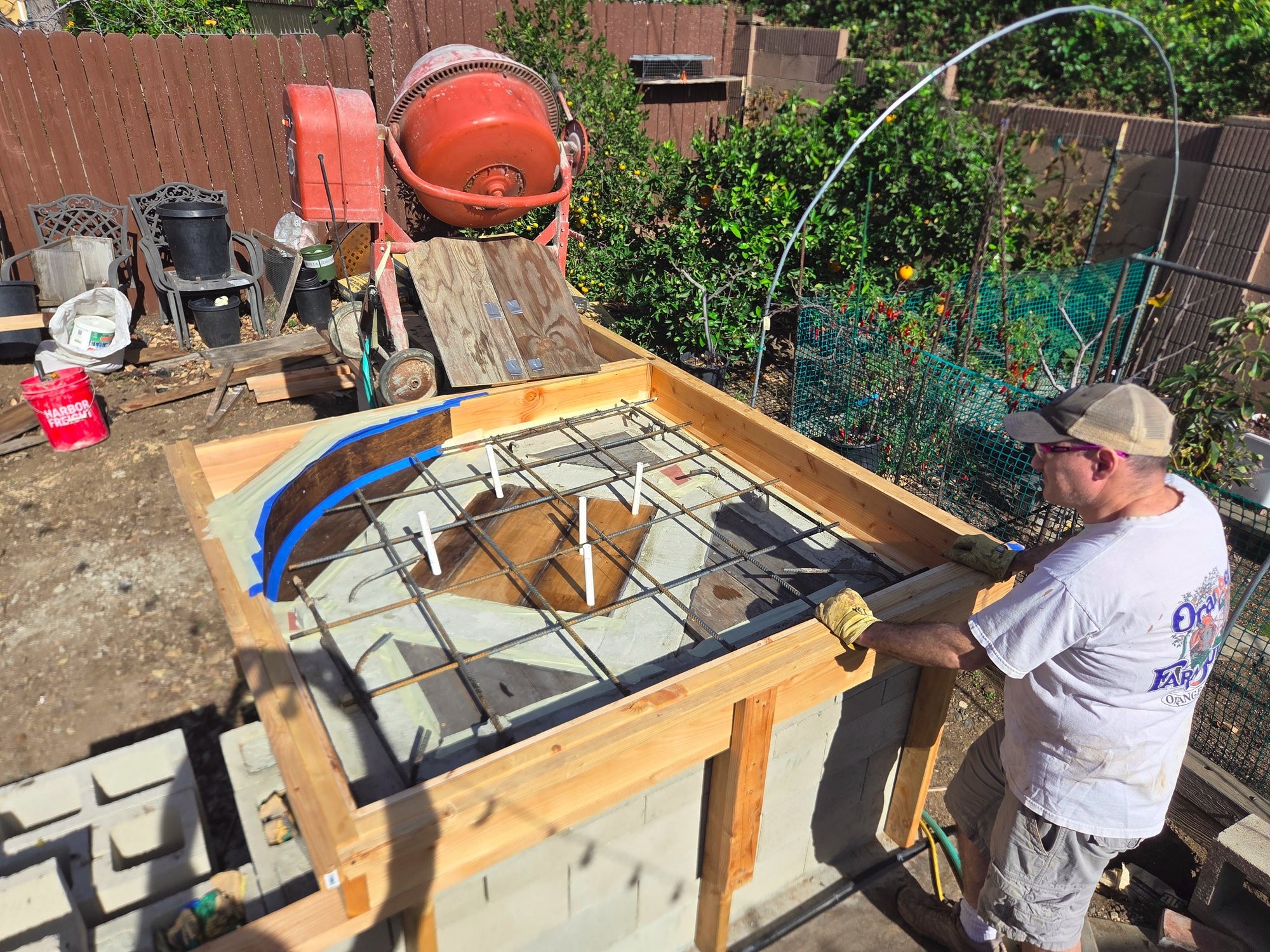

        I have lots of ideas, most of them bad. One good thing I did was place the cement mixer on top of the prep counter so it could pour directly into the form instead of lift each pound of cement twice. Ratchet straps held it firmly in place to the pallet I nested into the CMUs. I already carried it from the shelf in Home depot to the cart, from the cart to my car, from the car to the wheelbarrow, from the wheelbarrow to the back of the lot, into the mixer. One less lift for my old body. Thankfully my buddy from New Jersey was in town and was able to help me with the pour. Unfortunately I did not vibrate the concrete next to the form well enough and got a terrible finish on the edges. For the slabs I used a DIY vibrator of a slightly bent piece of #4 rebar chucked in a drill motor and set inside a piece of iron pipe. That consolidated the concrete beautifully. For the oven upper slab I used a jigsaw with no blade on the sides of the form, but it was not enough. I should have whacked it with a rubber mallet as well. Oh well, the good folks at r/concrete suggested Sika 123 Plus as a fix for that.

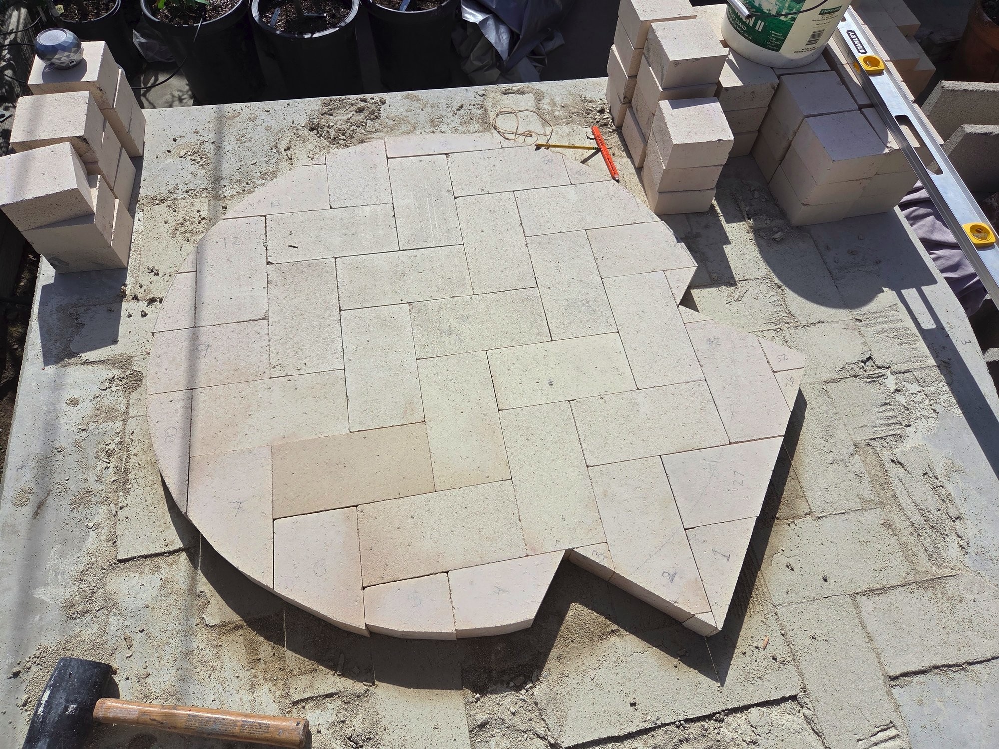

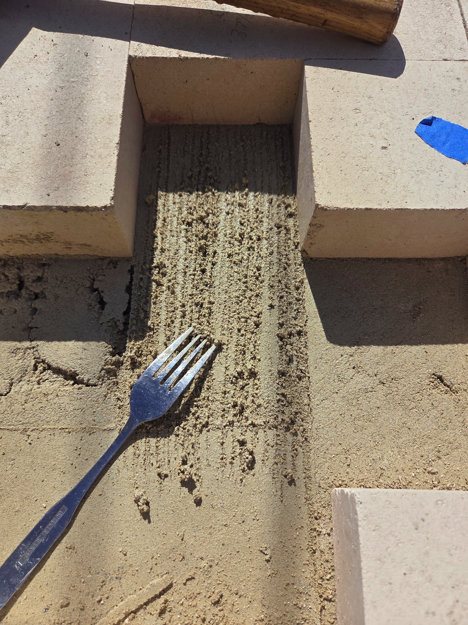

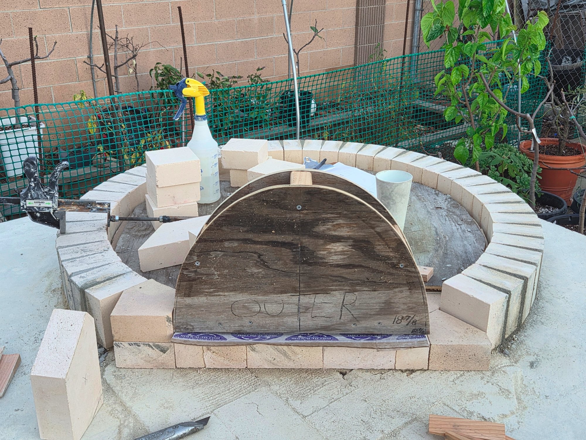

          Now we can actually start building an oven! Ignore that I have not poured the lintels or bond beam on the bar. That will come later once I feel like lifting more bags of mortar. My local masonry supplier only carries Whitacre Greer low duty fire bricks, which caused me great anxiety since the Pompeii oven .pdf instructions say to use medium duty fire bricks. But this thread assuaged my concerns about the performance of these bricks. I didn't have enough old Shuttle tiles in my office to use for the oven, and they are too delicate anyway. I originally planned to build a 42" oven, but realized that a corner build is really inefficient for space that the entry arches need, and scaled it down to 37.5 in the hopes of squeezing in a decorative arch to my curve-encumbured slab. I tapered the landing under the dome arch 1/4" over one brick length to allow a slightly better view factor into the oven and simplify removal of the arch mold. The floor was bedded into a 50:50 mix of sharp masonry sand and Lincoln 60 fire clay from the good folks at Aardvark Clay. My favorite tool setting (reworking, actually) the floor bricks was a $0.25 fork from the thrift store! This brought step and gap measurement flashbacks from early in my career! My buddy welded me up a IT using a Harbor Freight clamp and bits and bobs from his garage. I made sure the center line of the bar is in-line with the center of the face of the brick to avoid stepped bricks.
          I ended up with a 19.25" wide and 12.125" tall dome arch opening, which is 65% of the oven height. Pretty close to the preferred 63%. Thanks to JRPizza for helping me out with that. I cut the length of the 1st dome arch brick (level with cooking surface) down so that it only protrudes 2" from the oven OD to buy me more space in front. I plan to have a 1.5" reveal and overlap the dome arch with the vent arch by 1.5" to incorporate a ceramic rope seal to thermally and structurally isolate the vent arch from the dome arch. If I get lucky, I may just have enough room to fit a thin decorative arch in front of the vent arch. I plan to use a 6" diameter DuraVent anchor plate, which has a 10x10 footprint. Unfortunately the fastener spacing is not specified. Let's assume it is 3/4" in from the edge of the flange. So a 9" brick + a 2" extra piece + 1/4" grout line gives me 1-3/8" from the fastener centerline to the edge of the brick. I think I can live with that.

            Any insulation under those floor bricks? An uninsulated floor will have difficulty getting to pizza temps and also lose its heat by conduction pretty quickly.
            • #7
              4" of 5:1 vermiculite:cement. There is a crescent-shaped area at the back that the dome bricks and maybe an inch or so of the hearth bricks are overlapping the transition to solid concrete when I shifted the oven back as much as possible to make more room for the arches.
              • #8
                Great catch david s. When shifting everything back, it would have been good to have elevated a couple of inches of CFB to accommodate for the design change imo.
                • #9

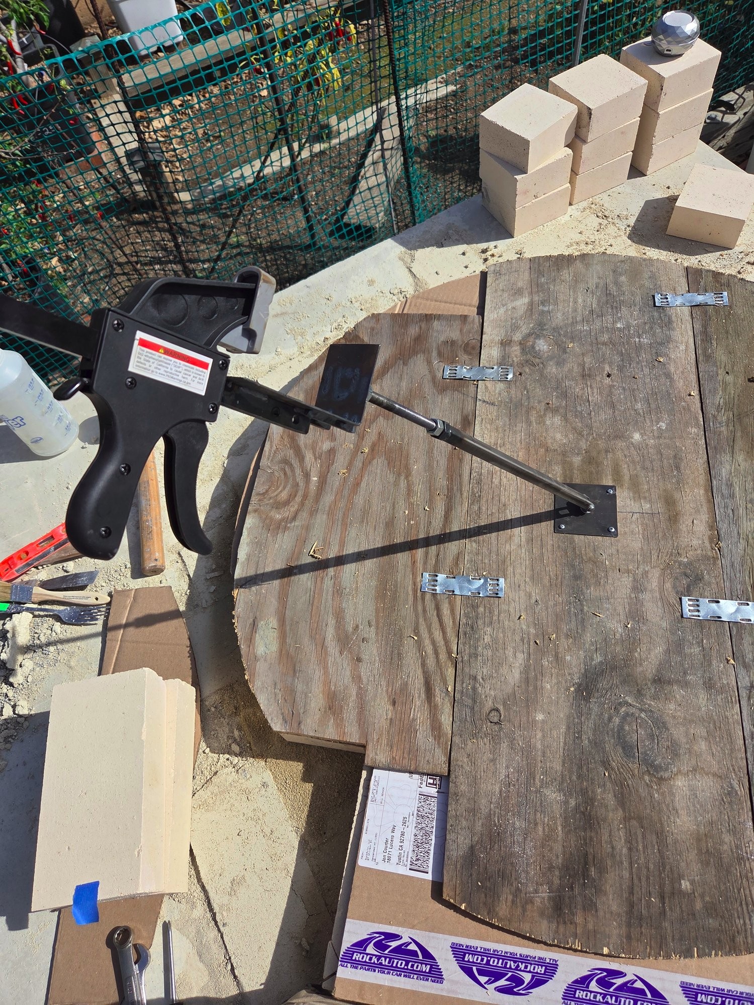

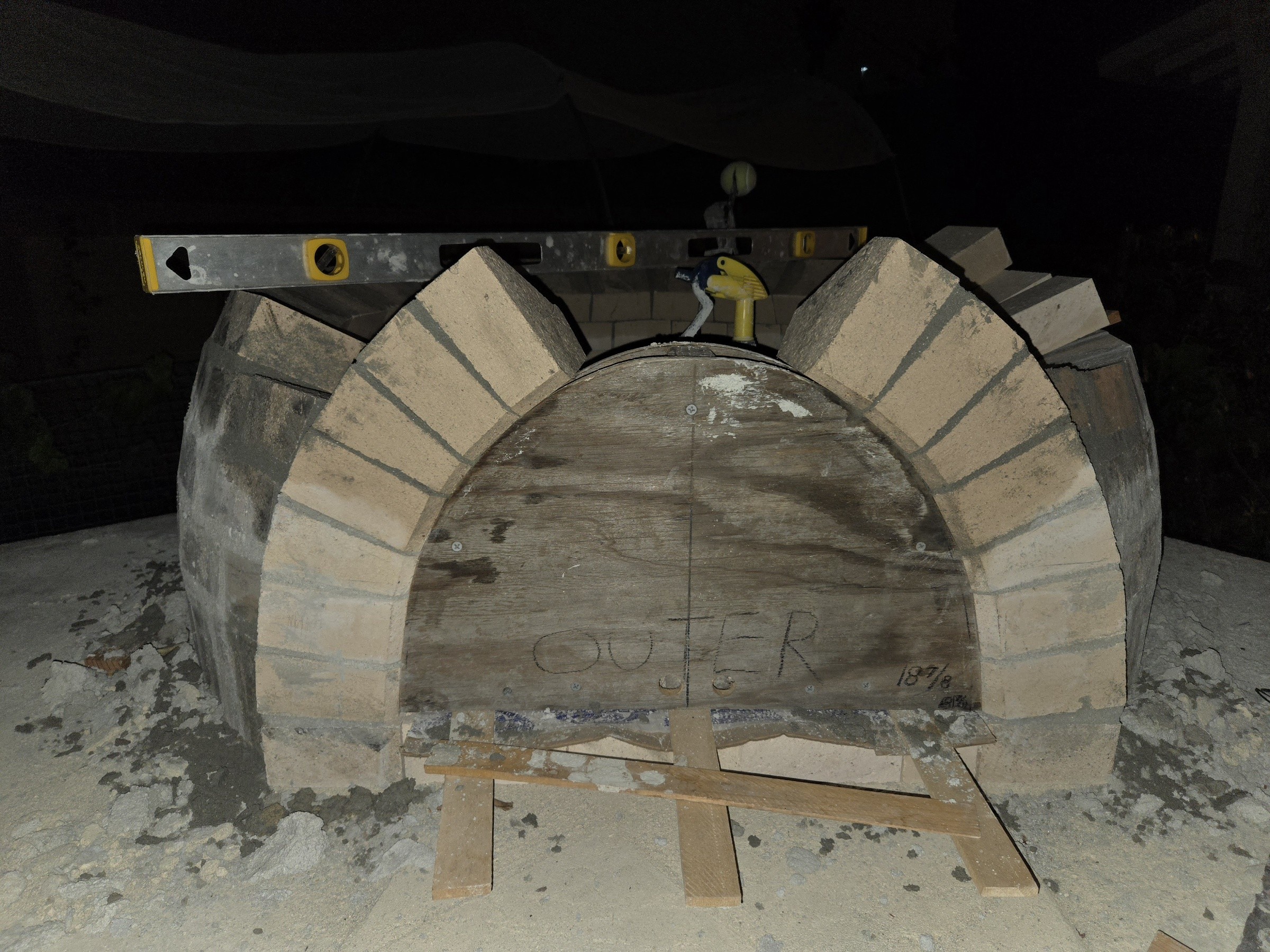

                  A couple of suggestions on your arch form, and I'm not trying to make you back up the train but you might want to do some modifications.
                  First, if you trim some known amount from the bottom, like the thickness of a 2x4, you can shim the arch form up so when you are done you can pull the shims and drop the form. With the weight of the bricks and excess mortar it can be a "bear" to pull the form if you can't drop it.
                  Second, and this is based on trying to look at the picture which isn't totally clear, it is best to have the front and rear of the form with exactly the same radius. You want the arch bricks to be as parallel to the ground (hearth) as possible and having the form cut at the same time is the best way to achieve this. I did this by two ways - I picked up a 12" compass at the local Harbor Freight store (you could use string and pencil) to make an exact hemisphere, and I clamped and cut the halves together so they would be "identical". Had to do some shaping (used a surform file) as my cut lines were not exactly on my pencil line, but was able to get it pretty round and the arch bricks sat flat. This is something you want to pay particular attention to! When I did my vent arch I disassembled my inner arch form and used the spacers as they were the right distance to support the bricks (I guess that is the third thing you want to make sure you have right), and I kept the radius boards in case I ever build another oven.
                  • #10
                    One last thing on the forms. I put radial lines showing where the centerline of the arch bricks should be. I built the arch up as I did courses, so I needed a way to make sure I had the bricks at the right spacing. This also helped me keep a consistent mortar thickness.
                    • #11
                      I thought from the look of your photo that it might be vermicrete in the centre of your supporting slab. 4” of 5:1 vermicrete is a pretty good underfloor insulator, but the drawback is that it contains tons of free water that takes ages to eliminate. If you can, remove the material (plywood or whatever) that was used underneath to support the concrete when pouring, to allow the free water in the vermicrete to breathe. If you can’t remove it, drill a number of holes through it. Moist insulation material does not insulate very well because water allows heat transfer by conduction. Many builds neglect this issue with negative consequences when their underfloor insulation inevitably gets wet from either prolonged humidity or heavy rain events.
                      • #12
                        JRPizza - The inner and outer arch forms are the same height, but the outer is about 1/2" wider to create a flared opening for better access to the oven interior. I plan to take that up in the grout lines rather than custom trim the bricks to change angle as it goes around the slightly elliptical arch. It isn't yet in the above photo, but the arch form is shimmed up about 1/4" and is sitting on one layer of cardboard so that it can be dropped a bit for removal without binding up. A full 2x4 thickness would certainly have been more certain to clear. The flare should help a some with that as well. Worst case, I can remove the screws holding the front form to the separator 2x4s to get it out. Now that I have a better jig to trim the arch bricks I will add lines on the form to keep the spacing tolerances from stacking up and going off the rails.

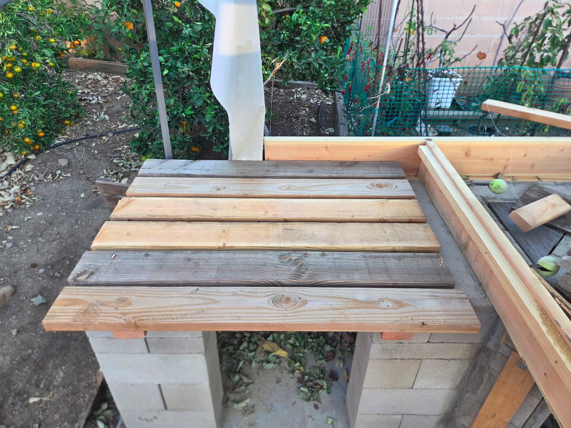

                        david s The wooden roof of the wood storage area under the oven has been removed. There are five 1/2 drain holes through there to the underside of the hearth bricks. Maybe I will install a blower system there to help drive some of that moisture out or just shine my old halogen work light at it for a few days. We are having a hot/dry spell (94F/33%) humidity right now, so that should help as well. My plan includes a waterproof coating on the igloo exterior to prevent re-saturation, but I am not confident in the seal at the interface to the chimney or to the horizontal table surface. Maybe some kind of weather cover tarp for the winter will be added.
                        • #13
                          Sounds like you have been doing your homework! When I tapered my bricks I did the first cut leaving the wider/outside edge of the brick untouched. I set the blade so it started cutting the side without removing much if any of the top edge. If your bricks are not square when you flip them around you will not be cutting the same amount from the new edge as you did from the first edge. If the bricks are square you will remove pretty much the same amount of material from each side. Then when you flip the bricks over you can sort of eyeball where the cut will intersect the first cuts and leave you very little to clean up if anything.

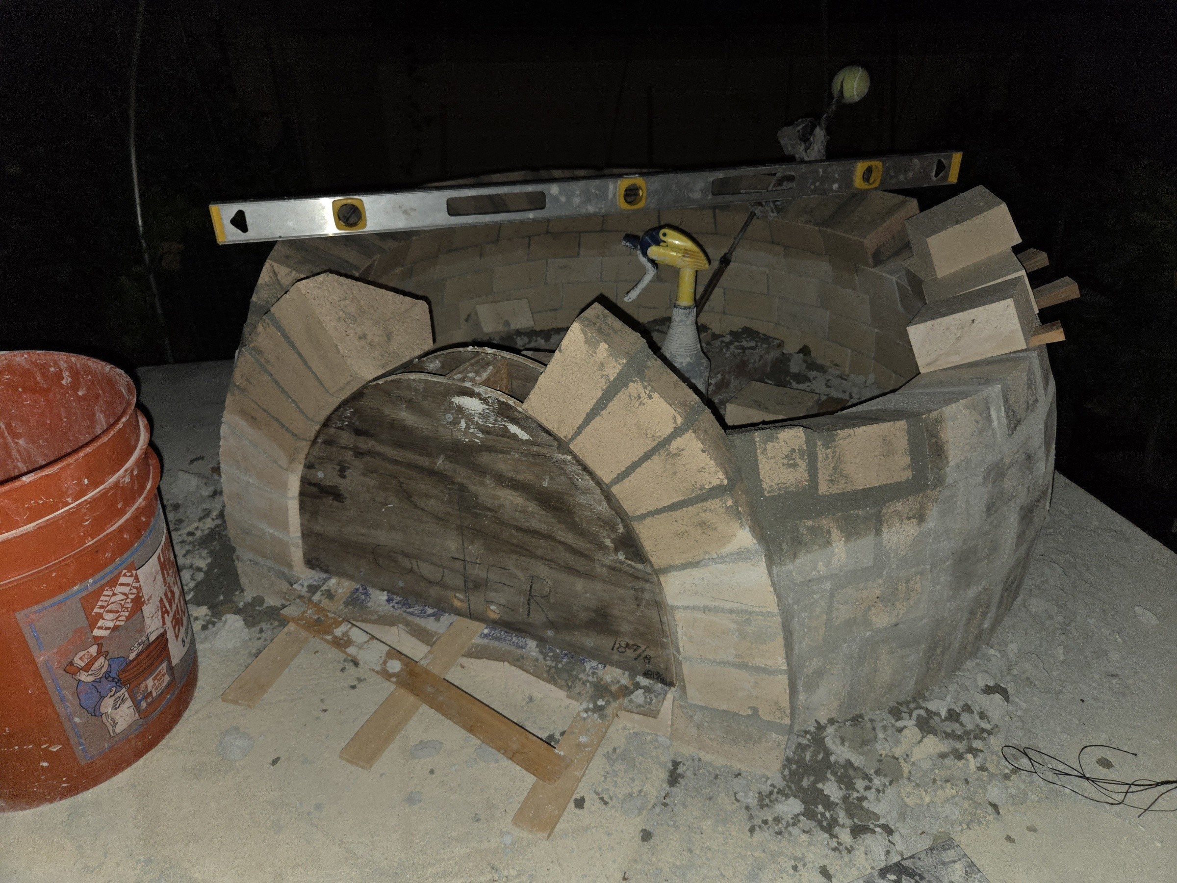

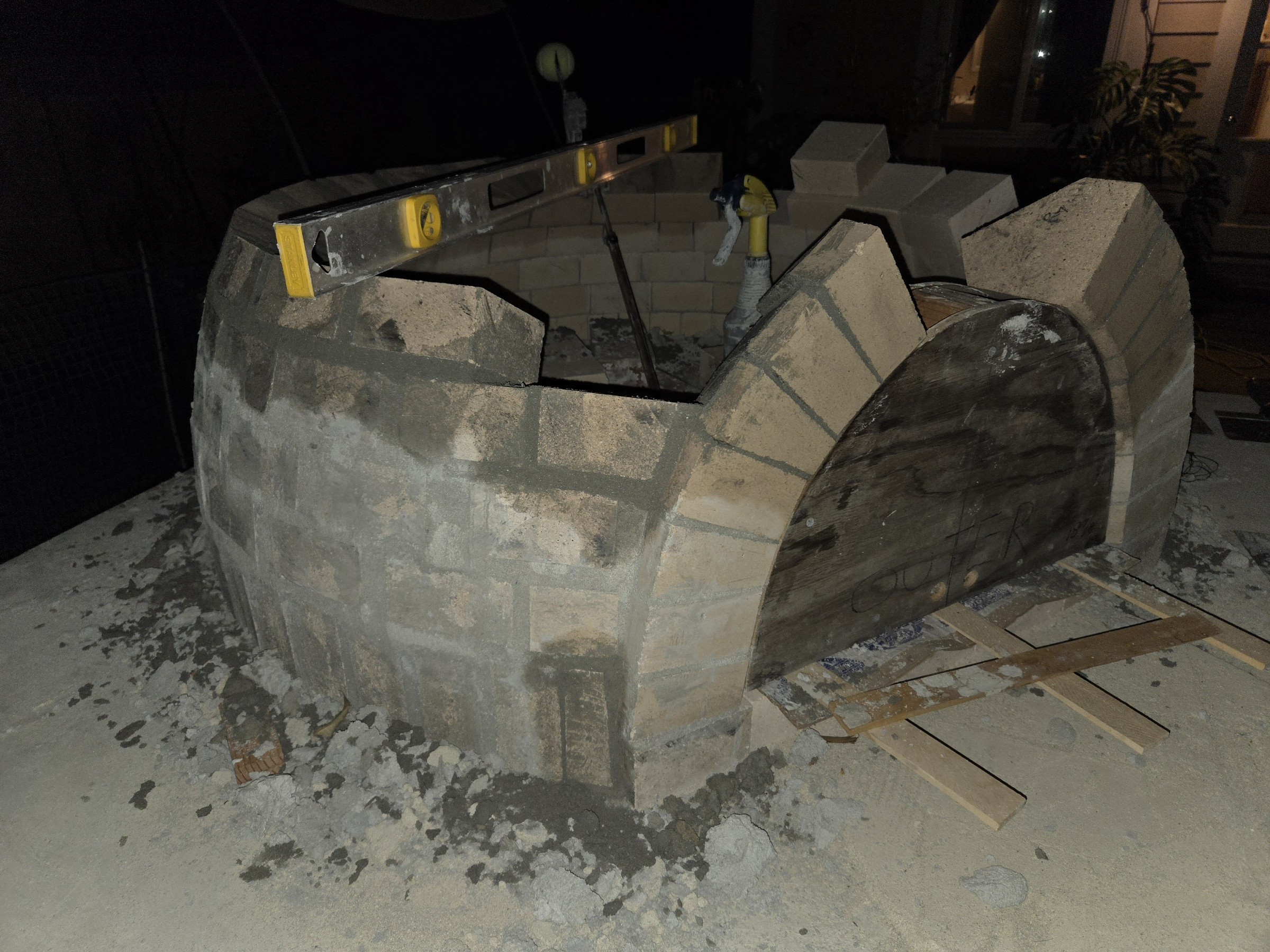

                              Slowly making progress. I started beveling and tapering the bricks at the fourth course to keep the inverted triangular interior grout lines at bay and to keep the vertical exterior grout lines from using so much mortar. My six big drink cup batch of 3-1-1-1 home brew mortar gives me enough to install eight bricks at a time. I think going forward I'll start grinding some horizontal lines in the faces of the bricks to prevent slipping grout lines after removal from the IT.
                              I opted to use shims for the bevel and tapering to keep things simple. Cutting the tapered arch bricks was a bit of a learning curve, especially when I learned my new diamond blade has a thicker hub, which reduces cut height. I went back to the old blade and am just cutting slow.
                              So far no droop has shown up at the dome-to-arch transition, but throwing a flat pallet up there to check flatness across the entire dome top has shown it is not perfectly matching the curve of the rest of the dome, but acceptable.
                              I made the dome arch slightly elliptical, and that is making the brick tapering complicated. I would do it circular or make an adjustable cutting jig if I had to do it over again. I am surprised that as the dome moves inward as it rises, it is not backing away from the arch as much as I expected. I hope this is not an indication of missing a detail.
