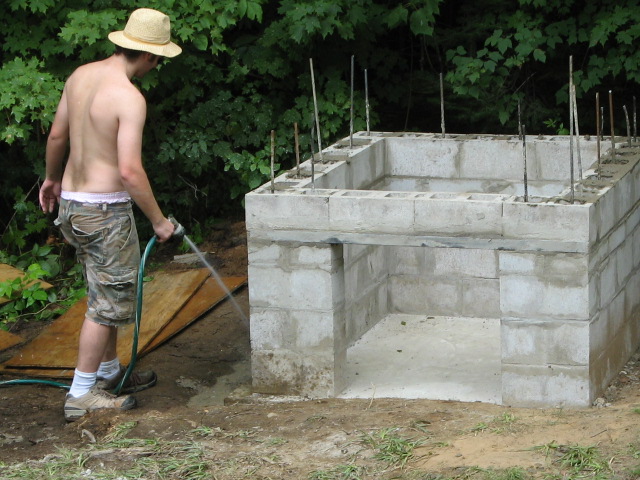

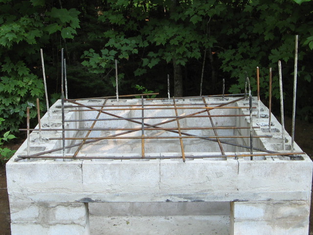

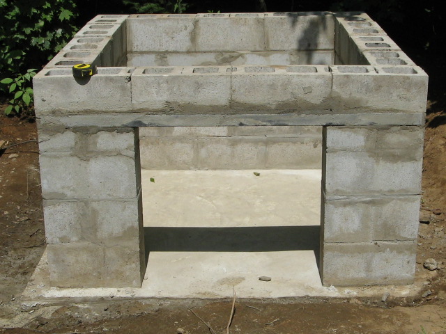

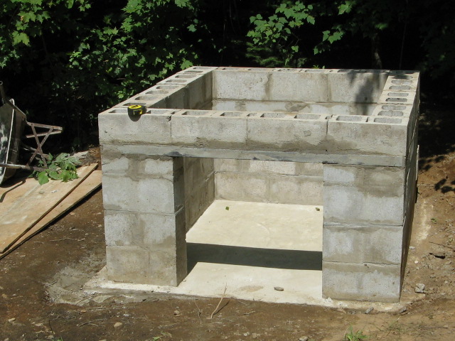

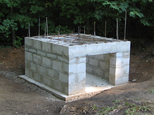

I am finally starting my oven after scouring these forums for months. I will be putting my oven up at my cottage because that where I do some of my best cooking. I decided to go with the 36" oven as per the Forno Bravo Plans, and I just started my clearing a spot for my foundation last weekend as there was trees in the way.
I want to do a floating slag dug down about 2 ft and have 1 ft of gravel and 1 ft of cement rather than doing any type of footer if possible. I am not sure if this is a good idea though as our frost line seems to be 3-4 ft. I would appriciate any suggestions as I dont want to build it and have it shift in the winter, but if I can get away without footers that would save some much needed time and money. Please let me know what ypu think, and I will update with pics on my build. Thank you to all for the great intel this forums brings
