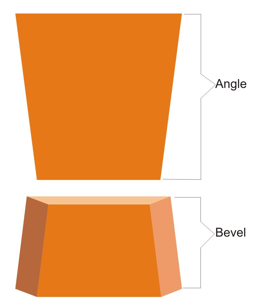

                      • 5259
                      Just be aware, you do not need to do a full length bevel cut as you go up in courses only about the first inch or so from the inside of the dome back. Mortar fills in the backside. Look at JRPizza build to see what we are talking about. The bevel cut is to minimize what is called the inverted V mortar joint. PS Before you build your IT, post it. There are some key design components that need to be factor in, mostly how the IT rod intersects the brick at the ID of the dome. Click image for larger version  Name:	anglebevel.jpg Views:	0 Size:	37.2 KB ID:	457121
                        I understand the need for the bevel, and eliminating the inverted V. Made myself a dummy wood half brick and been playing with it , just to grasp the mitre and bevel. I do have a compound mitre saw and am familiar with both cuts, so I get this part.
                        Other terminology is new to me, IT rod, and ID of the dome. I use ID as shorthand for internal diameter, but not really sure what these terms mean.
