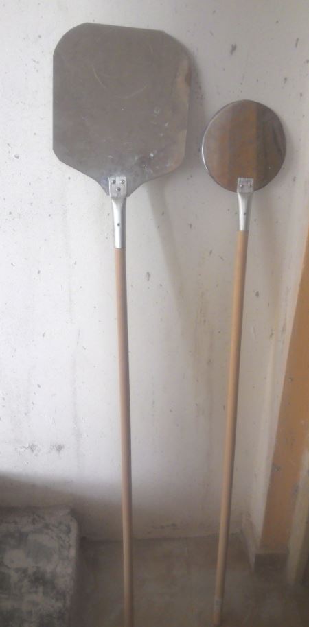

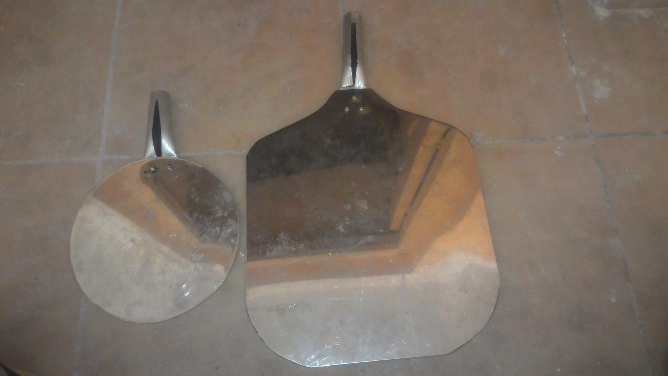

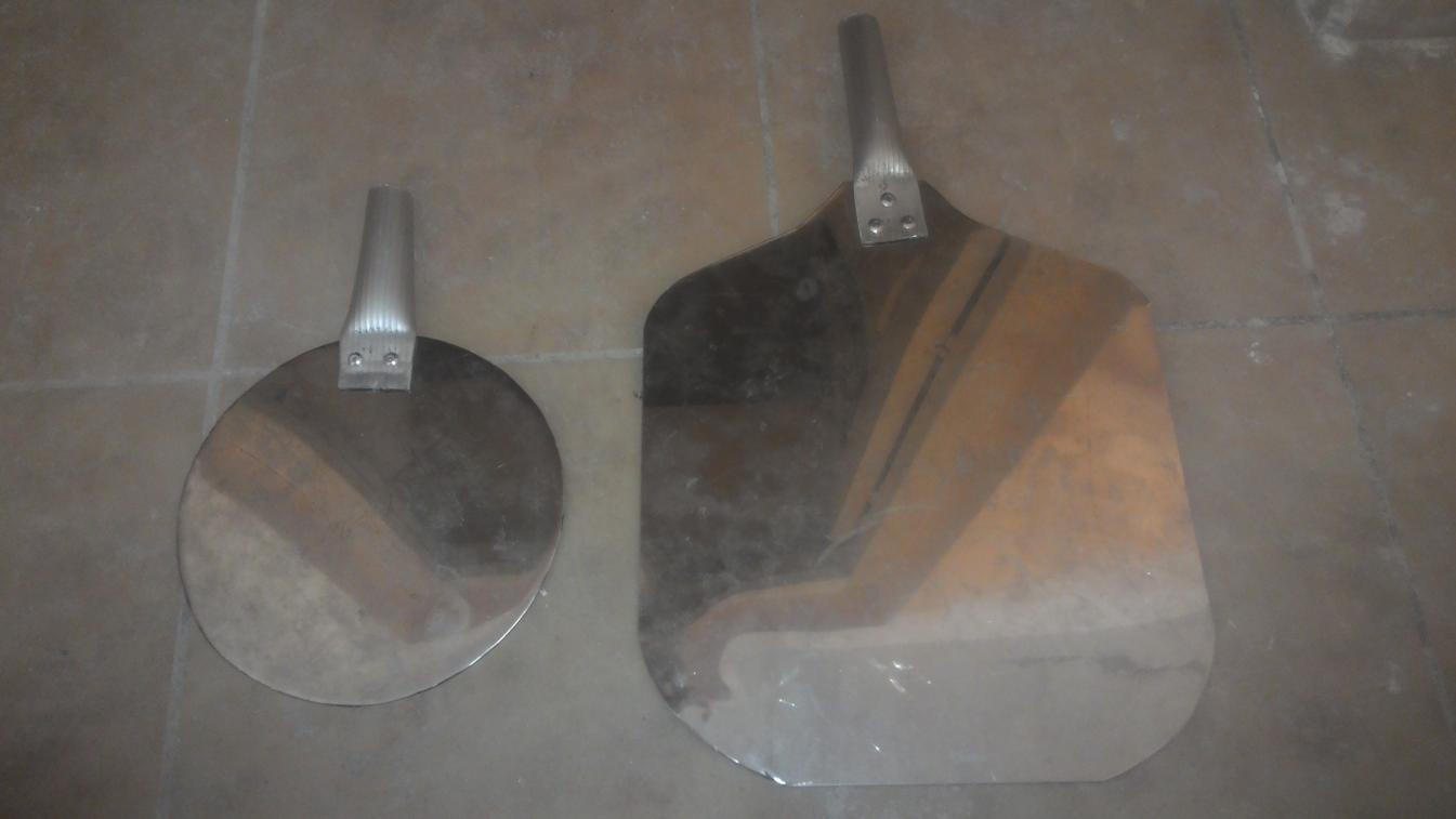

            I made some pizza peels for no cost.
            I found a stainless steel loaf and i cut it for peels.I used it and is perfect!
            I made 2 round peels and 2 rectangle.

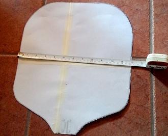

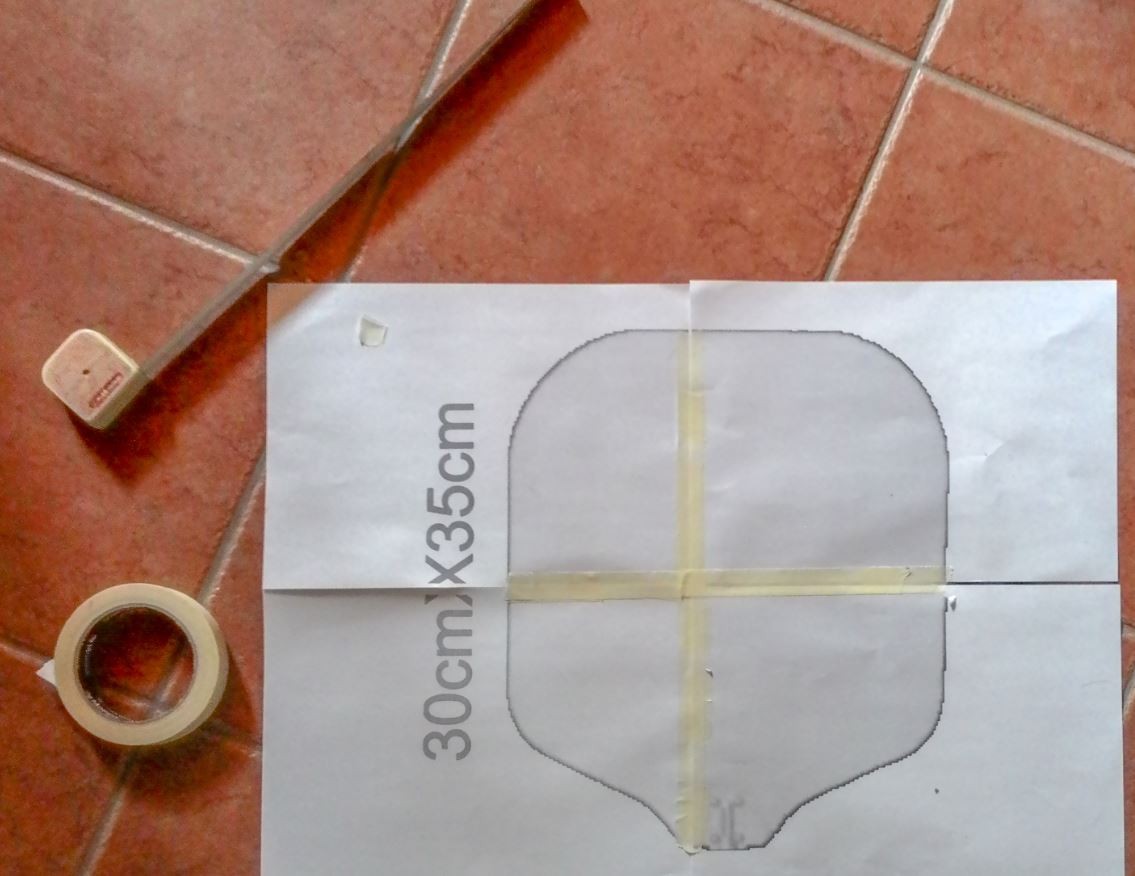

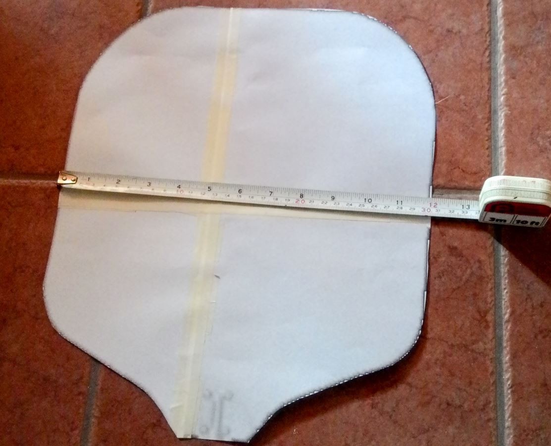

                  It is from stanless steel sheet.
                  I printed a template from peel size and i draw the outline on the sheet.
                  Then i cutted with electric sheet metal scissor.
