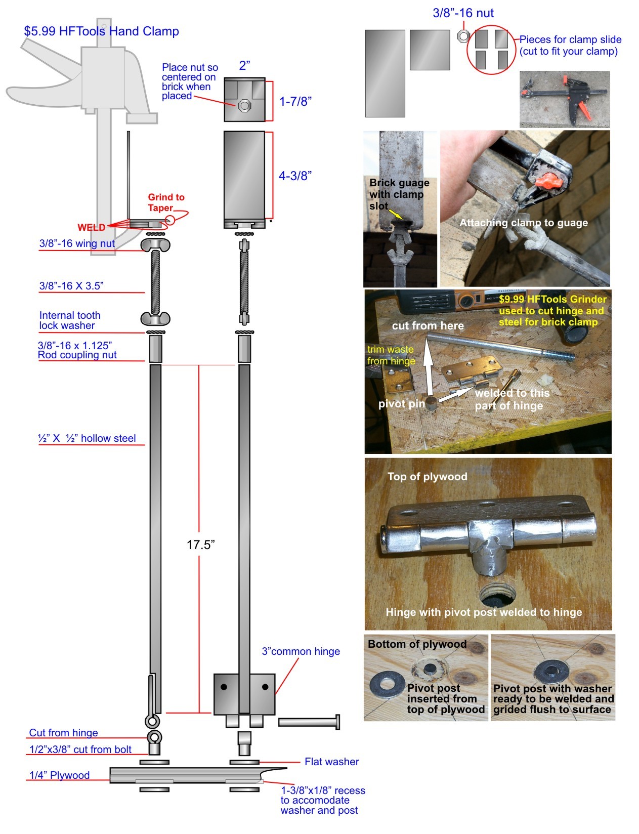

                              • 5259
                              #15
                              Here is plans for one the is adjustable and design wise good. Most parts you can get from a big box store, does require a couple weld, but possible be done with epoxy putty. Click image for larger version
