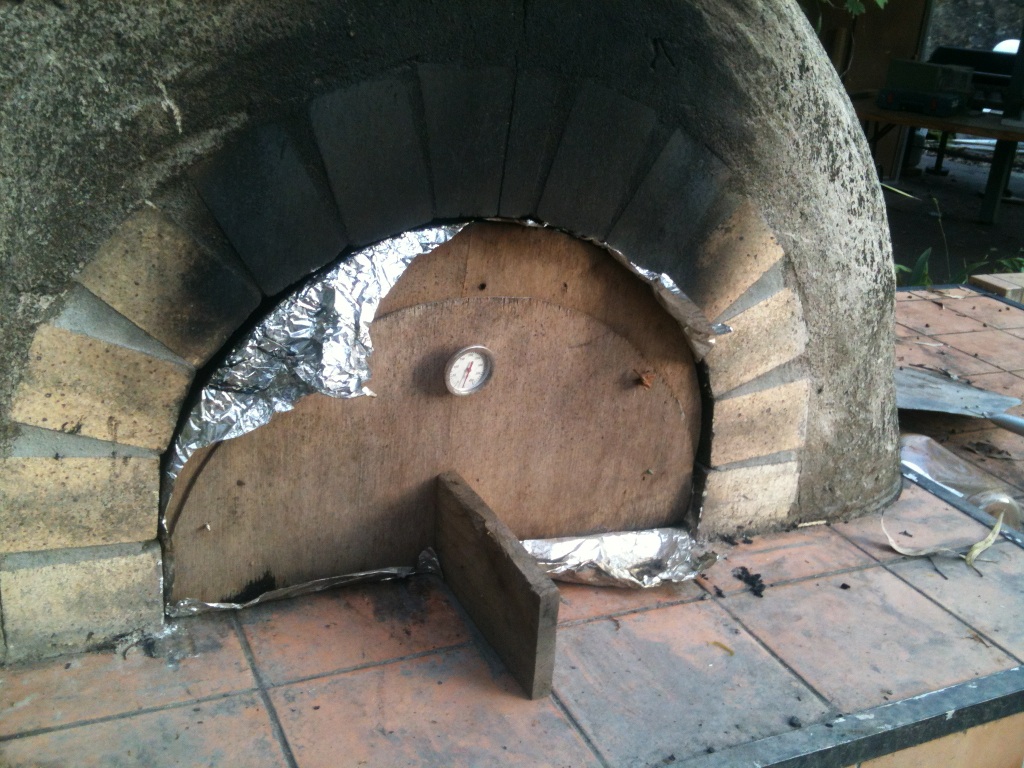

    Got invited to a mates place in the break Great pizza for lunch. best roast lamb and veg for evening meal......Shame about his door

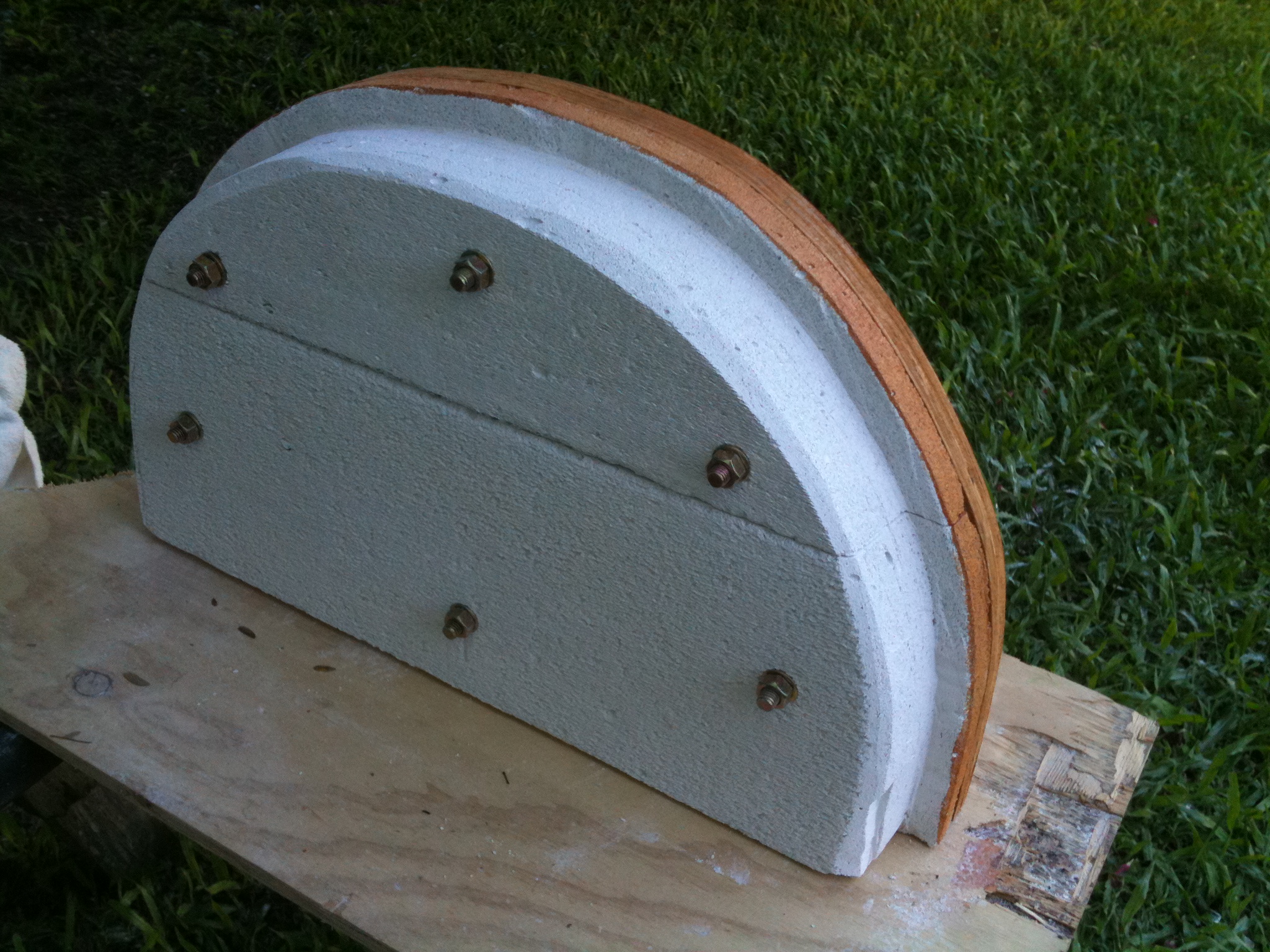

    Mate... pretty ugly but I have got to admit the thing worked a treat...can't believe a piece of aluminum foil could stop that ply from burning!

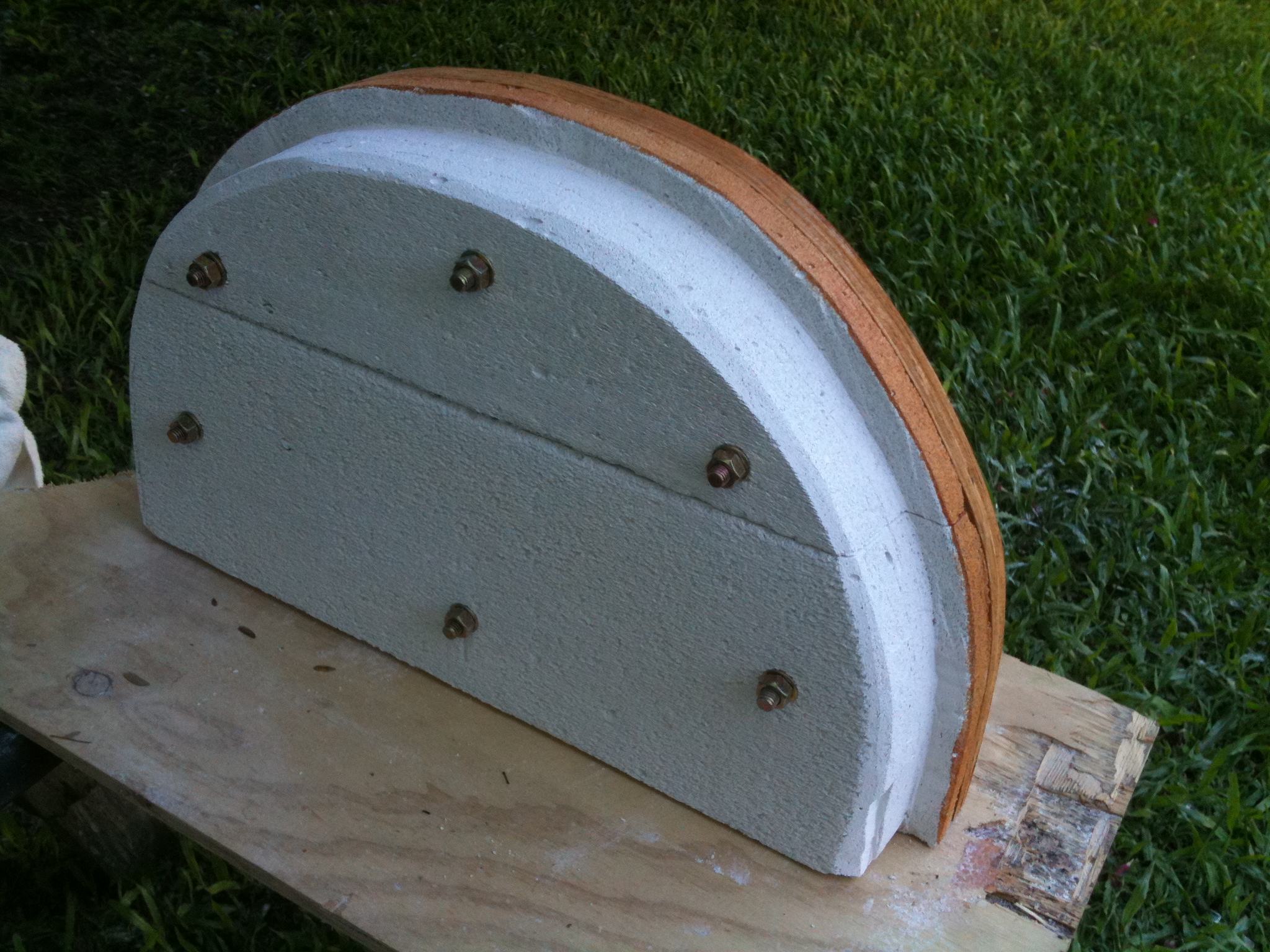

    Anyway I have made this one for him which is little tidier than my own.
    [ATTACH]Click image for larger version
    Its basically 75mm... 3in Hebel block bolted to a 10mm ply front (non gal bolts) another piece of 10mm ply screwed to the first covering the bolt heads which do get hot. The handles scewed to this so they two remain cool.
    A revel is then cut into the hebel ..the stuff cuts like butter you can saw, chisel or rasp to shape. The door can then be used to seal all that heat when the fires out for some slow cooking. My original one has survived about a year quite well handles the heat alright. It has a crack in the hebel block (from a fall).... now I better build myself new one with the extra prettier wood to cover the boltheads.

                  Davids thanks for your input....the crack I have in my temp. door is from dropping it ...ages ago... hebel is brittle. 10mm ply is flexible, drop the door and thats what happens. The bolts held it together so I kept on using it and yes the Hebel surface has stood up to the heat....I tend to use it also placed in front of the chimney as a heat sheld as well ...no probs. Its been a year now to so much for a temp. door.
                  So I think I will build Mod 111 for myself using silastic as the glue (thanks brickie) It should give me a flexible union between the ply and the hebel and stop the tendancy to crack. The hebel insulation properties should stop the worst of the heat from the silastic (thanks fornoa)

                    Brickie, my Hebel cracked right down the middle not where the screws were. The panel was only 1" thick. wouldn't use screws again, they get so hot they tend to char the the wood where they make the threads. I now use 3/16" 316 SS , much better. I prefer solid timber to ply as the glue holding the ply together does not like t he heat cycling, I think solid timber is better, I use Quilla.

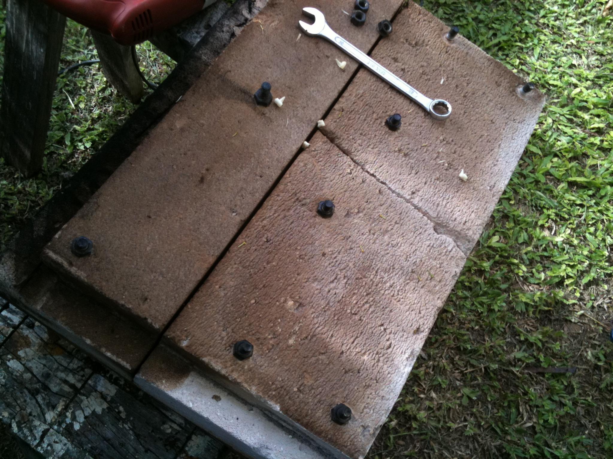

                      So I've made my mind up the door has to get pulled apart or I'll never build another
ID:	288509 Click image for larger version
                      Pulling it apart was interesting the hebel surface was basically a bit smoke stained and chipped but still in good condition not deteriated at all from the heat. The ply that it was bolted to was also still good I 1/2 expected to find some heat damage around the bolt holes but there was none. Did however showed charring on the bottom edge where it was in contact with the hearth bricks at the entrance no scorching anywhere else so the hebel did its job.
                      So I started Mk 111 door this time using silastic instead of bolts

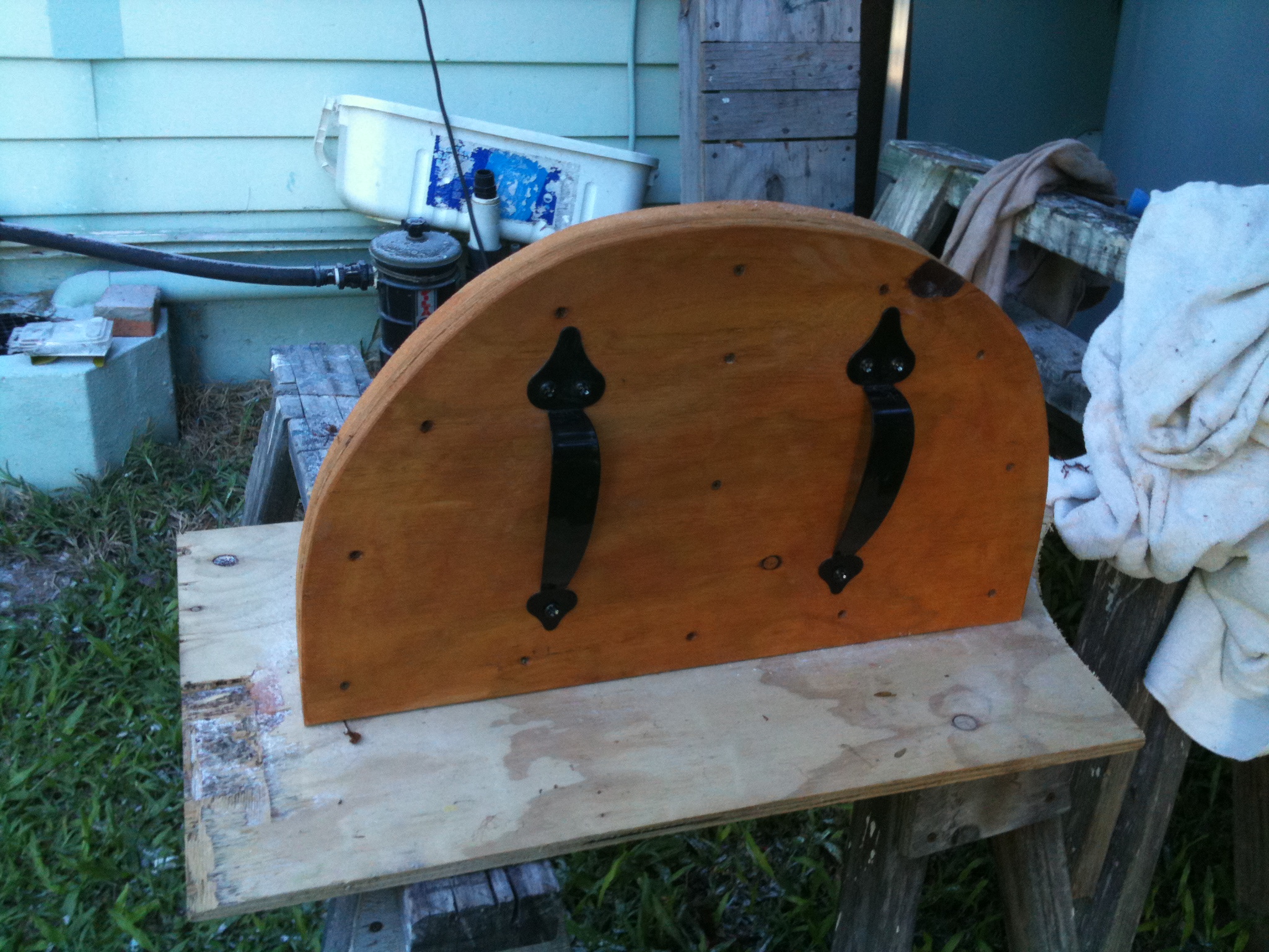

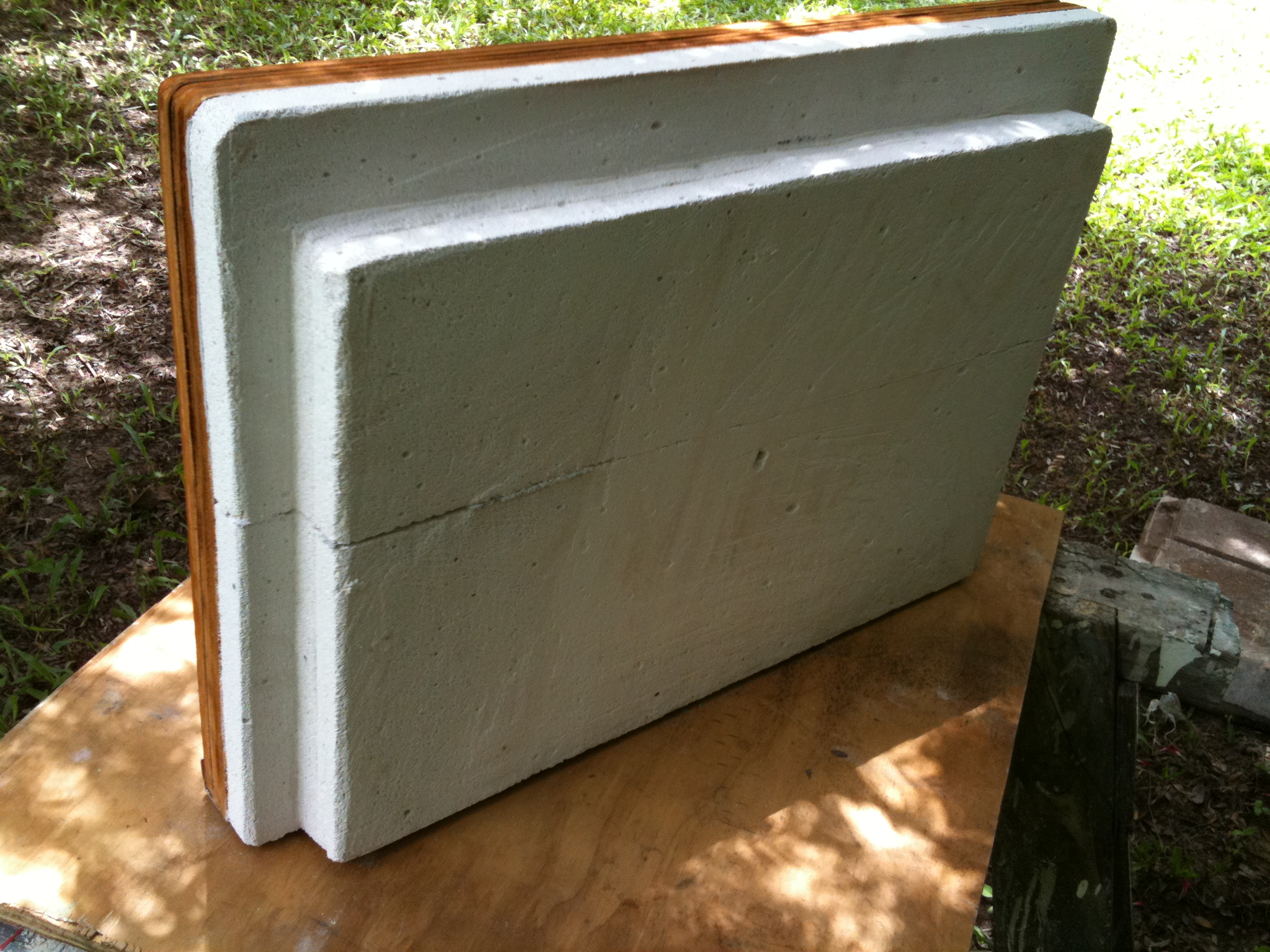

                          Using silastic I glued the hebel to a face made of two pieces of 10mm ply screwed together.

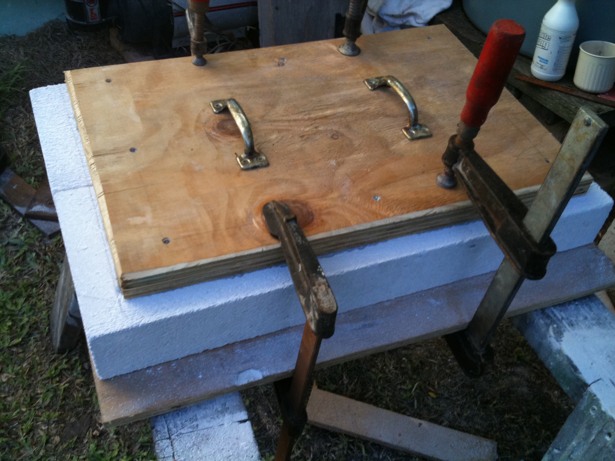

                          2 pieces so if the silastic didn't work out I can unscrew them bolt the hebel on them rescrew the secound over the top to cover the hot bolt heads. I used 3 in ( 75mm)hebel as i did in the first and cut a 1 in (25 mm) revel
                          Too bloody heavy I was sure mark 1 didn't weigh this much so I weighed it ....12.6 KG.....Decieded that was getting too much so I set about reducing the weight
                          Cut 25 mm off the whole thing and recut the revel weighed the door again.....9.4 KG thats better and the thing even though still quite heafty is usable. as you can see I used hand tools to do this it real dusty stuff and power tools would just make a big mess. Its real easy to saw and rasp Ive carved things with it before

                          Final door also has a the ply cut higher than the hebel on the bottom and a piece of alum angle to protect it from the hot bricks. I be testing this one to see that it works and I'm on the lookout for some interesting hardwood to replace the outer piece of ply with.
