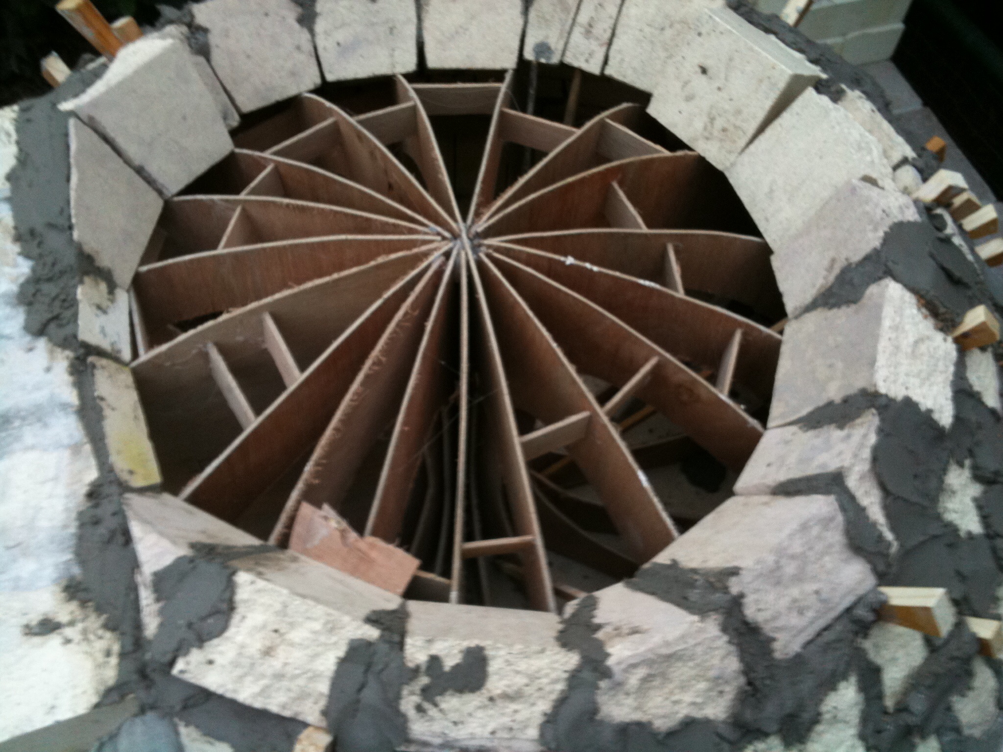

    I'm currently building my 32" round oven with a 17.5" heigh dome and a 12" high door. I am using a lintel for the door opening and the problem that i'm having is figuring out how to transition from the square opening to the dome shape. It's like a horseshoe shape with the bricks going inward to approach the peak then straight for the door opening. I'm using a hammer and chisel to make all the cuts and everything is working out well but if there is a simpler way to transition please let me know.

    Its hard to marry into a square entrance than to an arched one. I built to square in my oven entrance and have since experience with an arches and they are easier.
    A pic of the transition in my own oven like yours brick bulster and angle grinder.
    My door is a bit forward resulting the dome resting on the inside face of entrance.
    Where the entrance bisects the round of the dome will have a bearing on how wide your entrance is as well. You should be shooting for 1/2 the dome internal width.
    The internal height of your dome and entrance is quite high for the width of your oven. A dome of 32 in should be more to 16 inch dome height with 10.5 inch door.
    I'd recommend angle iron if using steel for the entrance as its less likely to warp like a straight length of steel. Don't trap the ends in the masonry so they can expand in the heat, leave a space and you'll not develop major cracks
    Hope something here might help
