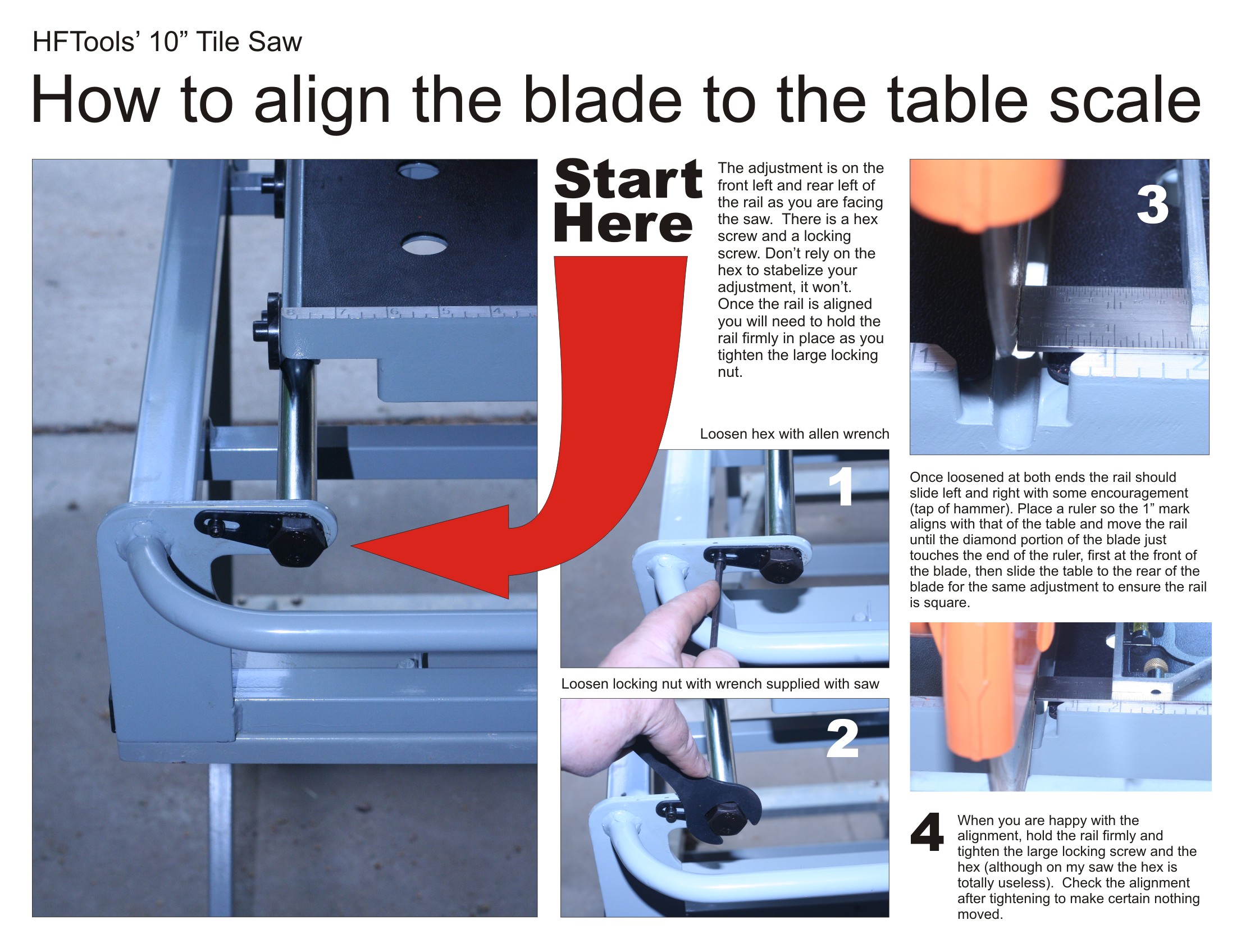

    I am unable to find the threads with information on aligning the table to the blade. Can someone please post the link?

    Russell (Utahbeehiver) provided this guide, sometime back.

      Re: HF wet saw
      That is what I was looking for. I spent nearly an hour trying to find it. Thank you!!!!!
