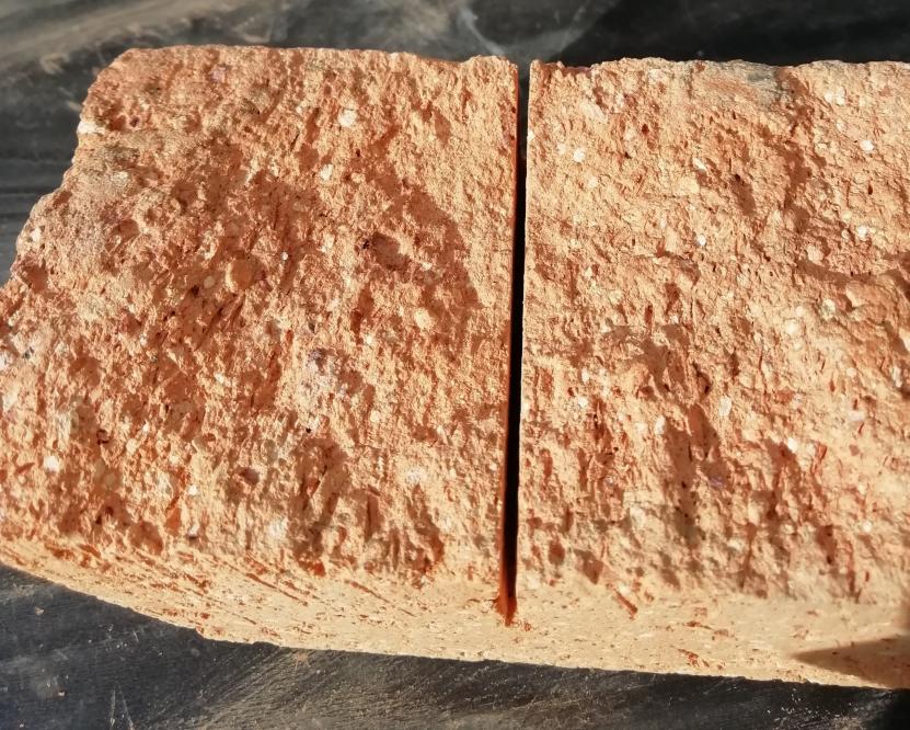

          Here is a photo of a brick split in half. It cuts extremely easily with a hand saw.
          I also tried putting this piece on the gas hob for ten minutes and on turning it off the top surface was barely lukewarm.
