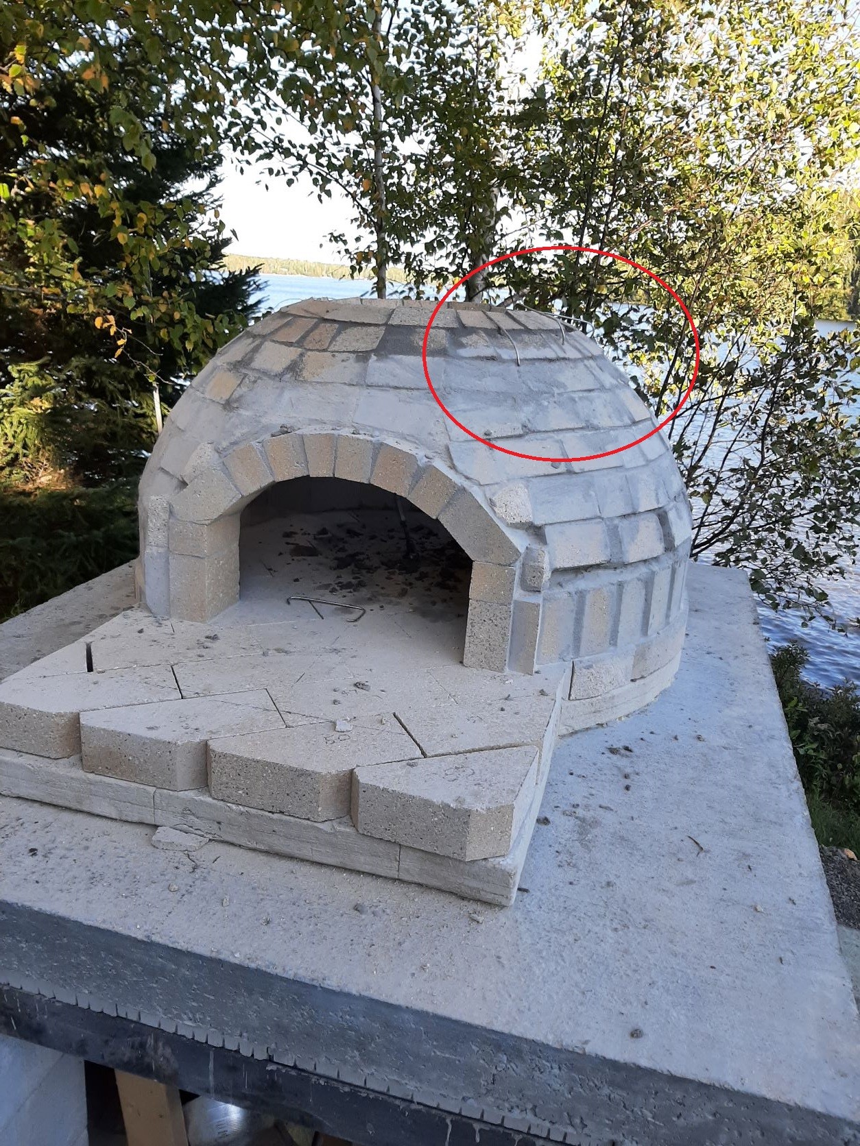

    A New Tool: The Dome Claw
    The Dome Claw is a homemade, inexpensive, easy-to-fabricate tool that unobtrusively supports bricks while building a bread oven dome.
    It’s explained in the following Youtube video:

      Stem, the claw works magnificently. Easy to put in place and easy to remove. I made mine from pieces of 1” X 1/8” aluminum. My next batch will be from steel - it is more forgiving if you need to rebrand to adjust angles. I broke some by trying to “adjust” the angle on them. Thanks again

          Sten, thank you for the idea. I had more success with steel from Simpson Strong Ties. I found them to have a bit of "give" with a spring effect. They came in handy on my seventh course. I'm making more as I go after the more vertical courses this weekend.

                        I made "24" of these over the week -end. The first few where a disaster ? Why ? You can NOT bend 1/8" aluminum in a shop bender without snapping the metal. Hmm! Made a few adjustments on the Bender & still no sucess ? Then tried a piece in the shop vise & it bent with a hammer, It Worked !! just as it should have. Left me wondering why it wouldn't bend in a bender machine ? After a few more trial runs I figured it out !!! (IF) you install the Aluminum straps into the shop bender & crank them a "LITTLE At A TIME" . they will bend & comform to your measurements. You just can't do them fast ! The aluminum needs time to conform it's shape.

                            I used something like that when doing the dome. Wish I had seen that before I did the dome. I had 1/8" SS tig wire in the shop so used that but the flat bar would have been way better. Thanks for posting.
