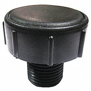

    Fires after insulation is on but before stucco, this allows the moisture to egress out. Be patience with the firing, if you see steam, you are going to fast too hot. David S suggest you loosely place a tarp or plastic over to oven to monitor condensation, if you see it, the oven is still wet. You can start with a halogen light, then a couple bbq briquettes fires(you can cook a dutch oven meal here), then wood. Have you considered placing a vent in the stucco coat? There are several different ways to do it but Gulf and I use a breather vent and a 1/2" pvc bushing that can be purchased at any auto parts store for under $10.
