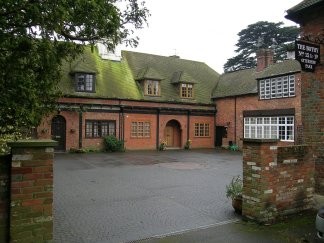

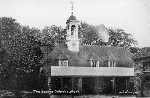

                  Hi Dave, my chimney is undoubtedly made of lime. I am unsure if it was 1:3 lime to sand or perhaps 1:4 !!
                  In fact my entire house is predominantly made of lime mortar.

                    G’day
                    yes that a pretty grand house congrats..... just ouzes history

                      +To be honest, being a practical guy my following statement may reflect an ignorance, however being an architect taught me that those period houses were designed as an animal dwelling for horses and sheep. Georgian houses were built in a certain style and certain ceiling heights either to reflect a grandeur wealth and illusion or as well as to get rid of the smoke and toxic gases generated from the fire places that they used to run all day long by the poor servants. The Georgian glass windows were designed that way as their glass manufacturing skills were limited to small approx 20 x 15cm glass panels.
                      Their houses were built of bricks as they dug out pits for their basement houses where they had their kitchens and stored all sort of food and dry meat, then they made bricks out of the excavated dirt. Everything had a practcal purpose. Yet we see many people mesmerized by the past unaware of the then technology of that day that imposed to build it in this way. Chimneys were built ion either sides of the houses as they are structural pillars that stable the structure of the house under extreme stress generated by wind and heavy snow accumulated on the roof.
                      Those infatuated by the past architectural styles are hanging on the aesthetic of the past that little do they know is an embodiment of the technology of that past period, yet ignoring the technology of our day.
                      My house was extremely uncomfortable to live in, until I carried out changes that made better, but remains uncomfortable and impractiocal as a modern house!
