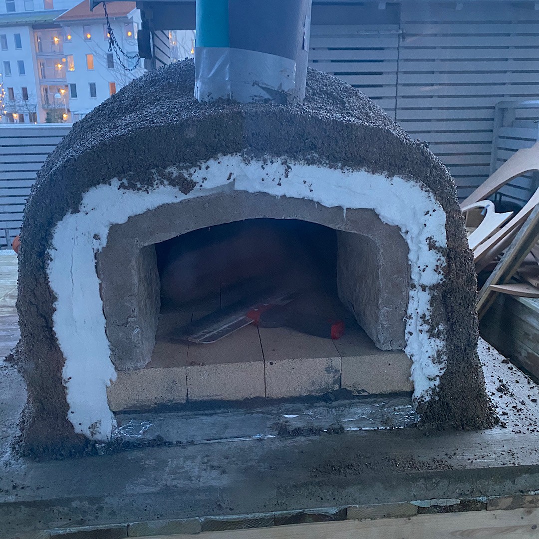

ID:	433631This what I have exactly done. For the bottom I used 50mm calcium silicate board. Then casted the dome with 40mm homebrew mix. On top of that placed ceramic blanket 2 layers with a total thickness of 50mm. Finally I did 10:1 vermicrete mix. Now I am waiting for the last layer to dry. I guess it will take a week or so then should I start curing fires?
          Also after putting on the last layer I found myself in the situation where the front opening around the oven is not covered. How should I cover it? do I need plaster or would it need to be a homebrew mix. I am thinking to avoid any bricks to build the arch, just need a simple opening.
          final question, when should I render and what material I should use?
          I am really thankful for this forum and especially for you David where I used your advice in every step.
          adding some photos below for the build
