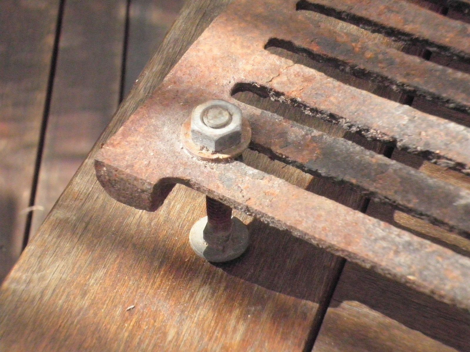

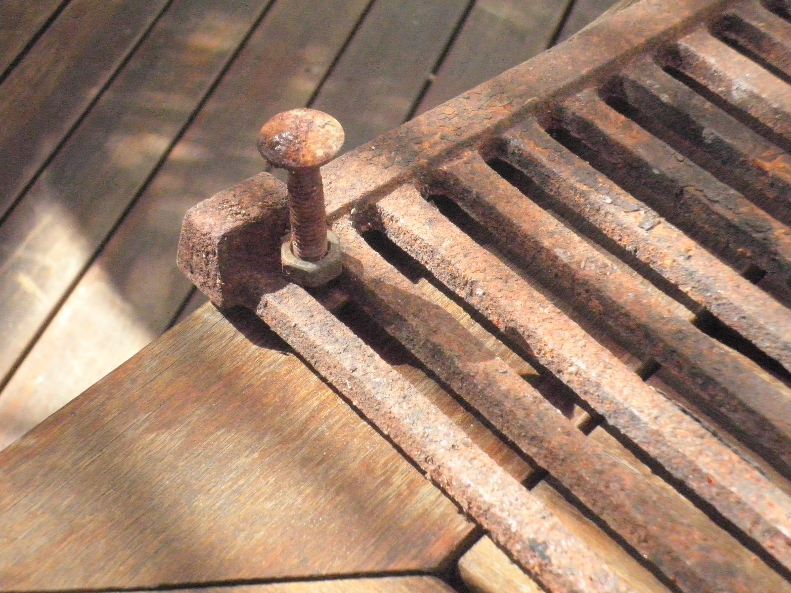

            Can you tell me how you did the legs? What did you buy and where? How did you attach them? I'm looking to do the same thing.

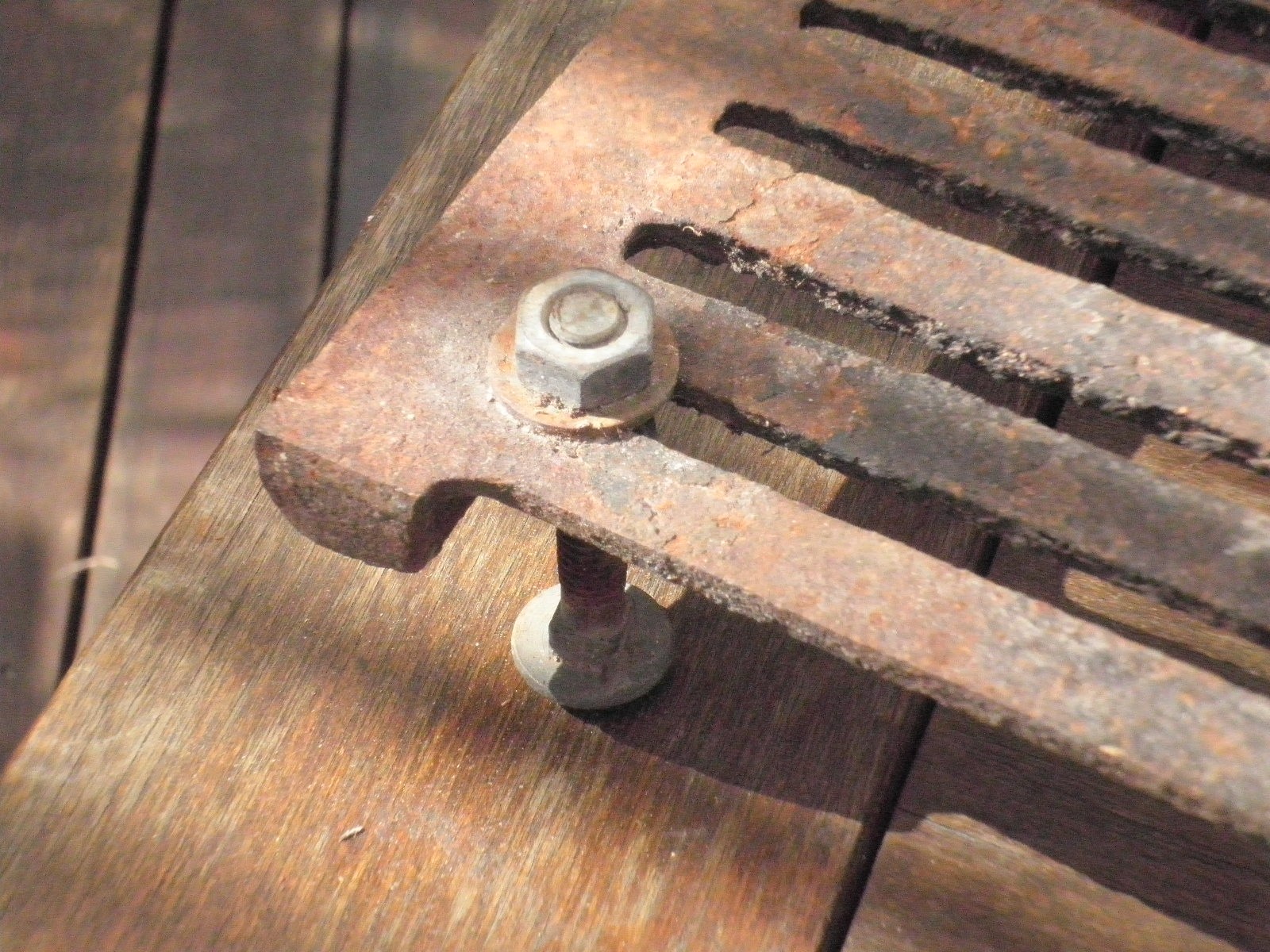

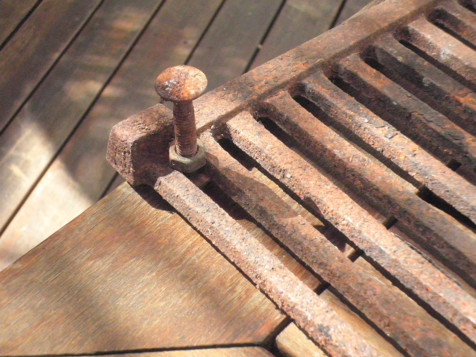

              Here you go. An old BBQ grill. Make the legs as long as you like.
              Click image for larger version  Name:	PA020039.JPG Views:	0 Size:	540.1 KB ID:	440222 Click image for larger version  Name:	PA020040.JPG Views:	0 Size:	536.4 KB ID:	440223

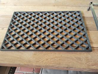

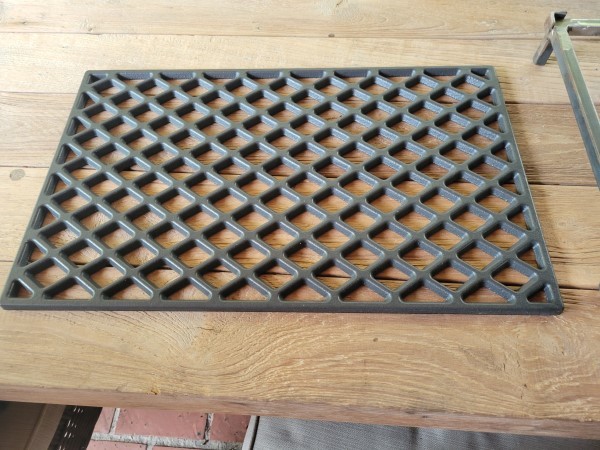

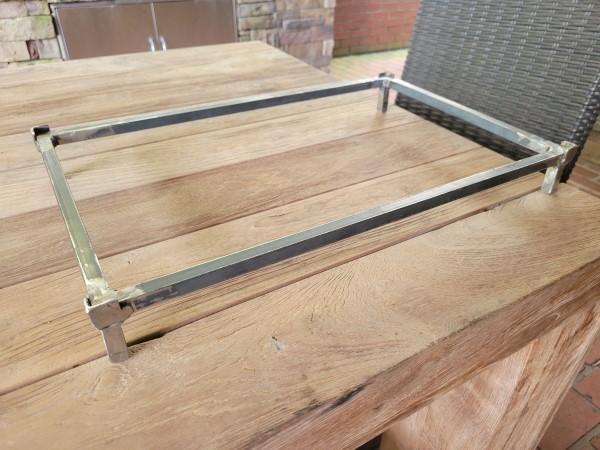

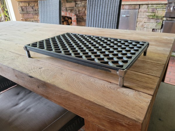

                  • 94

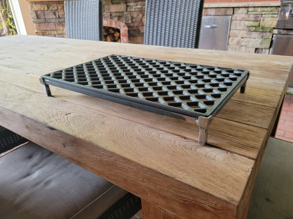

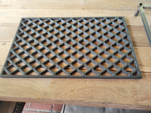

                  My tuscan grill is complete. I bought a cast iron grate made for grills off of amazon. Then I took it to a local welder and asked him to weld on legs. He said that was a bad idea and that the expansion/contraction would eventually lead to the legs cracking off. Instead he made a base that my cast iron grate can sit in. Probably cost me $200 altogether. Haven't used it yet but I like how it turned out! Link to grill grate from amazon: https://www.amazon.com/gp/product/B0...?ie=UTF8&psc=1

                    That should work fine. Good move.
                      Nice looking grill! I like the Tuscan I got from FB but might make a custom one so I can get a pan that will fit underneath and catch all the drippings. I slide a cookie sheet under mine but still get a bit of grease on the bricks, and even though it might eventually burn off I don't like the idea of getting a cup or more of chicken fat on the oven floor.
