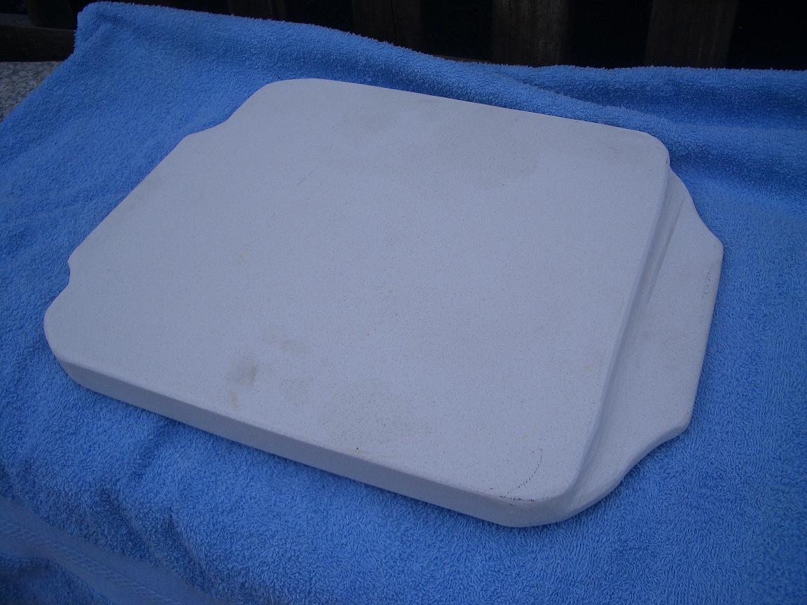

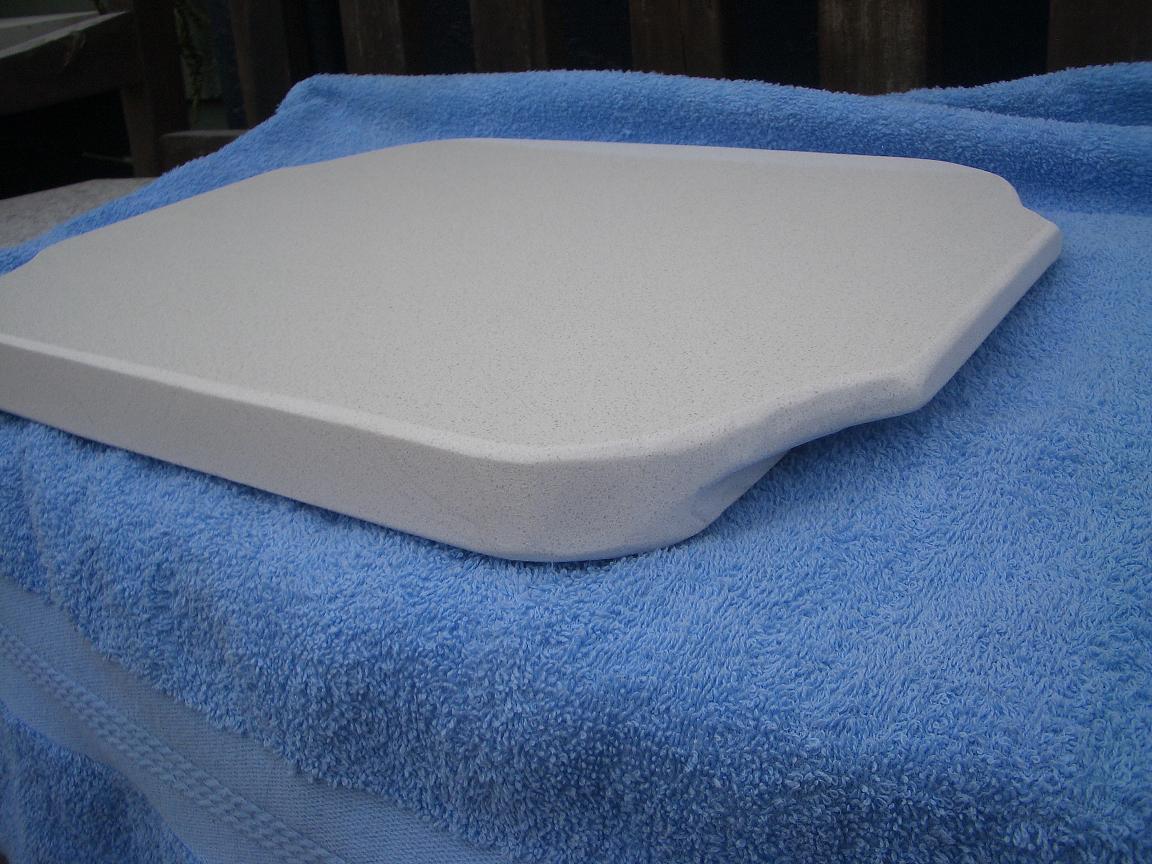

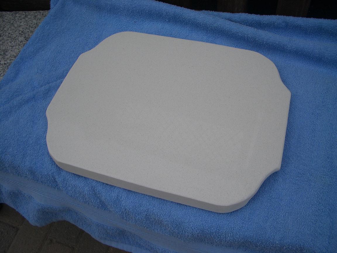

    I saw some people used marble as pizza stones, so I quickly made my own this afternoon, using some marble that I had.
    Dimensions, 40.5 cm (16 inches) X 31.5 cm (12/half inches) Thickness is 3 cm or a inch and a bit.
    Took less then 2hours to cut with a small stone cutting bladed grinder and a normal mouse sander for quick sanding of rougher edges.
    Tell what you think!

    Marble is not very refractory. It is unlikely to handle the heat required to cook the pizzas.

      Re: Home made pizza stone
      +1
      Marble's great for pizzeria countertops and oven staging areas, but you never want to expose it to heat, as it's resistance to thermal shock is pretty much non existent.

        Thank you for the comments.
        I don't have my WBO yet, so I will use it in the normal oven for testing.
        Since it didn't take long to make, I don't mind experimenting with it. I can after all make another.
        And if nothing else, I can serve pizzas on it, to keep it warm, because it does take and hold some heat.

          Ironwave, I'd be very careful with the marble. This is about more than just the marble cracking and being easily replaced with a new piece. We're talking about the possibility of it failing violently. Materials with especially little resistance to thermal shock can, under the right conditions, explode when exposed to extreme changes in heat.

            Okays, thanks for the warning.
            It will be a serving tray or cutting board then.
