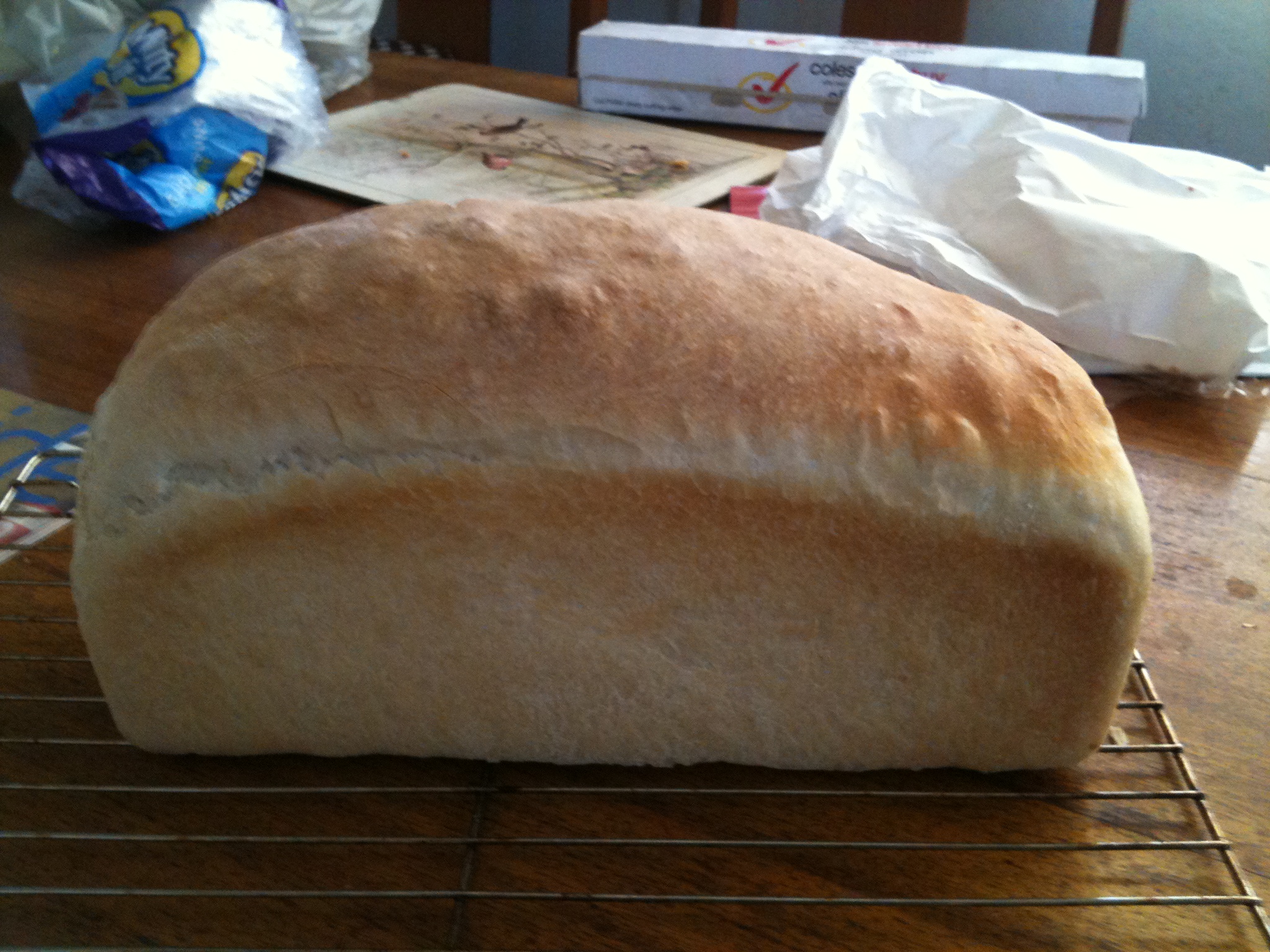

                      Dear Doug
                      Had an old mate over Sat Arvo/night. He's a little bit of a fire man and enjoys camping just for the opportunity to have a fire. He enjoyed the whole fire lighting and oven starting to breath bit. He was taken with the infrared therm and could not believe the temps. Loved the pizza he made himself and (with the help of his wife) even managed to not use to much topping on his pizza.
                      After eating we dragged the fire remains to the oven entrance and just enjoyed a cold beer in front of a warm fire... Poor buggers probably hooked and he away to his oil rig and has asked me for some more info...
                      Sun arvo with the door on the oven dropped to a comfortable 200C and I baked my first Succesfull loaf of bread. Yes the first attempt another time failed due to taking a "nanny nap" after a few cold ales. Nothing special just a commercial mix put throught the bread maker on dough setting but I got to use my old grandads hand made bread tin. Nice bread eaten very warm with a metling butter...does it get any better
                      Click image for larger version  Name:	bread.jpg Views:	2 Size:	1.12 MB ID:	286094
                      Regards Cobblerdave

                        Re: Karangi Dude's 48inch Oven
                        Hi Dave,
                        That looks like mighty fine bread.
                        Dave I would not mind a pupp out of that old bread tin.
