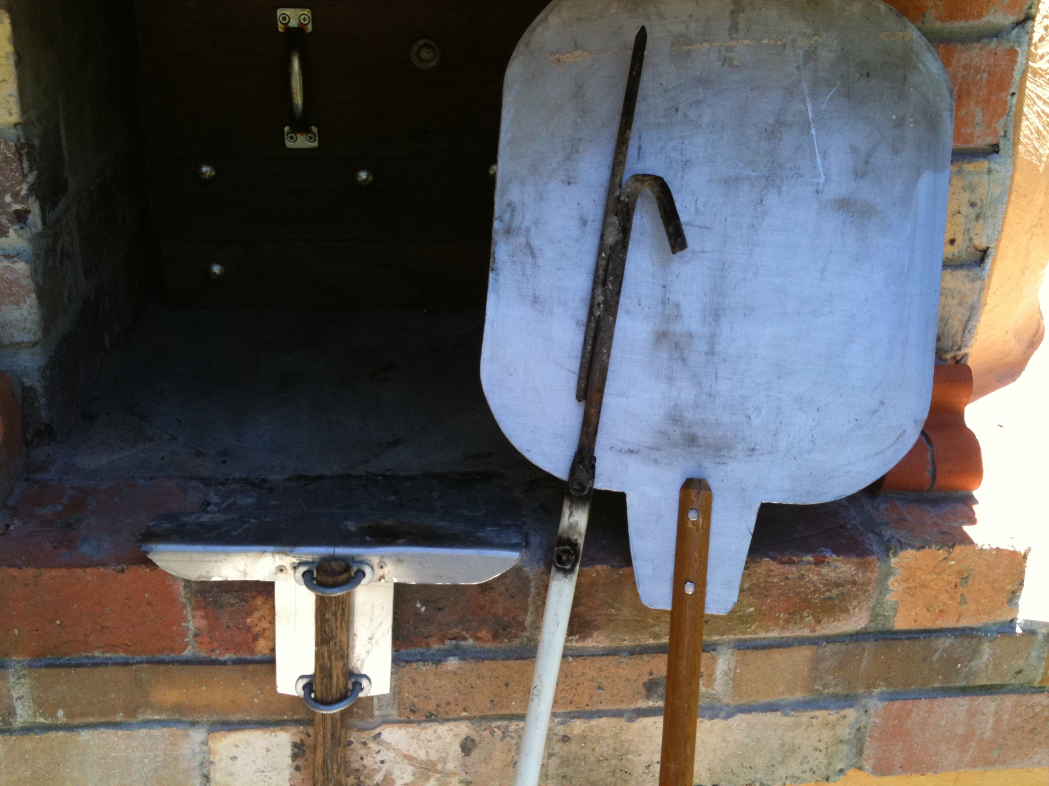

                Re: Looking to buy my pizza tools, any recommendations?
                Dear Gummz
                fins attached my homemades
                The Peel is made from.9mm aluminium which makes it easy to slide under items in the oven. Trust me Mark 1 was 2mm thick and was great at pushing things into the flames. yes its a bit floppy but you use it to transport things in an oven not around the yard. I just polish with a little dry flour and things slip off real smooth.
                The rake is made from 2mm aluminium... thick enough so it doesn't bend. works well but hard to get in to round corners at the front. Thought I mod it or make Mark 11 but it works well enough for me not to bother.Made most of the tools from aluminium so the would not harm the hearth bricks
                The thing that looks like a harpoon is a fire poker and general all round tool. It was invented by JAS and is basically a metal tent peg attached to a metal curtain rod. Its a little cracker... cant beat it for pushing and pulling logs and fire and things around an oven. Its got a bit of weight to it which is what you want. Great to for pulling out a heavy roasting dish as well.
                Brush not shown as its still being reconstructed was basically a Brass wire suede brush screwed to a wood handle. Unfortunatly mark 1 was left in the entrance way while I was distracted and copped a good scorching. Havn't decided on a more fireproof version or just to take more care as the first worked well
                Hope something here will help
                Regards Cobbler Dave
