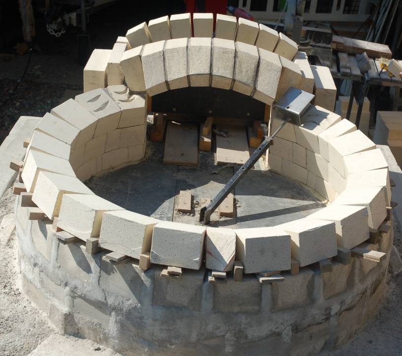

                      Re: Pompeii Oven started Slowly but Surely
                      slowly - a little progress couple of weekends each month ! see attache photo.
                      I will update my thread with a few more photos.
                      Thanks
                      Brett
                          Bert
                          No use rushing... thats good work...firebrick....like the cut above the arch to make the transition from arch to dome smoother...Karanga dude will be impressed
