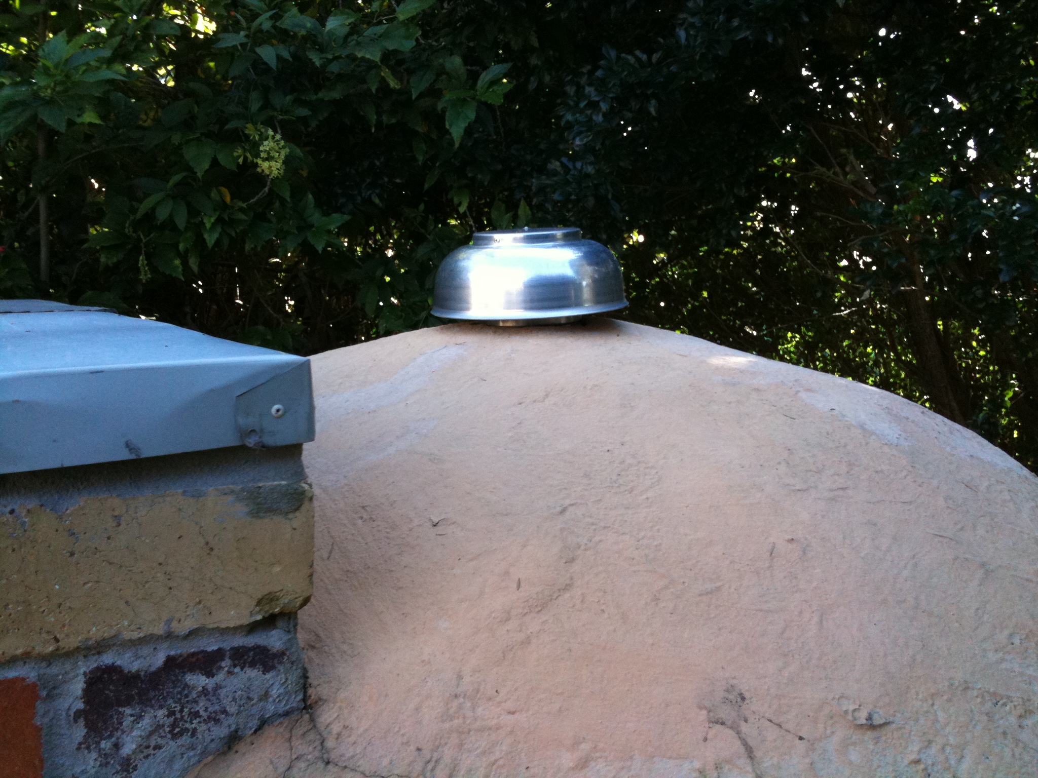

                    Gudday
                    Thanks Davids and Neil 2 I have come to the same conclusion you just can't keep moisture out of an oven in extreme conditions. The bricks and mortar naturally just take in moisture from the air. I have fitted a vent 4 in vent cap to top of the dome in a effort to allow this moisture an escape route. I will have to fill in a largish crack between the dome and chimney with paintable silastic then give Oscars flexable tile mortar a go.( thanks Oscar)
                    Recon it will need a coat of paint it looks a little "stark"
