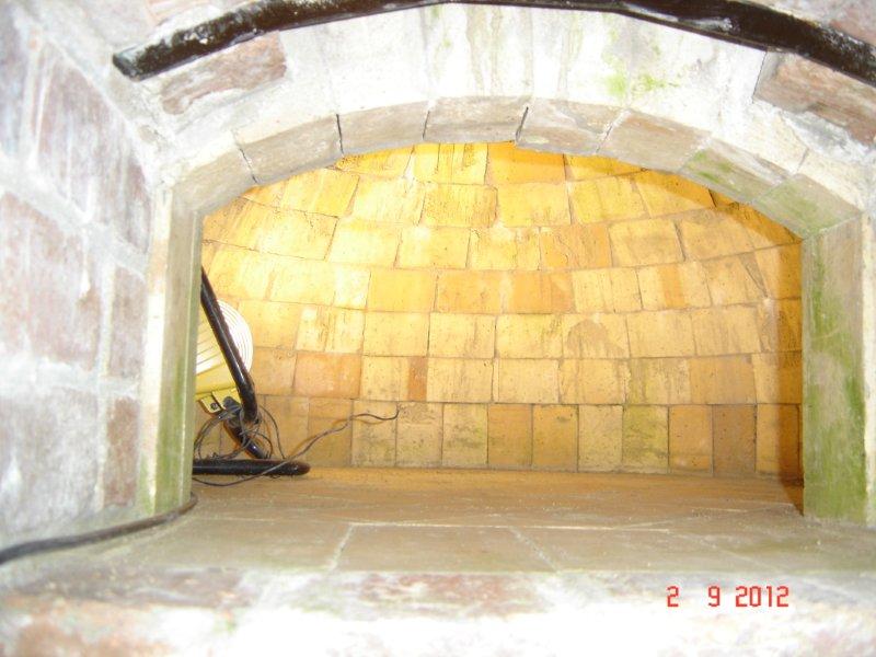

          Re: Oven Build in Adelaide
          Well what a Fathers Day!! Not only did I get a bottle of Glenmorangie and VSOP Cognac, the day on the WFO was spectacular.

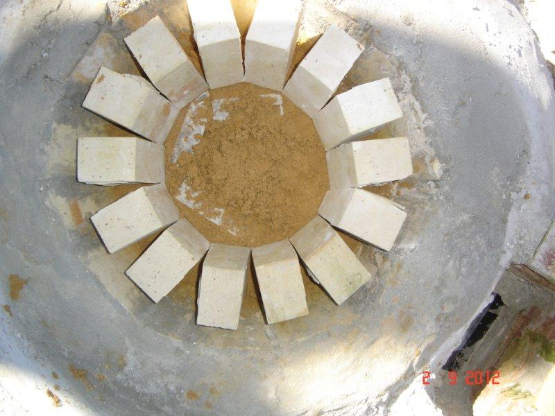

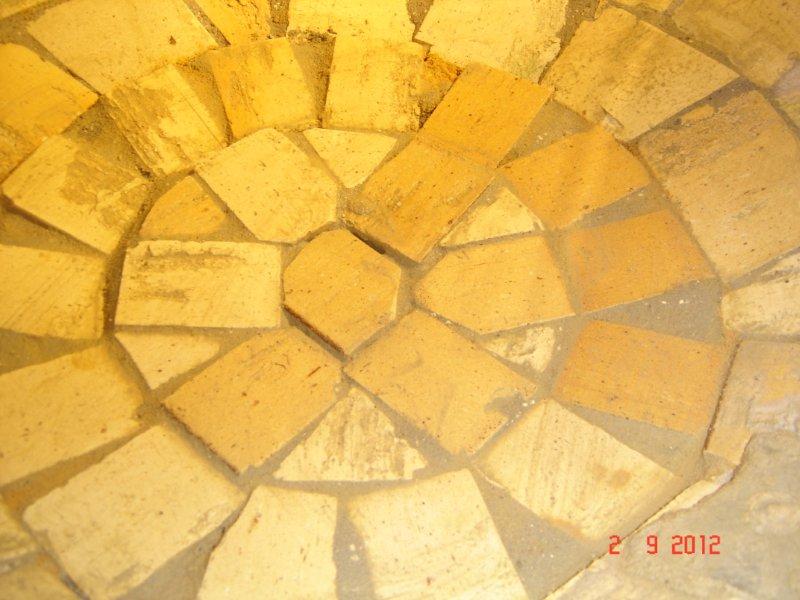

          I re-cut the disk to fit for the tenth row and arranged the bricks for the best fit. Boy this 10th level started doing my head in - shaping each brick to fit, in the end I opted for 1/4 bricks to minimize wasteage.
Name:	ninth course.jpg

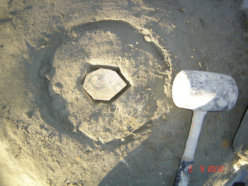

          I put a layer of brickies sand on the disk to support the bricks in the correct position, filling in the gaps with mortar. Managed to get this done before lunch.(Late lunch that is).
          Good day so far, so thought I'd start on the 11th course, which all of a sudden came together with the pieces fitting together quickly. A bit more sand to hold into place and give the mortar a firm base to rest on, and before I knew it I had put mortar into place. I suddenly realised all that was left was the KEYSTONE
          [Click image for larger version
Name:	Key stone ready.jpg
ID:	291069] Click image for larger version
          WOW What an amazing feeling. The dome was now complete.
Name:	seen the light.jpg
          I've seen the light.
Name:	dome complete.jpg
          Sunday never felt so religious, WFO religion that is!!
          Fathers Day 2012 will certainly be a well remembered day. Look out next weekend. The end is nigh......

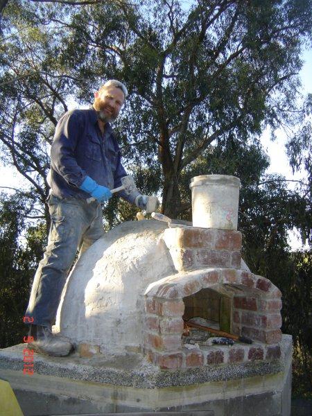

              Weather great today, not that flash yesterday, but managed to get the chimney/flue finished yesterday.
              Was going to start the insulation layer today, but after measuring the finished dome, realised the fibretek blanket was not going to be enough to cover. Will have to get more this week. Decided this was not such a bad thing, with the sun shining for most of this week, I figured the extra warmth from the sun would assist the drying/curing of the oven. The bricks were 5.5 degrees C yesterday and had crept up to 9 degrees today after some rays.
              Spent today looking at the set up of BBQ and Oven layout. Still a work in progress. Also set up formwork for pathway next to house, which will lead to lawn/entertaining area.

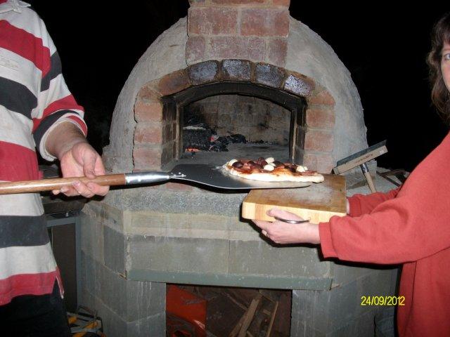

                  Thanks Dave,
                  Took your advice and spent the following week curing the oven. This culminated in getting the oven up to temp by the 23rd of September. Wow to see the dome inners change from sooty black to white was exiting.
                  I celebrated the next day, my 51st birthday, with the first pizza. I even experimented with a new dough mix using Karangi Dudes recipe with potato. Kept the first one simple with meat and baby mozzarella cheese on a home made tomato base from last years tomatoes.
                  Pizza ready to go in
                  And amazingly on the way out
                  Alas the excitement of the first pizza coming out of the oven meant we didn't get a photo of the finished pizza. It was eaten too quickly. Unbelievable, I didnt know pizza could taste that good.
                  We ended up with five pizzas for the night, a marinara pizza, and the most popular was a yiros lamb. This consisted of marinated lamb with feta cheese and olive oil, with a generous spread of rocket after cooking.
                  We ended up making a number of these. YUMMY
                  I have done two more firings since, and each time the pizzas are tasting better and better.

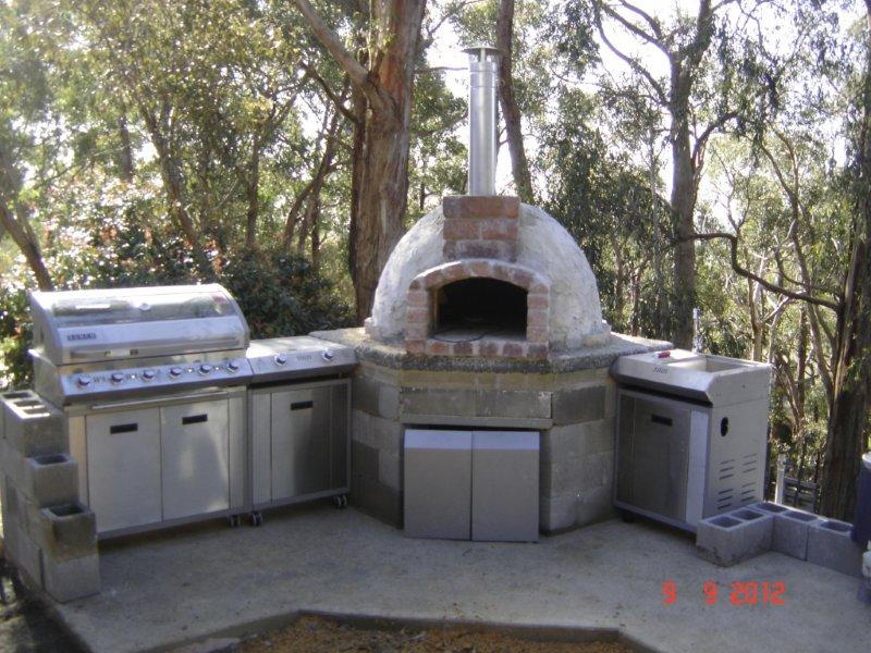

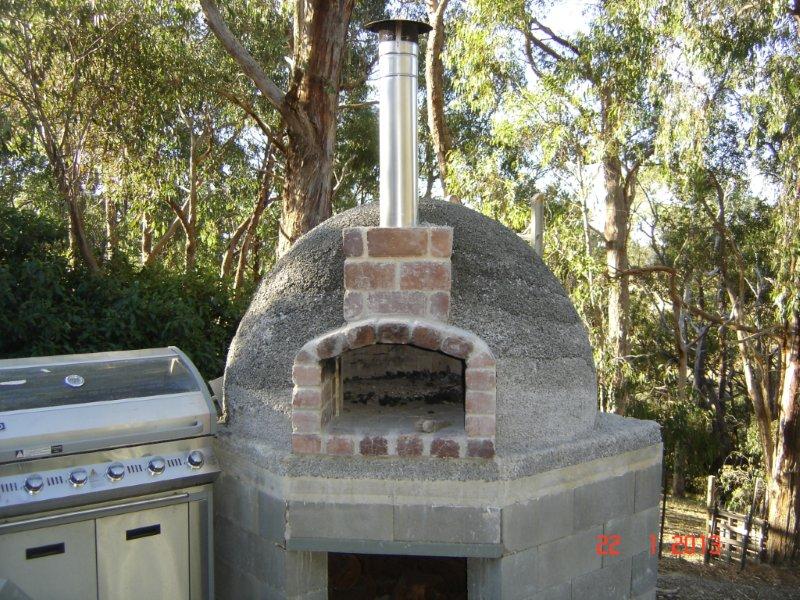

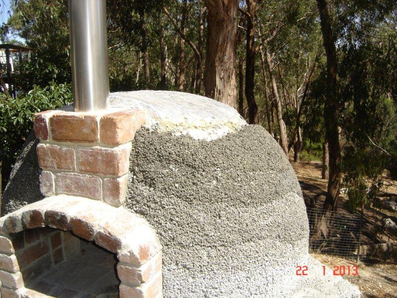

                      Well it has been a while since I did an update.

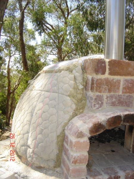

                      The oven progress came to a bit of a standstill after I got the first layer of insulating blanket on -50mm of Fibretek 650.
                      Had to get another roll as didn't quite have enough, so thought may as well try for 2 layers of insulating blanket, but alas was not meant to be.
                      CSR changed the manufacture of the blanket , changing the outer layer from a cloth like material to aluminium foil. Ended up being a pain to use, too rigid, too hard to shape, easily damaged. If it was on flat straight edges great, but not a pompei oven. So gave up as a bad idea and decided to progress to the perlite layer.
                      Then weather on weekends became unfriendly, along with all the pre xmas things.

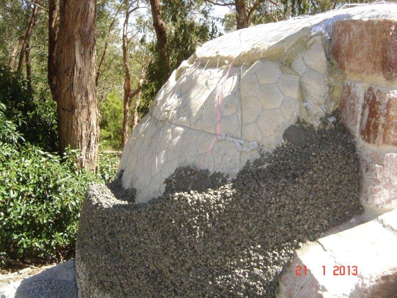

                      So now have managed to do perlite/cement layer over blanket, ended up with over 3" of perlite covering most of the dome.
ID:	292786Click image for larger version
ID:	292787Click image for larger version
                      With 37degrees forcast on Thursday,this shoud help cure this layer. I will do a small fireup on the weekend when it is cooler to make sure the whole
                      dome is dry before rendering. Dome has been covered with a tarp to keep it dry, and oven has been fully cured, with 6 or so cookoffs.

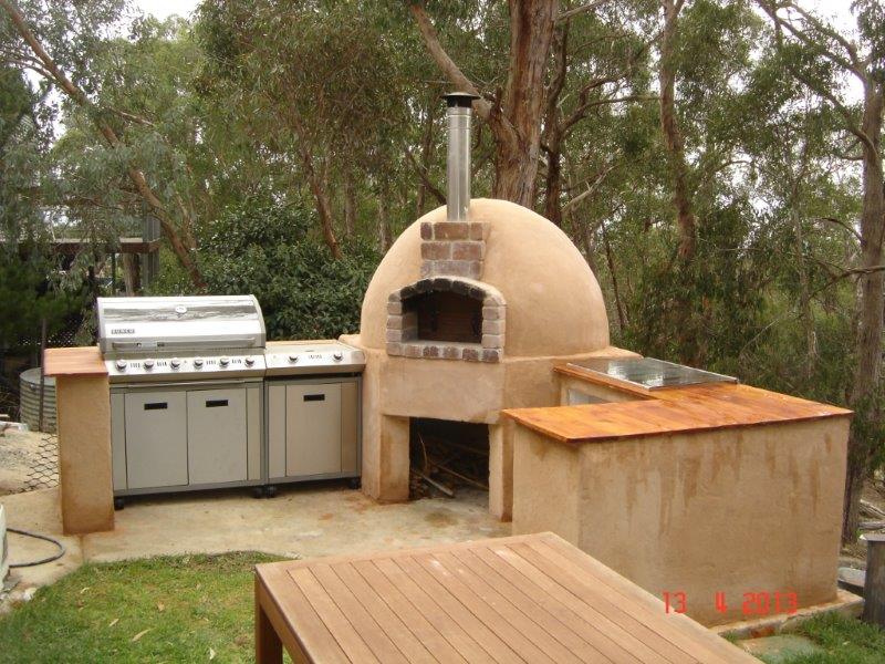

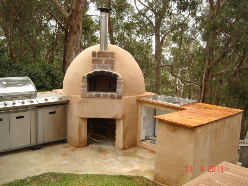

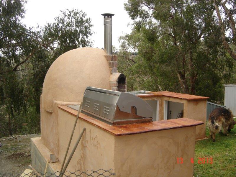

                          Well Team, after some time the oven is finally all finished. The second coat of render went on last weekend.
                          Pretty happy with the look.
                          Have now done the cabinets and benches, with just the doors to go and cutting the hole for a sink in the corner.
                          Layout seems to work well for ins and outs of pizzas.
ID:	293840Click image for larger version
ID:	293841Click image for larger version

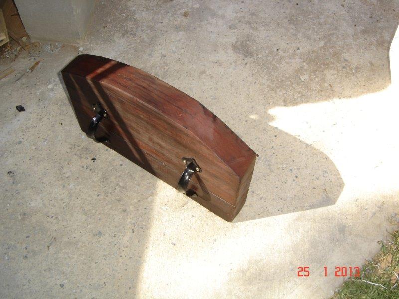

                          Have made a door out of an old piece of Jarrah. Works well, just need to do a bit more shaping to create a better seal.
                          Have already had great success in multiple days cooking, pizza night and then roast the next day. The leg of lamb I did was the most moist and tender I've ever done. Even the vegies in their jackets were amazing. People could not believe that it was all cooked by the residual heat of the oven.
                          Thanks to all that assisted in this project, particularly my son Jarryd for his help-particularly when I was attempting to be a rock climber standing on the ledge at the back of the oven.
                          This part was the most difficult of the build, glad I've still got a reasonable sense of balance at 51, though the hamstrings and calf muscles were killing me at the end of the day.
                          I guess a sensible person probably should have put up scaffolding!!

                              Nice build....
                              Your door will probably catch fire.....
                                Originally posted by brickie in oz View Post
                                Nice build....
                                Italians traditionally use wooden doors. I've read they used to soak them in a bucket before placing. If you only use it for roasting and baking below about 250 C it should last ok, but don't leave it in place for hours trying to save oven heat or it will char.
