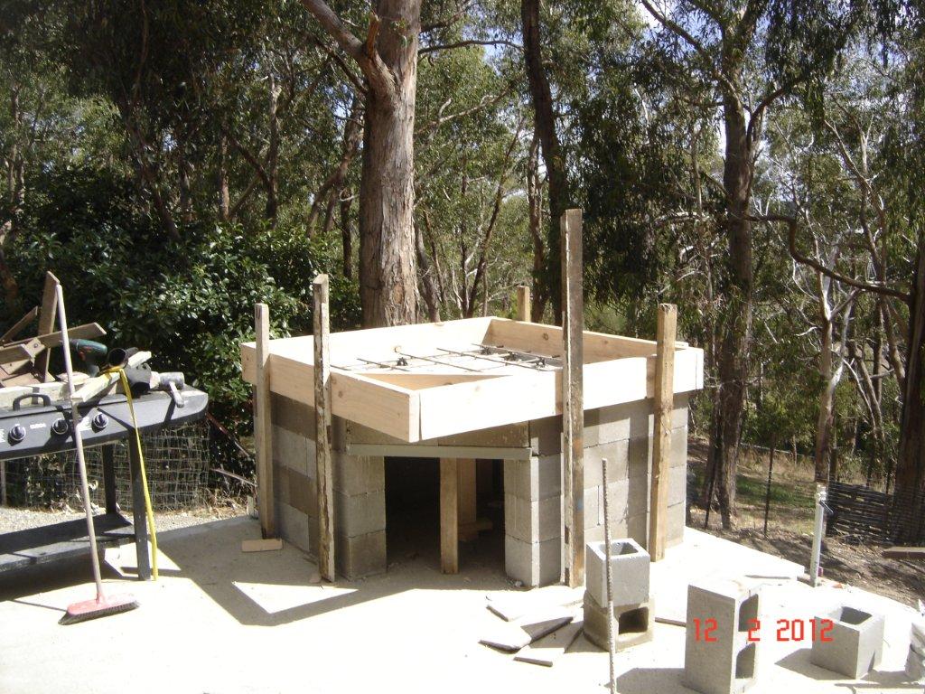

Started in January 2012 after lots of thinking and planning (This forum has been great). The oven is located at the back of our house on a 5 metre bench I built. We live in the Adelaide Hills (flat ground - WHAT IS THAT!!) overlooking Second Creek (with view to Port Adelaide/Outer Harbour) at the rear and Cleland at the front. So a picturesque setting for the outside oven/BBQ area.

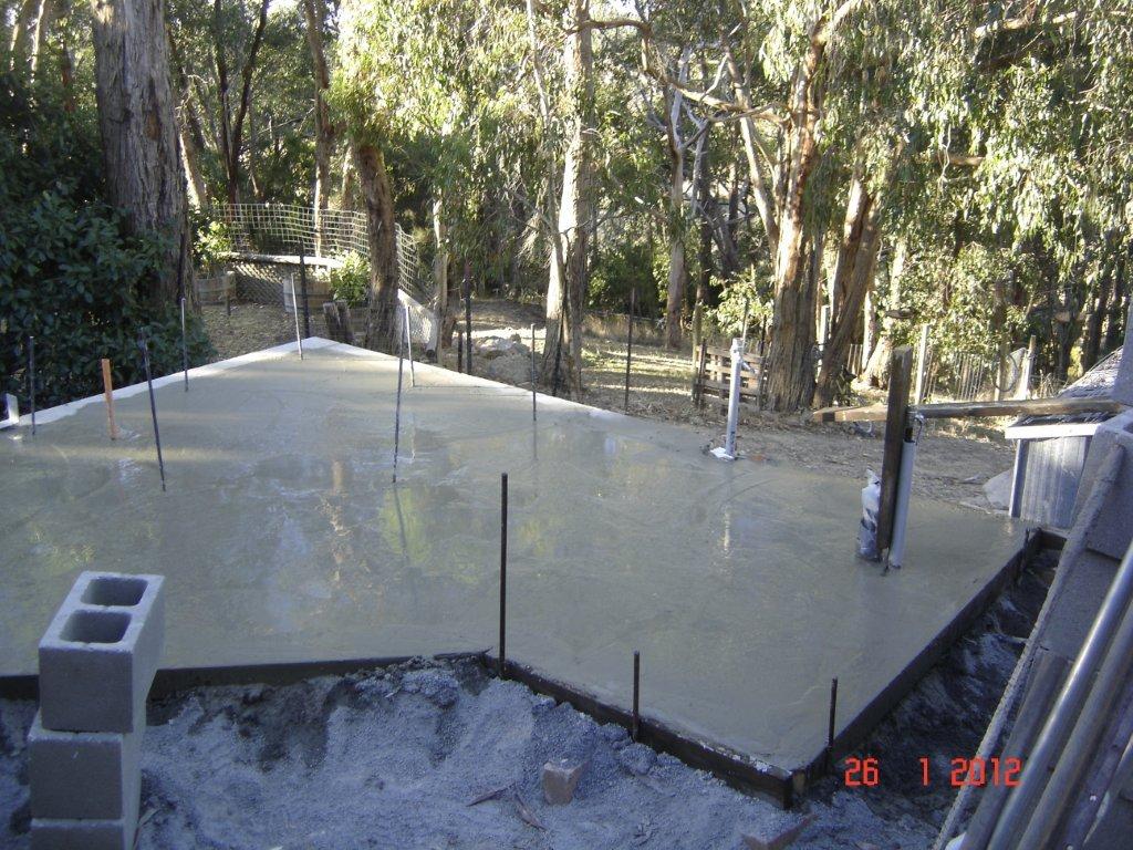

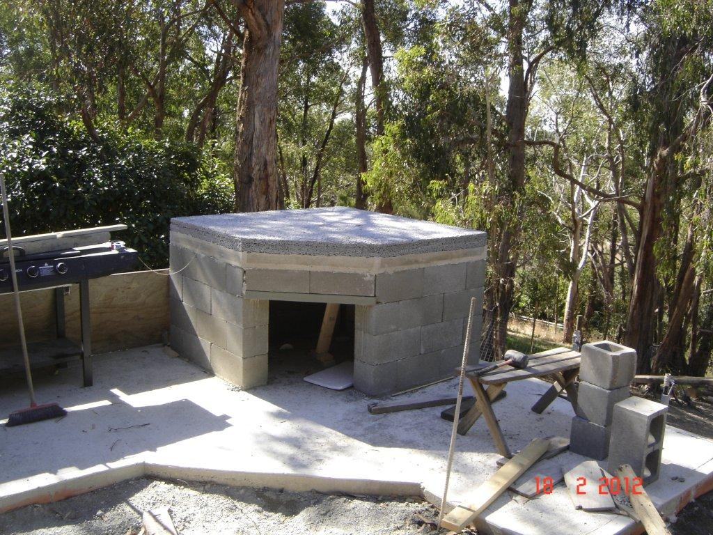

The base slab is tied into the retaining wall with plenty of steel and concrete. The base is besser blocks with reo rod filled cores. The reinforced slab and insulating layer are 100mm thick each.

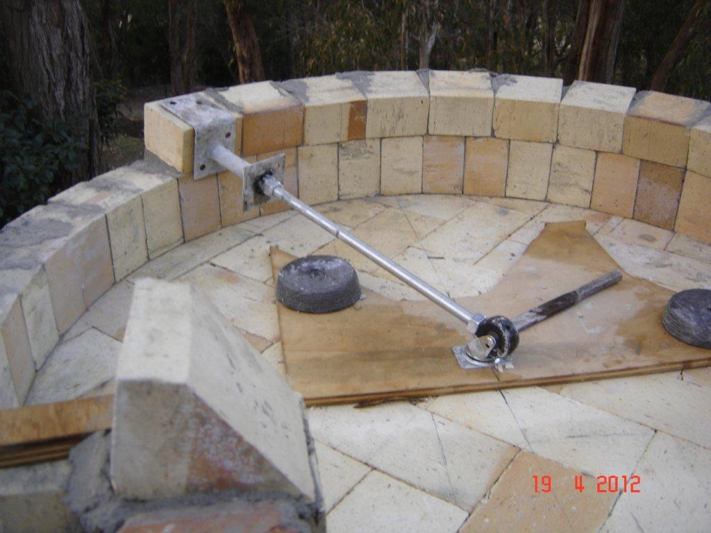

I sourced fire brick 'seconds' from Littlehampton Brick and opted for firebricks in the dome. The hearth laid, I got to work on the first course. I made what i now know as an indespensible tool, from a pergola stirup, threaded rod, nuts and a caster wheel which allowed the arc and swing needed.

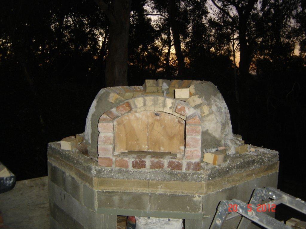

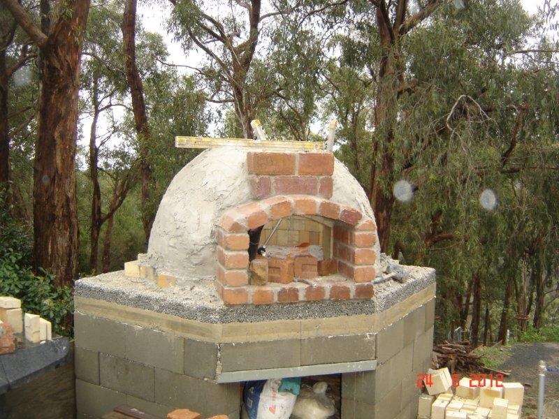

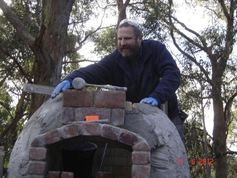

The first course laid, with the entrance opening in place, the next few courses went down easy using refractory mortar(sand.lime,cement & fireclay) and the dome took shape. I used brick from the original house constuction (15 yrs ago- who said you have to rush these things!!) to form the entrance arch. Many hours used trying to get my headspace right to tie arch, entrance and dome together. Not an easy task - wish I had my fathers engineering brain!!

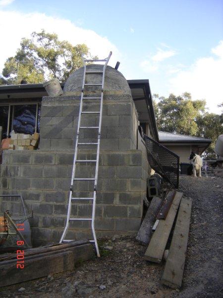

I am now on the seventh course of bricks, slowing a bit now with the angle of the dome, and height (with the edge of retaining wall right there), the vent is being formed in preparation for the flue and I can almost taste the first pizza.
