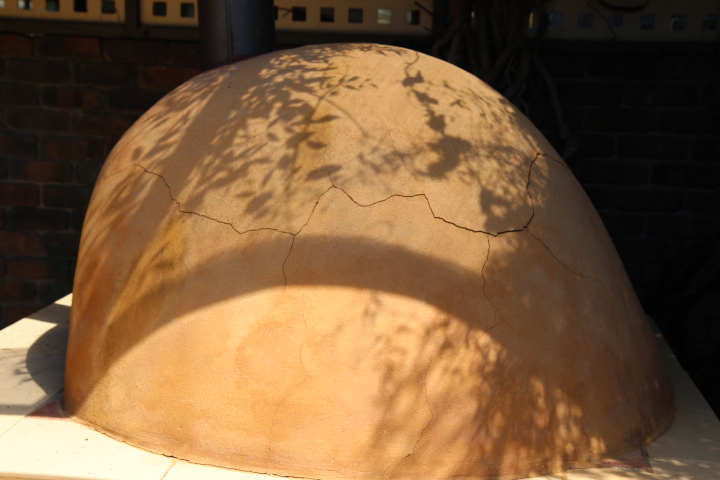

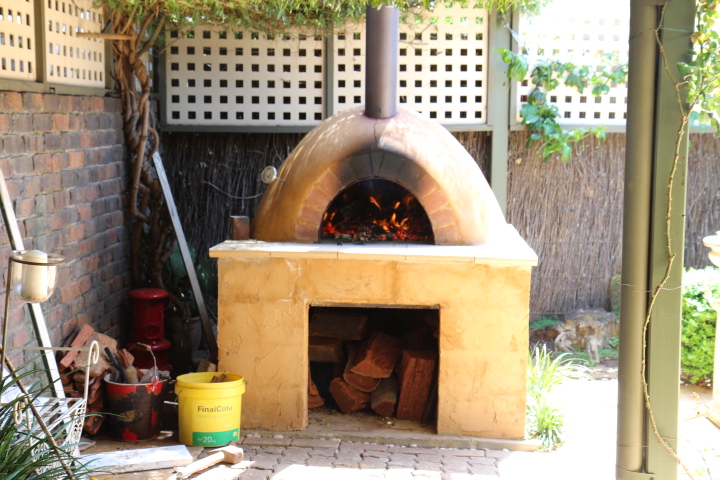

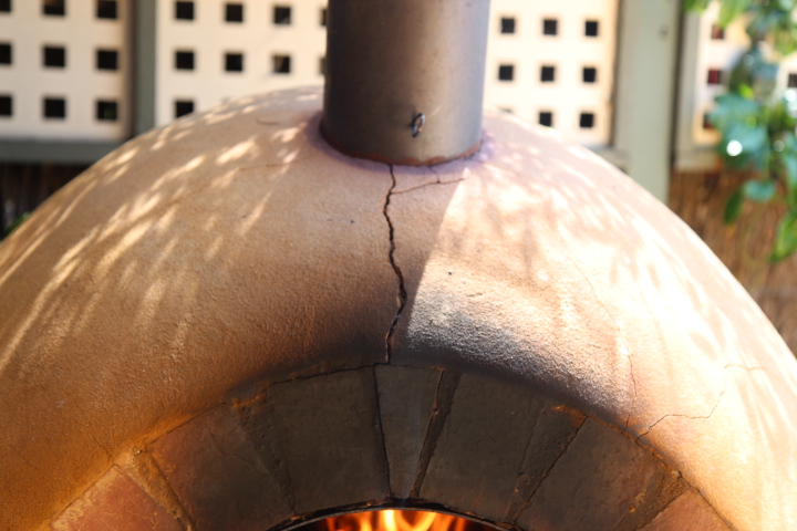

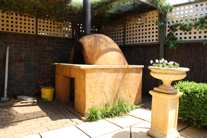

        i've uploaded a few pics of my first oven. overall it turned out nice but you'll see i made a few mistakes in the construction and design process, it works really well from a practical point of view, but it ended up cracking quite bad. these pics were taken after a recent fire up, so once its up to temperature it tends to expand a bit and the cracks become more pronounced. its i bit unsightly but doesnt really impede the performance.
        this oven was made of clay pavers for the cooking floor, and pressed reds for the dome. its got at least 100mm - 150mm insulation made from vermiculite and cement. theres plenty of insulation, once fully fired up its still only cool to touch.
        mistakes that i made in the process were, i never used any chicken wire in the insulation, only used vermiculite/cement insulation. although a good insulator i thing as the dome expands, because theres no flexibility in the insulation its forced to crack.
        i never cured the oven properly, got too eager and fired it right up.
        lastley, the chimney flue is inside the dome, at the time of making this i didnt understand the behaviour of smoke and the necessity of the flue infront of the dome to draw the smoke up and out. so although it cooks well, on initial fire up it gets really smokey, and most of it comes right out the mouth.

          Re: Adelaide Build Quest, refractory advice
          Hi Rob,
          You should repair your oven as soon as possible, do not allow it to sit uncovered in the rain, otherwise instead of a repair, you will need a redo on your stucco.

            It looks like you did a great job, it looks really nice.
            From my experience getting the flue right is the most difficult part of a wood oven design and construction. After I finished my dome I spent days working with different designs to keep the smoke out of my face.
            In the end I got it about half right. This is one think I will change when I do my next one!
