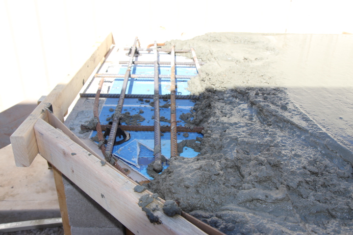

          Hi,

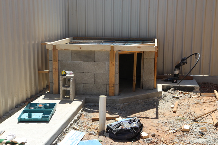

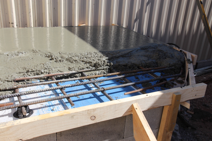

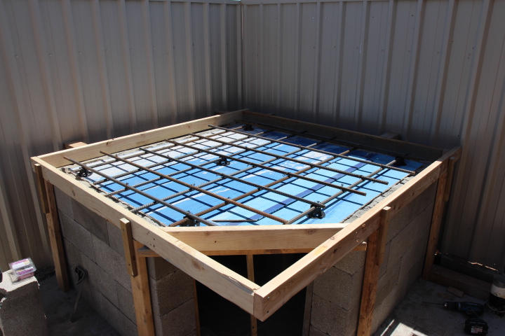

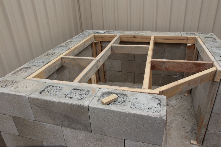

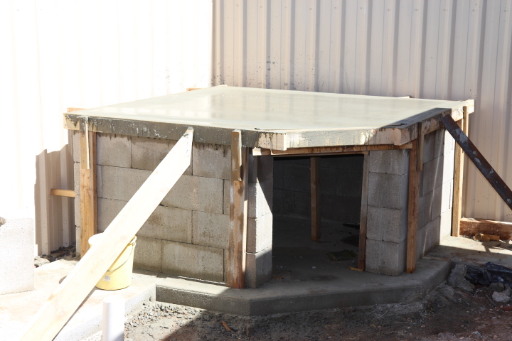

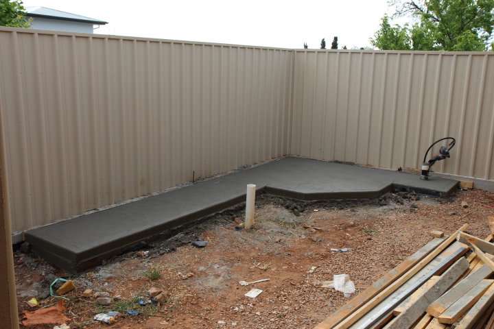

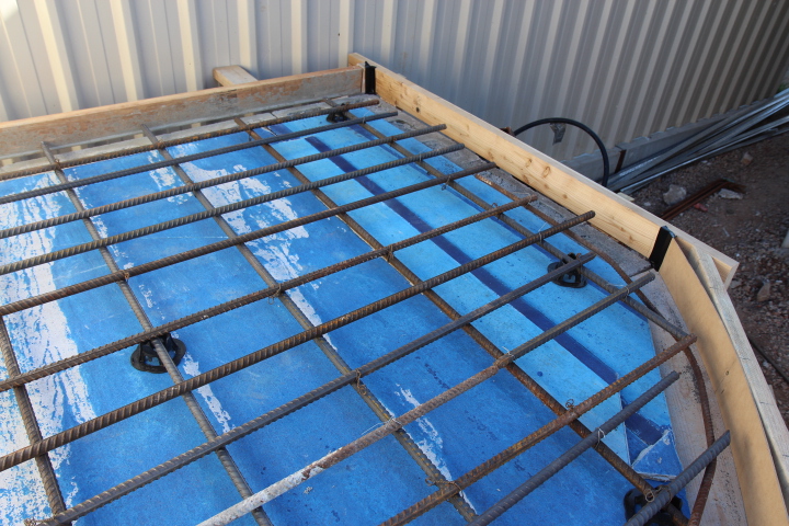

          so, i've finally collected all the reqired materials and have managed to make a bit of progress since i first posted on here, the attachents show my progress to the hearth floor, its coming along nicely

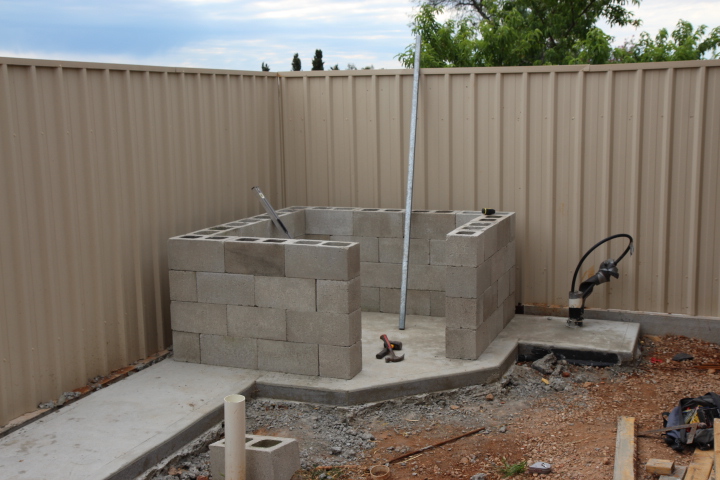

            Re: Adelaide Build Quest, refractory advice

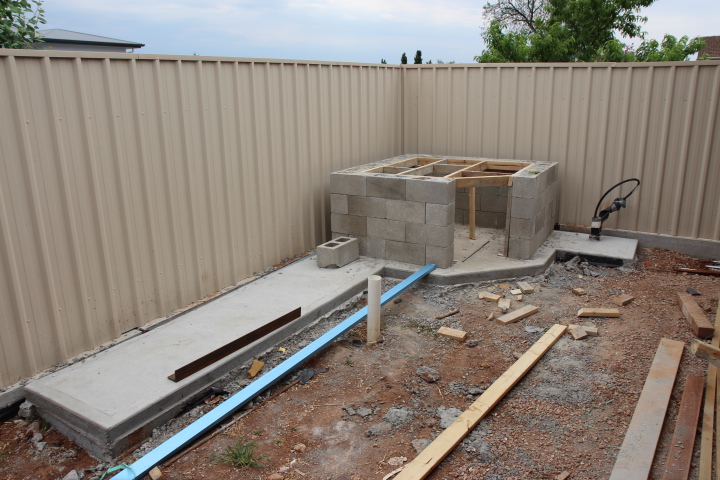

            more of the base

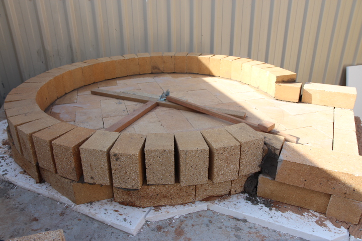

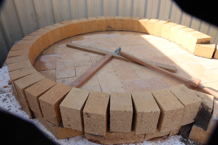

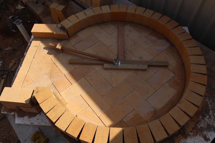

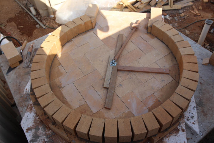

              finally started the dome.
