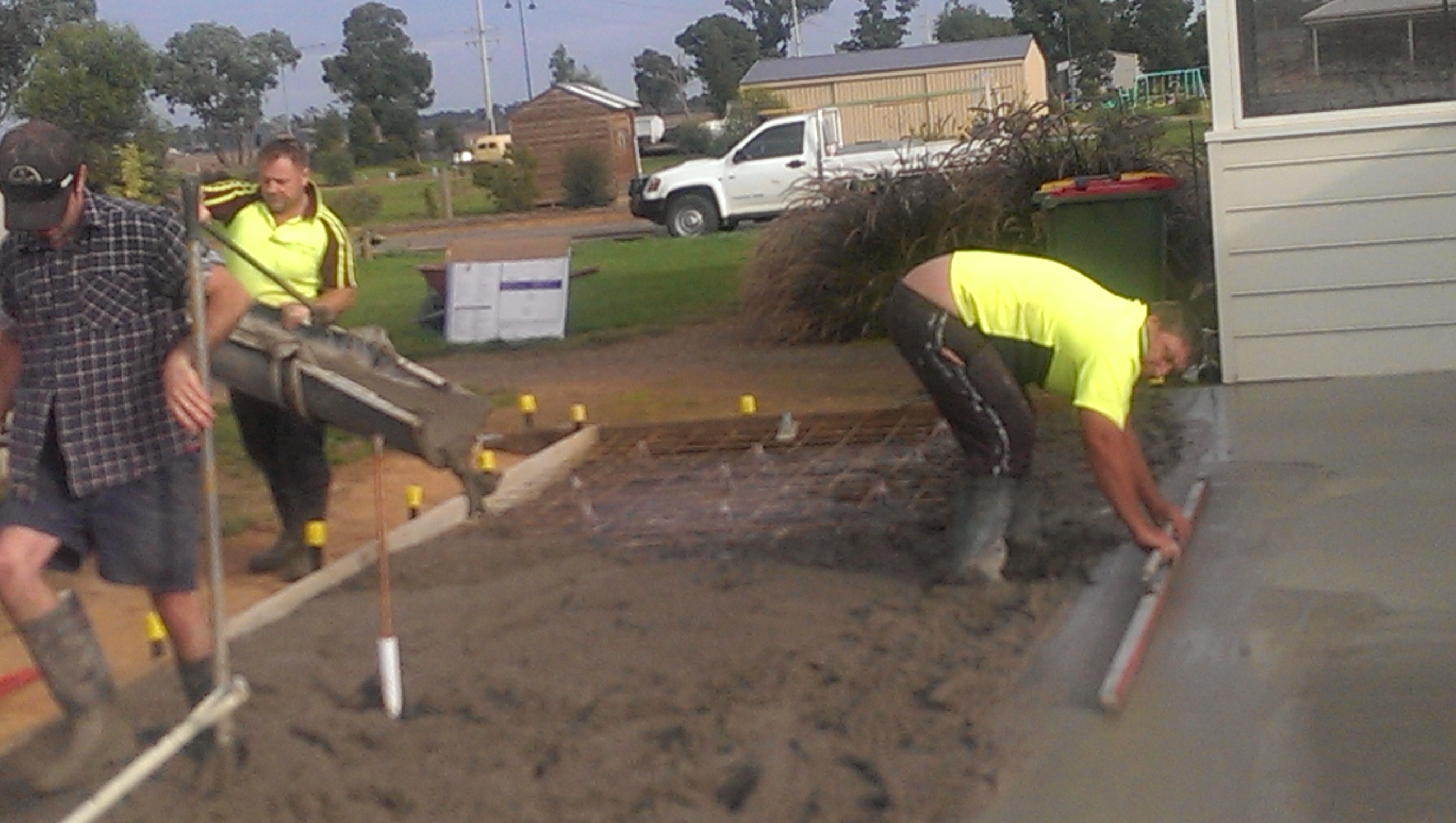

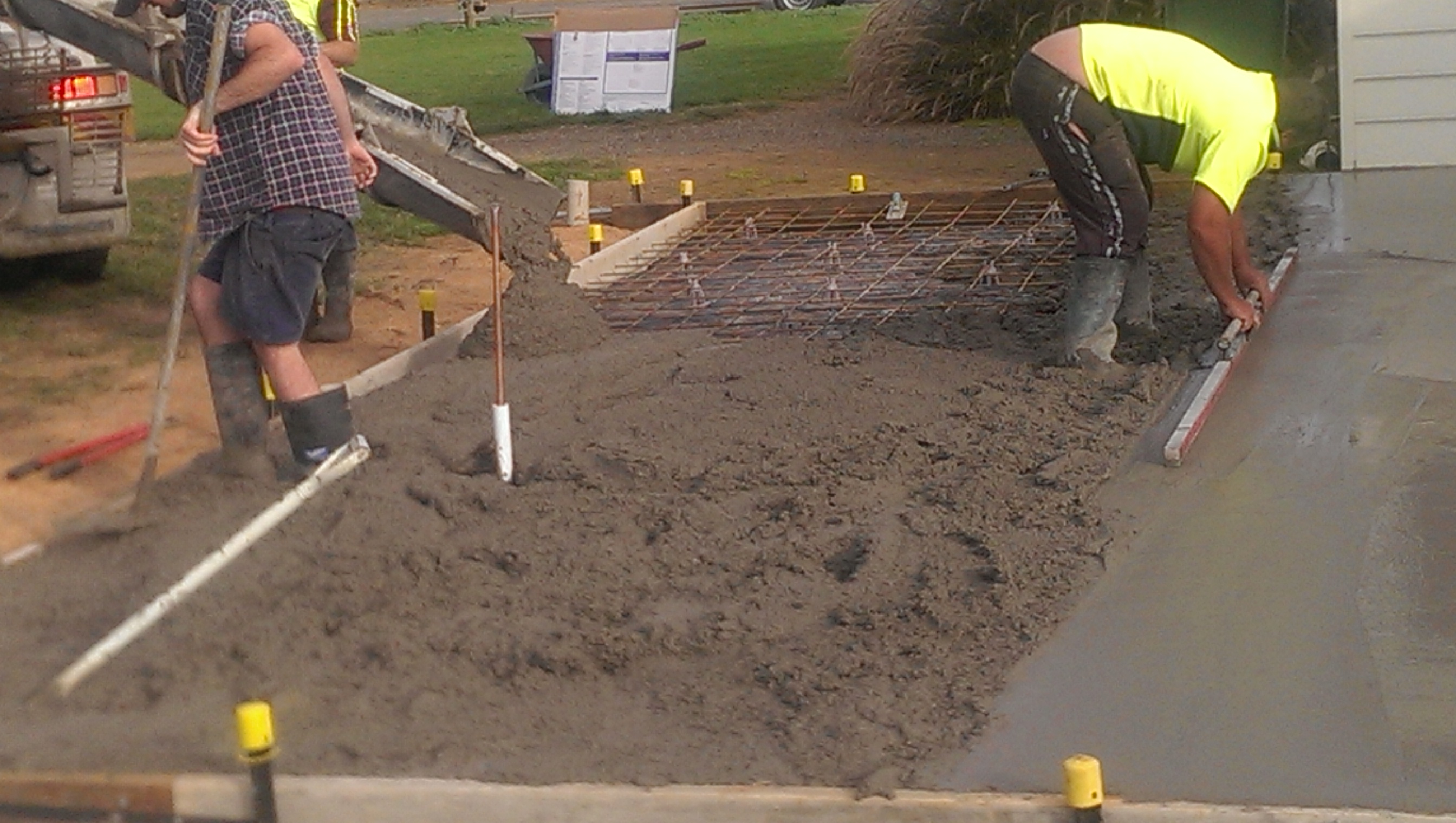

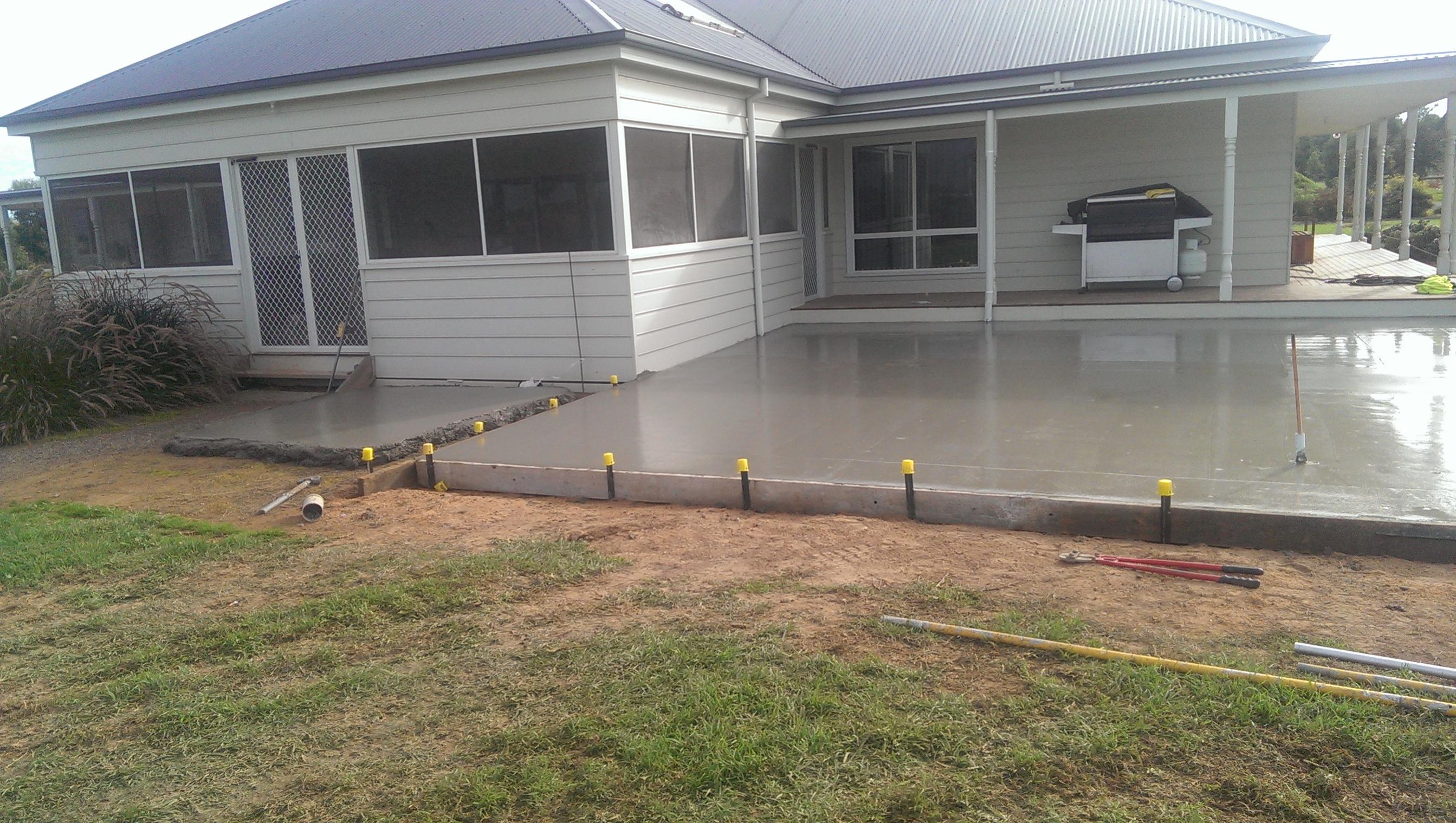

          Well here are the photos of the slab. The whole slab is 150mm thick as we are thinking of putting a spa in the back left hand corner. I also put natural gas out to where the bbq is going. No more running out of bloody gas half way through.
          Cheers John
