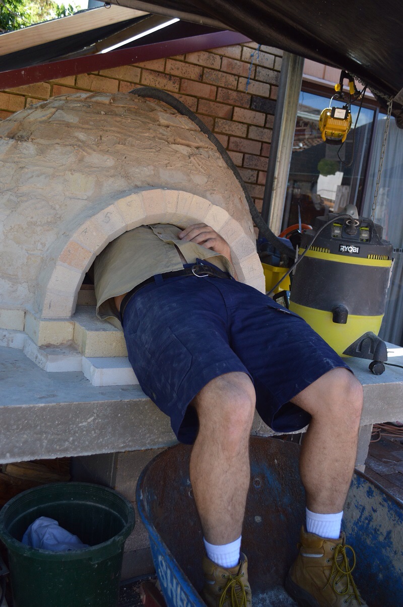

                                #60
                                Re: New build in Sydney
                                G'day
                                Commonly known as a breach birth
                                Regards Dave
