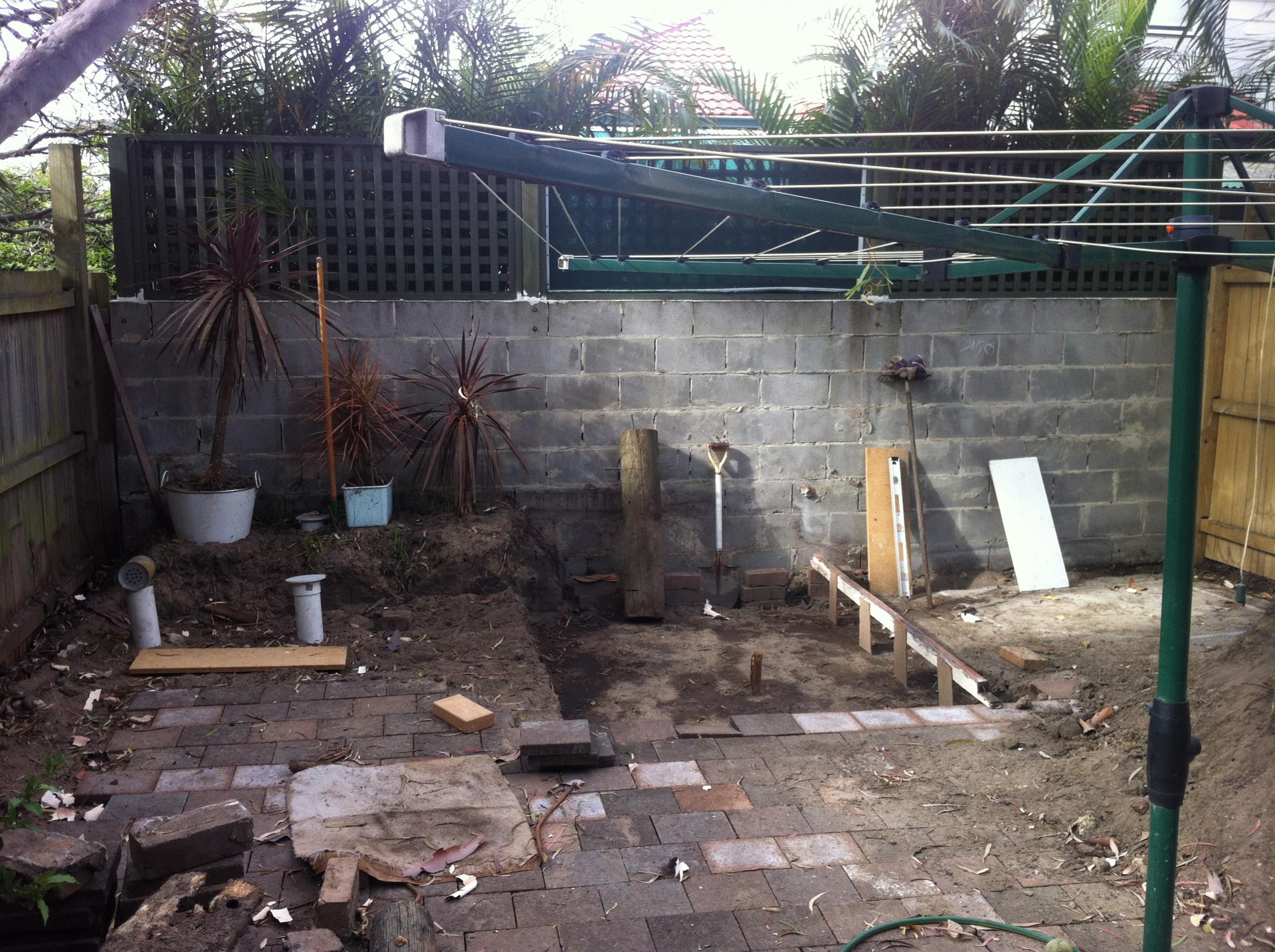

    OK, success with a piccie. Seems the iPad won't do it but the iPhone will. Go figure...
    The piccie shows the back of the garden and the area where I've dug out for the foundation. It'll be dead centre on the back wall but NSW rules and regs mean that I have to keep it 450mm from that wall. I'll be building a low wall either side out of hardwood sleepers about a metre from the back wall and that will be the sum total of garden. It used to come out a lot further so I've got a lot of dirt to get into a skip at some point.
    You can see a vent and inspection pipe on the left for the sewage which were within the original raised garden. I'll cut the inspection pipe back and re-route the vent closer to the wall. You can also see an existing slab on the right where the shed used to be. I was going to put the oven on that until I found this site, did some reading and realised that 40mm of unreinforced concrete poured onto a layer of bricks may have been fine for a tin shed but not the best of support bases for a WFO.
    For one reason and another, I can't pour concrete until nearer the end of this month. But say a week for it to cure and then I can lay the blockwork walls by the beginning of November. Then it's hold on the oven and get the garden up to scratch before I can think about the hearth. With luck and a fair wind I may be able to start the dome in December.
    Well, that's the plan.

              G'day Wozza
              Just a small thought....... Back to the garden bed at the rear of the oven . Mightn't be a bad idea to tank that wall as well, be right neighborly not to be the cause of a big damp patch on the neighbors side of the fence.
              • Wozza
                • Apr 2014
                • 141
                Re: New 36" Pompeii in Bondi
                G'day Wozza
                Good point.
                The raised garden on the left was originally higher (and a lot deeper) and ran across the back wall to about the right hand side of the area cleared for the slab. I had plastic sheeting behind it and it seemed to have protected the wall OK in the 5 or 6 years it had been there.
                When I come to finalise everything I'll fix some sheeting to the wall just about level with the top of the soil and run it down to the wall footings. That should keep the wall dry.
