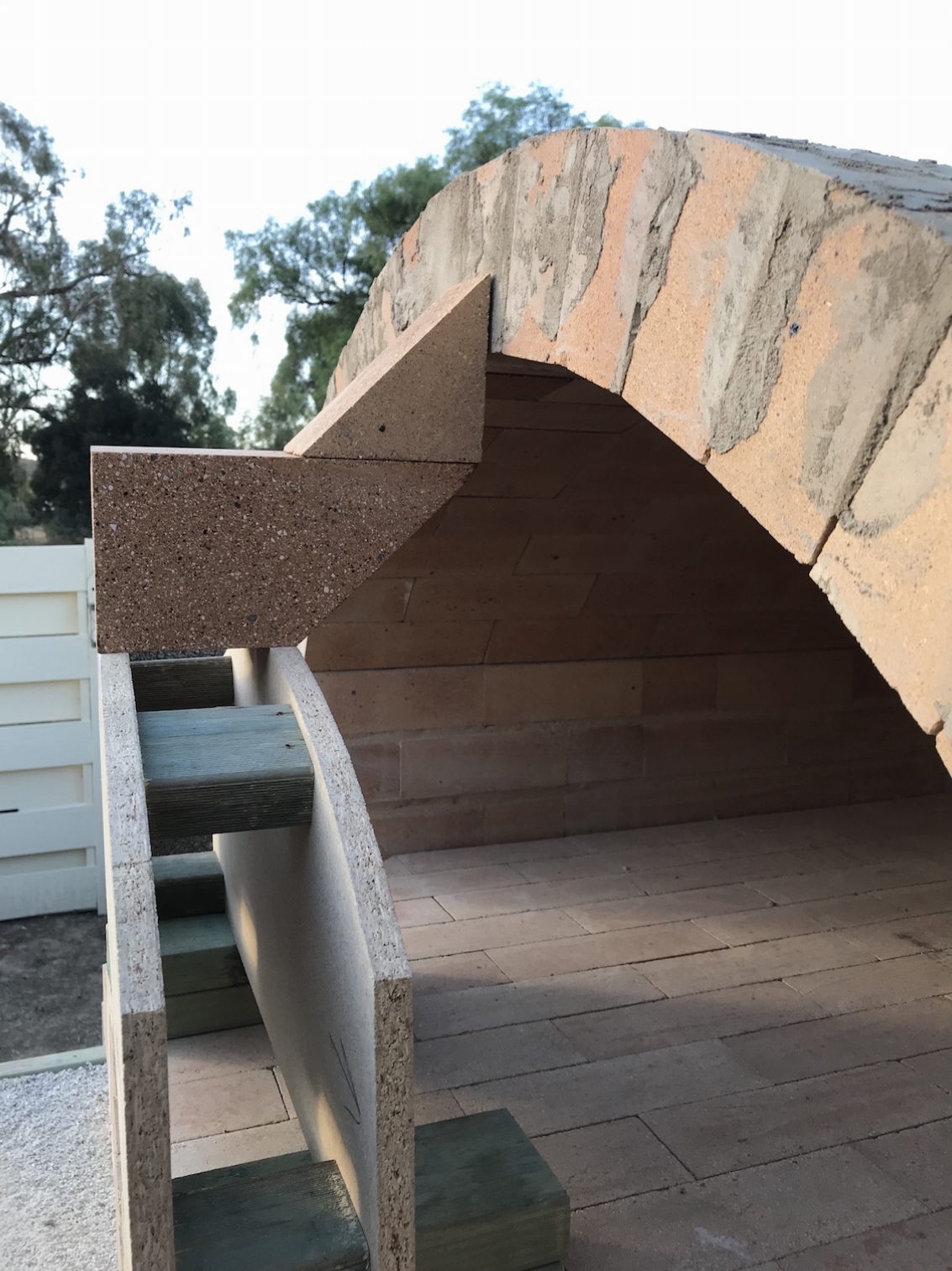

                          #42
                          Set the door arch form in place and after tapering the arch bricks I then back cut them at 45 deg for a more tapered transition, laid the sides bricks and did a dry run of the arch bricks

                            #43

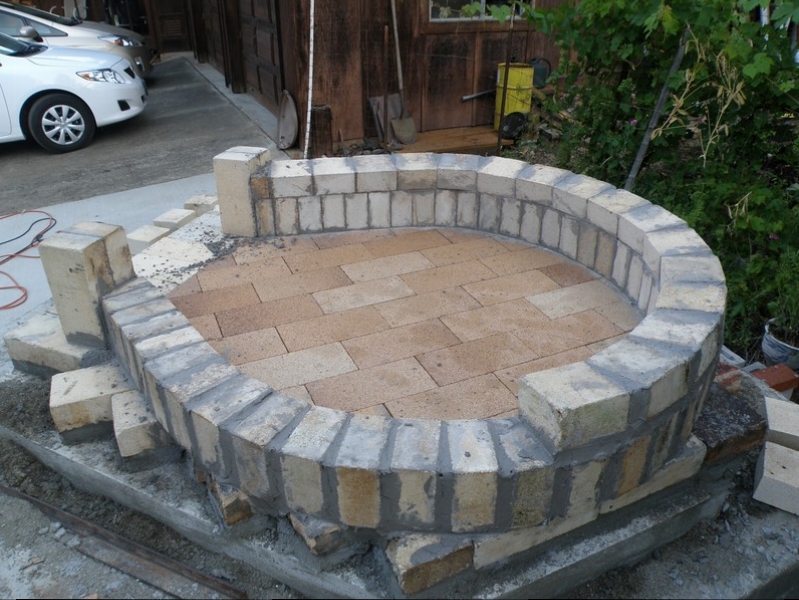

                            I did not taper the entry bricks, but instead matched their edge with the inner curve as the oven pursed out. The other name for the Montreal oven shape is a beaver tail. I attached a base picture and one of the almost completed oven which shows the "beaver tail" shape. As I noted before, I think you're really going to like how the smooth transition to the oven mouth works.

                              #44
                              Mike,
                              I have cooked in a few barrel / vault ovens and they didn't have the taper, I thought that the space either side of the entry was wasted and how hard it was to clean the ash out that is why I tapered the entry of this oven, using a scraper and broom to clean out any spilt mortar I can see already how well it works.
                              Also with having the back of the arch bricks tapered up at 45 deg it is creating a curve similar to that of an igloo, the space at the top of the door arch bricks will be filled in with another row of half bricks that will be at a right angle to the vault ceiling this will act like a smoke shelf for the smoke to curl before it gathers to go down the taper to exit out the door arch into the flue gallery.
                              It all sounds good in theory but the proof will be when I fire it up, I plan on lighting a smokey type small fire so I can watch how the smoke flow works, I then plan on wrapping it up with insulation and start to cure it the same way I have all the other ovens I have built or helped build and that is with what we call heat beads (charcoal brickets)
