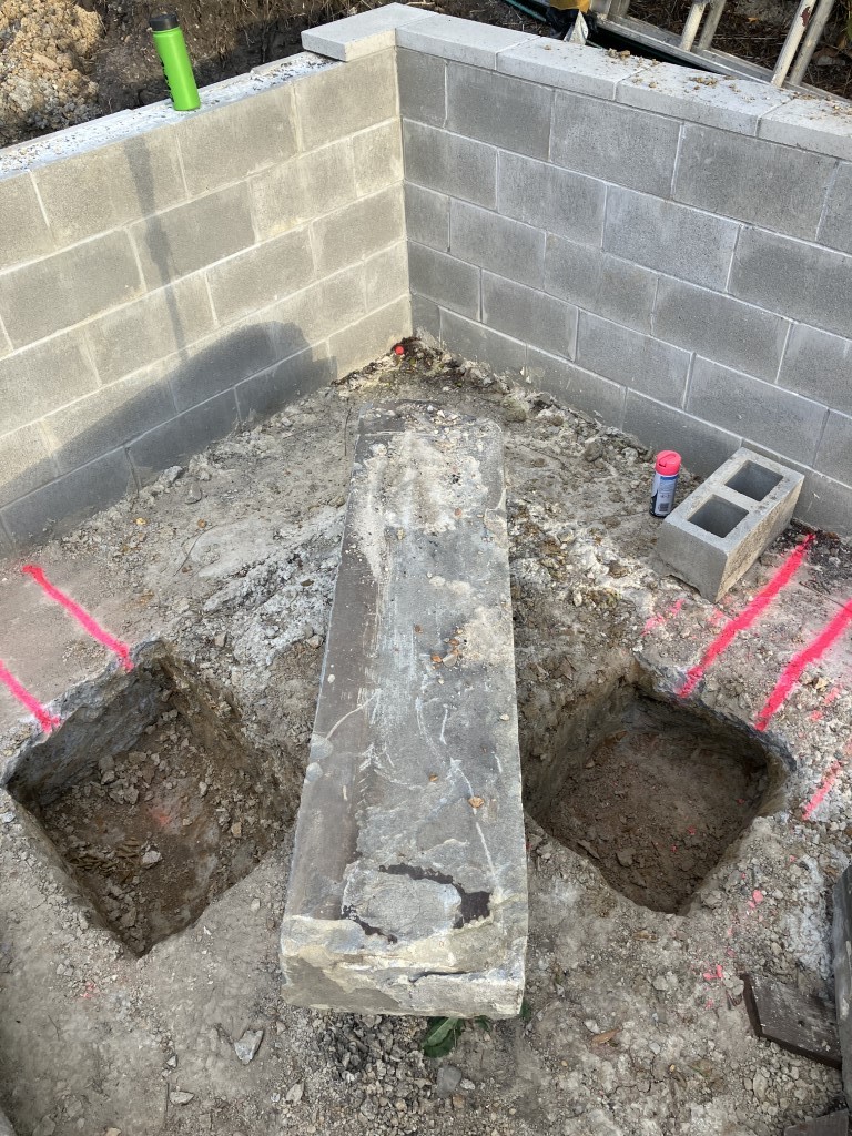

      As the existing strip footings extend out a decent distance out from the retaining walls, I just dug out a couple of extra pads, added some reinforcing steel and starter bars for the blocks and concreted the footings to create a good base for the stand.
      If you are wondering what the stone blocks are, they were old house piers that were on site that we decided to keep and repurpose into some steps and seating to the new terrace area. They were too heavy for me to lift, I got a guy with a machine to help move these into place a bit later on.

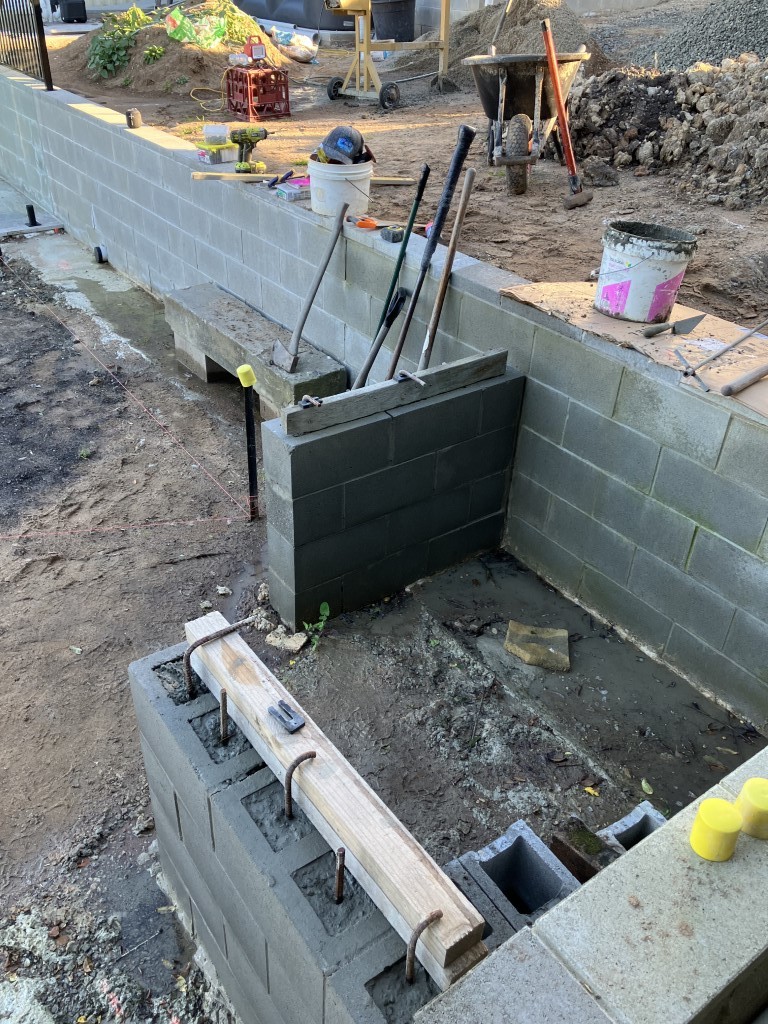

        Got our block layer back to lay the extra blocks. Added horizontal and vertical starter bars and core filled with home mixed concrete. Bought an old mixer to make things a bit easier for me on site. Click image for larger version

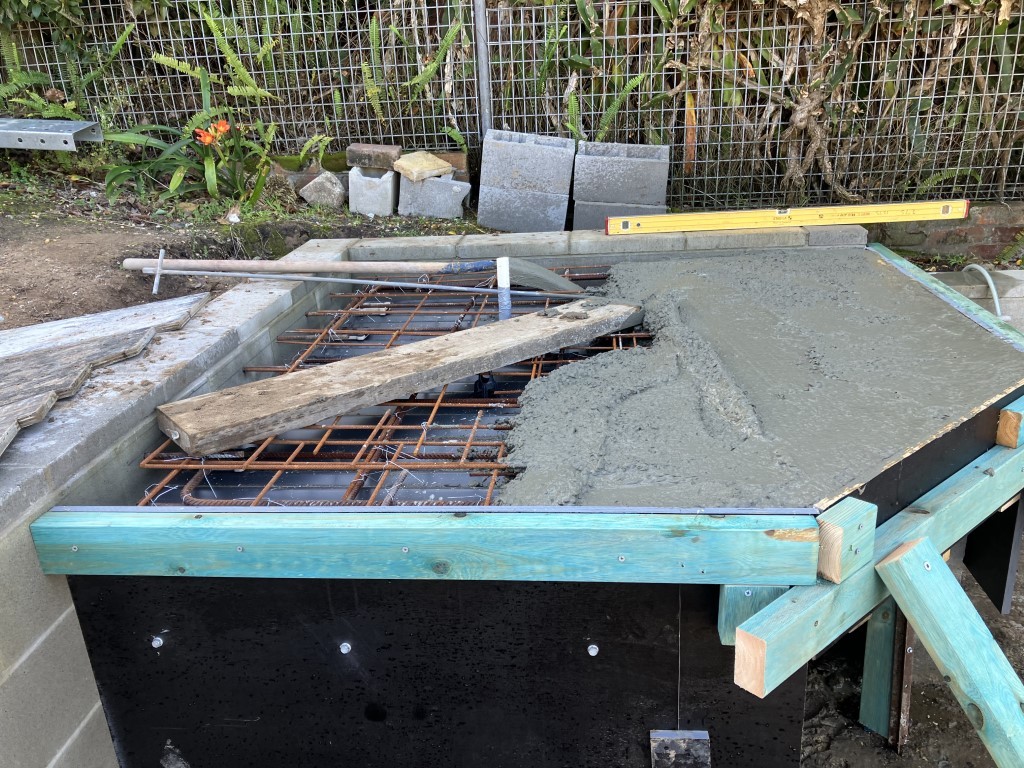

          With around 140-150mm deep RC slab (and 190mm plus thickened edge beam to perimeter of stand), top of slab will be just under 1000mm high.
          Added lots of dowel bars into existing walls, plus internal perimeter beam screw bolted into blocks.
          Sacrificial corrugated iron cladding to base of suspended slab, temporary timber supports under.
          Form ply to perimeter as formwork, screw bolted to blockwork.
          Went crazy with lots of bottom, top and edge beam steel, with steel and slab thickness I dont think it will fall down any time soon.
          Added plastic electrical conduit in centre of slab too as drain hole for any moisture under oven floor.

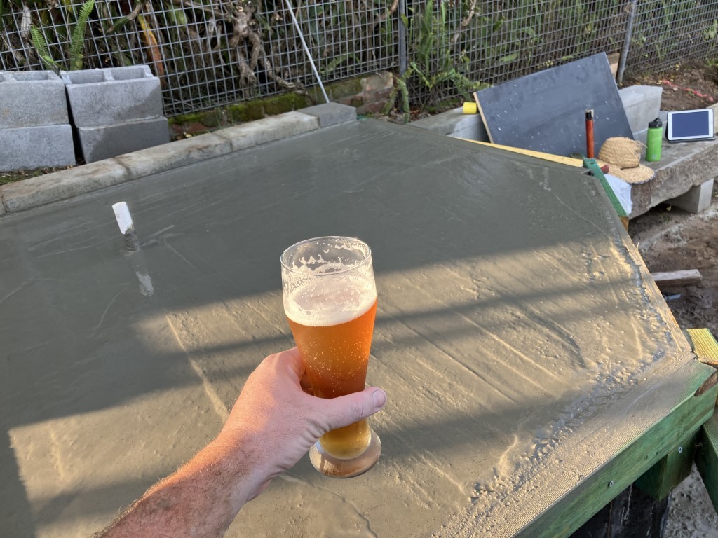

                Didn't realise how long it would take to mix by hand and it was dark by the time I got it in. Could have gotten a better finish on it if I kept going back to it but was getting a bit late and I was over it by this time. Will probably be tiling the slab surface later anyway so all good. Put a bit of fall from back to outsides and also centre slightly higher to reduce water ponding under floor. Will just add some sand under floor to level up later. Beer always tastes nicer when you have done a bit of concreting! Click image for larger version

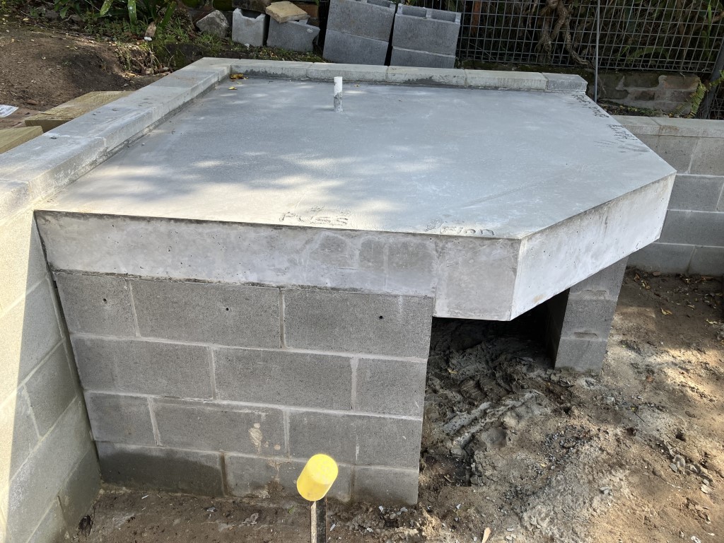

                      So the slab was poured last September, then worked on some more landscaping and edging to get ready to lay turf to this terrace area.
