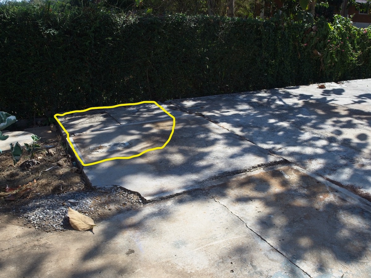

    I am building an outdoor kitchen at my house in Loei, Thailand. The centerpiece will be a wood-fired brick oven (WFBO) using the Forno Bravo Pompeii oven plans. I am also relying upon the forum at https://www.coolthaihouse.com/ for specific Thai constructions related matters.
    The previous owners had a structure between the house and carport. This was torn down, but the slab was left. Some of it is uneven, so I will have a new reinforced slab poured over it. The yellow line is where the oven will go.
