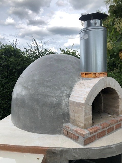

  • TxGR
    replied
    The exterior is now complete except for a coat of epoxy paint to protect the surface.
    Click image for larger version  Name:	67E40710-D528-43D4-923C-D92FE691C2C5.jpeg Views:	0 Size:	74.6 KB ID:	428334
    Click image for larger version  Name:	8C46011A-00B2-471D-9275-830B1EBAB576.jpeg Views:	0 Size:	78.6 KB ID:	428336
    Click image for larger version  Name:	0124010A-D6B6-4629-ACB9-EFC537D8E3C6.jpeg Views:	0 Size:	85.8 KB ID:	428335
    The decorative brick was added to contain the firebrick, and I like how this ended up.
    The last to be done is refinishing the cap of the ceiling (inside). We hope to do that this week. Then we can properly fire up.
    Then paint dome exterior with white epoxy, and make a metal clad door/plug.

    Here are some pics of the blanket being put on. They have since finished the exterior, but we still plan to paint with white epoxy paint.
    Leave a comment:
