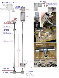

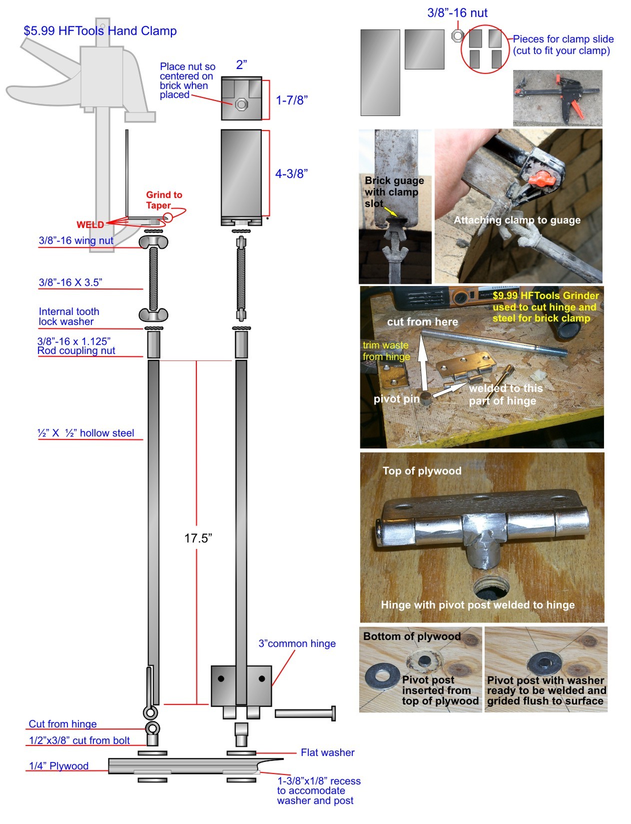

      With the advent of using tiles on the hearth as the base layer with weep holes, I am not sure that FoamGlas gives you any advantage now (although that is what is used in 2011). The newer ThermoGold 1200 CaSi is water resistance as well. A more budget friendly option would be 5 to 1 pcrete with tiles/weep holes. I snooped around on classifieds/facebook/habitat Restore for materials as well. But it takes time. Here is a pic of a good baseline IT plan from one of our members that is not too difficult to build. The IT has to have the correct design to work correctly.

        Thanks UtahBeehiver. I actually printed that IT design and added it my planning folder the other day. Not having used the tool it’s hard to know what makes for a good design so I am glad I picked one that comes highly recommended.
