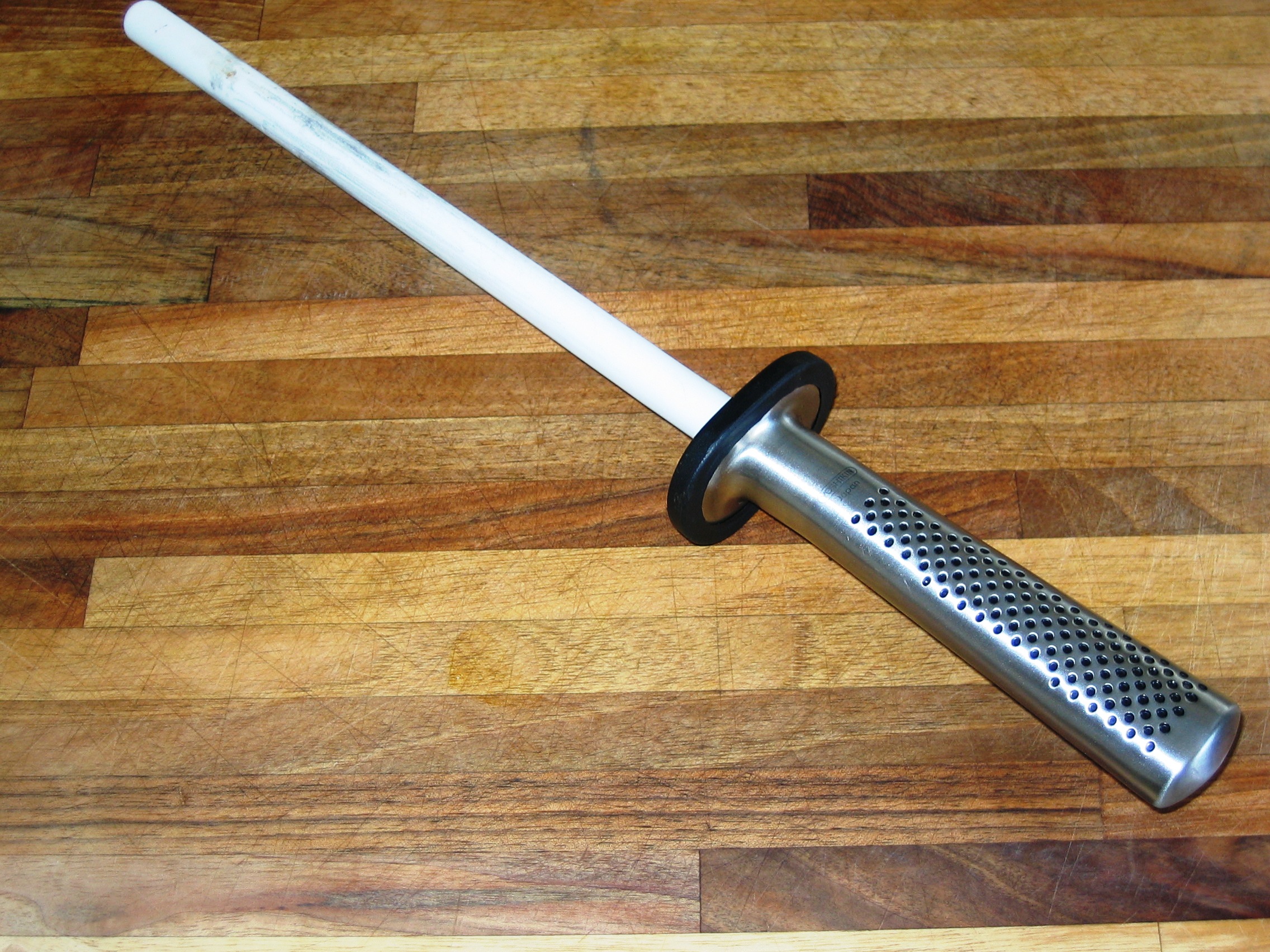

          For many years I used Sabatier steel knives and kept them sharp with a normal steel and whetstone. I then discovered the Global knives. They are made from Cromova 18 stainless steel. This is ice hardened to Rockwell C56-58. It holds the edge like no other blade I have ever used (although I would like to try the Kyocera ones) It also means that normal steels should not be used. I have a ceramic 'steel' for sharpening on the fly

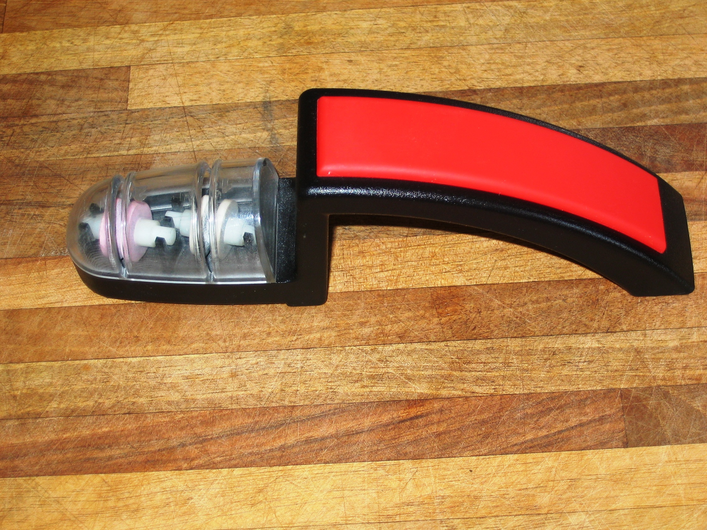

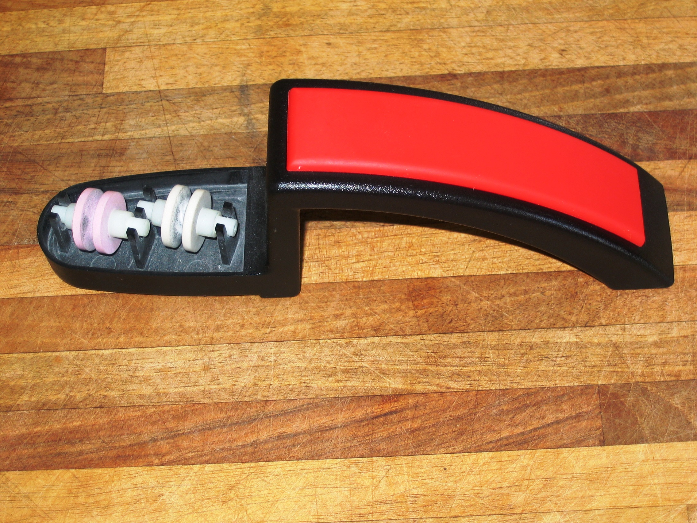

          My water ceramic sharpener is designed specifically for Global knives and is an easy and safe method for periodic maintenance.
Name:	water sharpener.jpg
          It consists of two ceramic wheels, a coarse white one and a medium pink. Water is put in and because the groove in the stones is offset to the slot for the knife it provides the perfect sharpening angle. Global knives are sharpened to a 15-20 degree angle. Guide rails that clip onto the knife can be used with whetstones.
