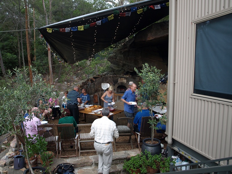

    We had 24 people to share in the piglet. We just pulled all the meat off and let everybody serve themselves up pork bread rolls with caramelised onion and cold slaw and crackling.
Name:	Piggy Crowd.jpg

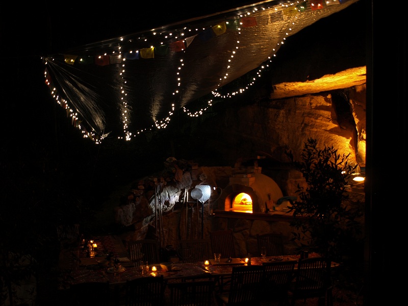

    Whilst I haven't done any work on the actual oven for a long time I did spend yet another month on the jackhammer extending the pizza oven area - adding nearly 2 meters to the left hand side as you see it in the picture.
    And here is the area set up for another dinner over Christmas. Table settings for 22 people in an L shape leaving plenty of room for cooking.
Name:	WFO lights.jpg
