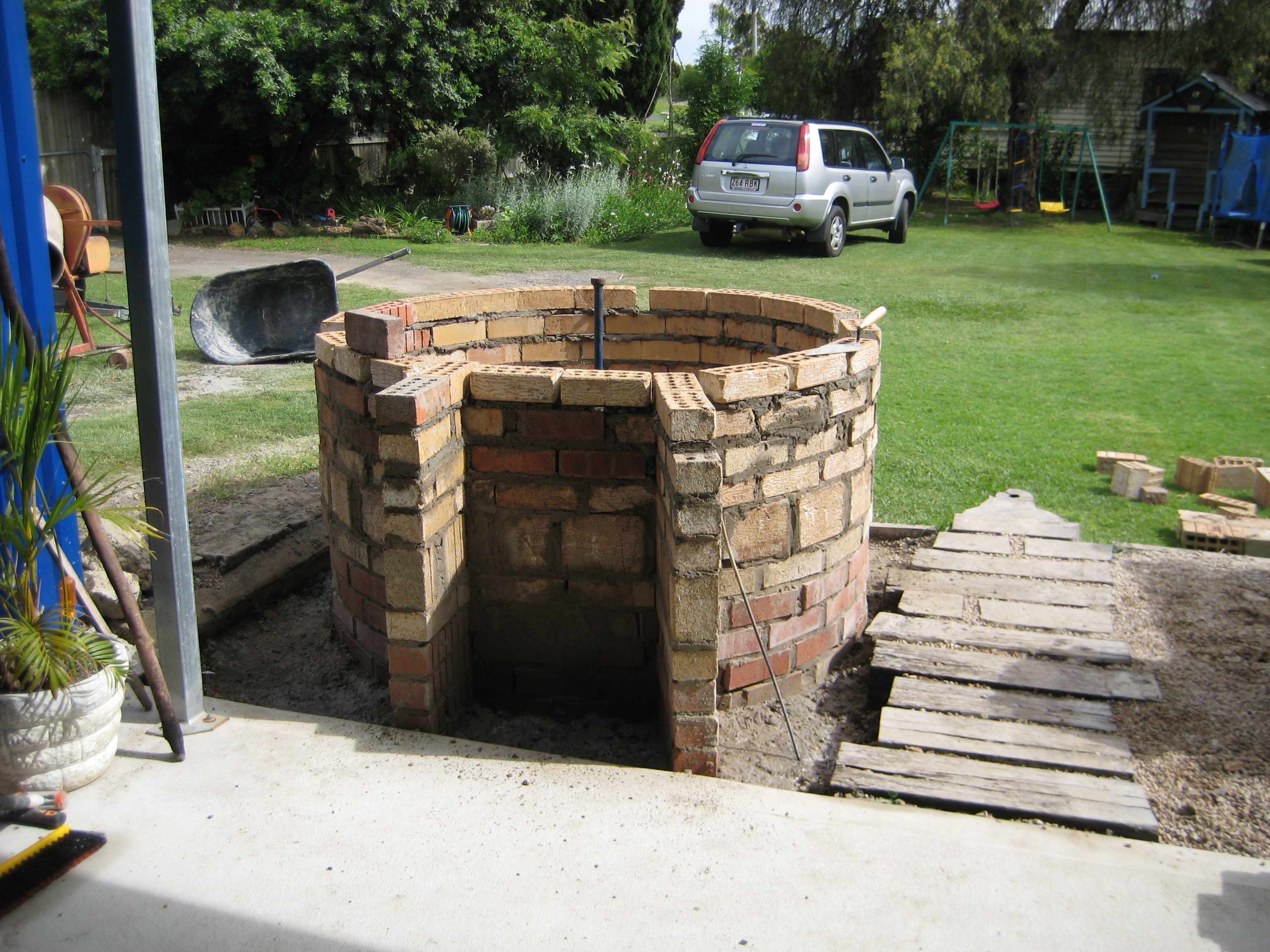

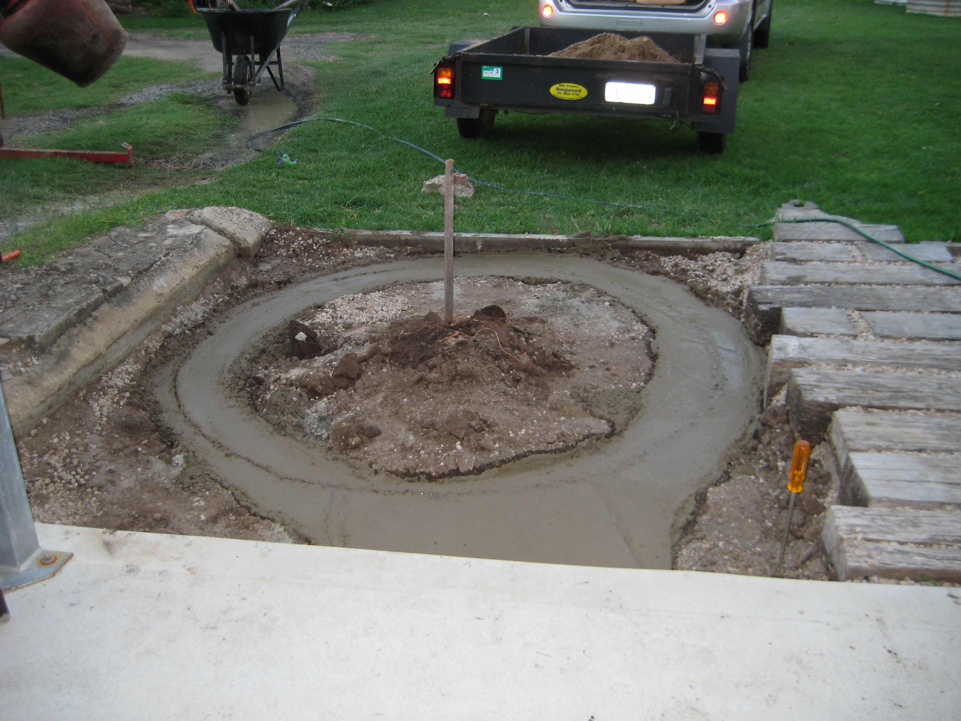

    The Footing, dug on a stinking hot day day with a hangover, sorry - wine flu.

    Base in progress with the Cheif Quality Assurance Officer overseeing the build
Name:	pizza ovan n stuff 224.jpg
    Base Completed. In hindsight, this was the hardest part.

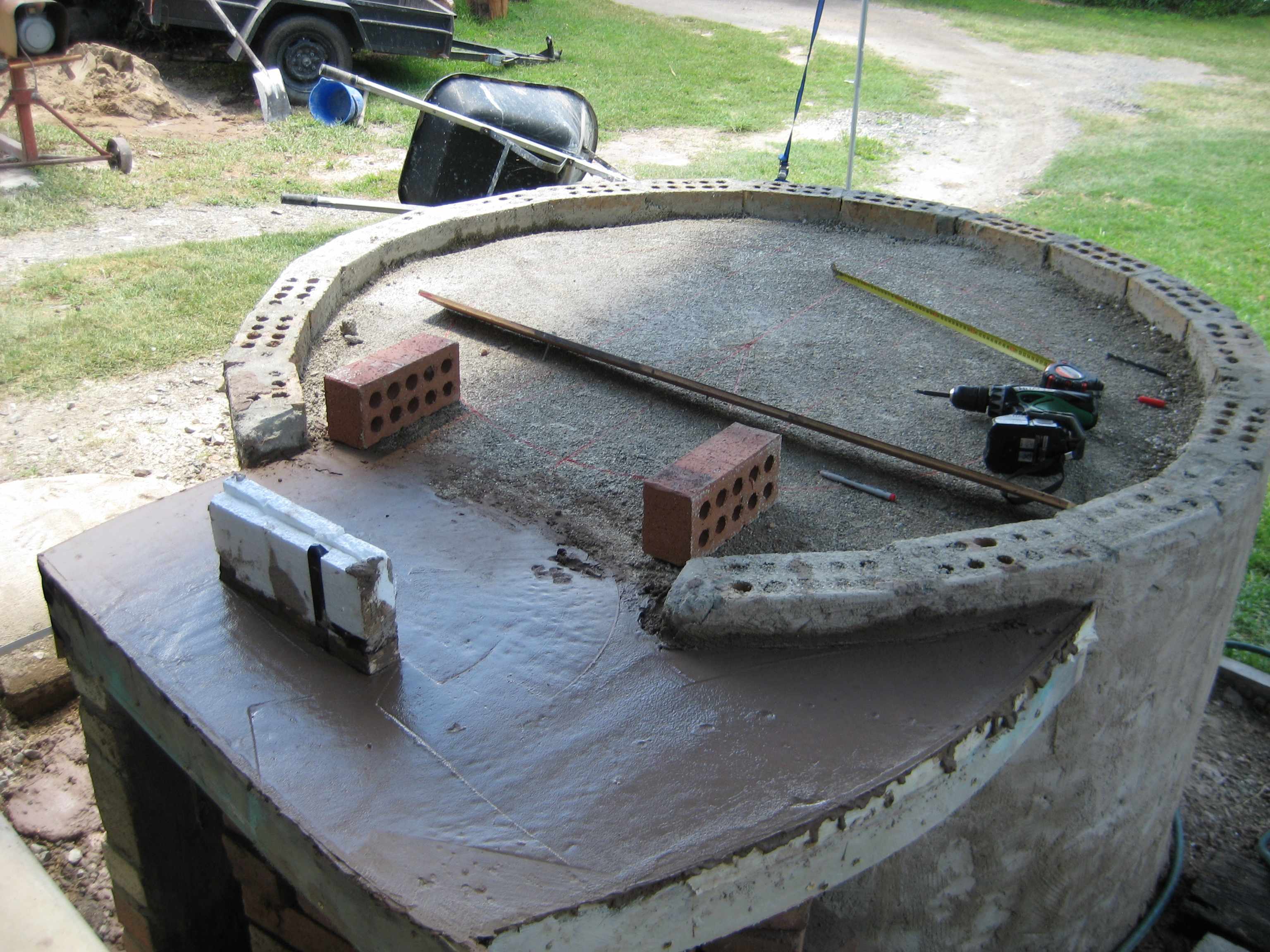

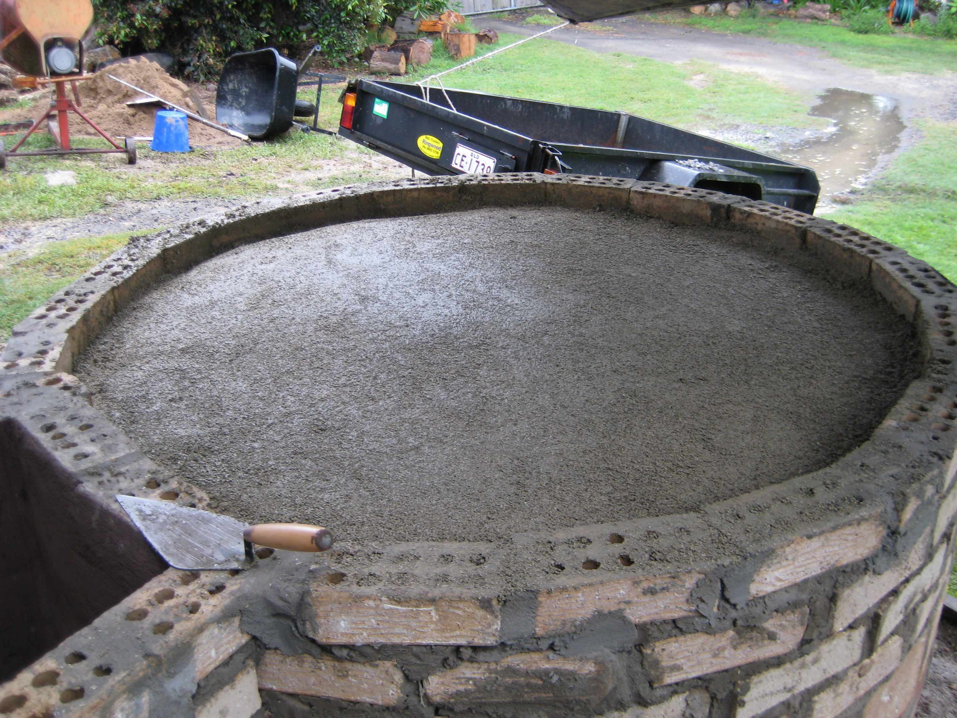

    Vermicement base. Freaky stuff, I was worried it wouldn't dry, but it came good after a day or so. After having an unsuccessful go at a couple of mixing methods we found the easiest way was to pour the vermiculite and the cement into a plastic kiddie pool, mix it all around then add the water and mix again. Sounds simple, but it took a while and several big messes to come up with this master plan.

    Snazzy little landing with provision for an ash pit hole, and most importantly, somewhere to rest a drink.

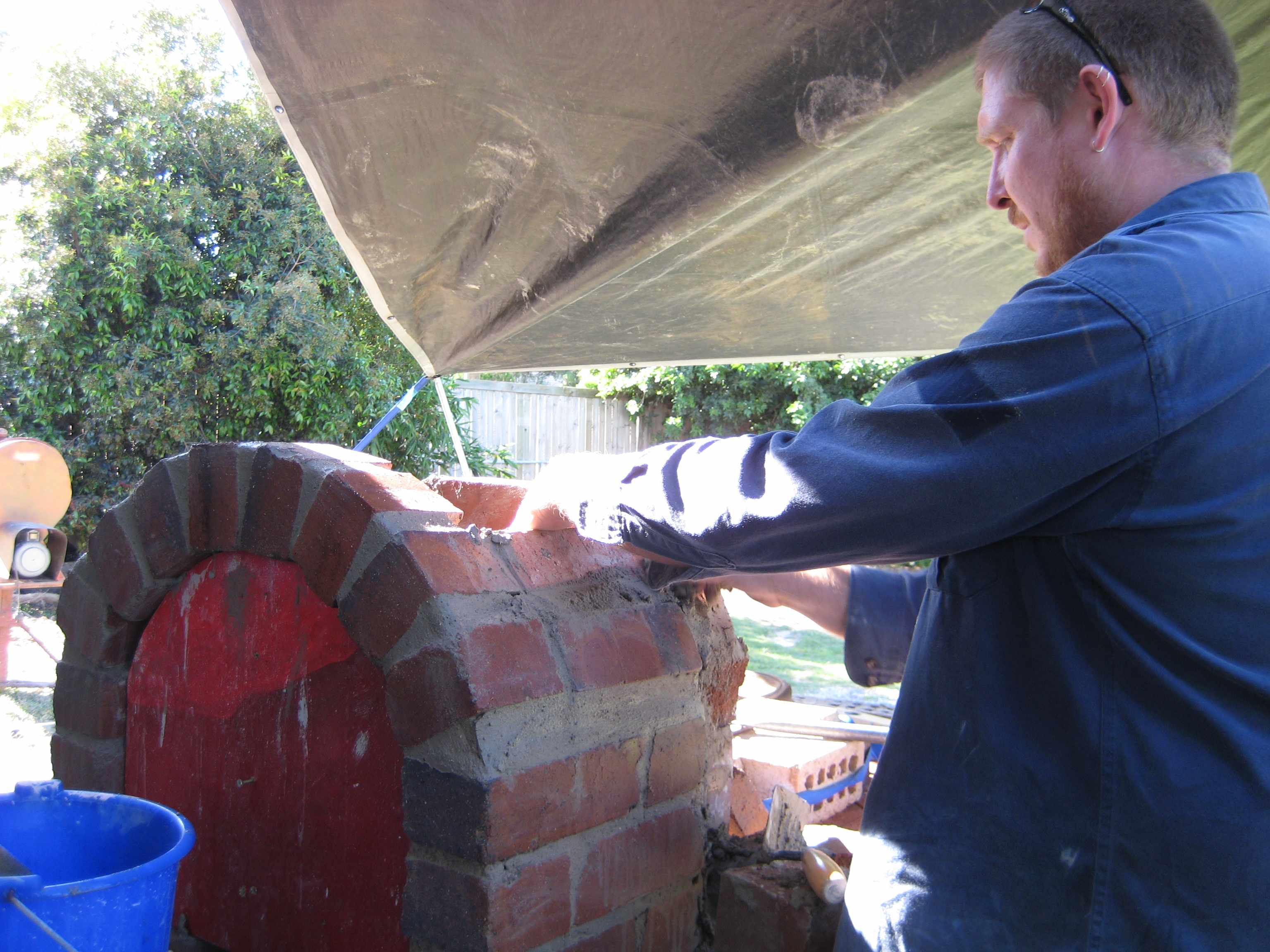

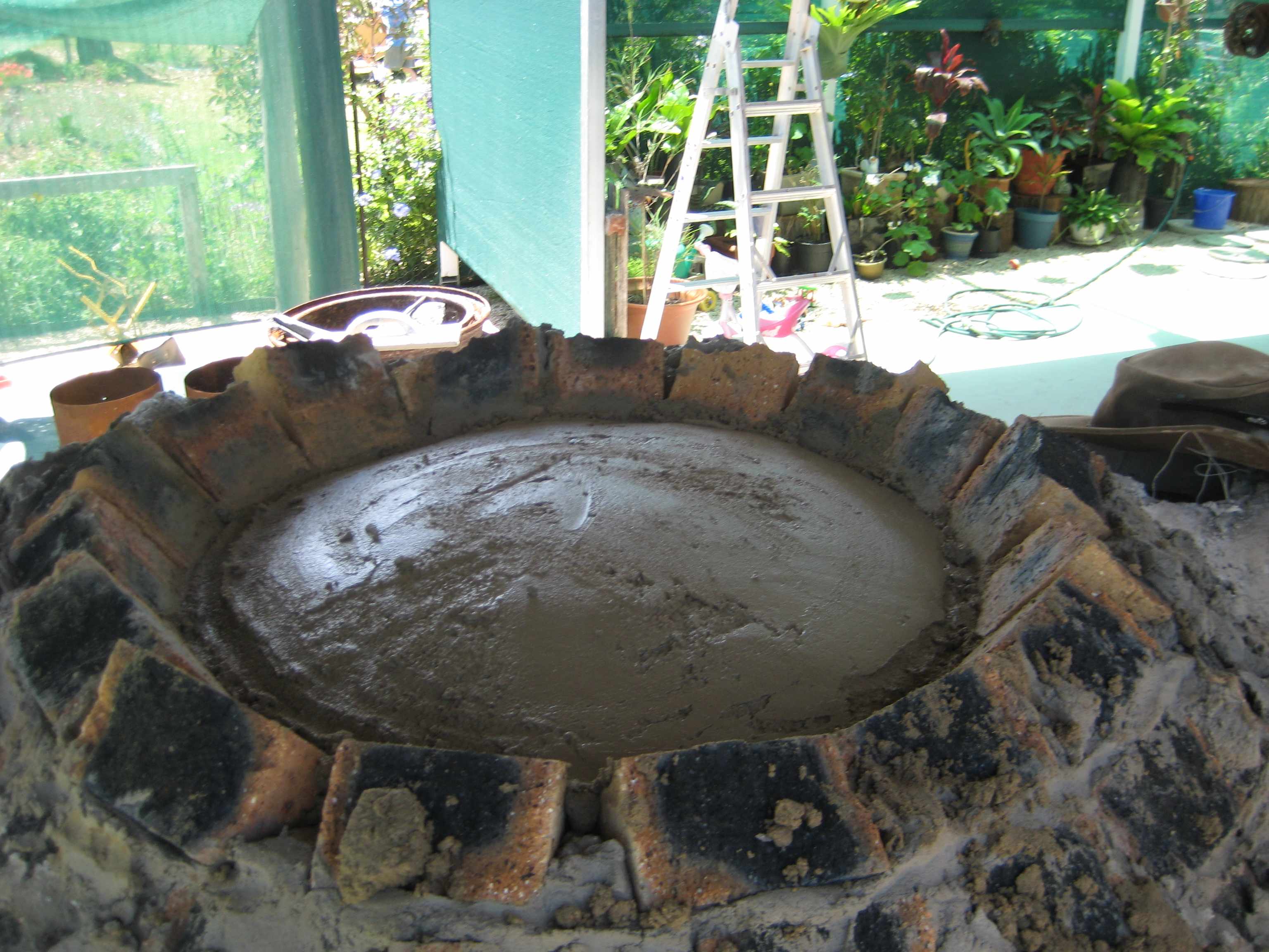

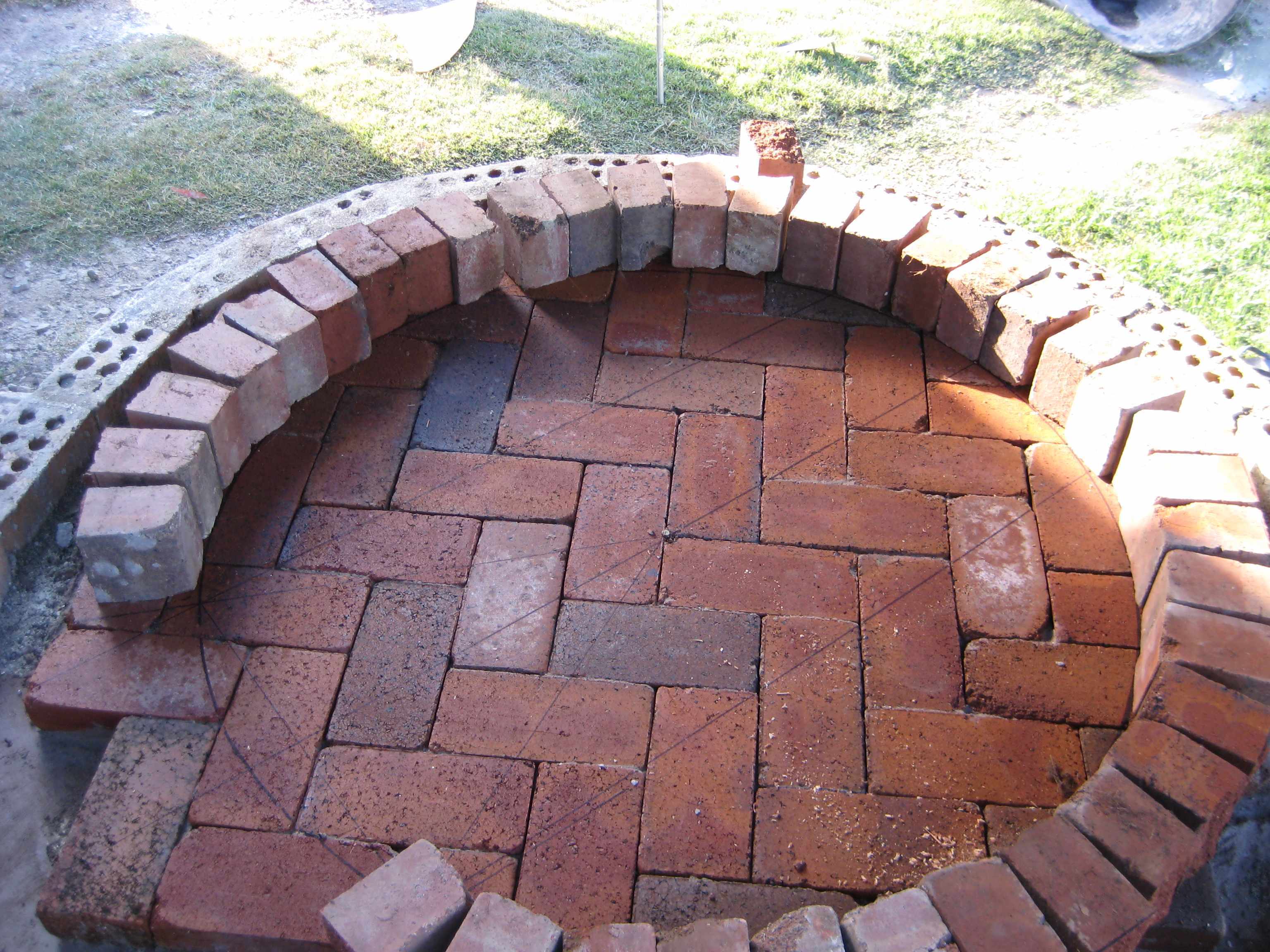

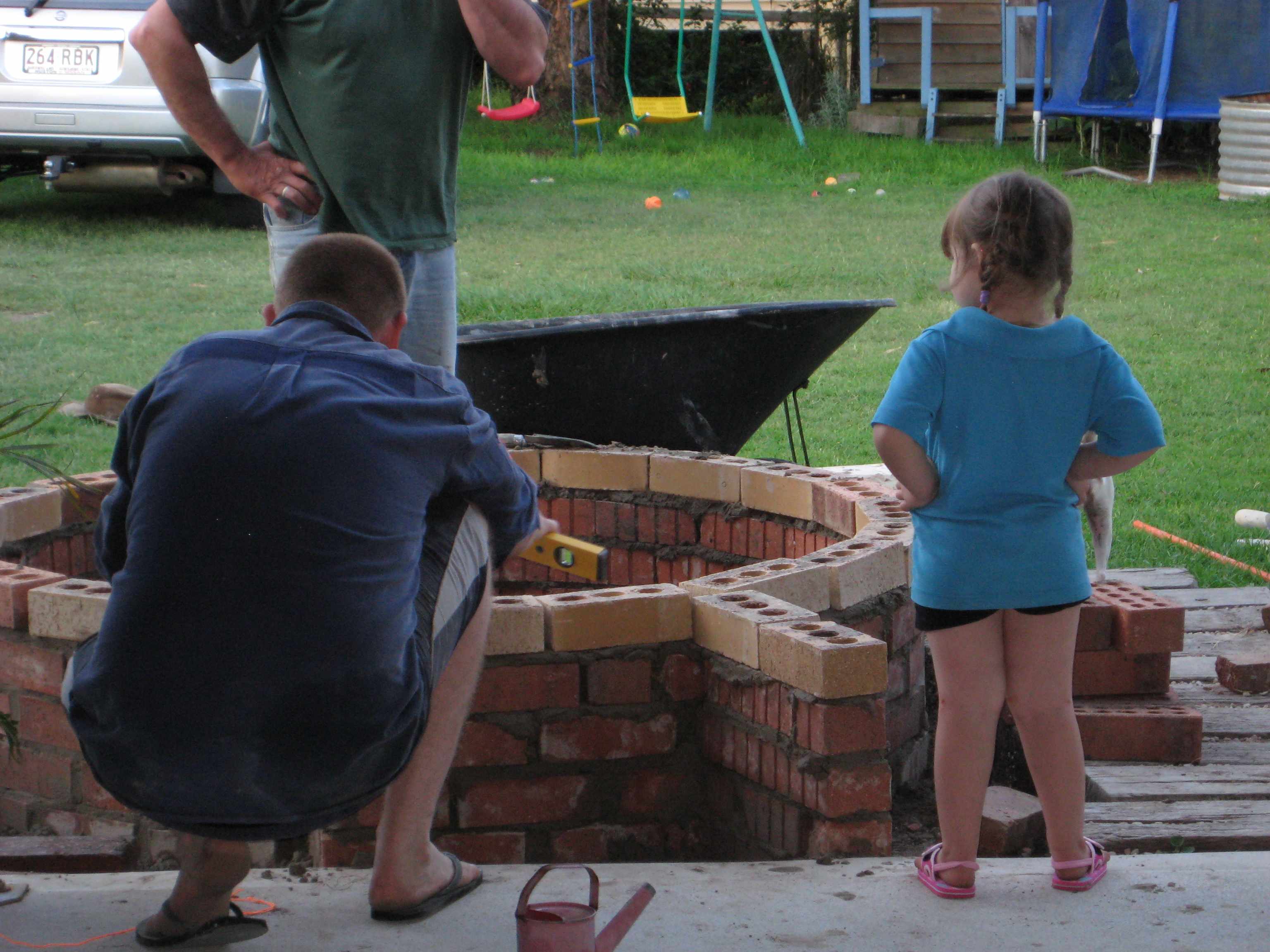

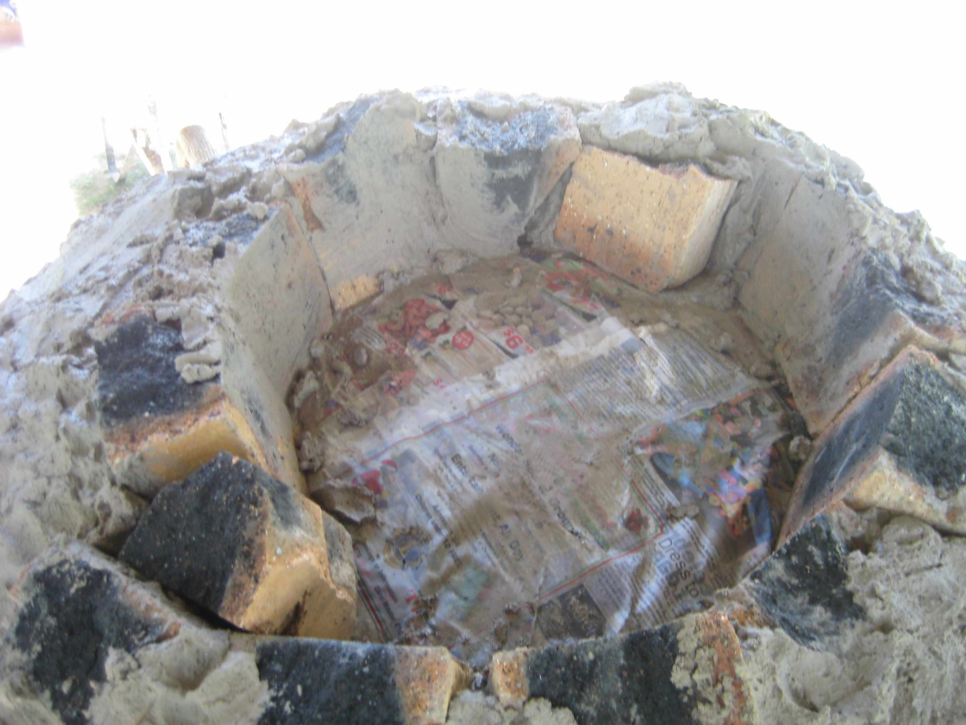

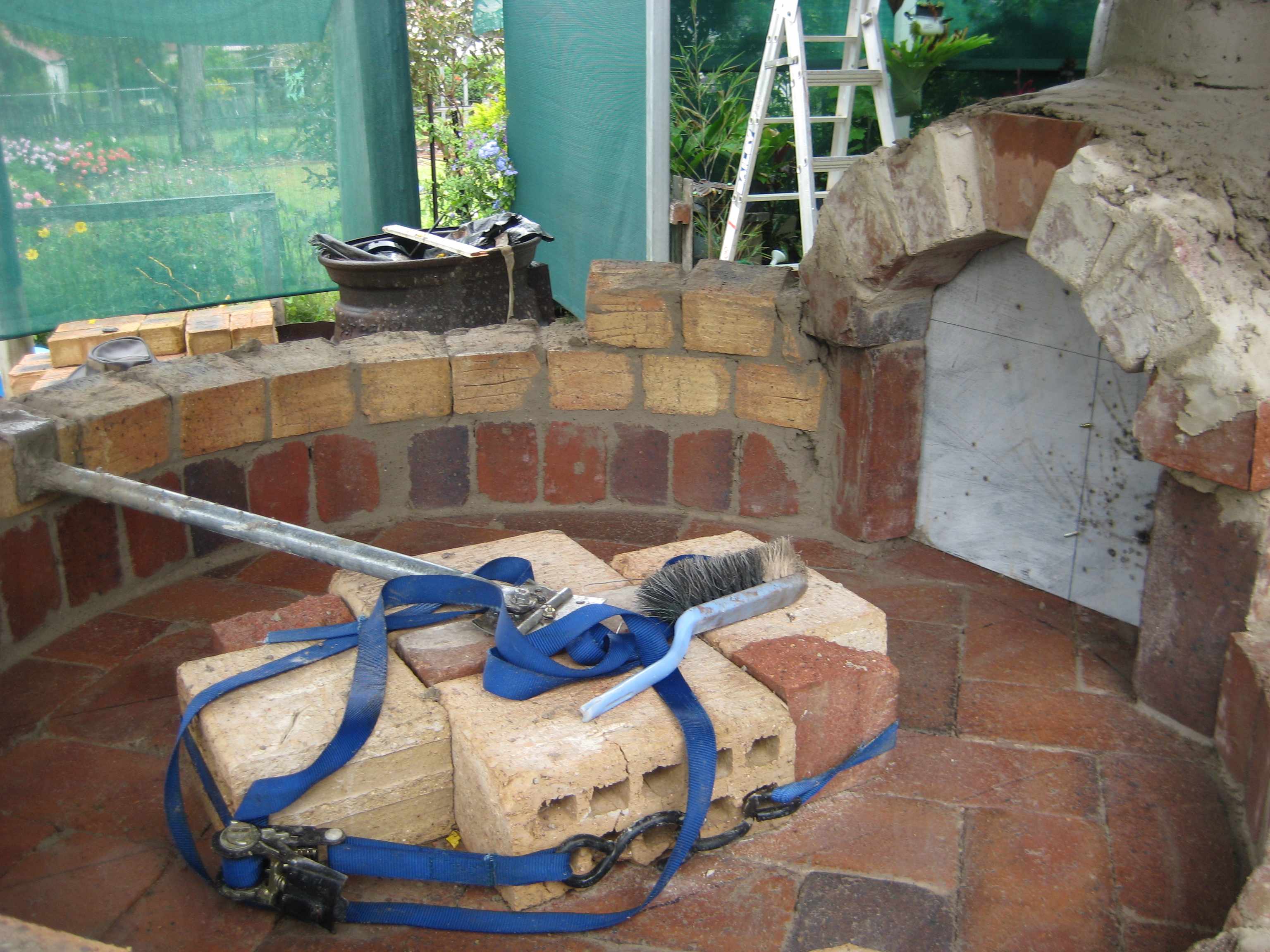

    Below is my setout for the floor, my attempt at the arches (don't have a bricksaw and my bolstering is pretty hit and miss). It's rough, but going to be rendered so I wasn't too concerned about it being pretty. The bricks and the strap were my resolution to anchoring my hendo indispensable tool (and what a tool it is, could not have done without it). I ended up using a sand form towards the top. In hindsight I should have persevered with the indispensable tool, I couldn't see what I was doing with the form and it ended up being a bit of a dog's breakfast. I used a circle of mdf, cut in half(ish), overlapped and screwed together under the sand. I used a car jack to hold 'er up there. There was a moment when removing the form where I just had to rip the jack out and hope for the best. A bit puckerish, but amazingly satisfying to see the dome staying up, holding together all by itself.

    I live on a corner block in a small town with my back yard exposed to the road, am getting a running commentary on my progress from everyone from the local garbo to random strangers. And the common thread - I'm gonna build an oven one day. Amazing how many people want to build a WFO, but you see so very few around.

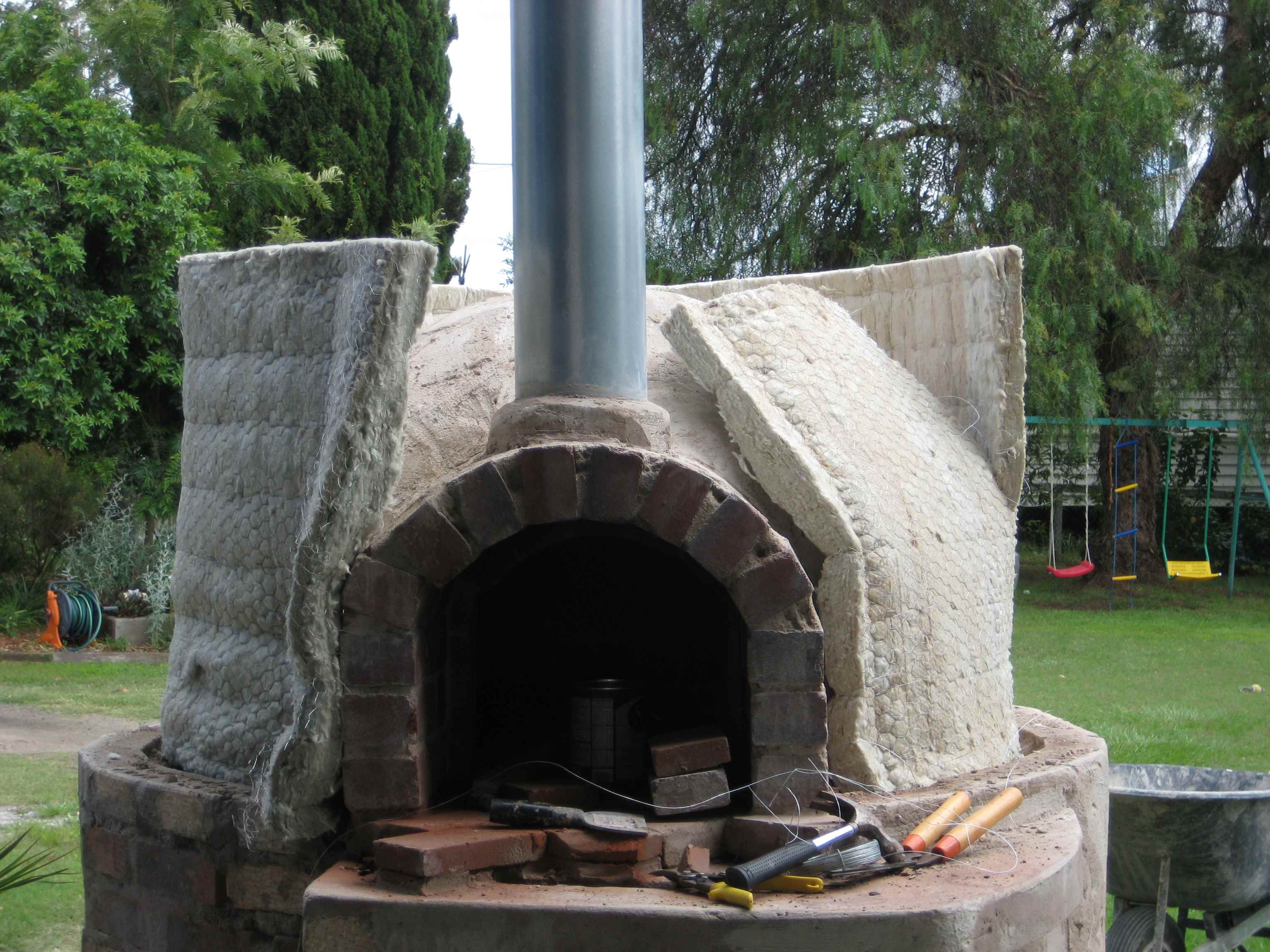

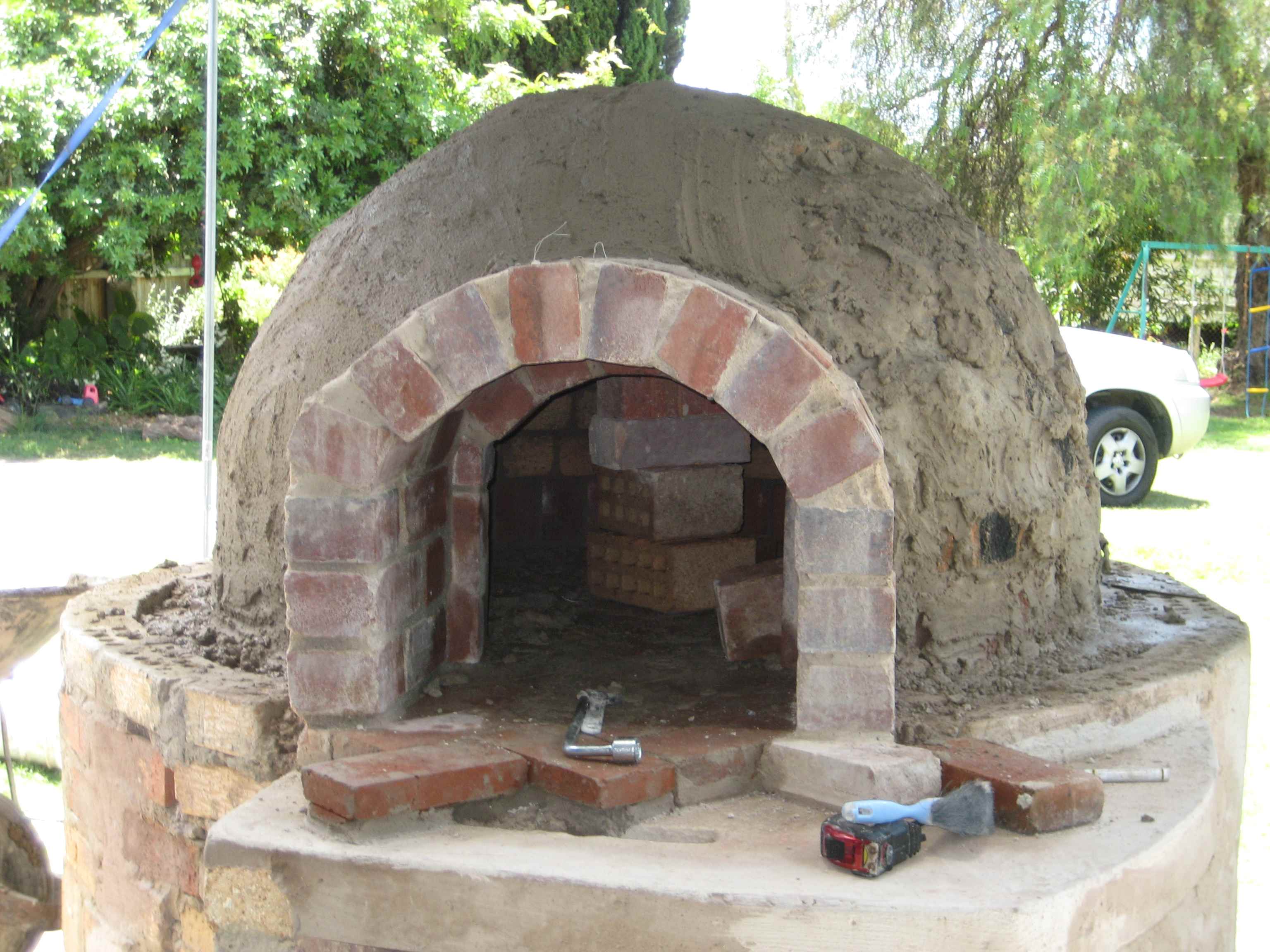

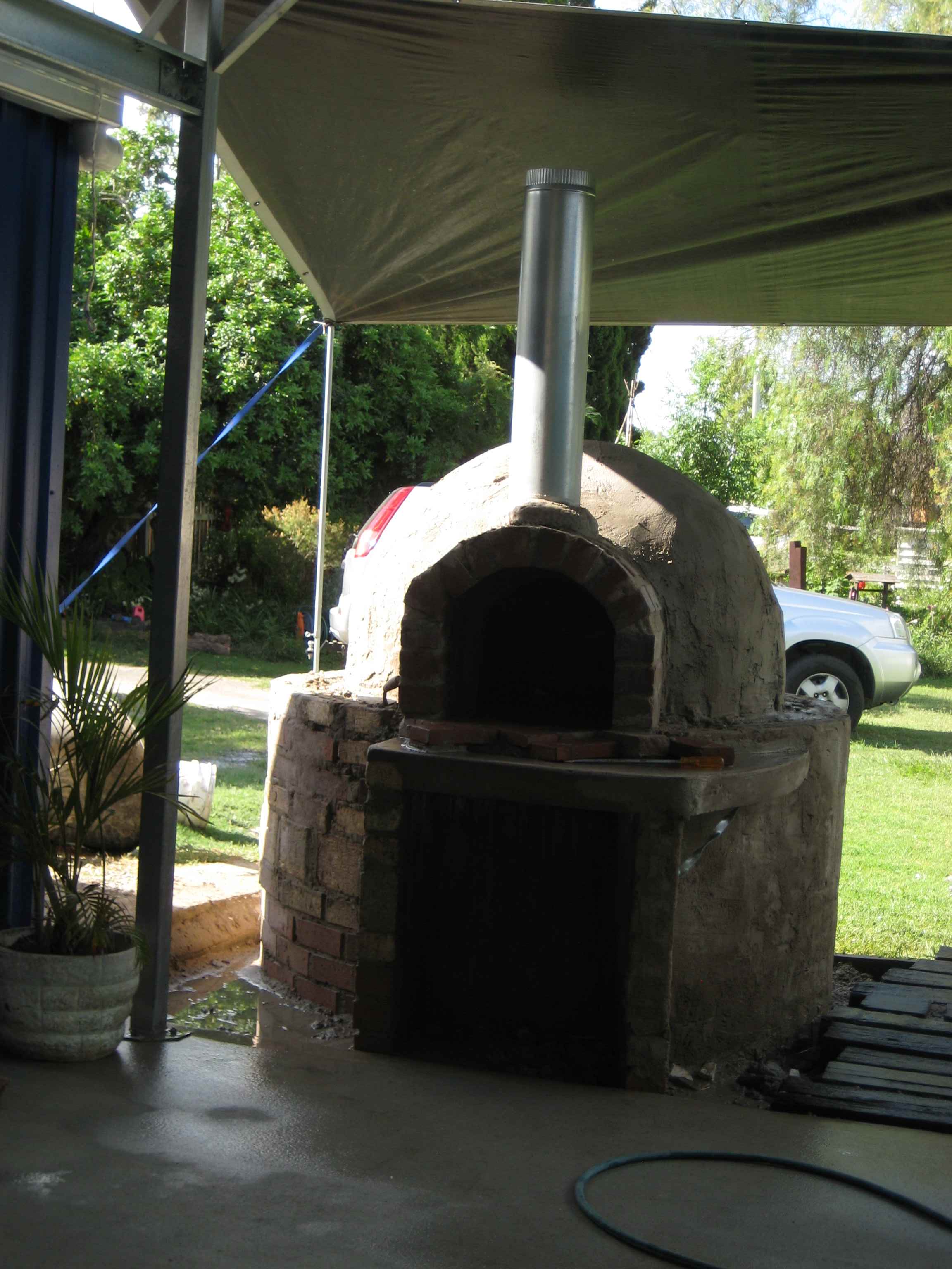

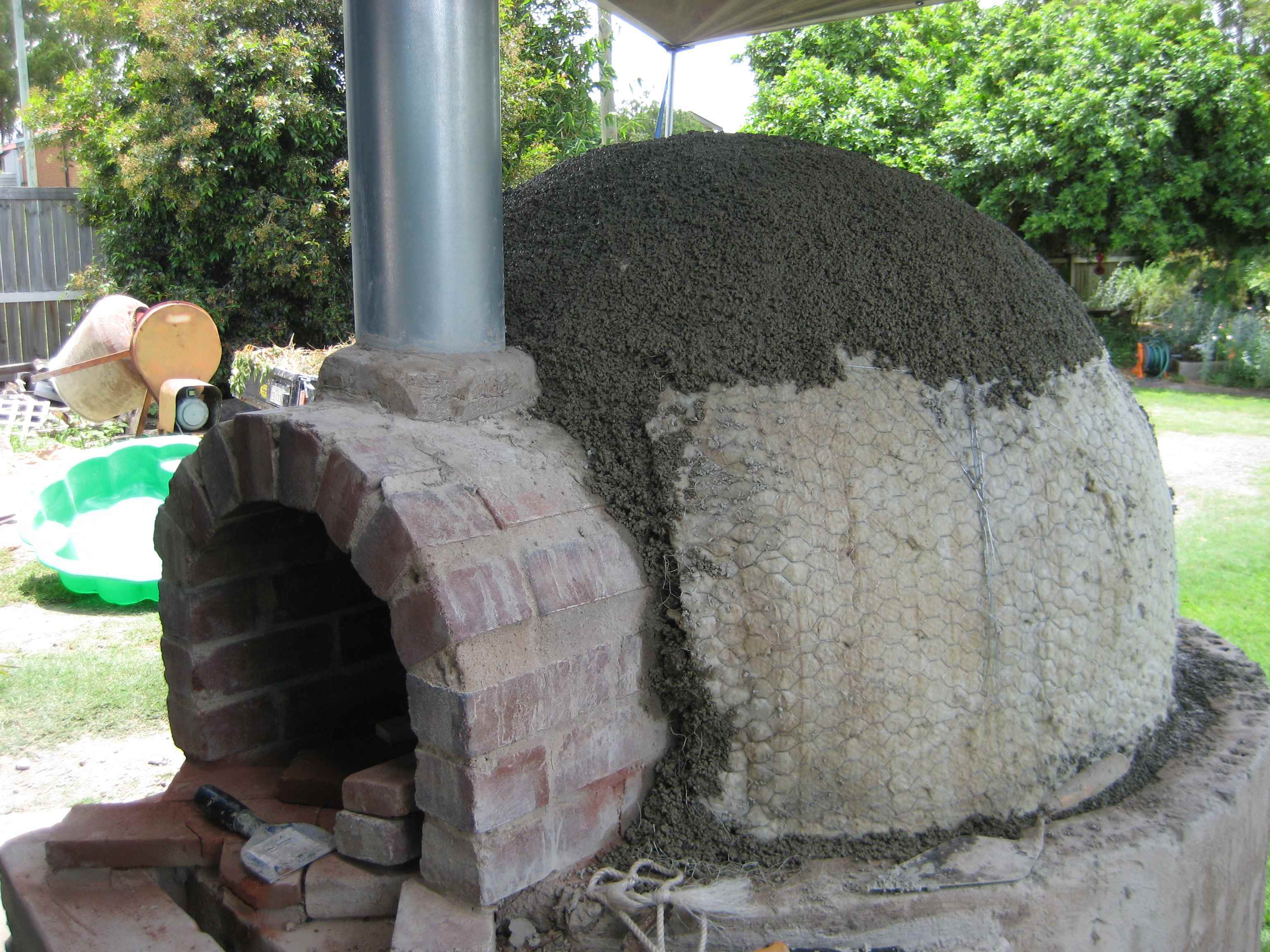

      Insulation blanket and vermicement. Not a fun day. Whatever they pay the laggers that work with insulation every day, they deserve double.
      Finally, rendered and near finished. I still need to finish the bricks on the landing, and make the ash bin, but I fear this may never be finished now its usable.
      By the way, the missus suggested (demanded) the name, I was going for MUD GUTS.

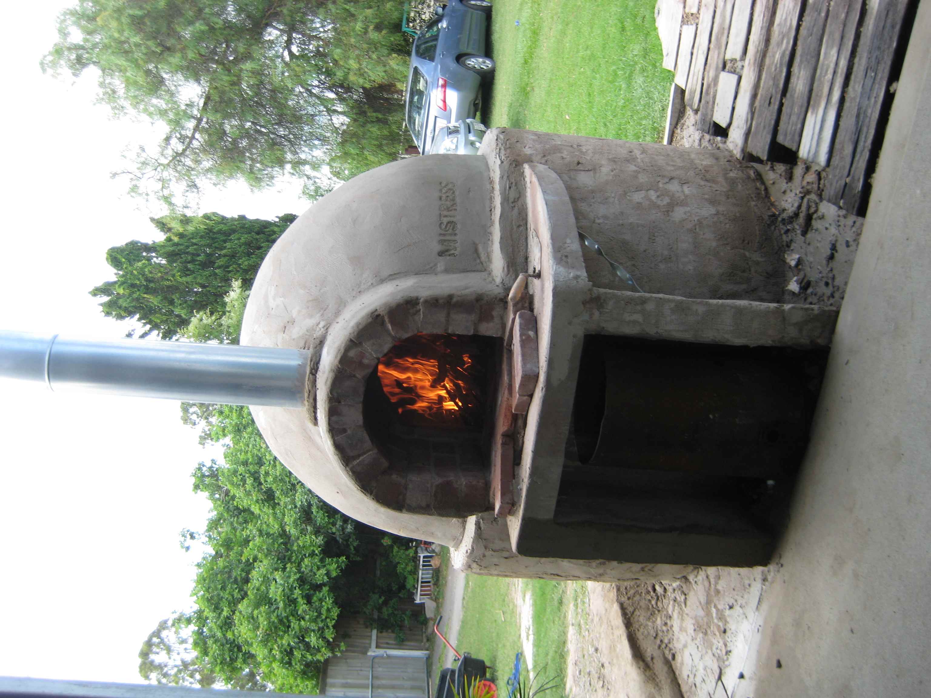

                      Had a cookup last night, oven was too hot for pizza, apparently timing is everything, the bases burnt straight away. I had more success cooking the pizza on the stainless steel peel I made up. Everyone keeps telling me (a thousand times over) about pizza stones and how I should get some, but my response is I HAVE AN 1100mm PIZZA STONE ON THE BOTTOM OF MY OVEN! I need to work out the best way to make a pizza, transfer it to the peel, slide it off in the oven and get it out again. It looks so easy on youtube. I'll comb the forum for some hints and tips. In the end, I think more practice is in order. Bugger, oh well, I 'spose if I must.
                      At this stage if I don't let my mate make a door he'll crack a tanty. He's a little too excited about using his new welder, I'll get a door out of him then may look at an intervention. I've got a feeling the door I'm having made might be a bit too heavy. If this proves true, the heebel design sounds like the go. I looked at the temp gauge link the other day, almost looks too good to be true. I think I may have another item on my list for santa to bring me..

                          I think I went a bit hellboy and stoked her too much. I'm using thicker wood, and plenty of it too. I think everyone who builds a WFO must have a streak of pyro in them, when I look at the oven I can hear her saying 'Feed Me'. Must learn some self control.
                          When I raked the coals back to the walls, the base bricks had a bit of a glow where the air met the edge of the coals. I left it 10 minutes, then mopped the floor with my home made floor-mopping-doodad. 10 minutes was obviously not enough, but in my defence I had a crew of starving yobbos screaming PIZZA. Next time, less fire, more time, no mates.
                          We made a simple dough with what was in the cupboard - plain flour. I need to investigate what flour to use. Though, the plain flour dough works well, and does puff at the edges on the brick. I was sceptical that it would cook through before it burnt, but they are grouse. I burnt out the wife's mix master making the dough. I think I need to buy a heavy duty unit, I'm over kneading dough, and a pair of dough hooks does a pretty good job.
