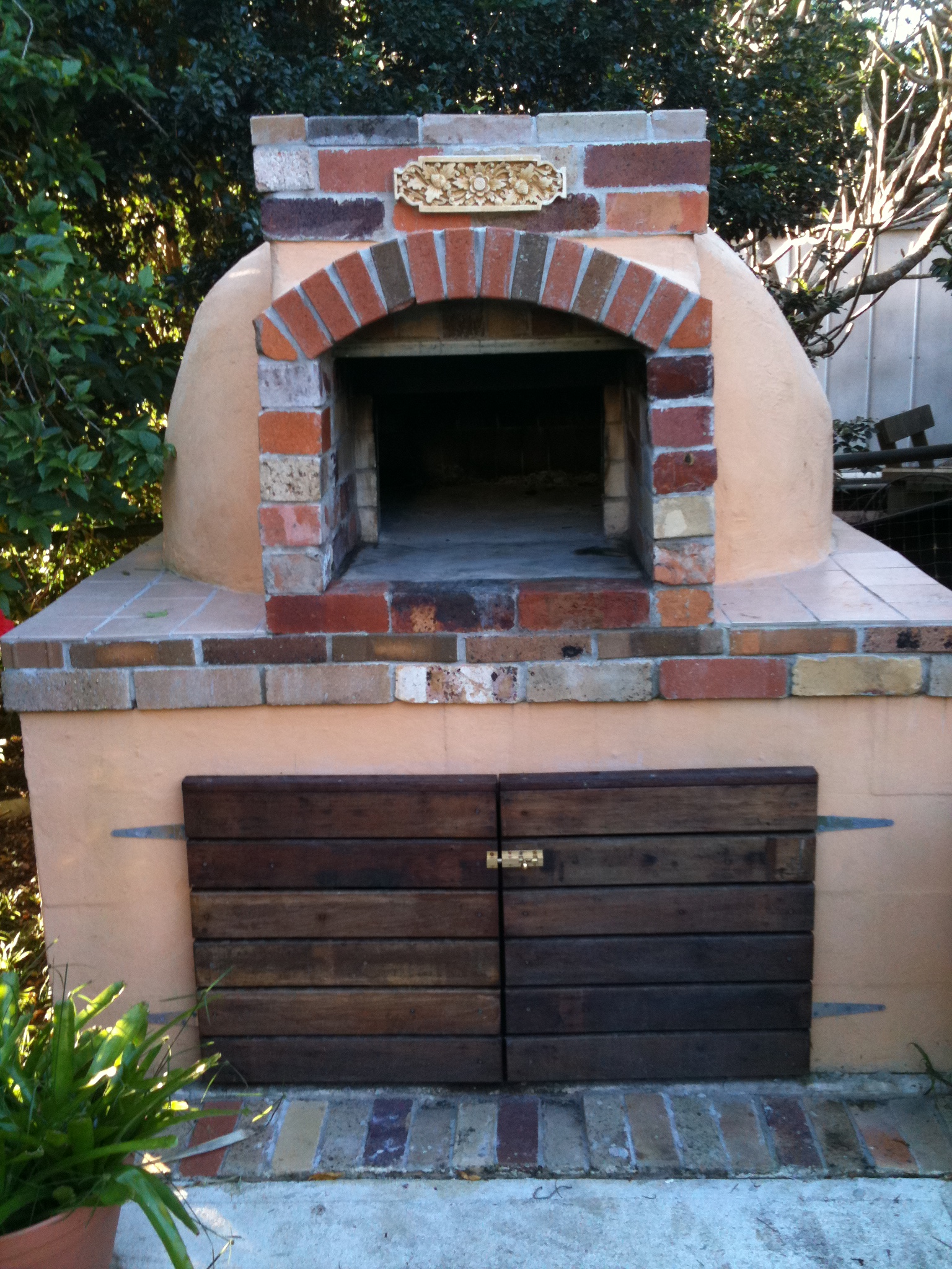

      Been doing some more work on the oven added an arch at the front in n effort to stop the rain coming in an it looks like working. Used some brick from the old church building for it to. Don't worry though had a glazed brick from an old pub in sydney that we used for a door stop. Choped it up and included it just to balance things off. Sealed off all the bare brick with a Bondall sealing product recon I've got the damp solved

        Your oven looks top notch. You should be proud mate.
