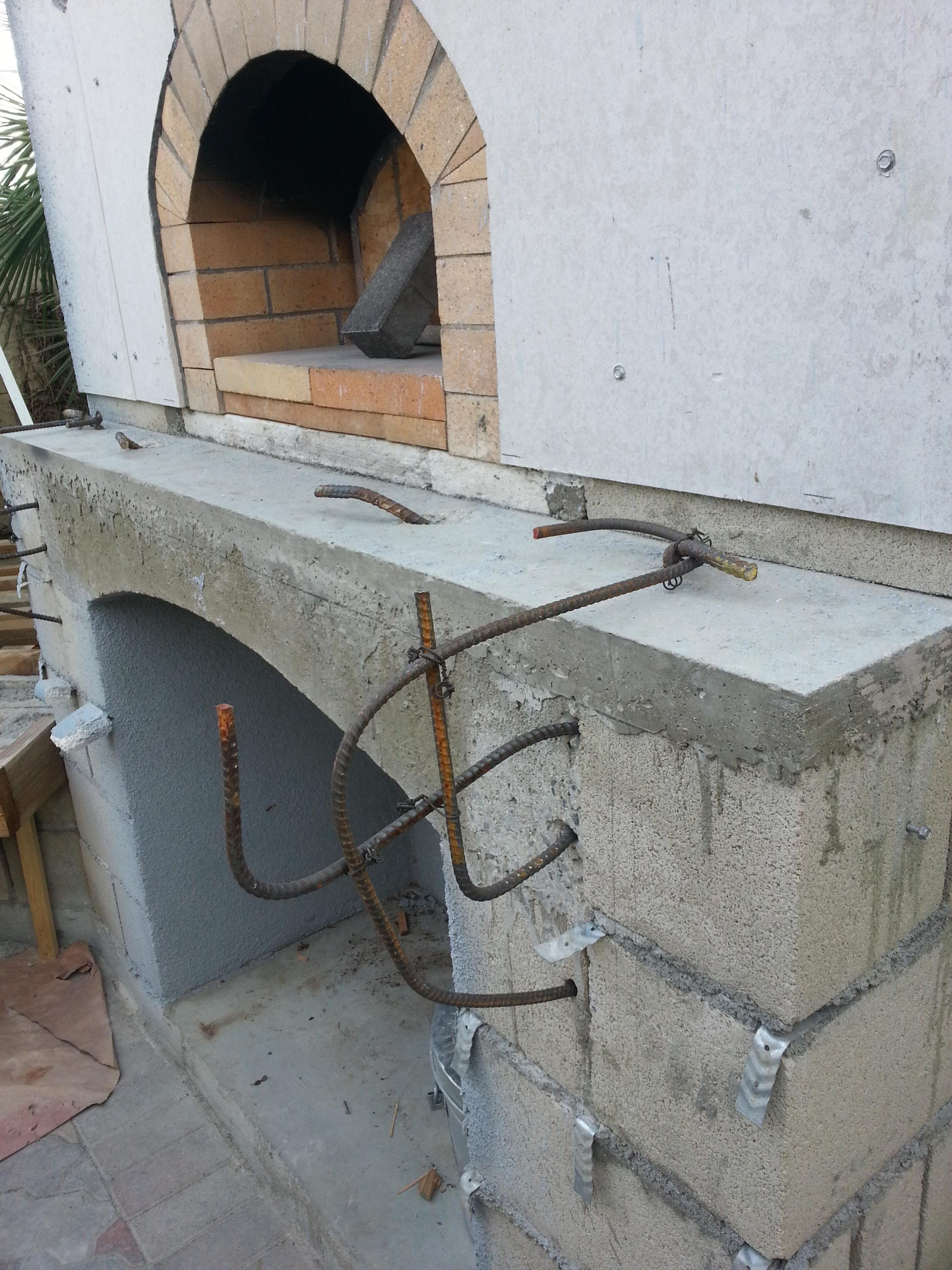

            I prepped the corbels today. - yes I drilled in several bars of re-bar in each at differing angles. I will plan to pour one evening, remove the forms the next day and and see what works. I will escalate from sponge to nylon brush to steel brush as needed.

                  Thanks for the heads up on the landing. The front of the enclosure and outer arch sits 8 inches back from the front edge of the stand. I plan to make a landing the extends 24 inches from the enclosure on the left and right with rounded edges that sweep back to about 10 inch depth in front of the enclosure - the 2 inch will over hang my planned veneer stone.

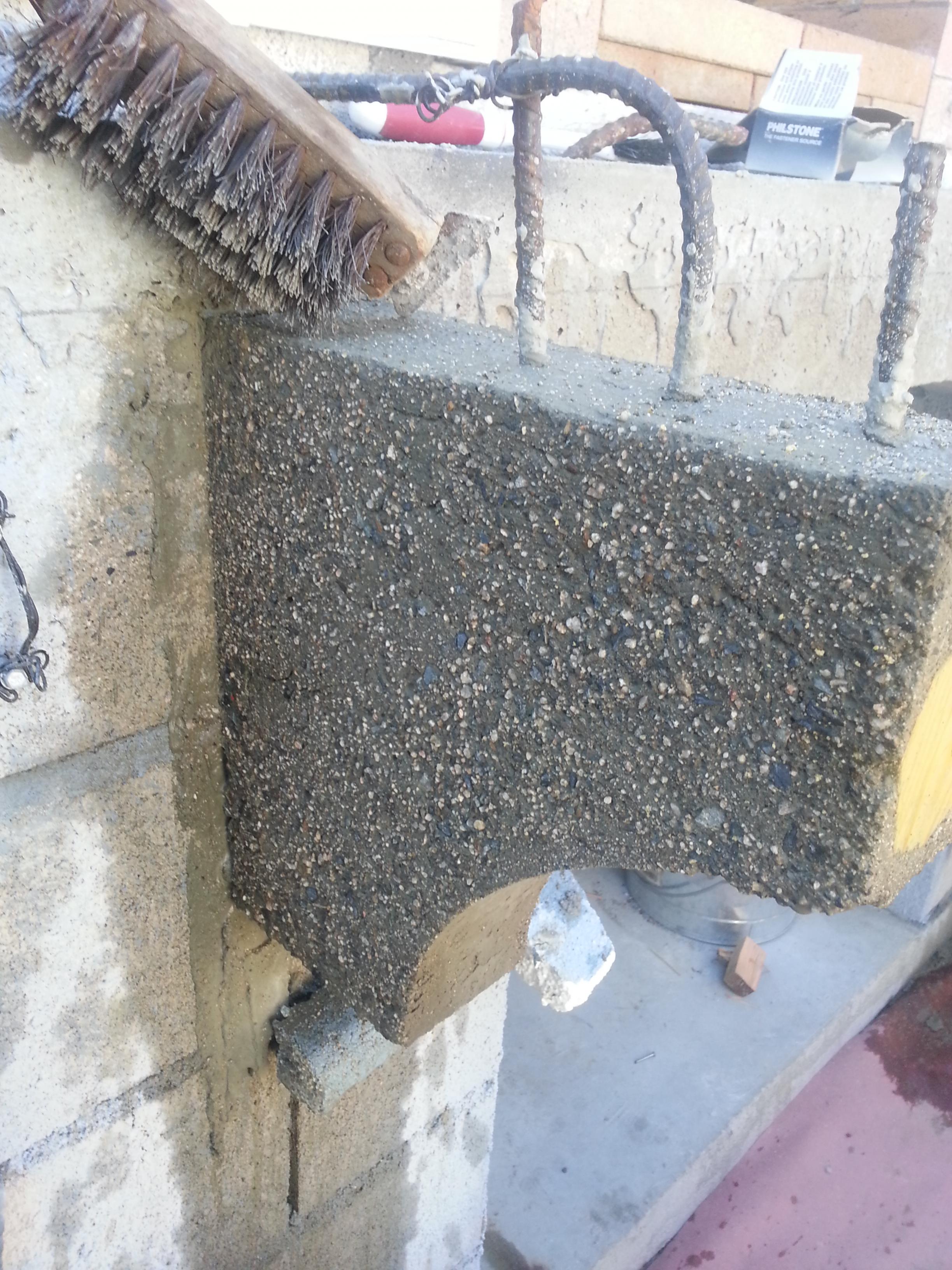

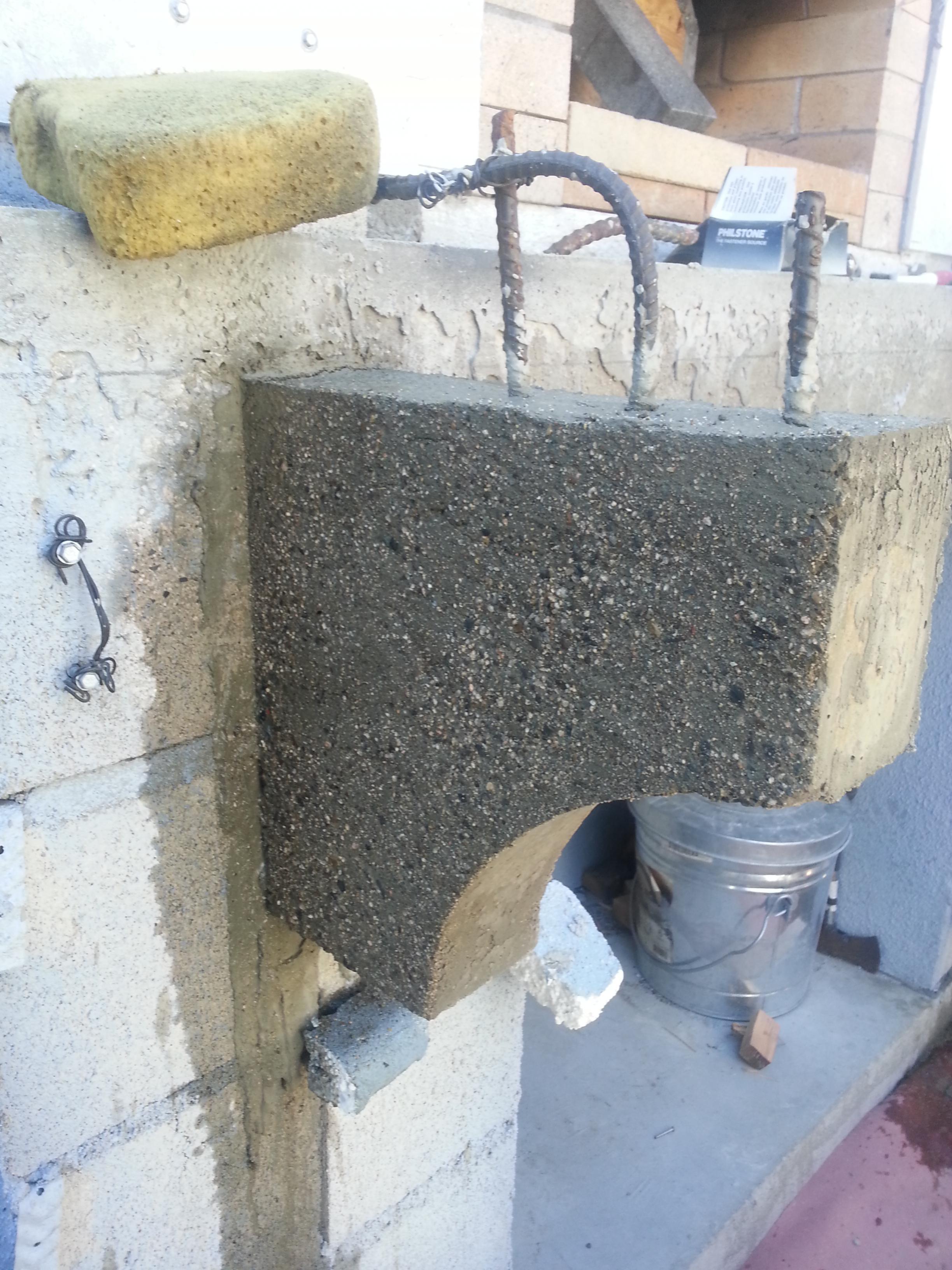

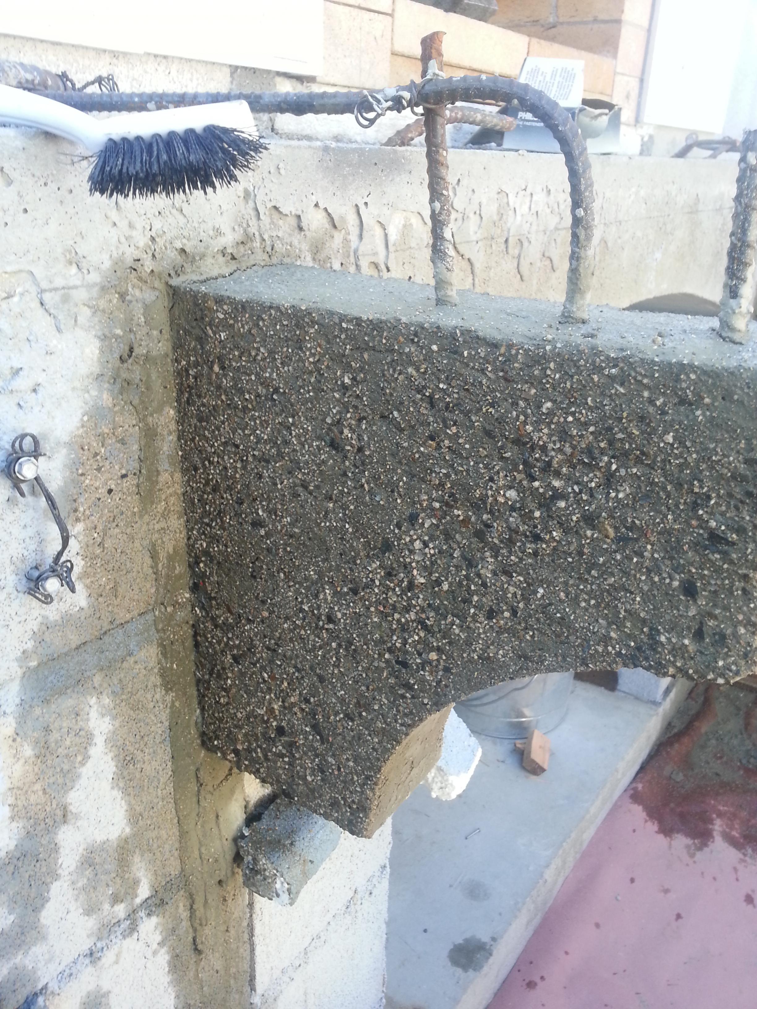

                    I had a lot of fun over the weekend - I enjoy tackling new projects. I poured my corbels then exposed the aggregate, in the style of Gulf. I started with a wet sponge, then a nylon brush, then a steel brush - I took photos to show the progression.

                    So I am framing the landing, then hearth on the adjacent fireplace and the seating on the adjacent pony wall this weekend - hope to pour the following week. We shall see.

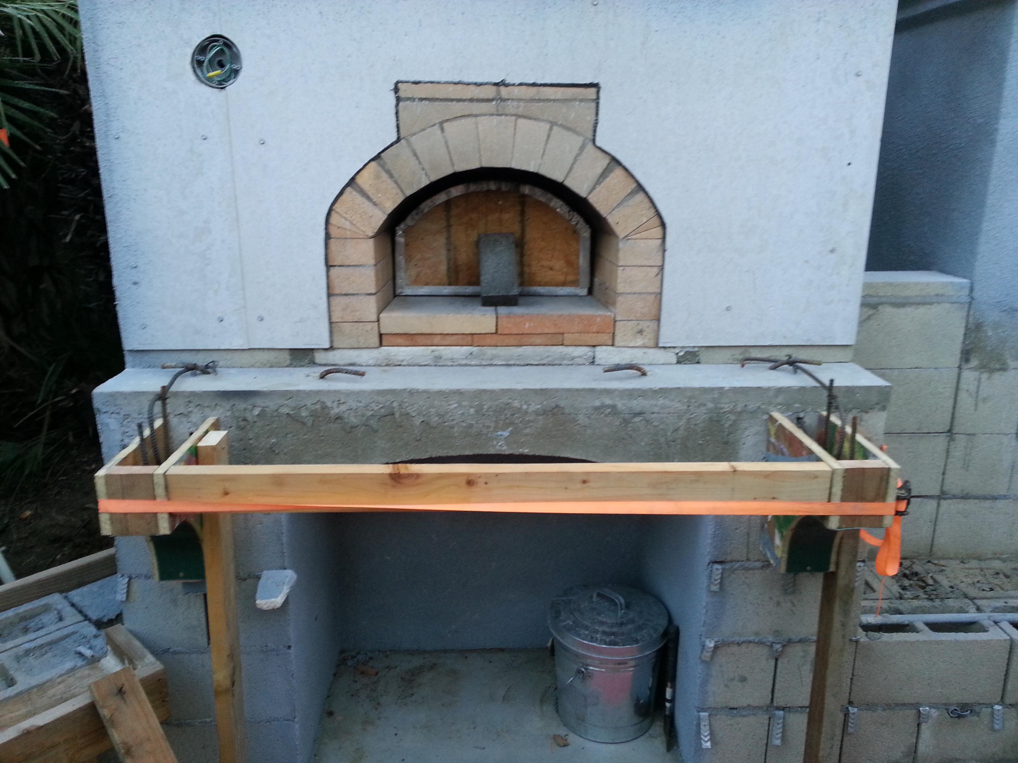

                      One question for you - how deep is your landing going to be? I ask because mine is about 15" deep - hangs out about 4" beyond my stand. I found that even adding that little bit made it more difficult to place pizzas in the oven. It looks like you might have quite a deep landing. Have you tried working that far from the oven yet?

                        Thanks for the info on the fibers in the cement and the head's up on the landing. I am actually planning two curved counters on either side that tie together in the middle. I currently have 8 inches of stand in front of my landing and I only plan to extend that two inches. I hope to get the framing done tonight, Photos will make it more clear.

                          Here Is what I have so far for the landing. Still planning to add re-bar.

                              Love the shape of your landing! That will let you get right in there when you need to. I haven't completely figured out what I want to do with my landing / counter tops yet. Definitely concrete but now you've got me thinking more about the shape!...Thanks for sharing. Keep us posted on what you learn along the way.
