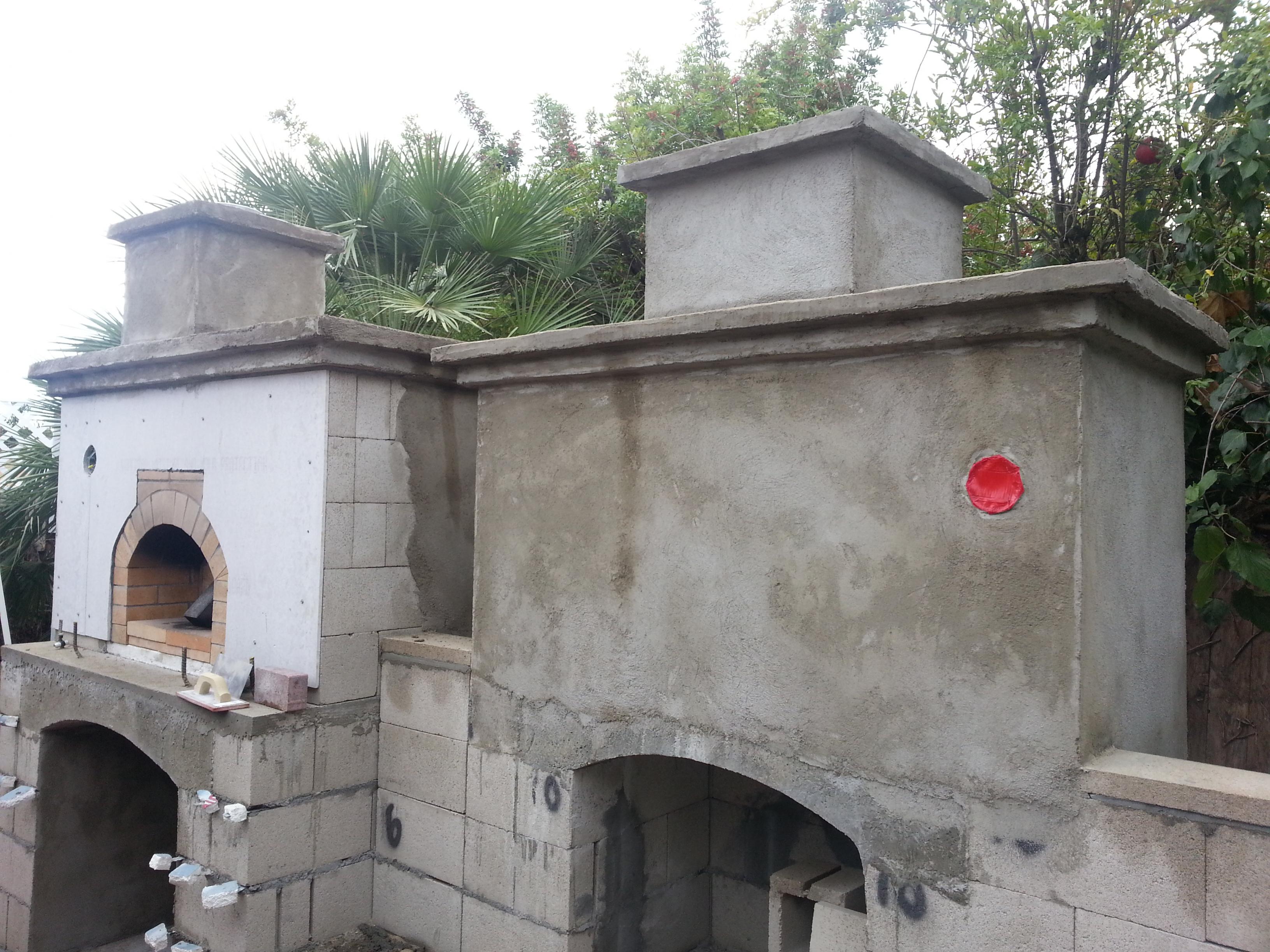

    Applied 320 pounds of stucco this weekend (brown coat)... sigh... have about the same to go before color coat. But is is good exercise! The oven's efficiency continues to improve; The oven is 315 degrees tonight - last fire was Halloween (Pizza 10/31, Bread 11/1 and again 11/3). It was about 80 degrees here today - lots of misting to keep the stucco curing - not drying.

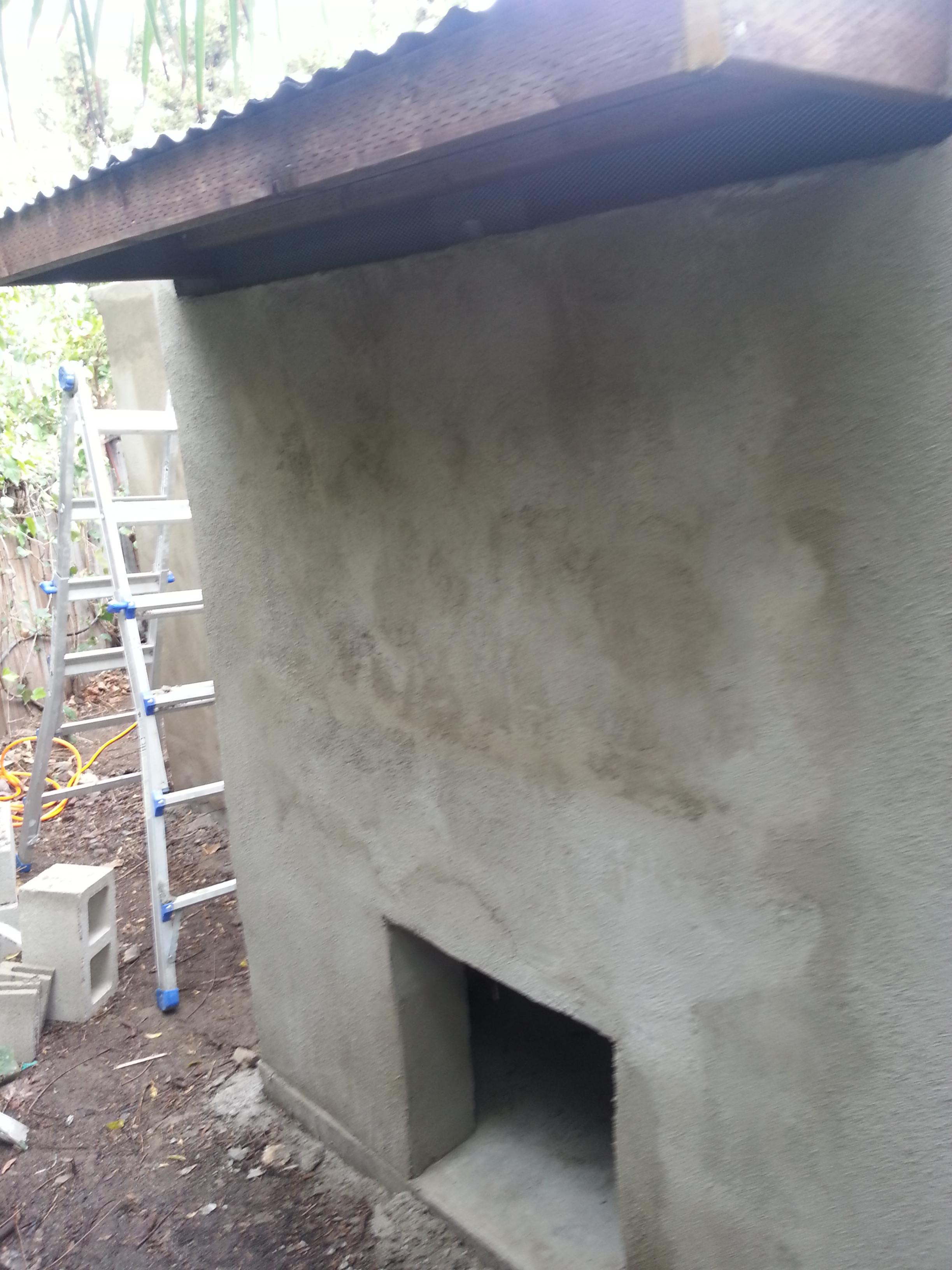

      Mild weather does allow WFO progress! I placed a stucco scratch coat on the metal framed surround for the oven chimney. On rest of the block structure needing stucco, I went strait to brown coat. Here are some photos of the oven enclosure ready for color.
Name:	2012-11-17 09.35.26.jpg
      Notice the tortoise den on the back side of the oven stand.
Name:	2012-11-17 09.39.15.jpg

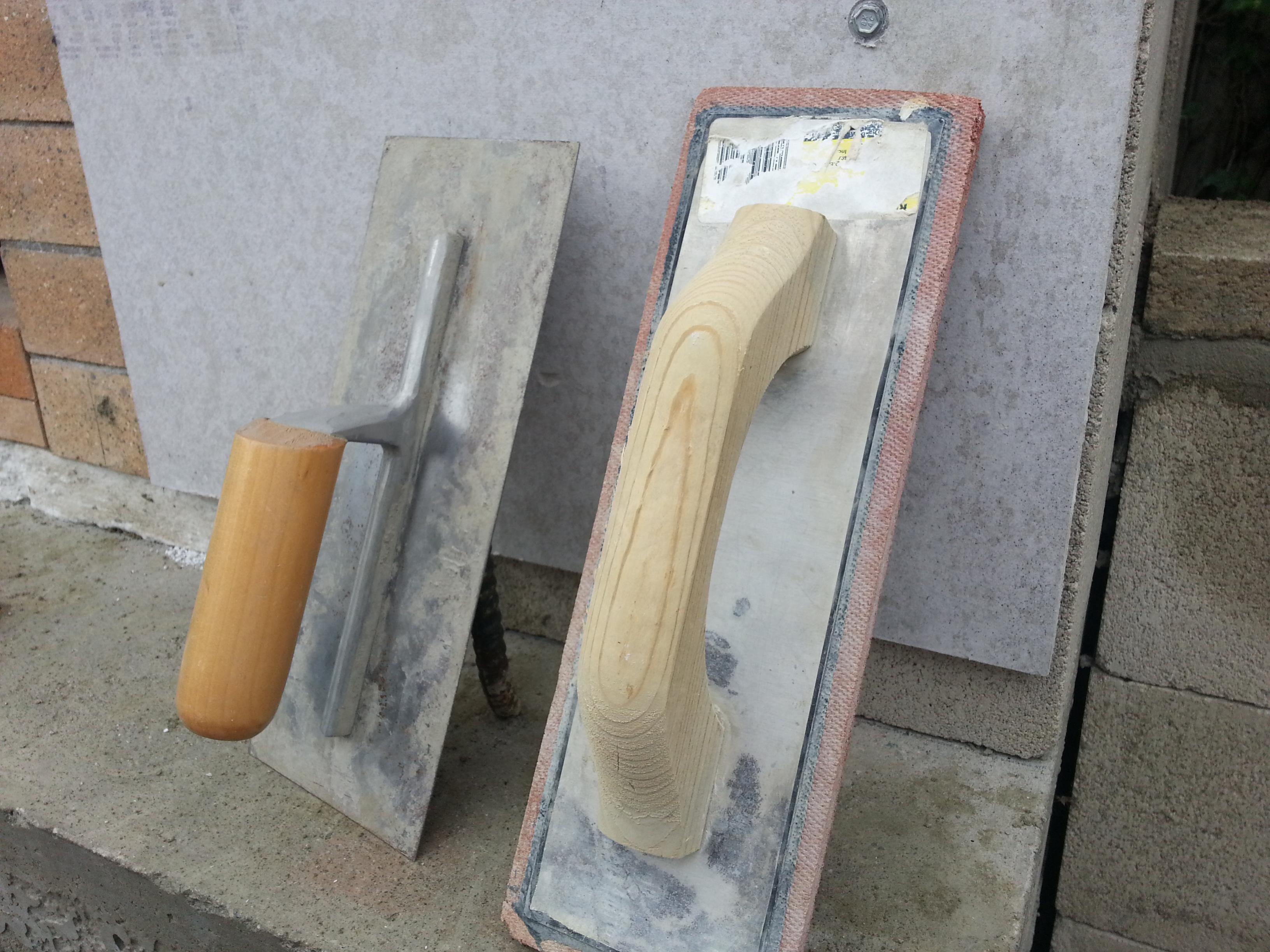

      • Re: 42" FB Pompeii Oven with 19" dome, and adjacent fireplace, in the O.C.
        After troweling on the brown coat stucco and bringing some texture to the surface with rubber float:
Name:	2012-11-17 09.36.00.jpg
        I was ready for an easier way to apply the color coat.
Name:	stucco color coat.jpg
        I decided to spray on the color coat; managed to get all 350 sq feet applied! I used 3) 90 pound bags of grey base stucco, pigment, and a sprayer designed to apply drywall texture. I will post photos of finished stucco after some clean-up.
          Looking good dvm!
          I have completely stalled out on the stucco application for my oven. The lath and paper are on, I just have a lot of inertia with taking on the stucco application. Not sure why!
          anyway, good on you for pushing forward - and the results look great.

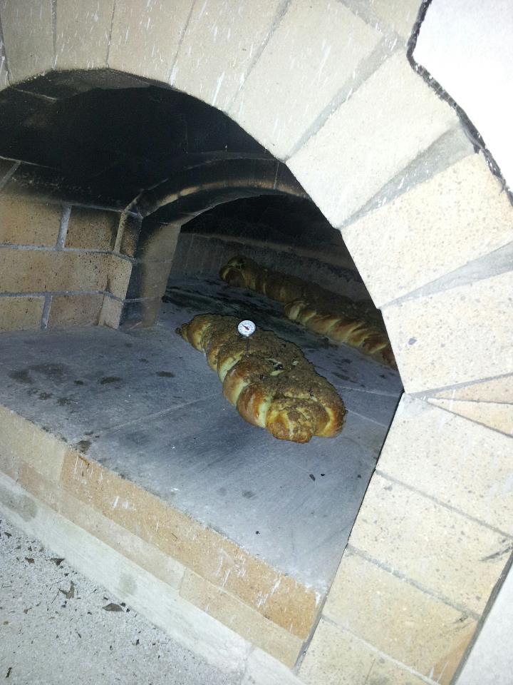

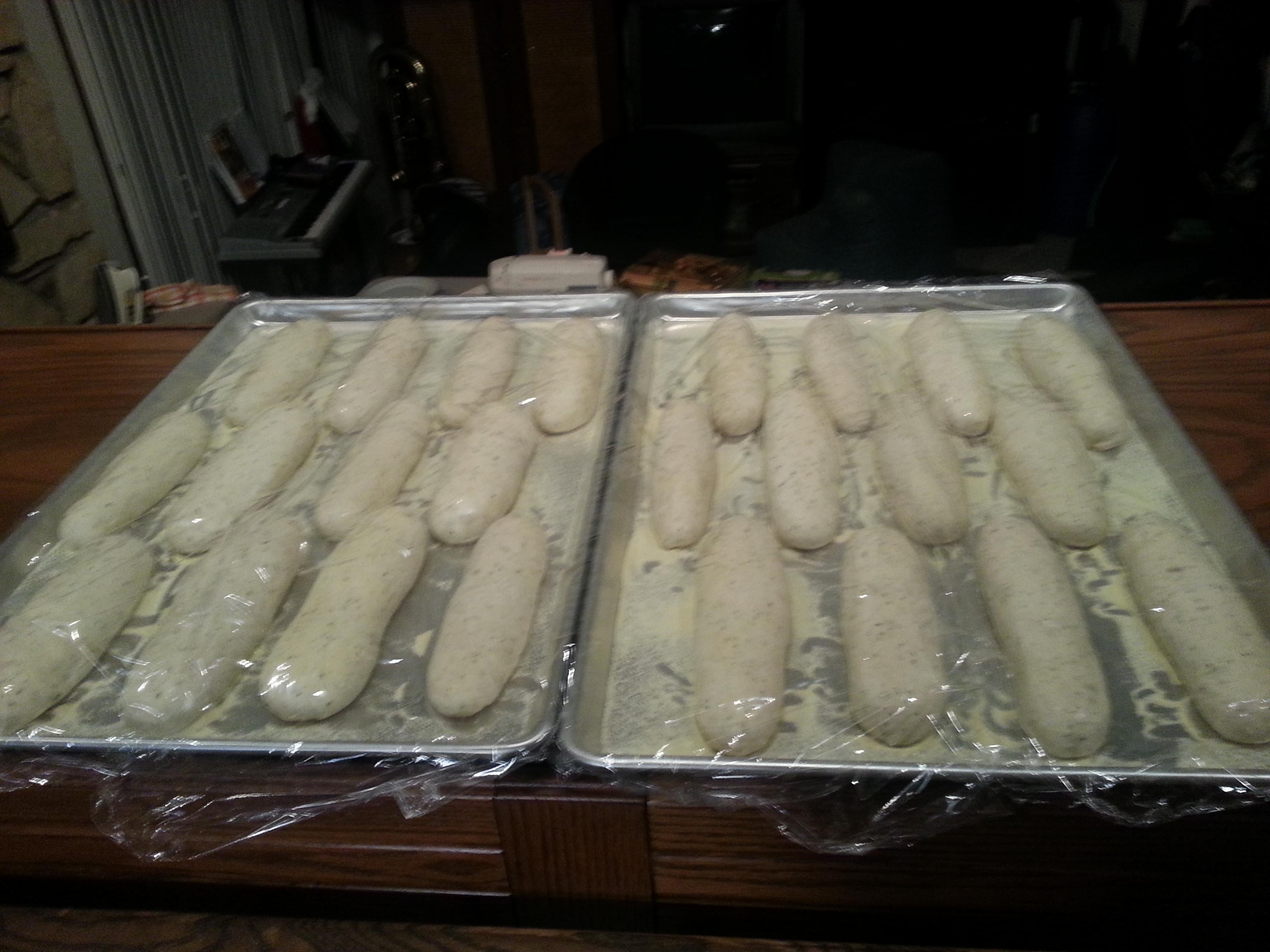

              Had a great WFO weekend. My oldest was home from college and wanted to bake. I modified my basic pizza dough to a garlic-herb-parmesan bread and my son found a recipe for chocolate, cinnamon bread; made a mixer full (2.5 kilos) of each.
Name:	Choc Cinn in oven.jpg
ID:	292393 Click image for larger version
Name:	Chocolate Cinnamon Bread.jpg

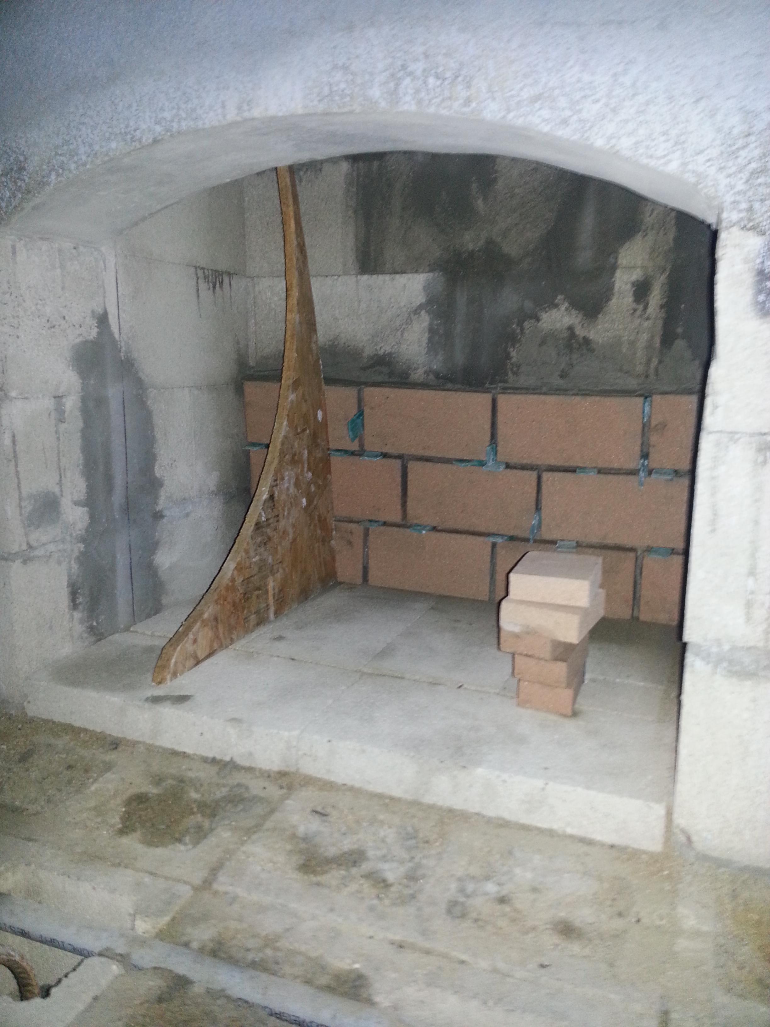

              I did a bit of mortar mixing too. Placing firebrick in the fireplace adjacent to the oven. First attempt was to create and install a "panel" of splits tilted off the back wall - that was a fail. Second attempt is buttering and placing bricks one at a time - using a plywood profile to set the angle - so far so good. It does take a bit of contortion to get in there.
Name:	2012-11-25 18.45.59.jpg

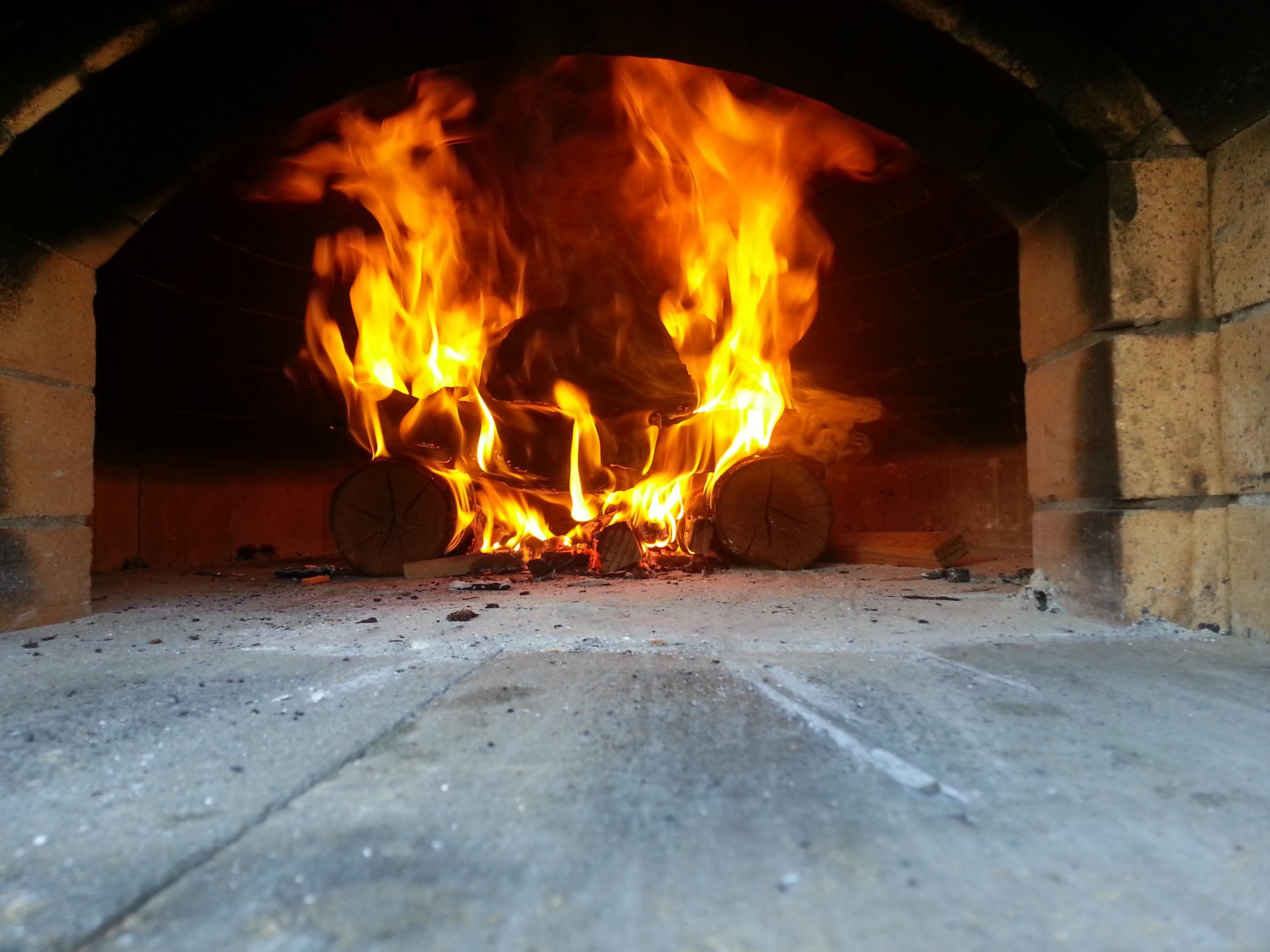

                    Did something new (for me) with the oven today.
                    I fired it yesterday morning with almond wood (as usual). Click image for larger version
Name:	2013-01-05 08.57.23.jpg
ID:	292598After some pizza for lunch I removed all of the coals to an air tight ash bin and left the door off for a few hours until the oven reached 475 degrees. I then baked two dozen 200 gram garlic and herb roles last night. Click image for larger version

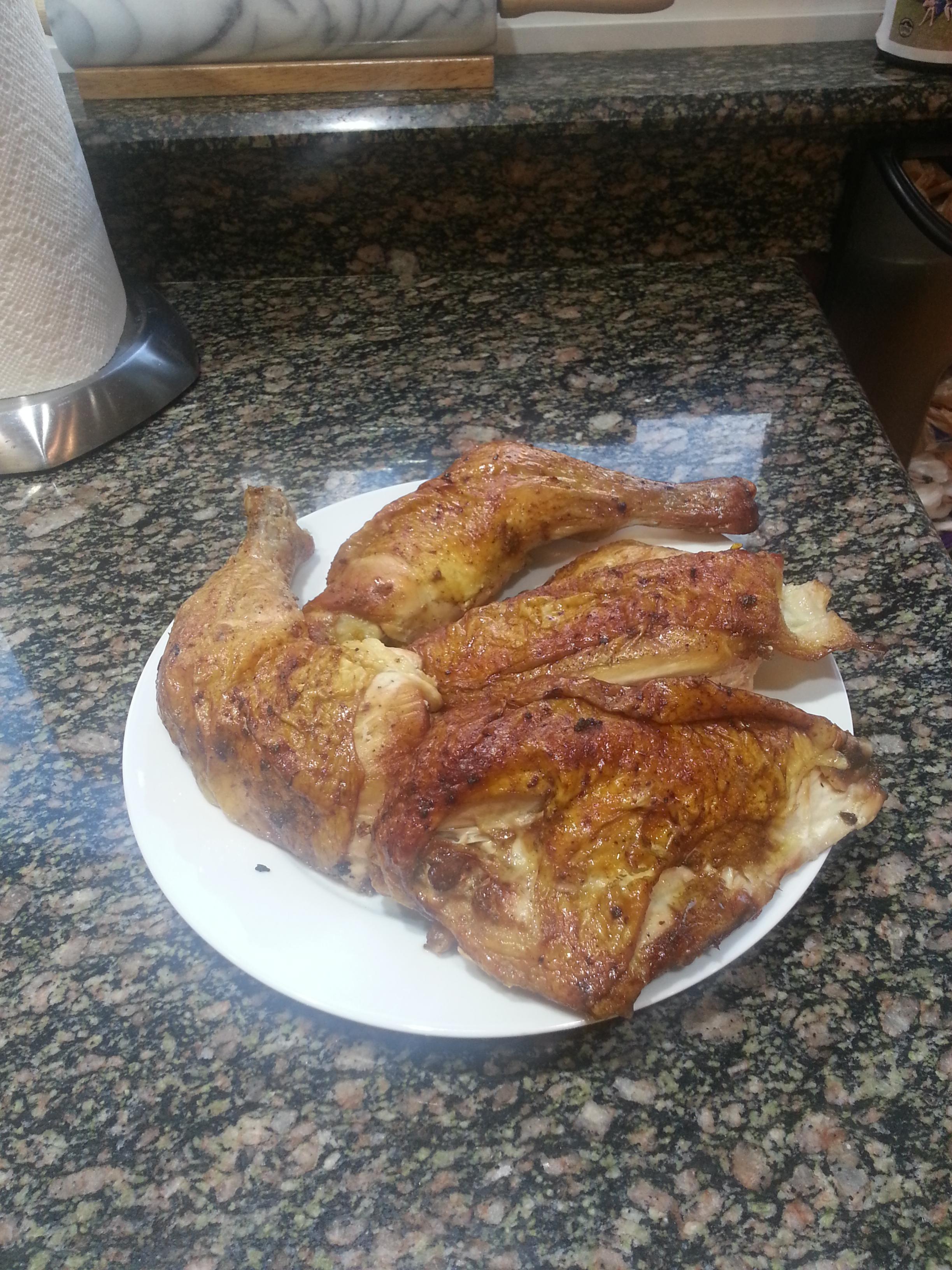

                    At noon today I put the (now cold) wood coals along with a few splinters of pine and a 2 inch Almond branch into the (350 degree) oven. With some encouragement from my torch, it ignited and began to produce lots of smoke.
                    I put chicken on a rack over an aluminum pan and placed the door ajar. When the temp probe in the meat read 180 degrees I pulled it out - the result was great! Good smokey flavor, Attractive browned skin and the meat remained moist.Click image for larger version
Name:	2013-01-06 16.24.57.jpg
                    WFOs are not just for Pizza and bread any more!

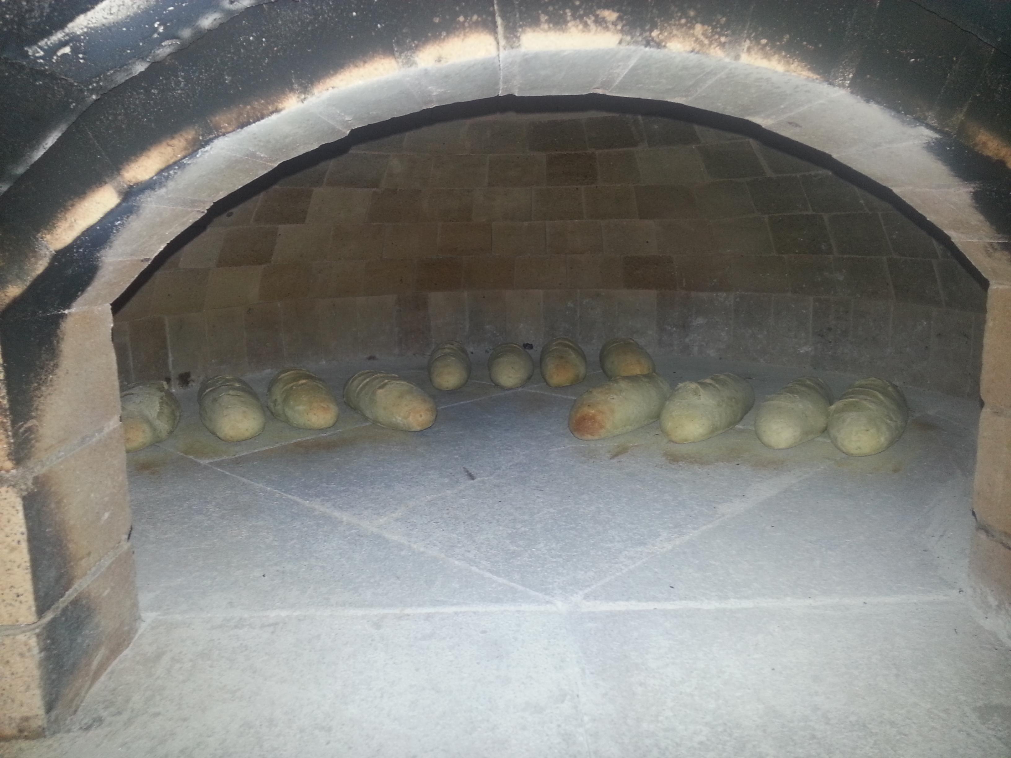

                        I am enjoying finding uses for each day of the oven's cool down cycle - different recipe for each day. I suppose I should get back to actually finishing the construction. Humph.

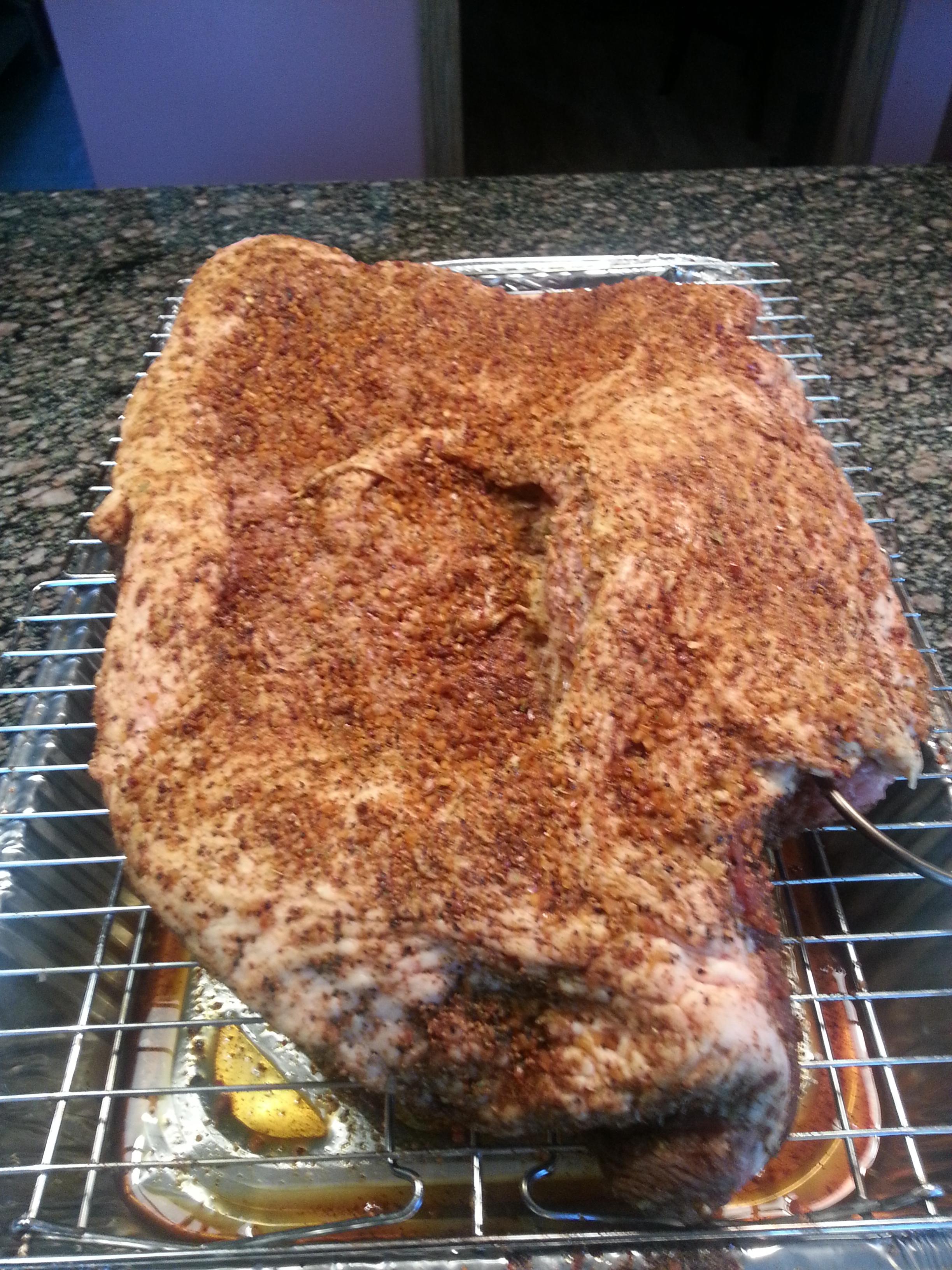

                          Something New
                          I smoked a Brisket today. I fired the oven Tuesday evening (and made pizza). This morning at 8 am (Saturday) the temp was 275 on the back wall. I clean out the ash and put in cold almond wood coals, one stick of almond fire wood and a handful of Hickory chips. I got them burning the placed the Brisket in the oven on a rack over an aluminum foil pan.Click image for larger version
Name:	2013-01-12 08.06.31.jpg
ID:	292680. I had prepped the meat with a rub the night before. I put my door on but propped it up so air entered under the door.
                          I put a thermometer in the meat and another k-wire thermometer in the air (on the rack) next to the meat.Click image for larger version

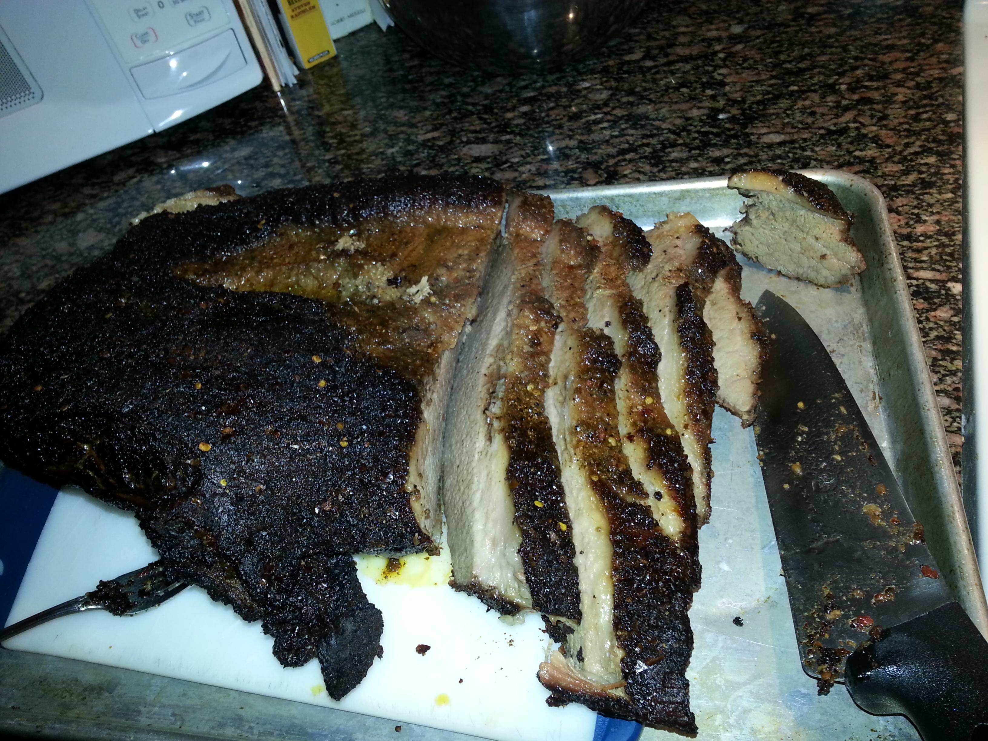

                          At 5 pm the temp probe read 180 and I pulled the meat out (I thought I was going to 190 but could not wait any longer). I discovered that the probe was in a large chunk of fat ( I trimmed the meat the night before but had not recognized this slab of fat). Served it up with garlic mashed potatoes, butter nut squash and broccoli.Click image for larger version
Name:	2013-01-12 17.17.01.jpg
ID:	292683. Next time I will trim better and ensure the probe is in meat not fat - the meat was nearly over cooked. I think I will also start cooking about 12 hours earlier (at around 325 - 300 degrees). One day a door with adjustable slots will allow better control of temp and smoke.

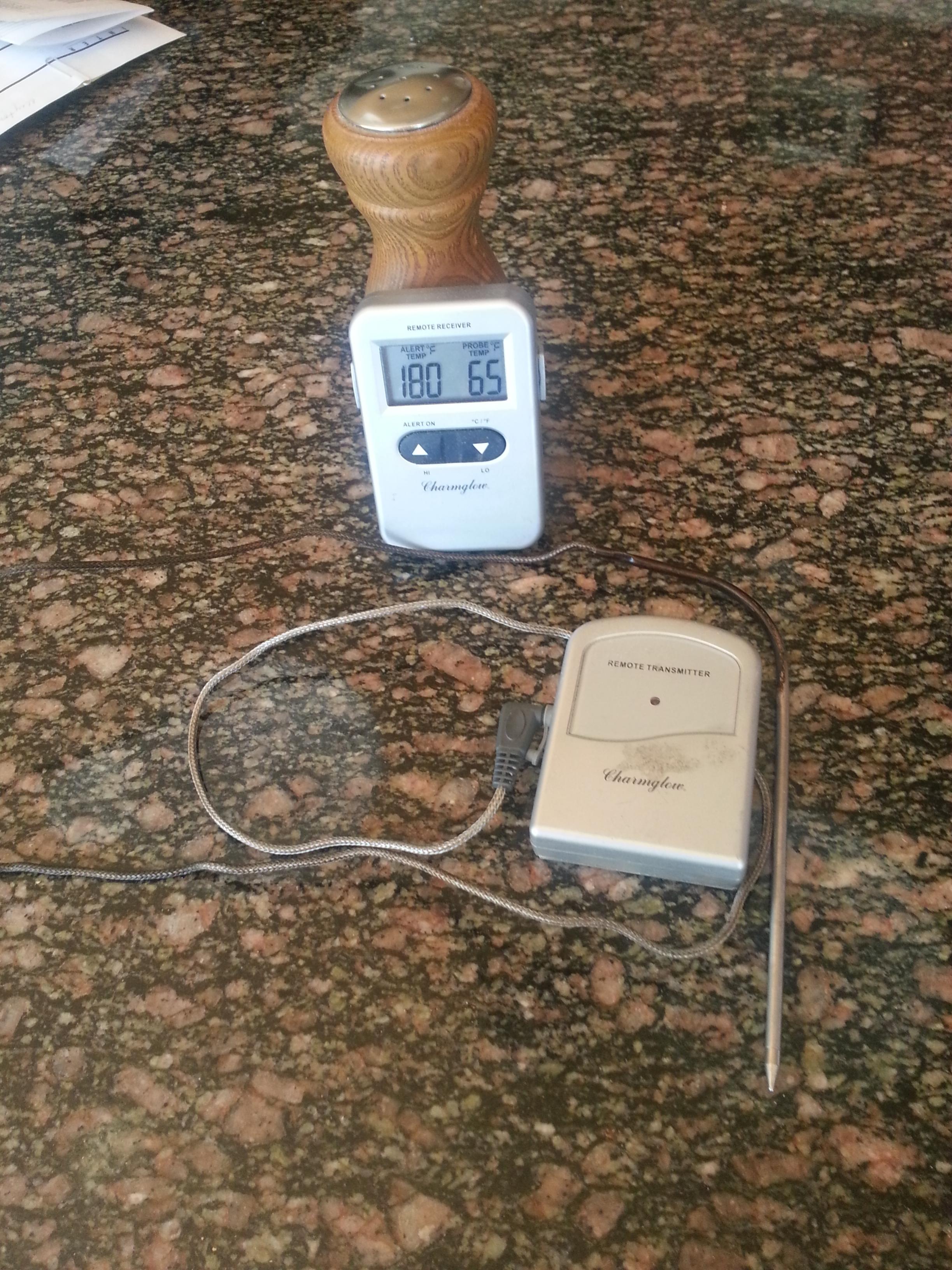

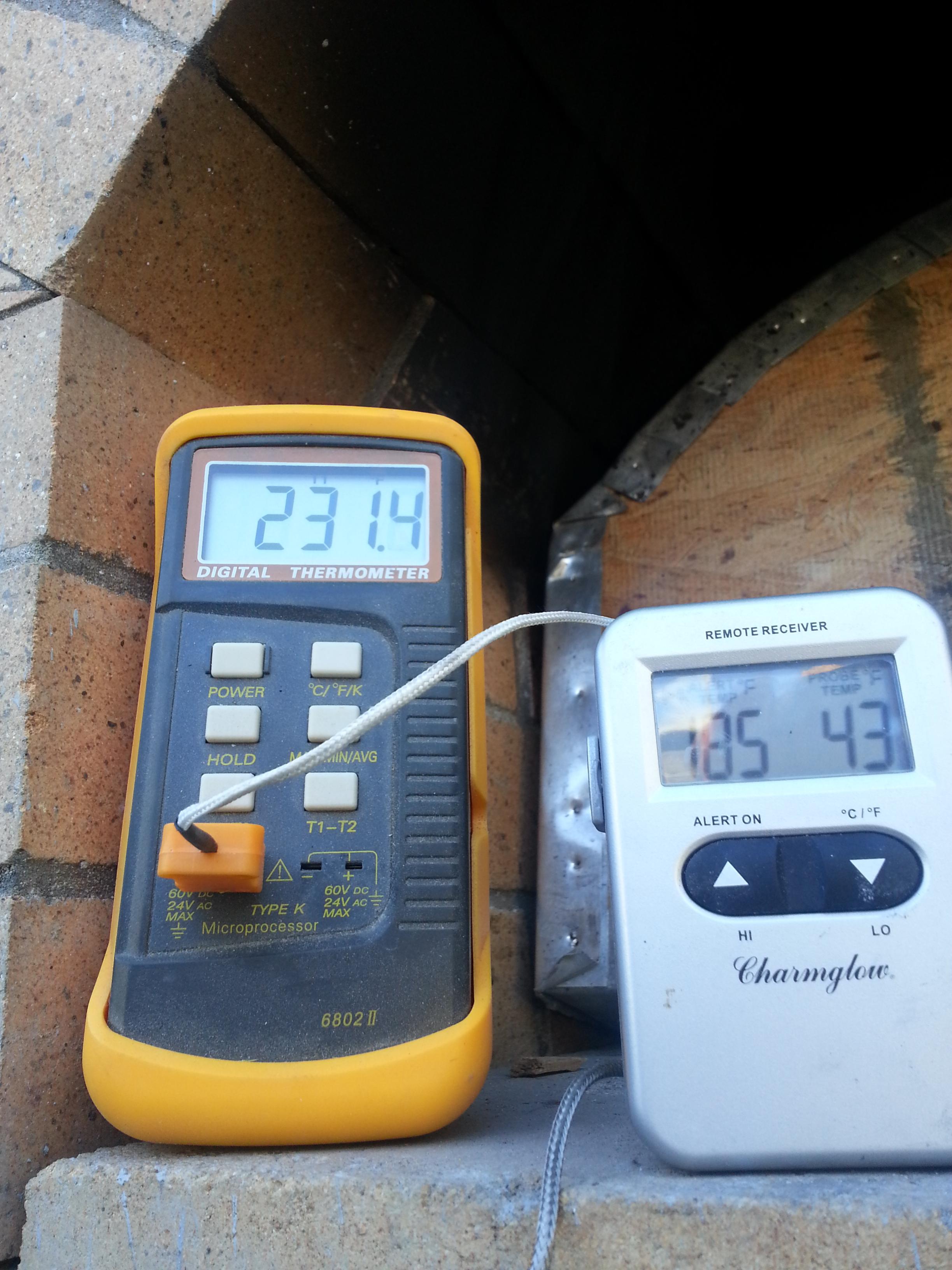

                              Hi Gulf
                              The meat thermometer has a 36 " probe (I got it several years ago - possibly from HD). The probe attaches to a sending unit and the receiving display works anywhere in the back yard (but not in the house).Click image for larger version
Name:	2013-01-13 12.11.23.jpg
                              The Brisket was ok, Then chicken I cooked last week was better. With the brisket - I was going for a very low temp - in order to maintain the heat, I was very stingy with air flow into the oven. The result is that my wood did not produce smoke as well as with a more open door. Also with the poor air circulation, the meat was a bit coated in creosote - easily trimmed off with the crust - But I generally like eating the crust! Next time I will start with a hotter oven and allow more air flow - I think think a door with vents will be part of the answer eventually.

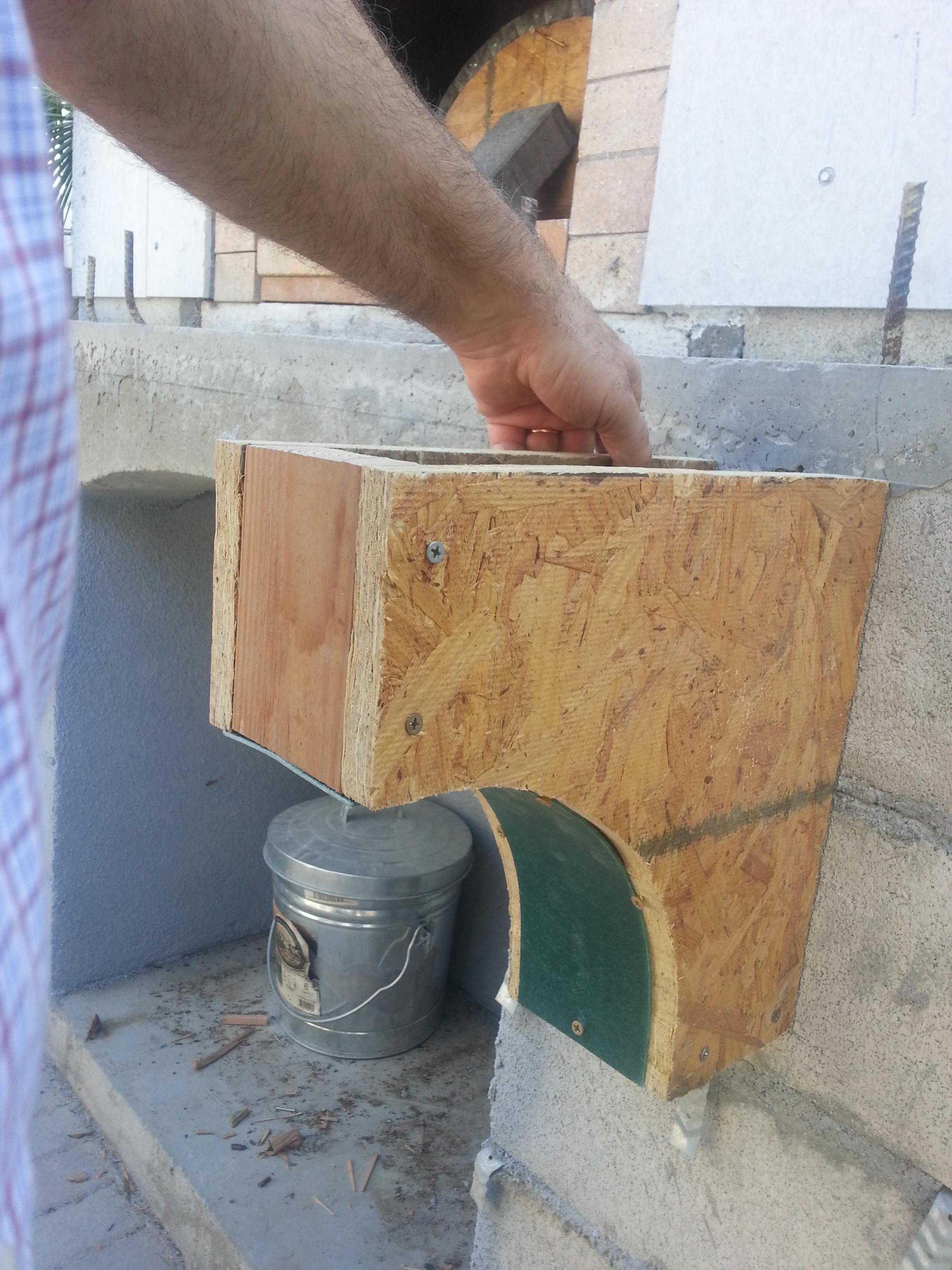

                              I am prepping to put a landing in front of my oven - I am going to pour cement corbels followed by a poured and polished landing. I want to try exposing the aggregate in the corbels (as you did). I am using bagged redi-crete and I plan to vibrate the pour (a wand in the cement - not a form vibrator). If I pour on a 65 degree day (we even dipped below 32 degrees last night - but that won't last a week around here) - how long before I should remove the form - 12 or 24 hour? Also to expose the aggregate are talking sponge or wire brush? Click image for larger version
Name:	2013-01-13 12.08.03.jpg

                                I looked back at your build and am wondering how you are supporting the corbels? I may have missed something. Did you drill some holes in your stand to insert some rebar? I am sure you have thought this thru, just wondering .
