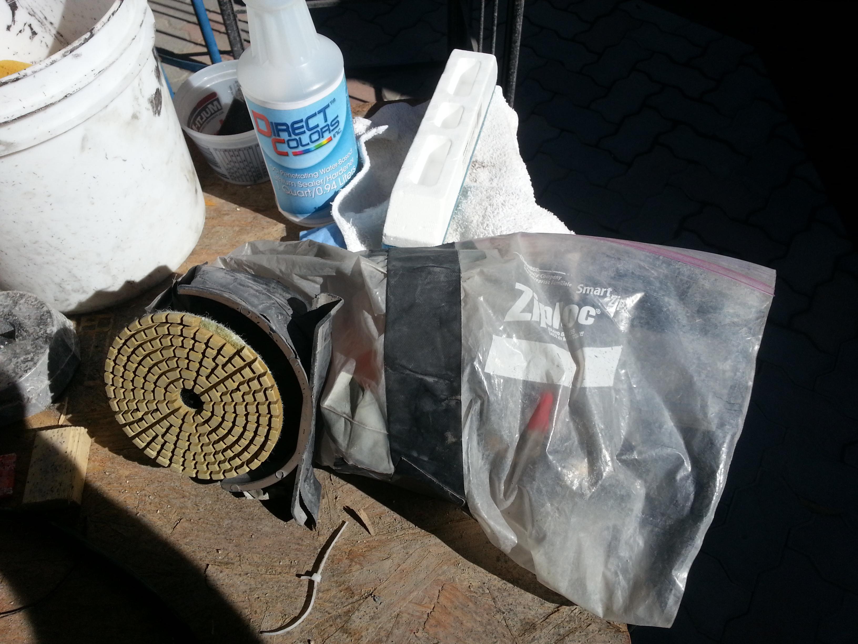

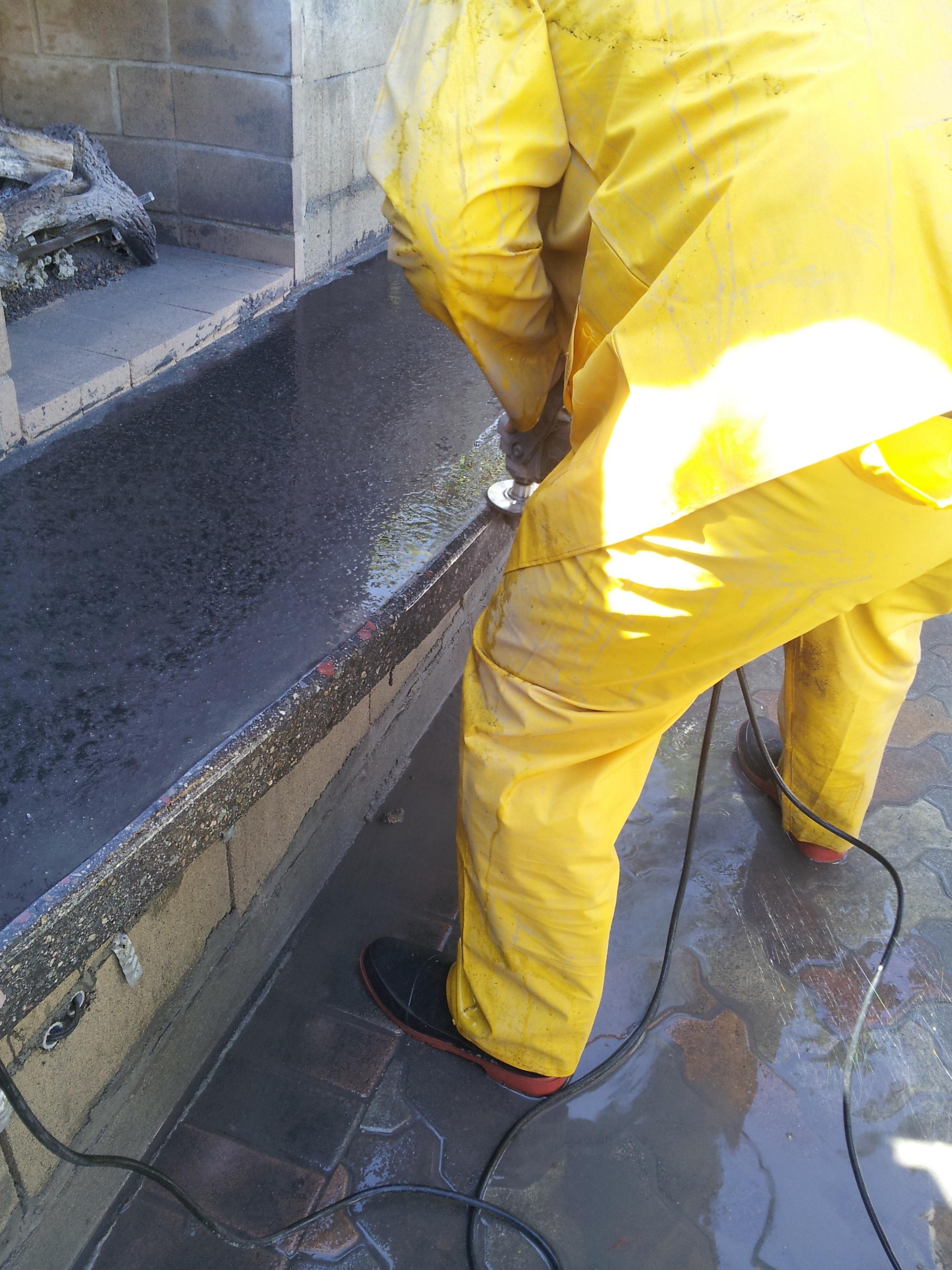

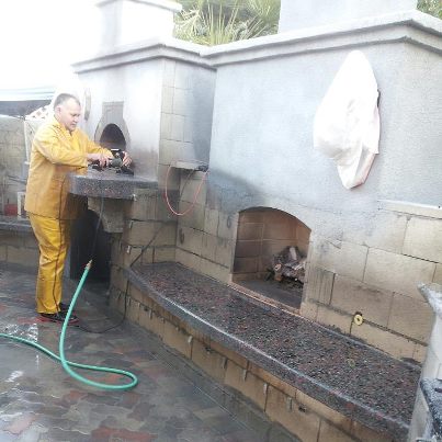

          3) The wet grinder is designed to work on a horizontal surface - not vertical:
          I purchased the unit with the bull nose router bit and the polishing pads on line and I ran it all day horizontal last Saturday happily grinding down about 1/4 inch then polishing to 400 grit. This weekend - working on the vertical face of the hearth - the GFI Tripped and the then the unit was dead within 30 minutes. I thought if was a defect, and facing a full days work I went to my local pro building supply yard to purchase another unit (the only one in stock was the display so I got $25 off) and I planned to return the online purchase for warranty. This second unit also tripped the GFI and went dead within 30 minutes grinding - the first unit had dried out - and worked fine. So I worked hard to keep the motor dry and rotated between the two units all day long. One is 800 watts, the other is 900 watts - aside from the color of the plastic casing and the stickers they are identical units. I plan to make some kind of enhanced plastic shroud before next weekends final vertical grind. BTY the rain hood with a face shield was an important part of the plan at this point as cement slurry flys straight up then back down on the operator during this process.

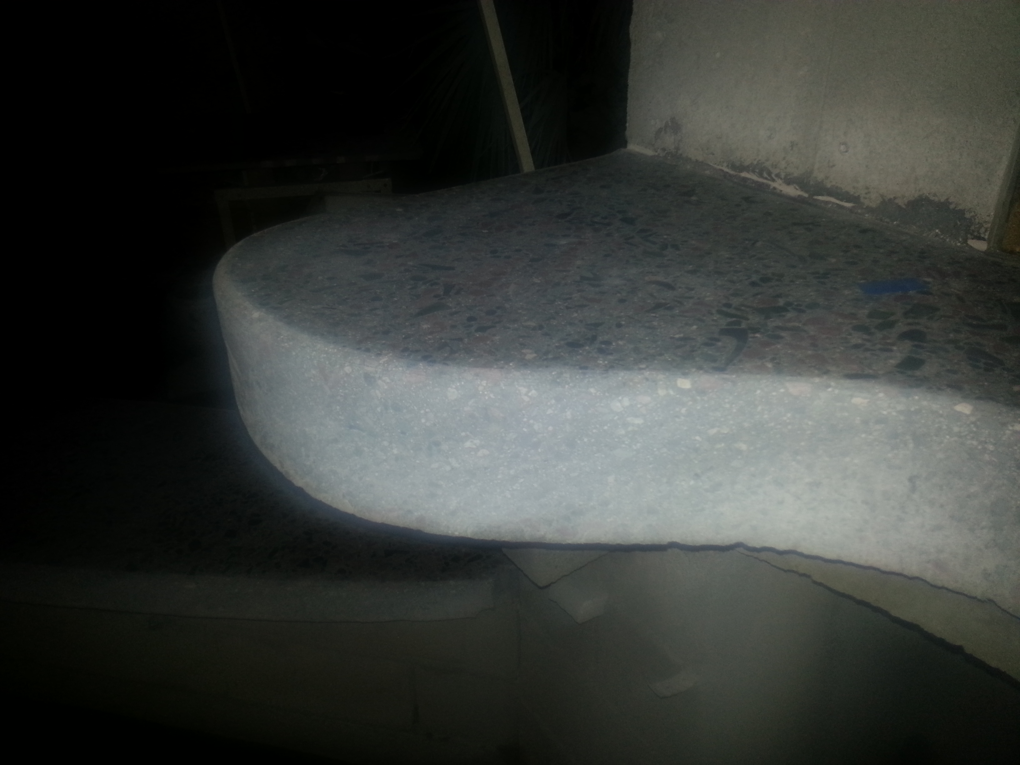

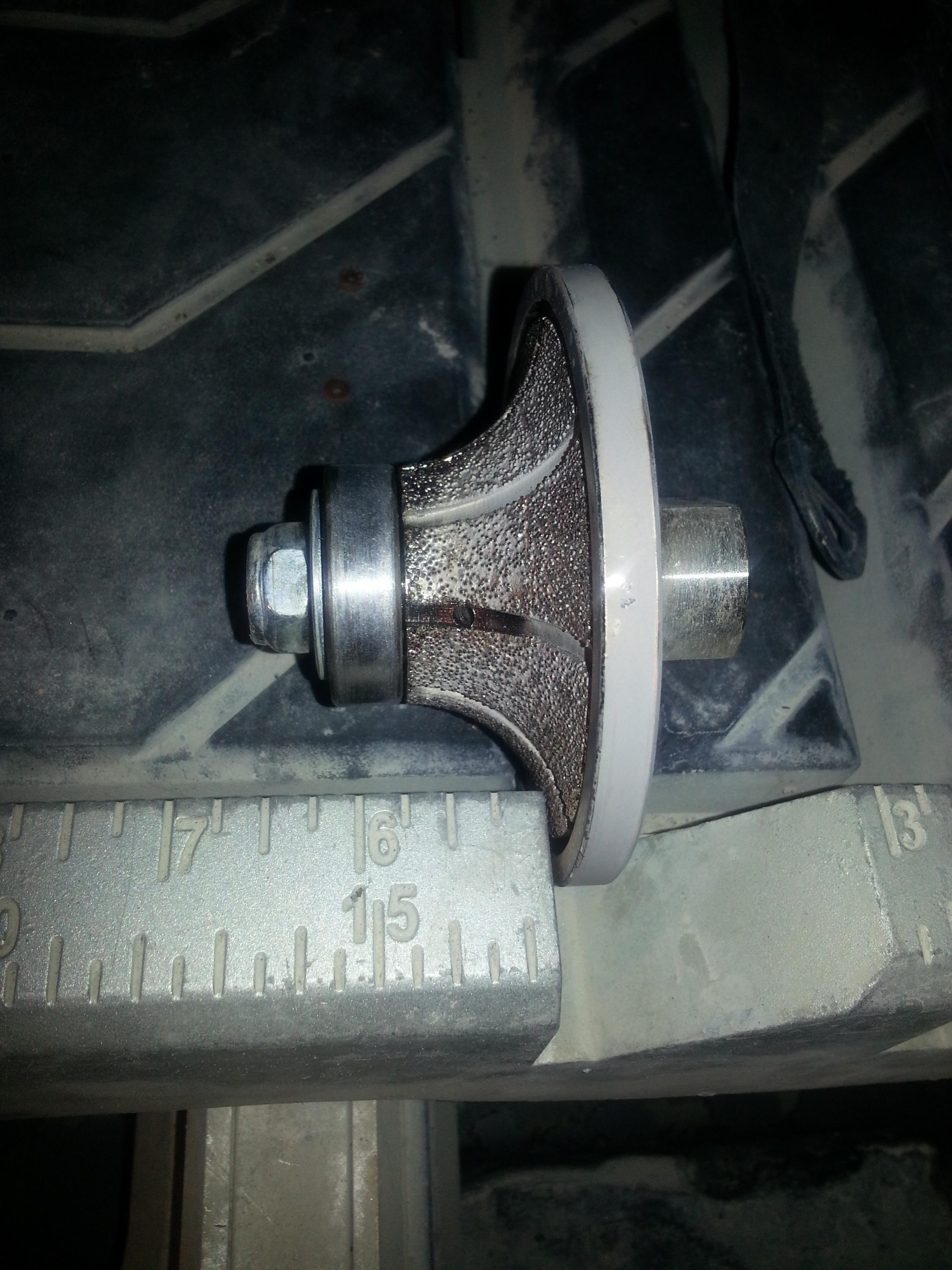

          4) The 3/4 inch bull nose diamond grinder worked great:
Name:	2013-02-24 21.05.23.jpg
ID:	293145Click image for larger version
Name:	grinding bullnose.jpg
          It was a very forgiving process. It was not necessary to try and remove all of the material in one pass - I could take of in various manors (push - pull - dive in) as long as the final pass with the tool was pushed down, and flush to the surface, the edge came out great and Stones are revealed in the ground edge!Click image for larger version

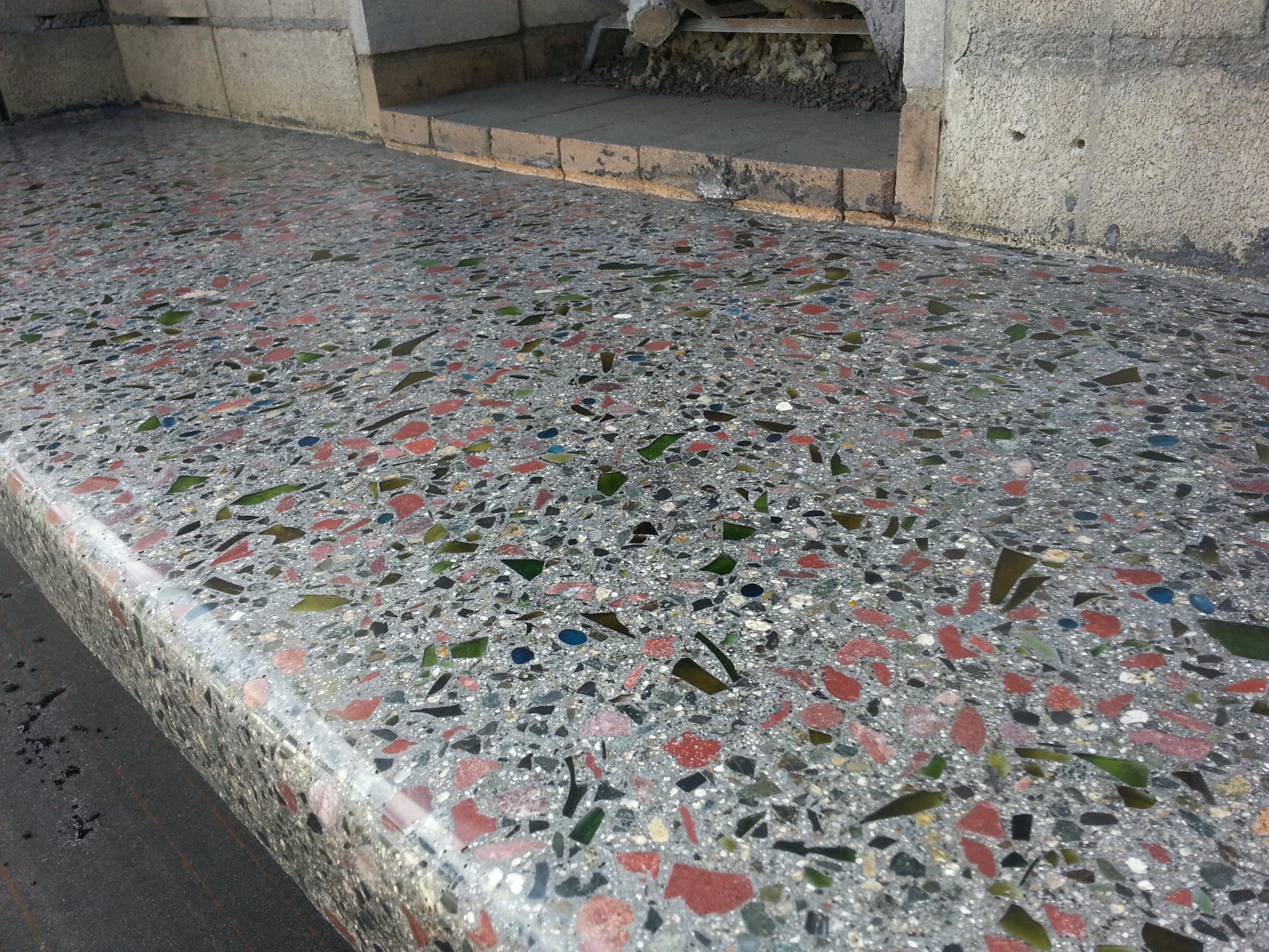

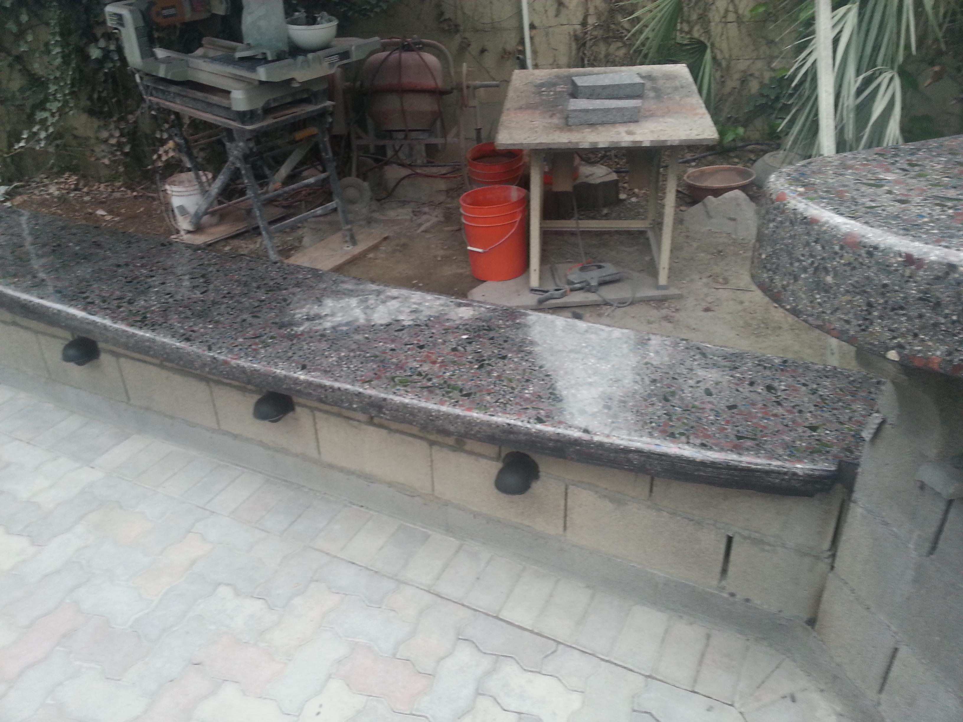

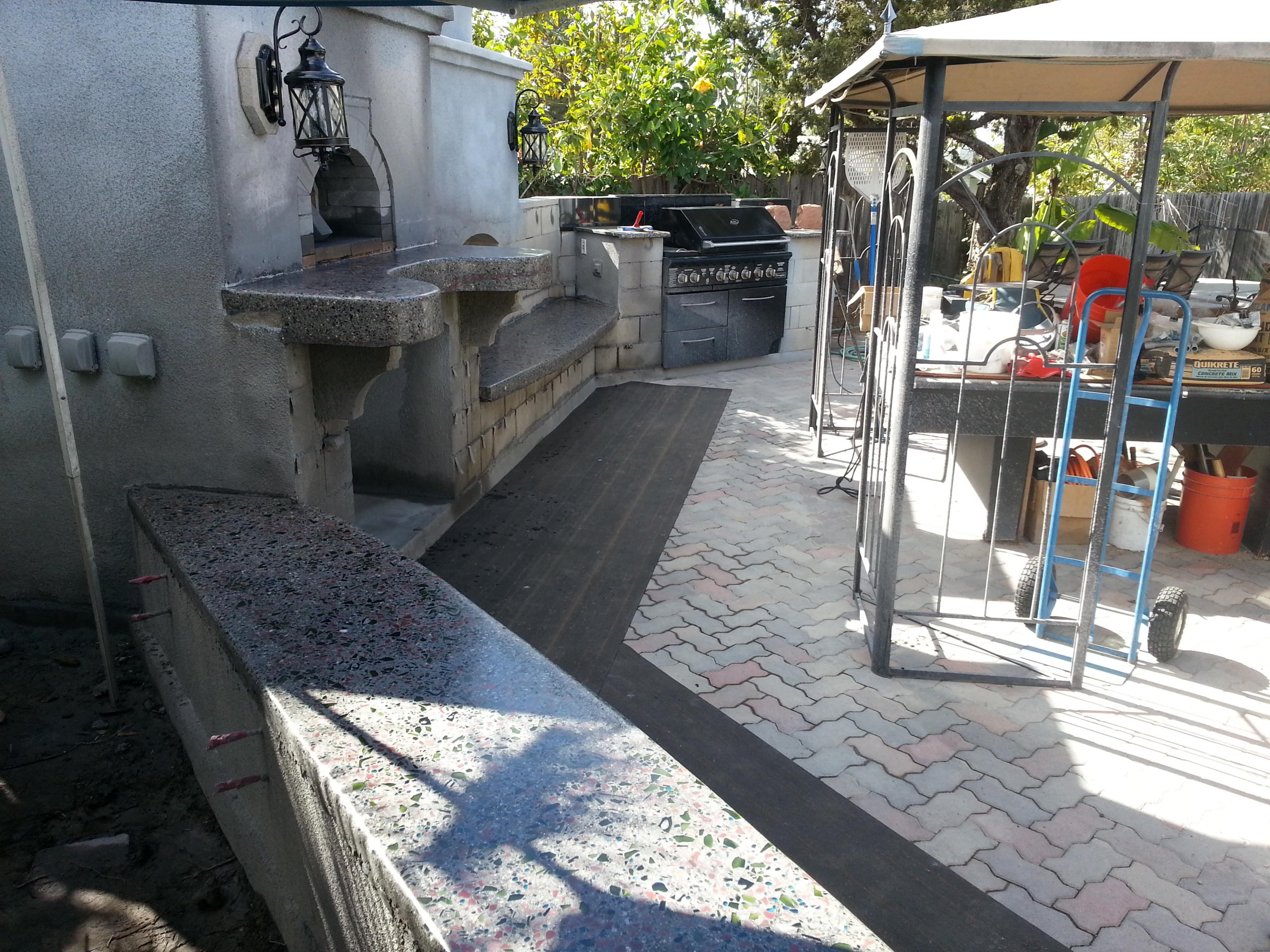

                I finally can see the light at the end of the tunnel with this project. I got the the last bit of polishing done and lithium sealant applied on the poured in place landing, hearth and seating. Once it is good and dry, I will polish the sealant and get some photos in the sun. I am very pleased with the outcome.
Name:	2013-03-03 14.20.01.jpg
ID:	293206Click image for larger version
Name:	2013-03-03 14.20.17.jpg
ID:	293207Click image for larger version
Name:	2013-03-03 14.20.42.jpg
                I am anxious to see how it holds up. The key to polishing the vertical surfaces was keeping the motor dry.
Name:	2013-03-03 14.28.20.jpg
                Next are the decorative arches for the oven and fireplace. I am planning a keystone to match the counter / hearth for each. My wife and I finished casting 100 sq feet of faux limestone in colors complimentary to our existing pavers for the final step.

                      Several Lessons learned since my last post

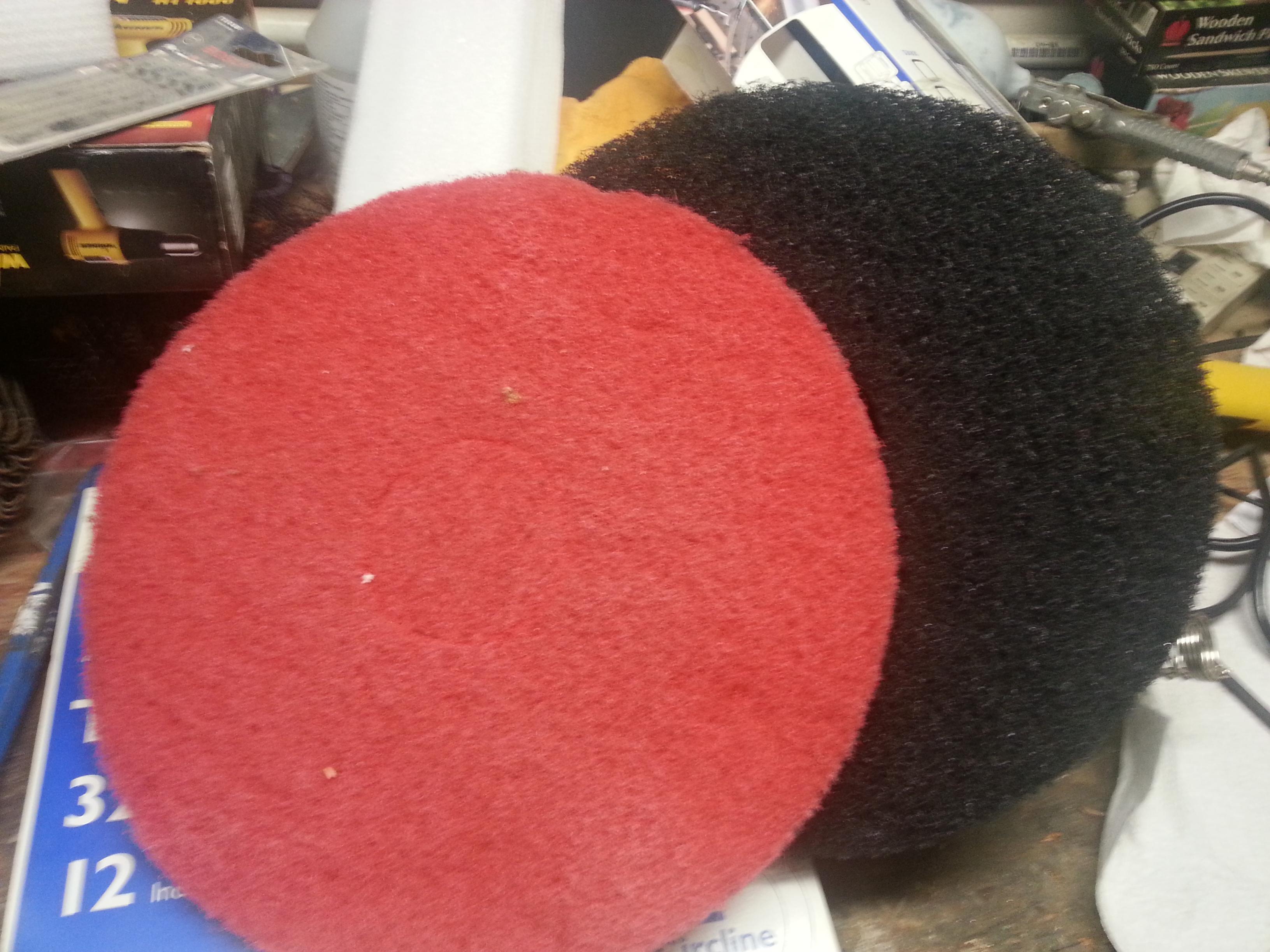

                      1) The Lithium sealer penetrated nicely and gave a satin finish as advertised. It was a bit bumpy and in few locations. Where I applied a "second coat" during initial application it did not penetrate at all and just sat on top - yuck. Soo I endeavored to Polish the lithium sealer with the recommended floor buffing pads
Name:	2013-03-27 07.23.21.jpg
                      2) The red did not remove any material and the black scratched the surface. Boo
                      So I then "polished" the Lithium sealer product with a 1600 grit granite polishing disk - it took down the high spots and left the surface (particularly the glass) cloudy when dry. What was frustrating was how amazing the colors were when wet, and then it went all dull when dry. I took photos but they didn't show the problem well.
                      So I next re-polished the surfaces with the granite disks 800, 1200, and 1600 - this removed the micro scratches in the glass and the looked great until they dried then some color was again lost.

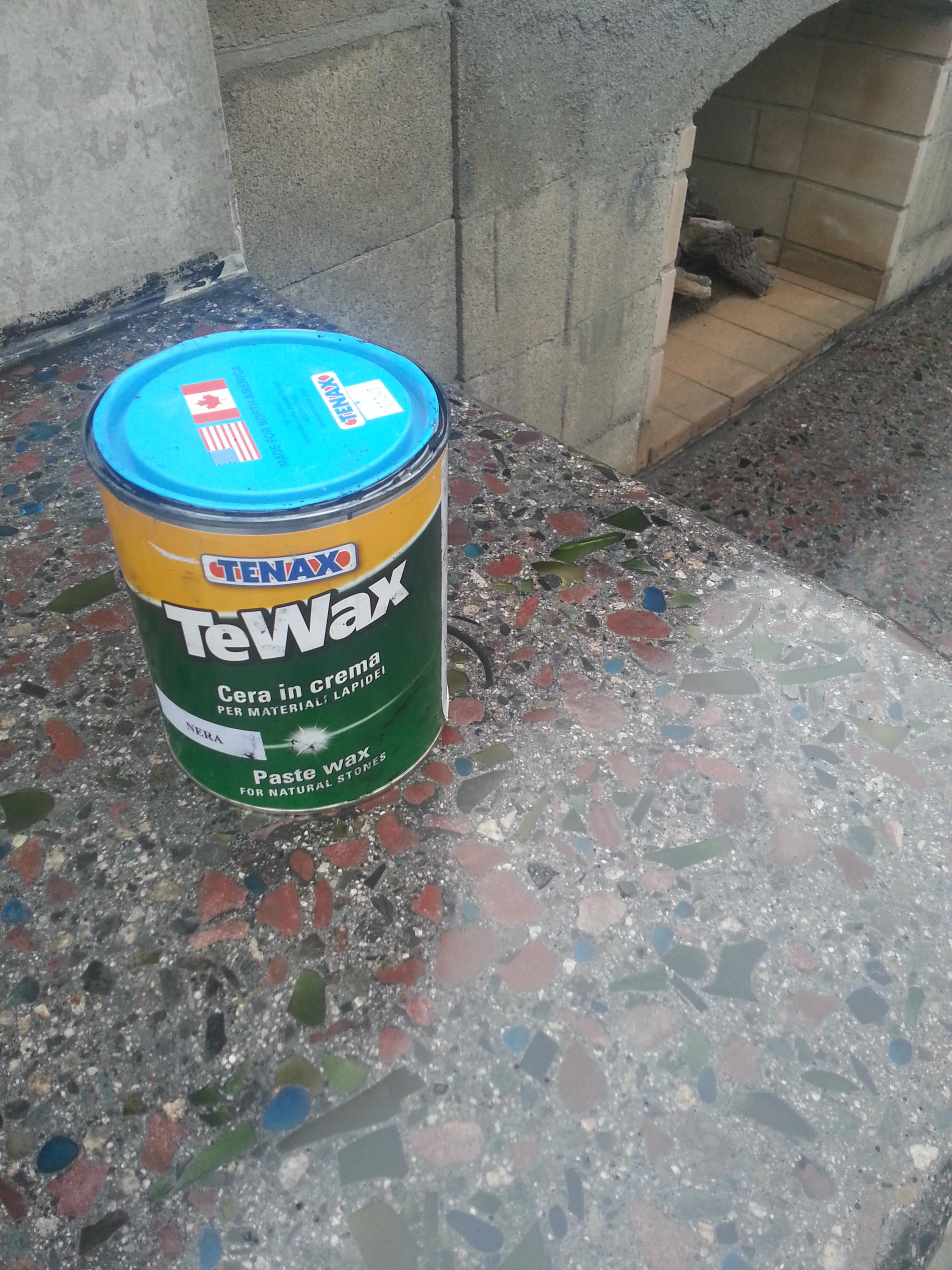

                      So I then applied this wax - Click image for larger version
Name:	2013-03-27 07.20.03.jpg
                      3) This wax worked great. This is the same product I used in my kitchen a few years ago when I installed granite counters (DIYGranite.com). I applied it like car wax then removed the excess and buffed with #0000 steel wool. I used the velcro backer disk from my polishing disks in the angle grinder on low speed.

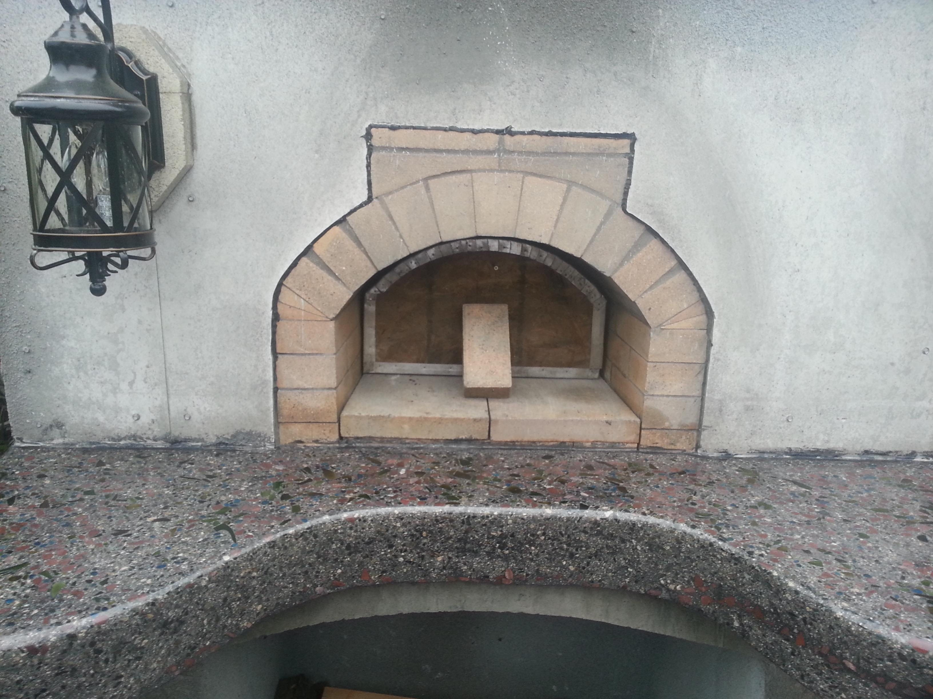

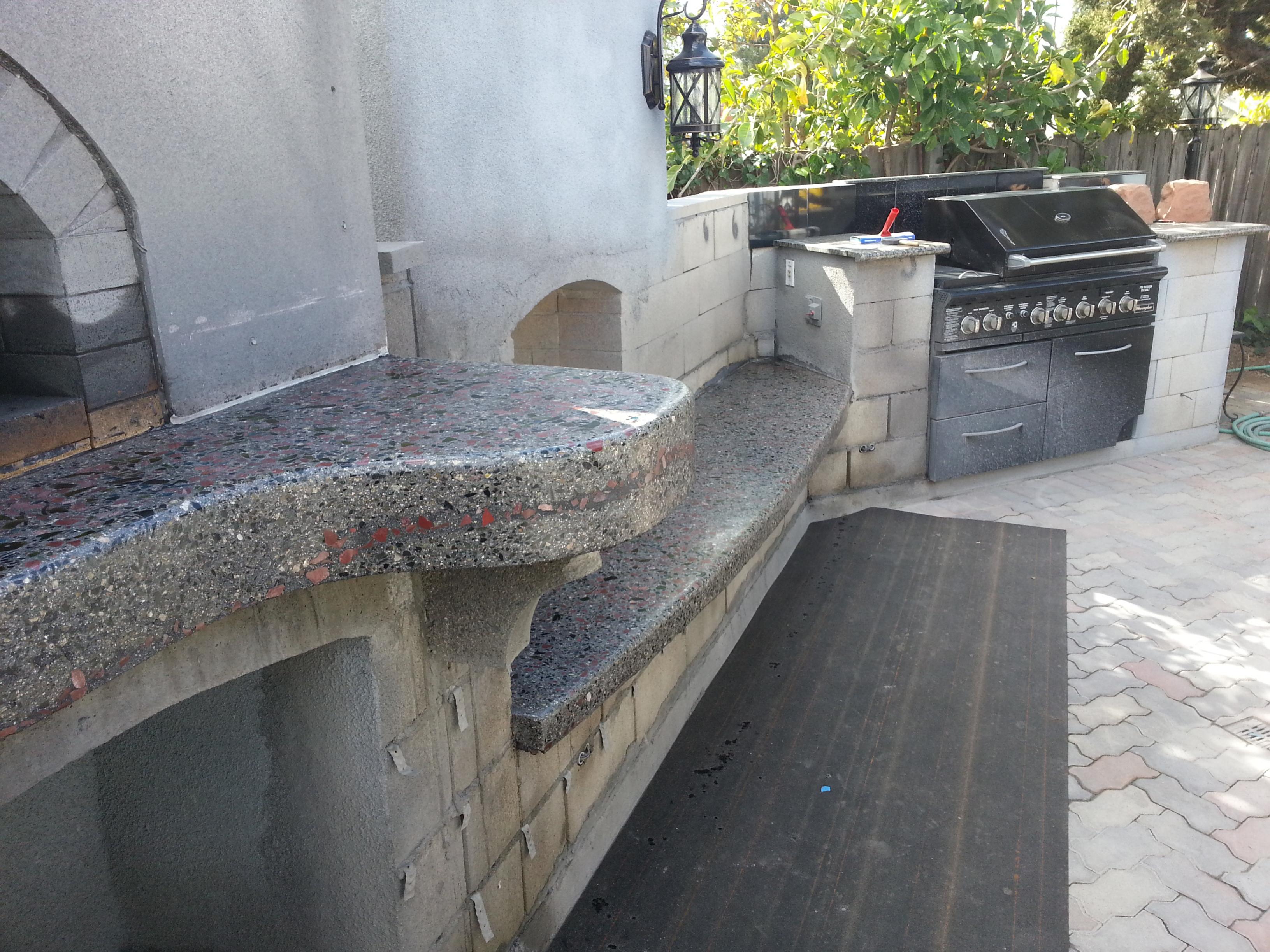

                      I am satisfied with the result: from Click image for larger version
                      To Click image for larger version
Name:	2013-03-27 07.21.21.jpg
ID:	293587 Click image for larger version
Name:	2013-03-27 07.21.09.jpg
